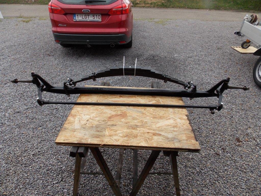

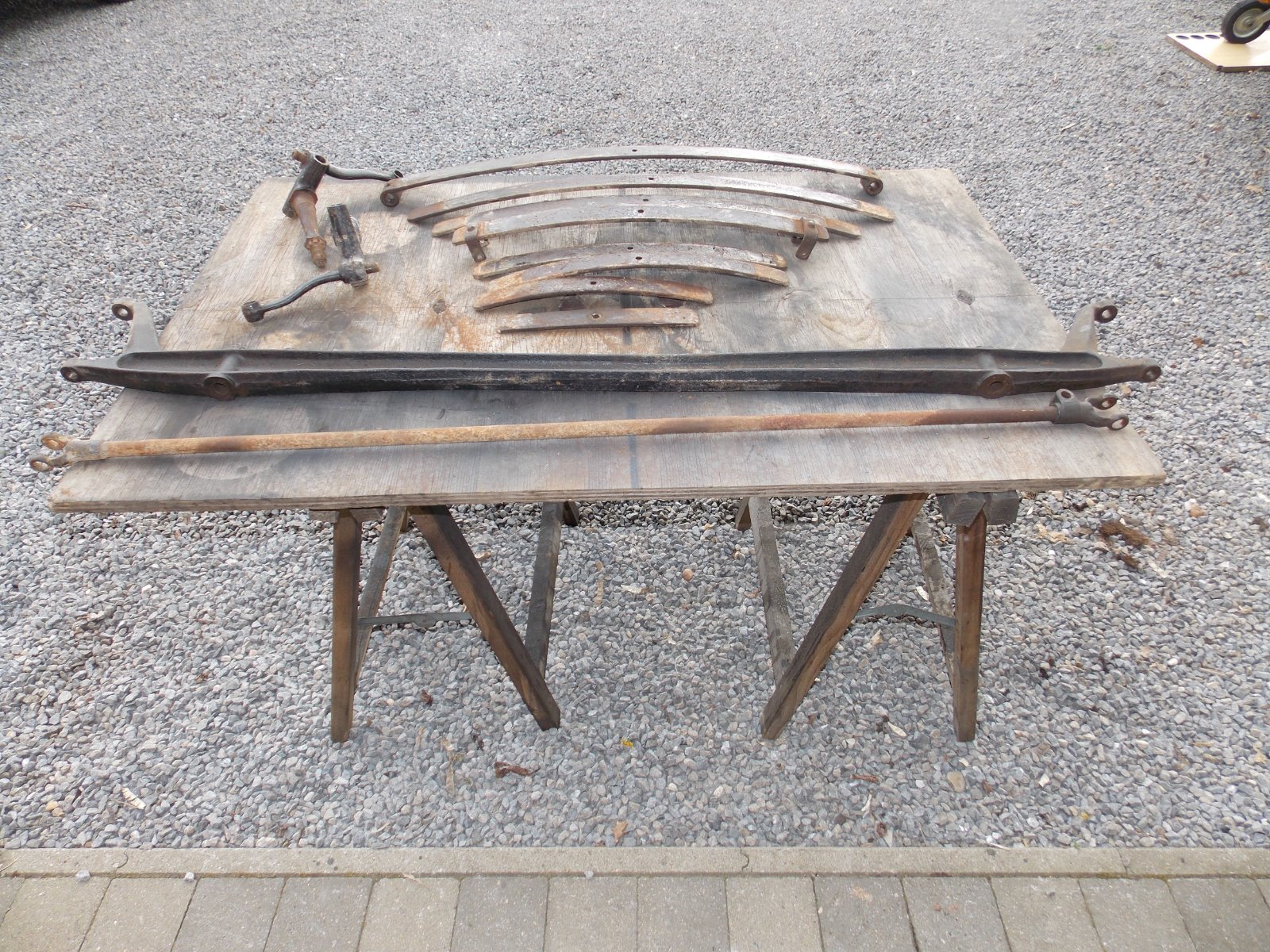

Post by AndreFordT » Wed Jul 24, 2019 4:44 pm

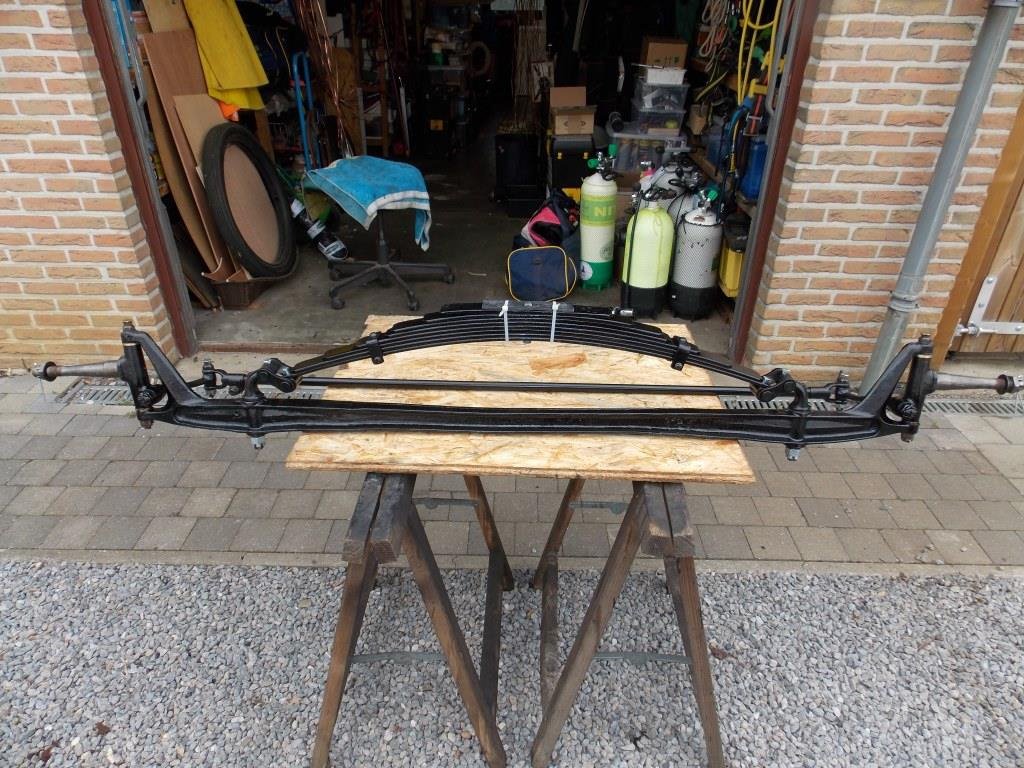

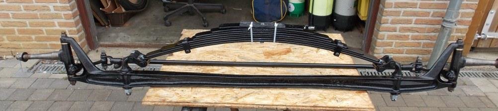

Here photos of a fresh restored 1926 front axle.
Andre
Belgium

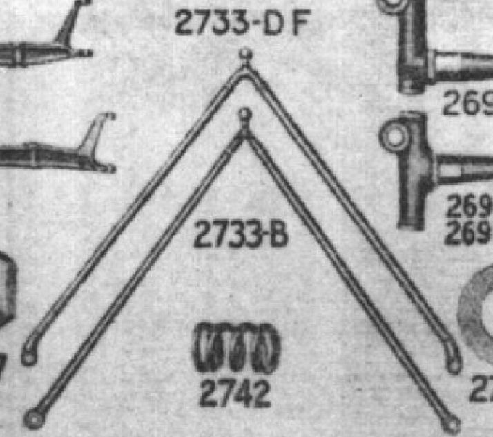

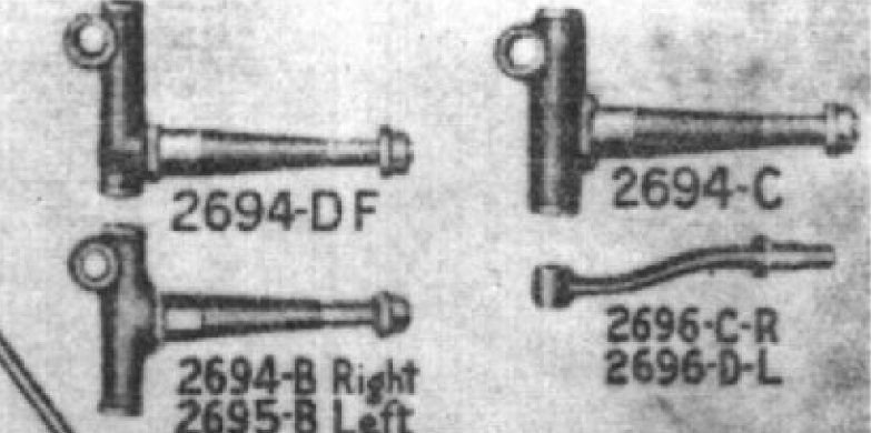

Re: Improved car front axle
Post by Hap_Tucker » Wed Jul 24, 2019 8:19 pm
Andre,

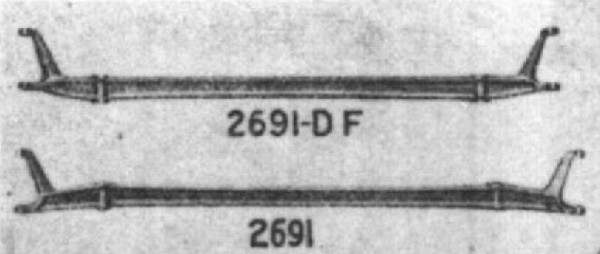

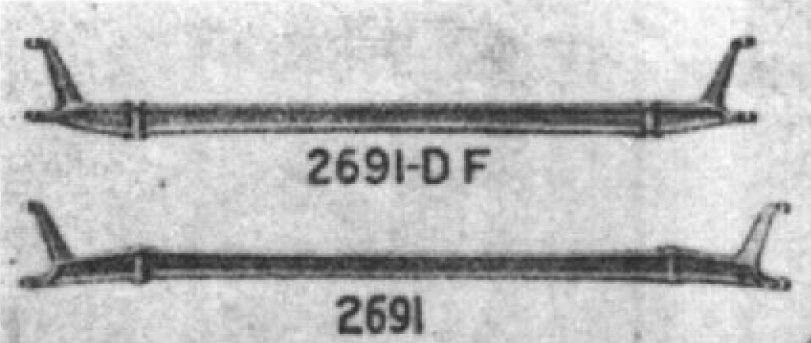

Your axle appears to be the English Ford produced axle that they introduced with the Drop Ford cars in Jan 1924 (ref page 230 of the English Ford Book vol 1). Below is an illustration from one of the English Ford Price List of Parts showing the earlier style regular front axle and the DF or Drop Frame front axle that they produced in England.
Hap_Tucker

For a 1926-27 car assembled in Denmark, England etc. -- they used the DR front axle and DF wishbone but the standard style USA type front spindles. Ref: http://www.mtfca.com/discus/messages/331880/375948.html Also ref page 180 of the English Ford Book vol 1.
