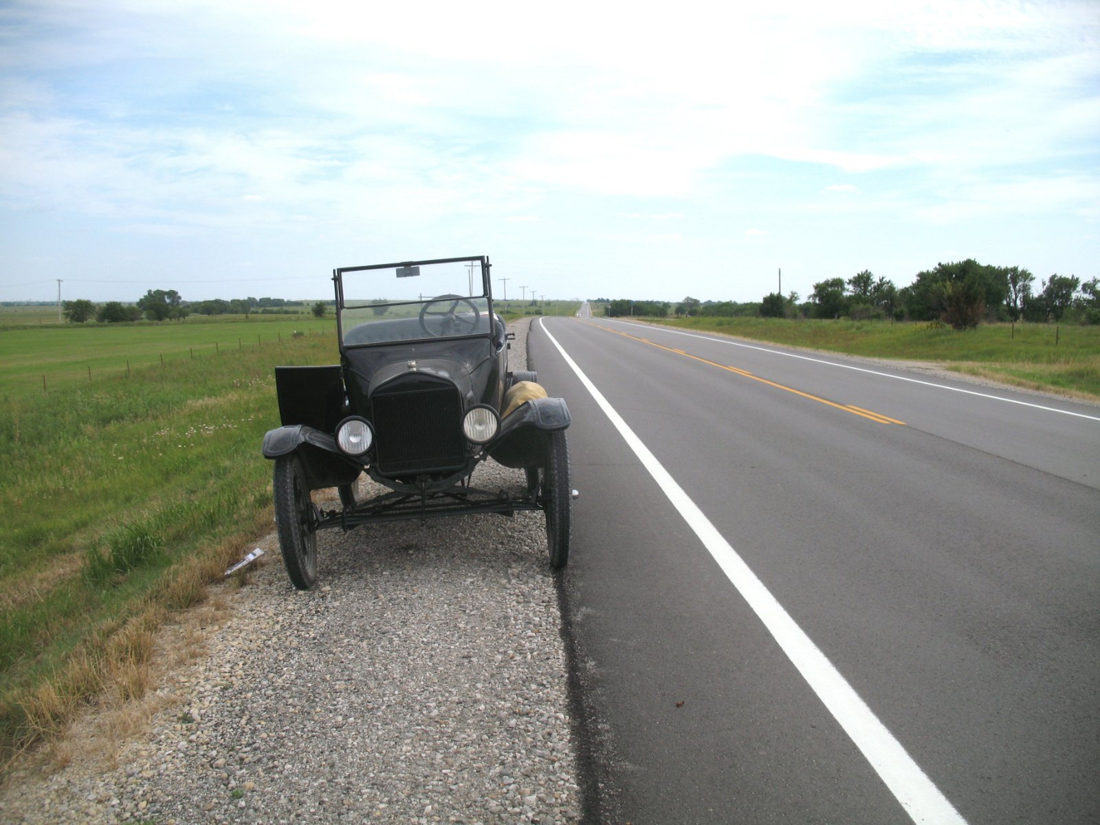

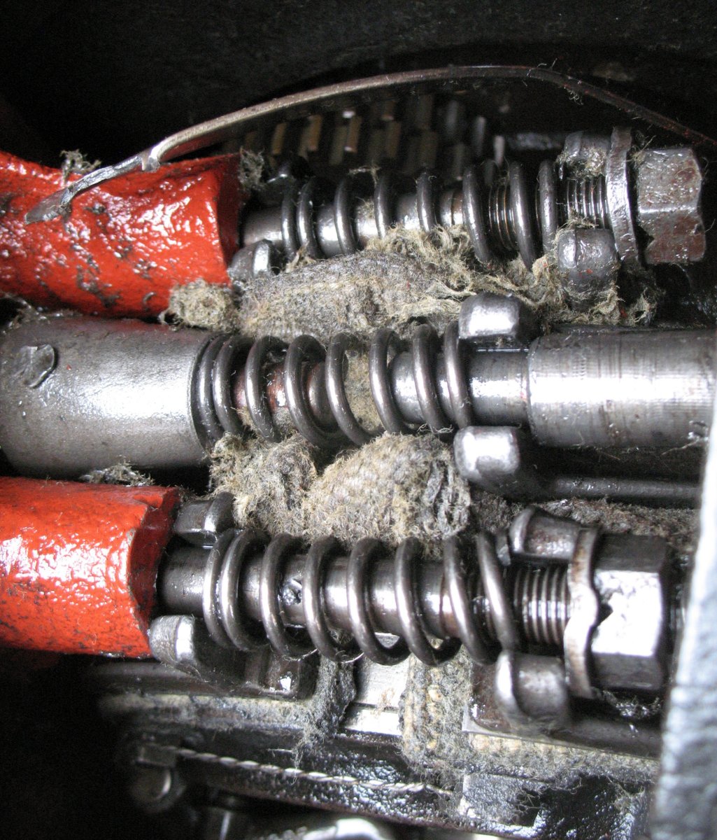

About six miles up the road a loss of power accompanied by a certain noise told me I was running on three cylinders. I stopped and replaced the defunct spark plug, but couldn't get the car started again until a passerby with a tow strap got me going. Less than a mile after that a very bad noise underfoot had me stopped again.
See what's missing? It's attached to the half low band sticking out at the top of the picture.
Waiting for Wally. I called my cousin to come and fetch us home. I'll go back this morning with the trailer and get the car.

What IS that at the top of the photo ? And, is that band material all wadded up ? Your reverse adjustment nut is not engaged into the washer.

You have a real problem there. I have never seen band material all bunched up like that in all my life. You have to address the issue further. That almost looks scary!

Is that about half of the low speed band up at the top of the picture? Yikes!

Is that safety wire at the top of the photo?

Almost looks like part of a piston ring.

Looks like the band ear broke loose. It either wasn’t latched completely, or tore itself loose. Occasionally, bands have hairline cracks thru the latching lugs that could allow that type of failure.

Now I realize that THAT is the remains of the low band - holy Crap - 40 + years in the hobby and that's a 1st !

guys look closely its not a wire you are seeing its the band from the edge way view. philip

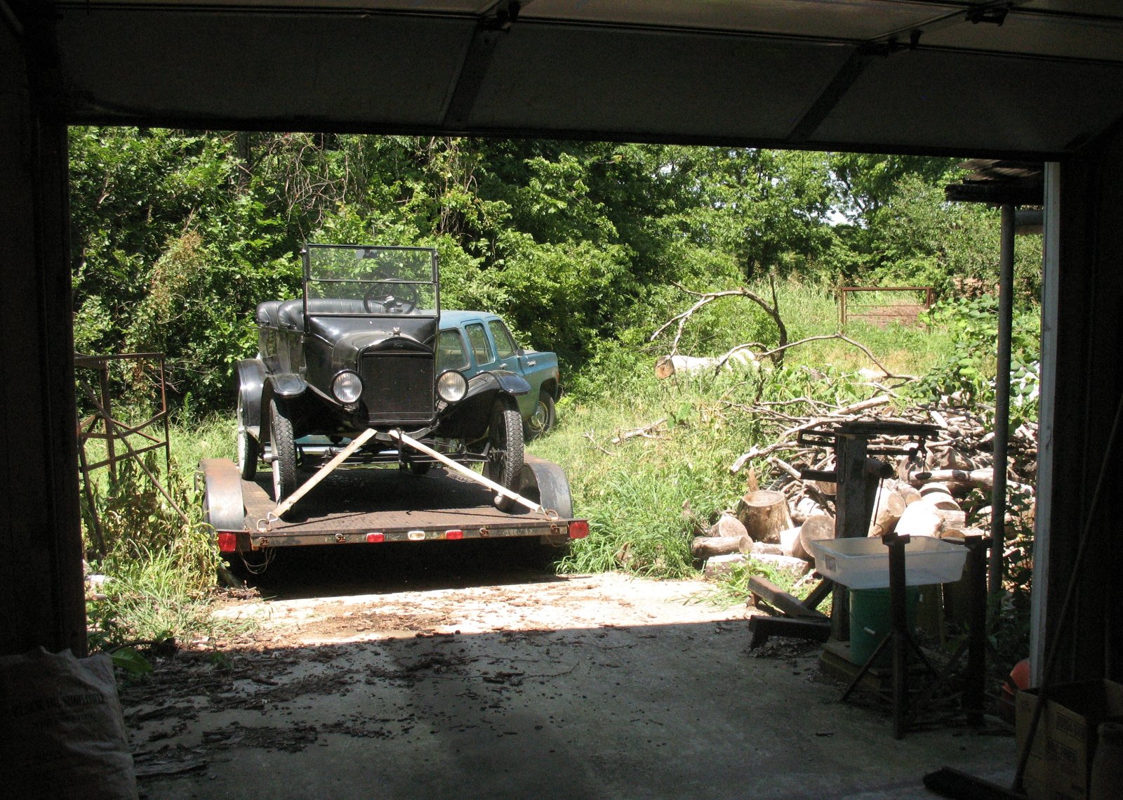

I'll say. So far none of the anti-Kevlar folks has said, "See? I told you so!" Yes, that's band lining material bunched up on top of the drums. The missing band ear is still attached to half the broken band, which is that piece sticking out at the top of the picture. And yes, this will be an engine pull for sure. I expect there's band lining fuzz everywhere I'll have to clean out, and I'll have to inspect all the transmission parts to see what went haywire. Chances are there will be several things to fix or replace.

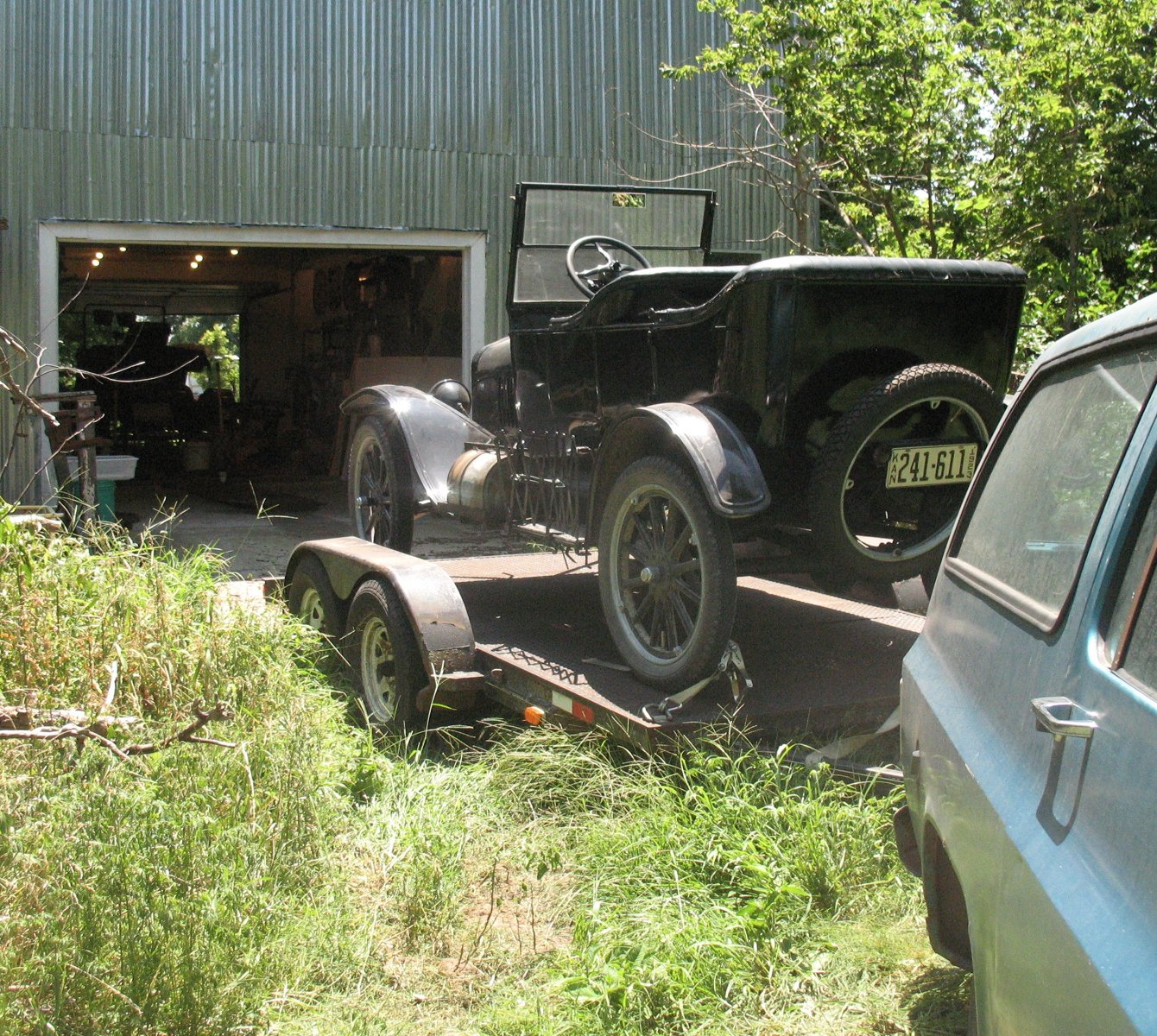

I just got home a half hour ago and I'm sitting in front of a fan cooling off before I unload. I put the car on the trailer backwards so it would unload nose first into the shop. That made me a bit nervous about whether I had enough tongue weight, so it was a slowwwww drive home. I kept a speed limit of 40 mph.
I'll roll the thing into the shop, and maybe do a preliminary look-see, but really digging in will have to wait while I take care of some other chores. If my cursory inspection shows anything I'll post a picture.

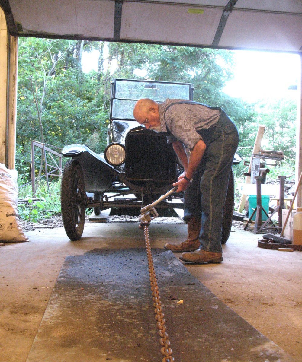

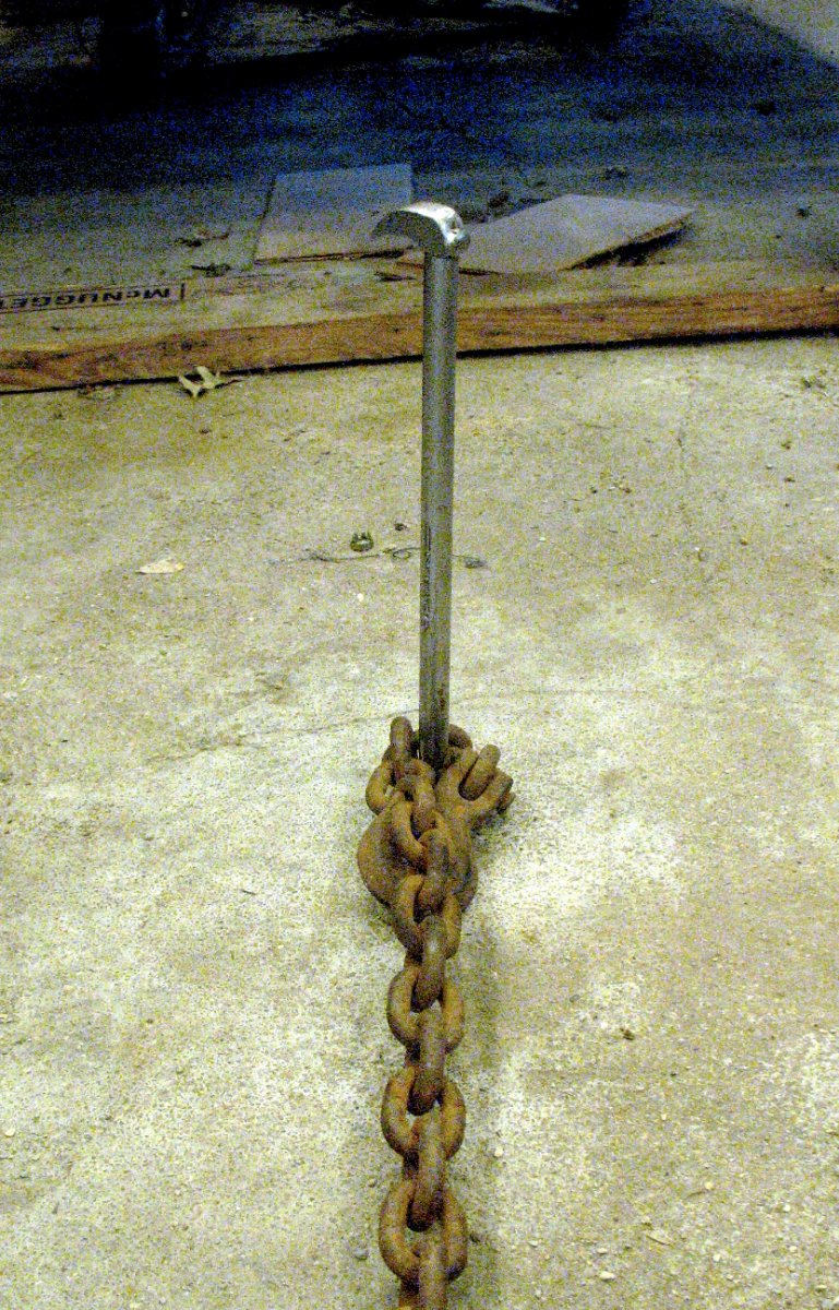

Got it off the trailer and in the shop.
How do you anchor the come-along? Drill a hole.

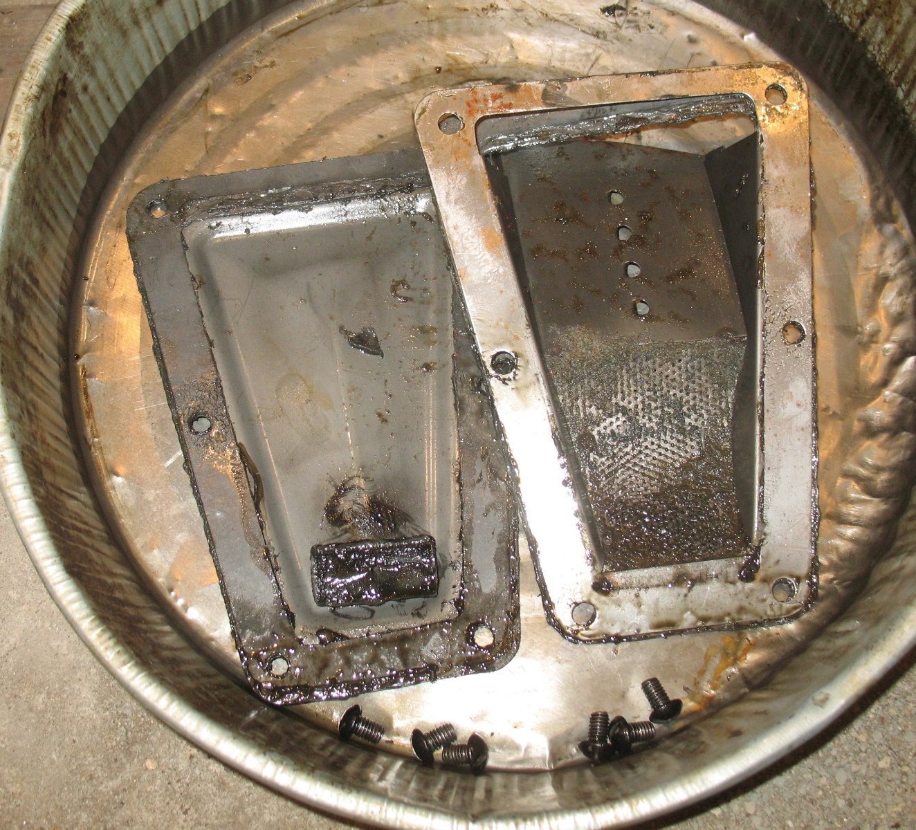

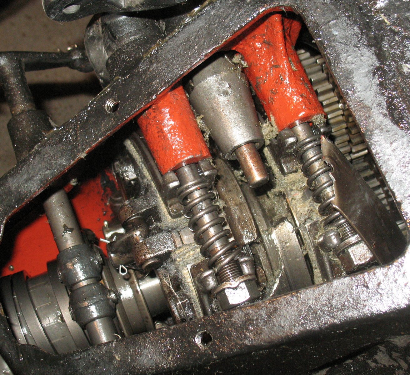

Post by Steve Jelf » Sat Jul 27, 2019 1:08 am
Houston, we have a problem.

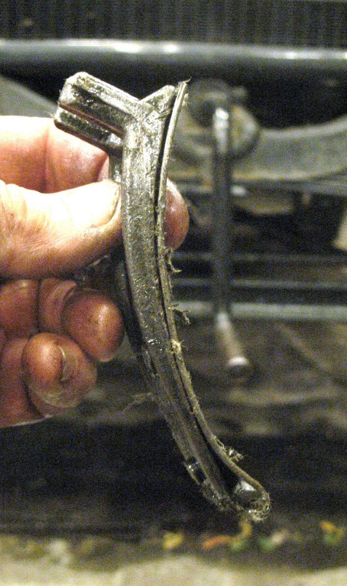

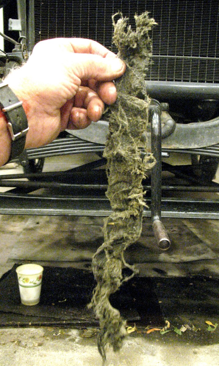

I was expecting a lot more lining fuzz in the oil screen...
...but most of the lining stayed in one mangled piece.
Here's one end of the low band.
The rest of the band is still stuck in there. That's it over the reverse spring. Meanwhile, it seems some of our drum is missing.
It's Bill

Ugh. I hope that wasn't the new engine. Looks like we should add the bands to items that should be magnafluxed during a rebuild. Good luck! Cheers, Bill

You think the drum let go and took the band with it?

That is a real bummer. I have suffered broken drums like that four times... Until I stopped using Kevlar linings. I feel that there are only two kinds of Kevlar drivers, those who have broken a drum and those who will. Too bad you have changed categories!
I hope you have a replacement low drum. This might be a good time to explore the wonderful world of wooden band liners!
My ’27 is down also. I made a dumb mistake and wiped a rod bearing. Close inspection shows enough problems to rate an engine swap... Hopefully the original block will go back in to mine.
Best luck, TH[\size]
Posts: 6797
Re: "The best laid schemes of mice an' men...
Post by Allan » Sat Jul 27, 2019 8:47 am
Steve, are you suggesting that a cracked drum may have been shredding the lining somewhat, causing the need for the frequent adjustments? I would then expect more fuzz. From the photo of your stopping place I presume you were in top gear, and thus the band was not even engaged. It reall is a puzzle.
Best wishes with the re-build.

It is quite common for a broken drum to let go even when it is not in use by it's band.
I once backed out of my drive only to loose the drum about six blocks later.
Steve's drum was toast back just before he noticed it started needing low band adjustments. That tow may have accelerated the catastrophic failure but the drum was already destroyed. Steve just waited until the band joined the drum.
My take is Steve overheated his low drum and cracked it some time ago. It finally flew apart on the road trip.
Magnafluxing the band wouldn't help anything since the problem was the broken drum. (IMHO the Kevlar liner was the cause of the problem.)

I suspect that the drum had been cracked for quite some time before it went to pieces, and that the crack had been attacking the lining, pulling it loose rivet by rivet. That would explain the repeated need for adjustment. With the lining gone the cracked drum attacked the bare metal band. When the band went the free piece jammed against the cracked drum and broke it. That's one theory of how it went. It will be interesting to see what else I find when I get it all apart.

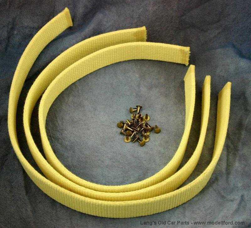

Just to be clear- those are Kevlar linings, correct?
Posts: 6558
Post by Scott_Conger » Sat Jul 27, 2019 5:52 pm
Steve
Typically a cracked drum will feel very mushy underfoot and will lint up the screen very fast. Your lack of lint in the screen and symptoms of having to constantly tighten low band and yet no linting, and a broken band to boot, makes me wonder if in fact you had a cracked/broken band for a good while until it finally became two pieces and camed under the pedal boss and broke the drum.
Very sorry to see you sidelined by this.
Posts: 6797
Post by Allan » Sat Jul 27, 2019 9:05 pm
Scott, that was my reading too. Little lint, so no gradual scraping away at the lining by a cracked drum. Just a monumental let go and ensuing shredding in one big piece. It had to be a sudden failure to be able to bust the band as it did.
