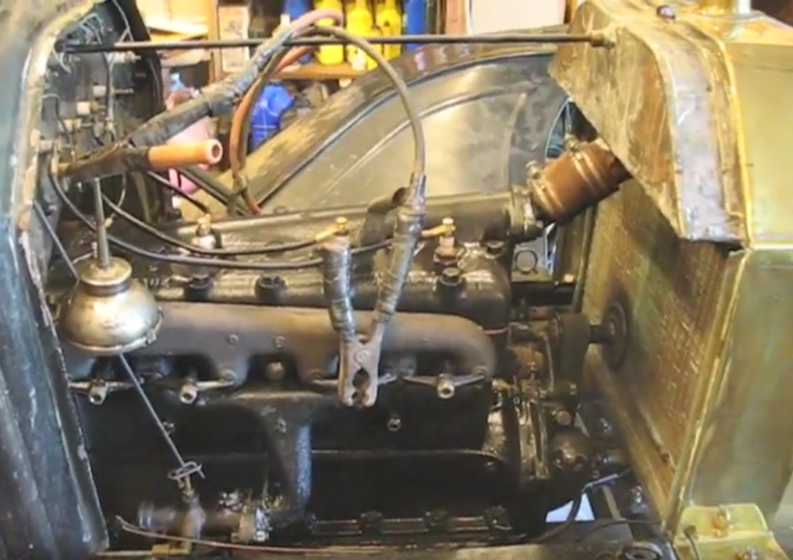

I was working up a sweat with lots of crank pulling yesterday. I got about a half dozen false starts. The engine would run a second or two and die. So this morning I removed the NH to check it out. I found the float setting was ½". I have no idea why I would have done such a thing, but I reset it to ¼", put the carb back on the car, and started it up. When I installed the crank pulley I thought it was OK, but the clatter says I need a better one.

Congratulations! What's up with the jumper cables?
Topic author - Posts: 7403
Re: Fresh engine first start
It was mighty stiff at first, but even after running only about an hour and a half it's pulling easier. The car battery wouldn't hold a charge, so I started with a separate battery. It will start on MAG when warm now, but it will need to loosen up a bit more to start easily without the battery.
