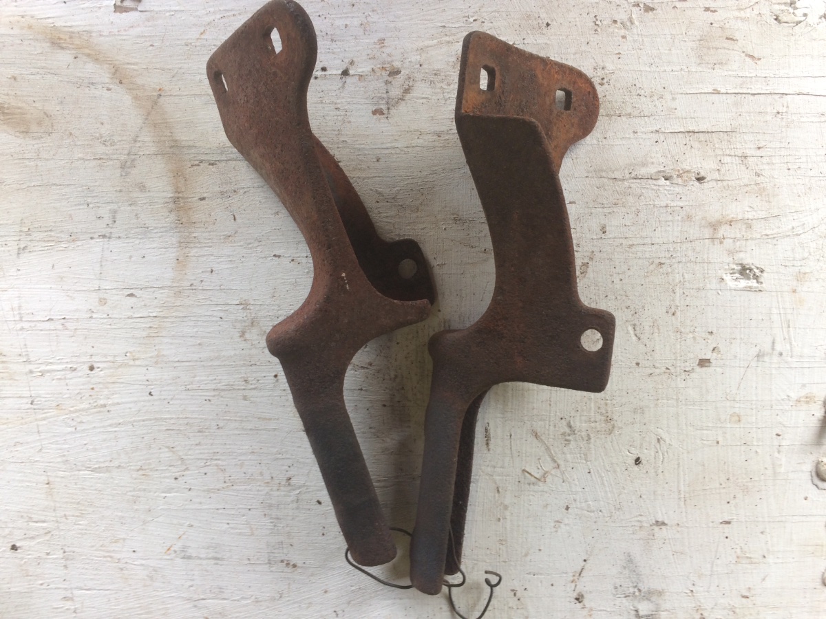

Was going to mount the oil lamps I bought and realized my cowl lamp brackets apparently are not right for a 1922 Touring. If I used them the side lights would not point straight forward - they would shine off to the sides of the car. Looking at Lang's I see what looks like the same brackets I have, but they indicate the bracket is for 1923 and up. Any idea what type of bracket I would need for a '22? I did receive the following from the person I bought my lights from:

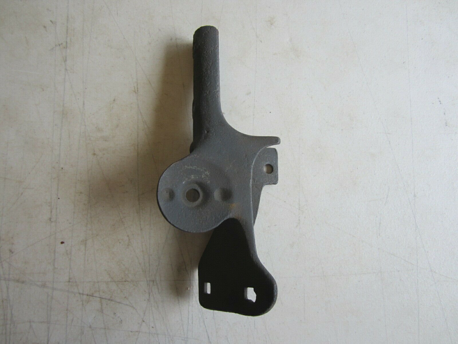

I'm quite sure that the cowl lamp mounts for a '22 Touring were integral with the w.s. mounts - does your w.s. stand straight up or tipped back a bit ?

Post by George House » Tue Aug 20, 2019 3:40 pm
Steve is right .....mostly. From ‘19-‘22 There were actually 2 different lower windshield brackets. When a starter and generator were included on a T there was no cowl lamp brackets. When no ‘electrics’ were on the Ford engine these years cowl Lamps were added and their mounting brackets were cast integrally with the lower windshield brackets

I "borrowed" this photo off Ebay to show what the correct bracket for a '22 "non-starter" (how's that George ?) car would sport.

RajoRacer wrote:
Tue Aug 20, 2019 2:37 pm
Hello - the windshield stands straight up and down.

RajoRacer wrote:
Tue Aug 20, 2019 6:48 pm
Darn. Mine has a starter so I suppose it would not be "correct" to mount a pair of oil lamps on it. I just love the look of them though :D

Mark; in a previous post in this thread the OP said “the windshield stands straight up and down”. Doesn’t that lead you to believe it’s an early to ‘22 Windshield? Granted, we need pictures of it at this time but your catalog picture would be leading him astray. That bracket is for s ‘23-‘25 T. I feel what he has is like the pic I’ve invluded of a non pair:

Post by Mark Gregush » Wed Aug 21, 2019 10:07 pm
The holes are the same 1915-1925 that the brackets would bolt to. Both the straight and slant windshield, the lower mounting holes are about 2" center to center. Using those brackets would put the lights lower then the ones with the cast in brackets. Except for the thickness of material both the 1915-22 and 23-25 mount the same. I wonder how may open cars out there have the wrong windshield on them?
