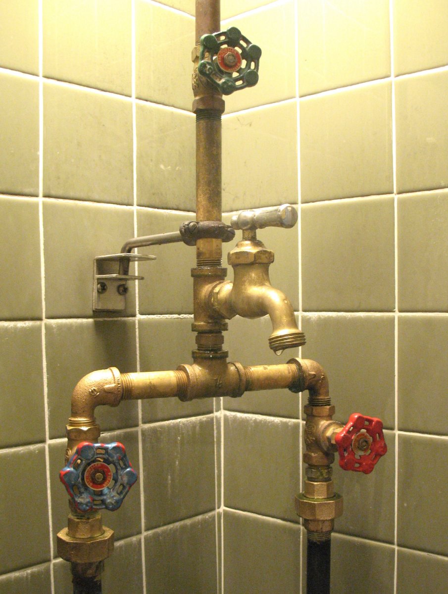

Hard water lime deposits were building up on my shower plumbing, so I sprayed on CLR.
I found that it not only took off the lime, but also removed the tarnish.

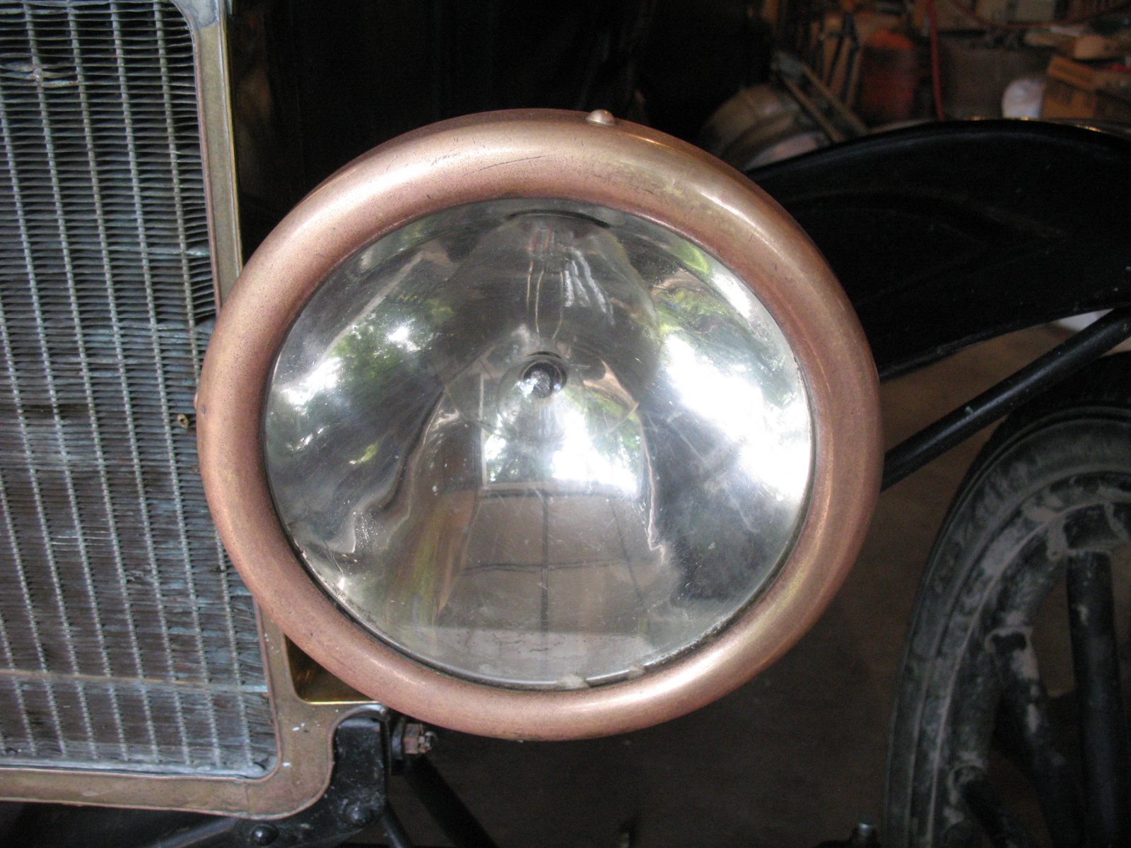

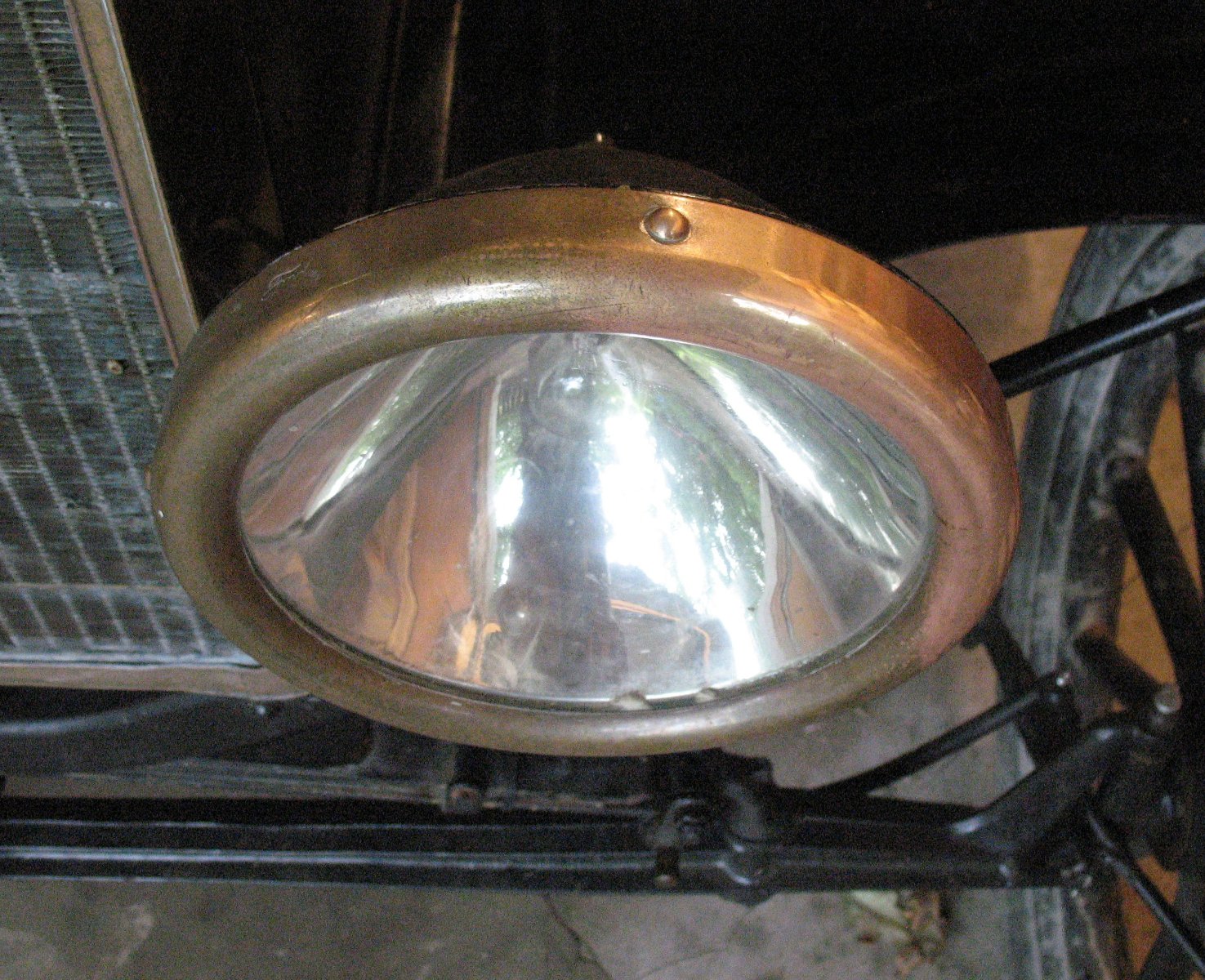

So this morning I tried it on a headlight rim. Nice! After attacking the tarnish with CLR, polishing will be a LOT less work. :)

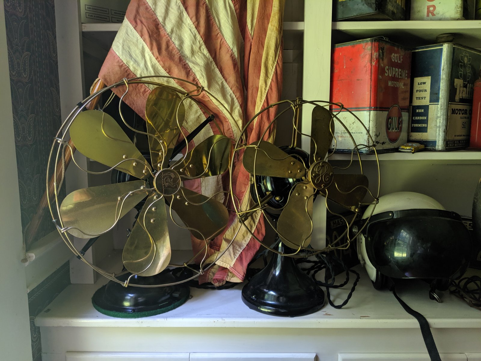

I used Lysol toilet bowl cleaner diluted in a bowl of hot water, with 0000 steel wool on some old brass fans I collected. It has to be the original liquid formula in the white and blue bottle, and don't let it sit too long on the brass or it will turn red. Be sure to wash the part well with warm water after scrubbing. This process leaves a nice starting surface for polishing.
I cleaned and polished the left fan a few years back. Right one I left alone.

I should have timed this. A little cloth dipped in CLR rubbed the tarnish away in under three minutes.
I did time this. With the tarnish removed, polishing with Mother's took five minutes.
You may count me a happy camper.

Steve
from the color the brass turned, has me wondering if it hasn't been left with a copper-rich surface after the CLR stripped out the zinc. I do not know this for certain, as I do not know how either lactic acid or gluconic acid react to zinc, but I personally would not use this solution to clean brass on a regular basis until I understood the chemistry of it.

...would not use this solution to clean brass on a regular basis until I understood the chemistry of it.
I have to confess I know nothing about the chemistry of the stuff, but I've been using it on those brass pipes and fittings in the shower for a few months and don't see that it's done any damage yet.

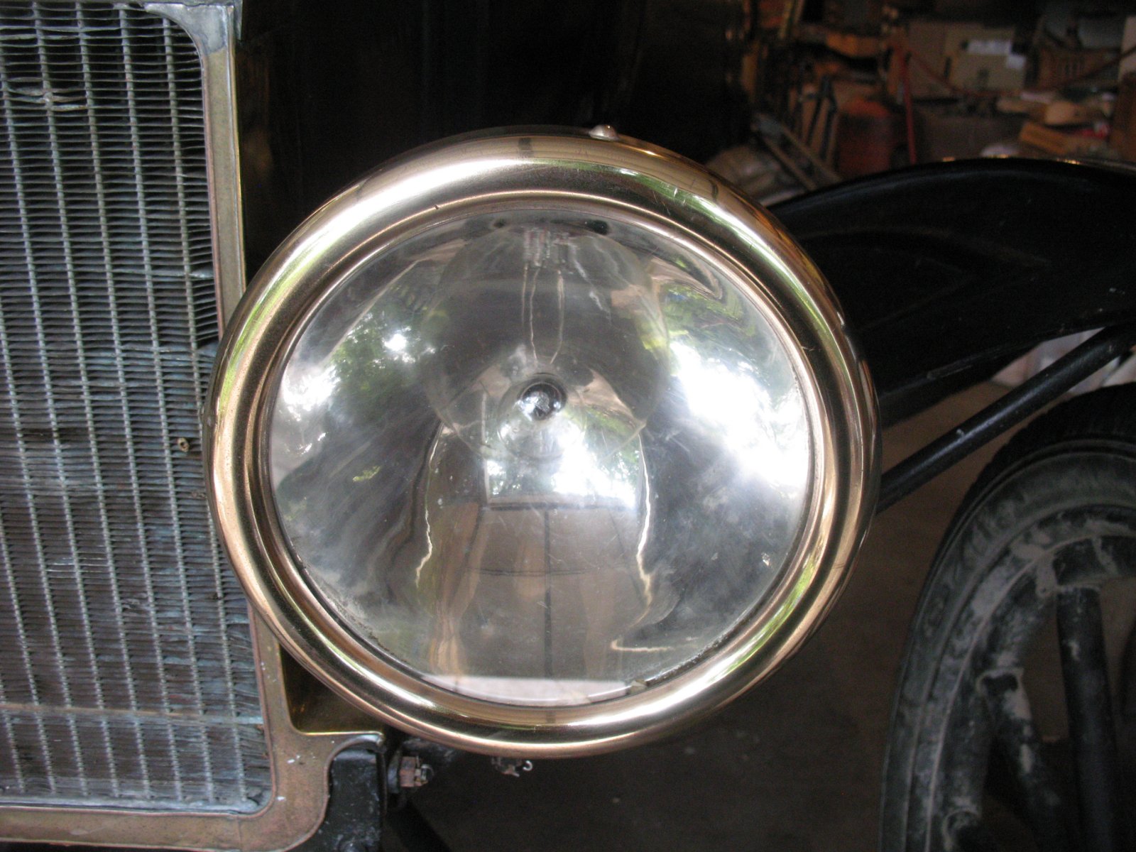

It certainly doesn't take long for Mother's to bring out the normal brass color.

Scott nailed it. Anytime you turn the brass red, you are stripping the zinc out. It would probably never make a difference on thick plumbing parts, but can be deadly on thin brass. Keep up that routine and you’ll be wondering why the brass has age cracks now. There is an old saying, if it sounds too good to be true, it probably is !
