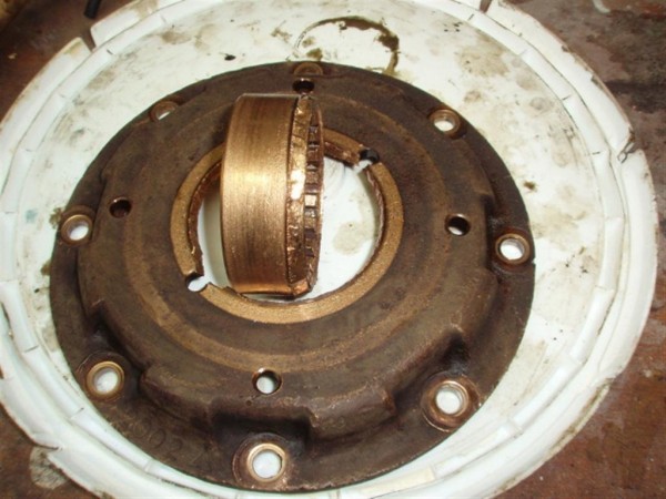

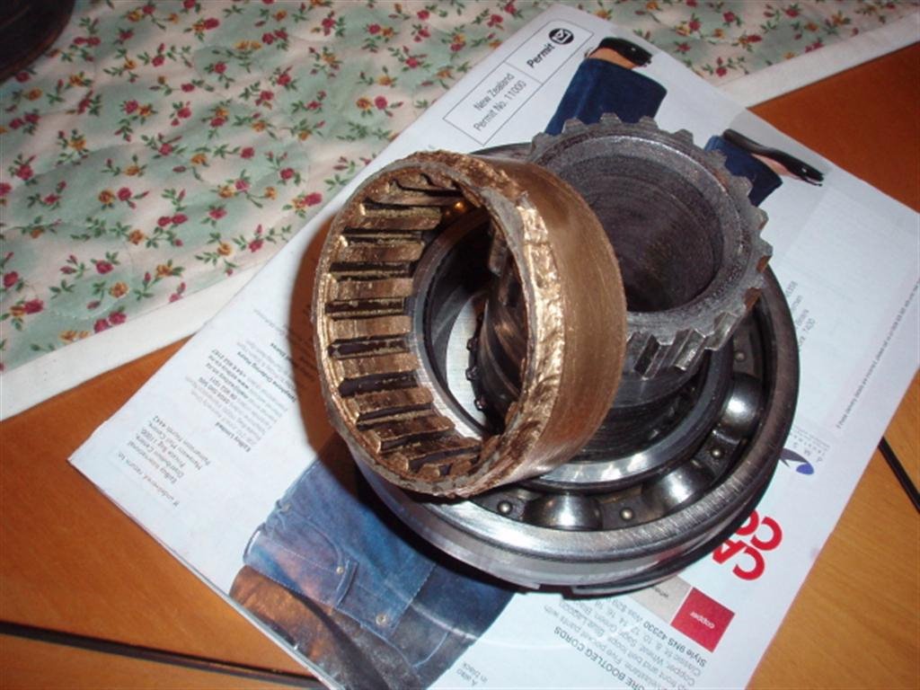

Could be a broken bronze gear casting. That broke on my TT and I had the same problem - no more standard drive, only low.
It also gives a nasty 'neutral' if you shift into standard, no braking either in that case.
Tear down and see if you can replace the casting if possible. It usually cracks near the hub (see picture).
A MUST is to get the MTFCA booklet on Ruckstell rebuild. FOLLOW it carefully and you won't go wrong.

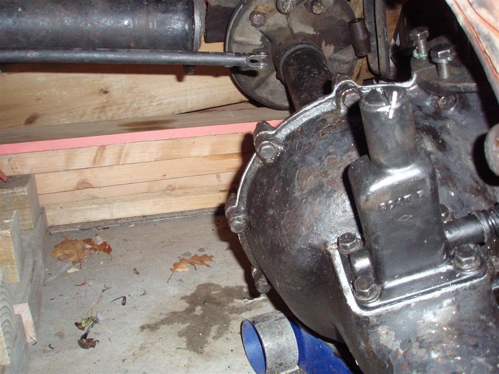

I meant to add, if you have the later long nose shifter, that is a plus. Better spring tension to keep the selector engaged.
