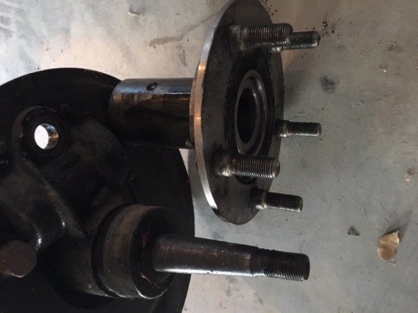

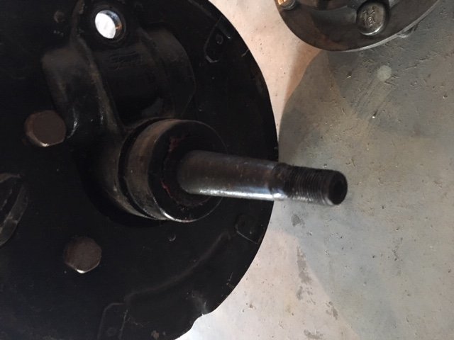

I am the in the process of swapping rear ends. I really hurt my ruckstell.
Long story short. I pick up an original '26-'27 rear end so I can go to the Texas T-party.
Well Now I need some original style rear hubs. See the pictures.
Any idea where I can pick up a set, or does anyone have a picture of what I am really looking for?
Any idea what they might be worth?
Please help I am running out of time.

You could get a set of floating hubs for wire wheels.

That is a front hub, not a rear hub. Rear hubs have brake drums on them.

That is a floating hub. You need a T wire wheel hub to use it. It also requires modification to the housing.

I have plenty of spare hub sets. Let me know if I can help. As others have stated, you will have to cut some off of the tube after removing the Hyatt Bearing. Simple fix and those safety hubs work great.

Found a set of rear hubs.
They should be here on Monday.
I really thought I was stuck between a rock and a hard spot.
