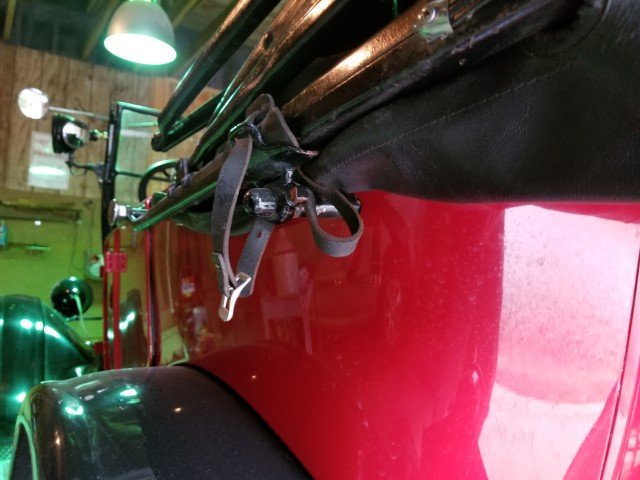

The saddle that my top bows rest on when the top is down is loose. I know there is a nut on it inside but for the life of me simply peeling back the panels I cannot reach that nut to tighten it.
Suggestions? Tricks?

Isn’t a nut inside, only a female thread boss on the metal upright strut. Use a pipe wrench or vice grip pliers to snug the top prop rod.
Appears to me your prop rod has a bullet nose sleeve over the outer end, might be there to increase the rod diameter for earlier saddle, early have 5/8” hole, later 23-27 have 1/2” holes for the later 1/2” prop rod.

You have a ‘26-‘27 touring. That forged saddle should have a 1/2” hole for your “prop rod”.

Hey John - 2 different parts - "top prop rod" threads into a boss on the body support iron as Dan stated - "top saddle" has it's own square head set screw which tightens onto the top prop rod - one or the other is coming from together !

Got it and thanks!
