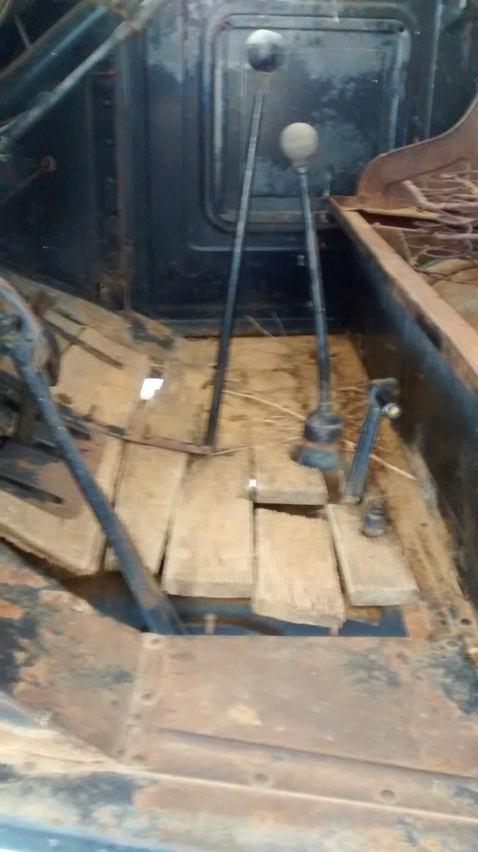

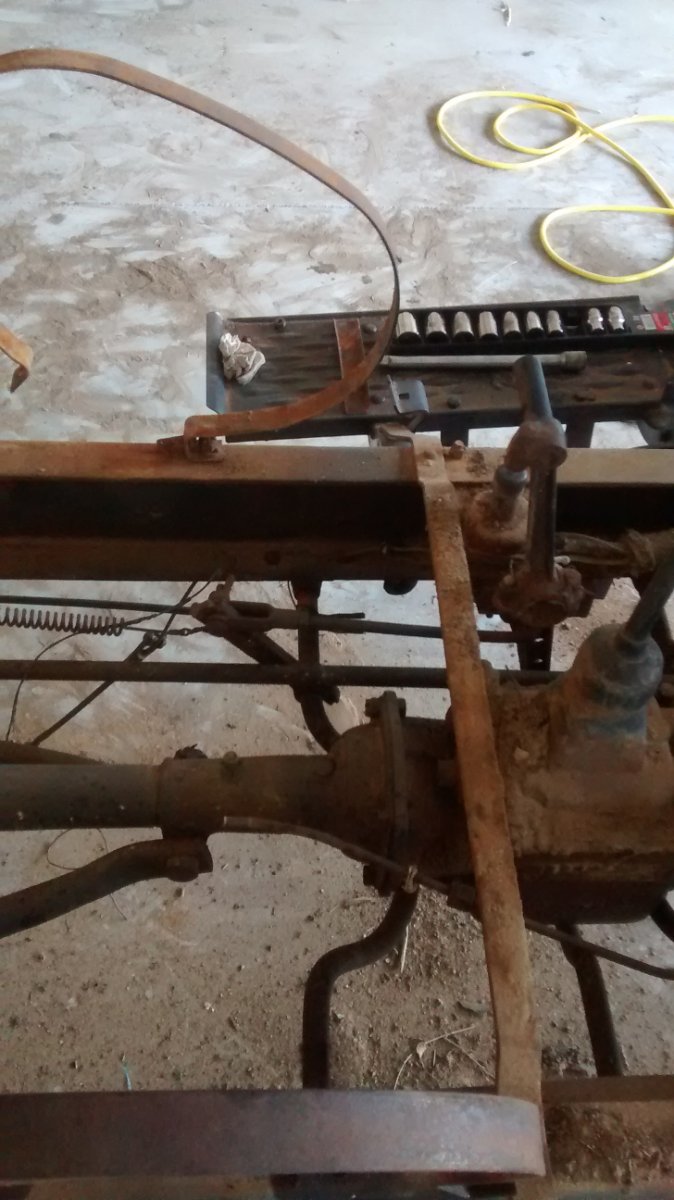

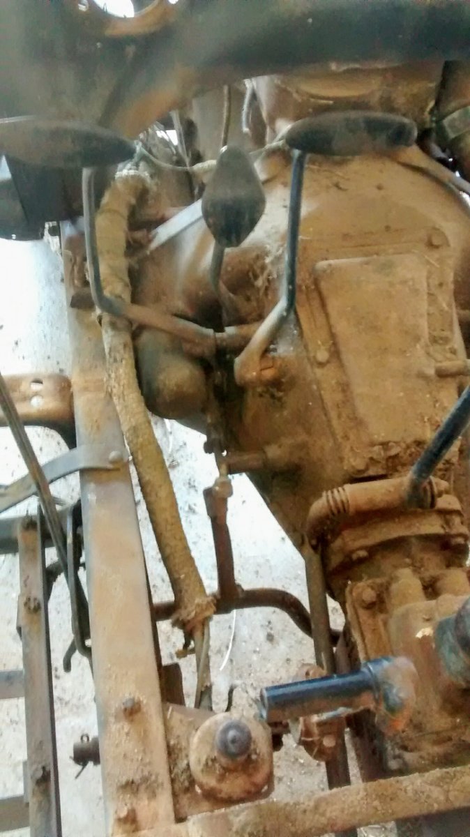

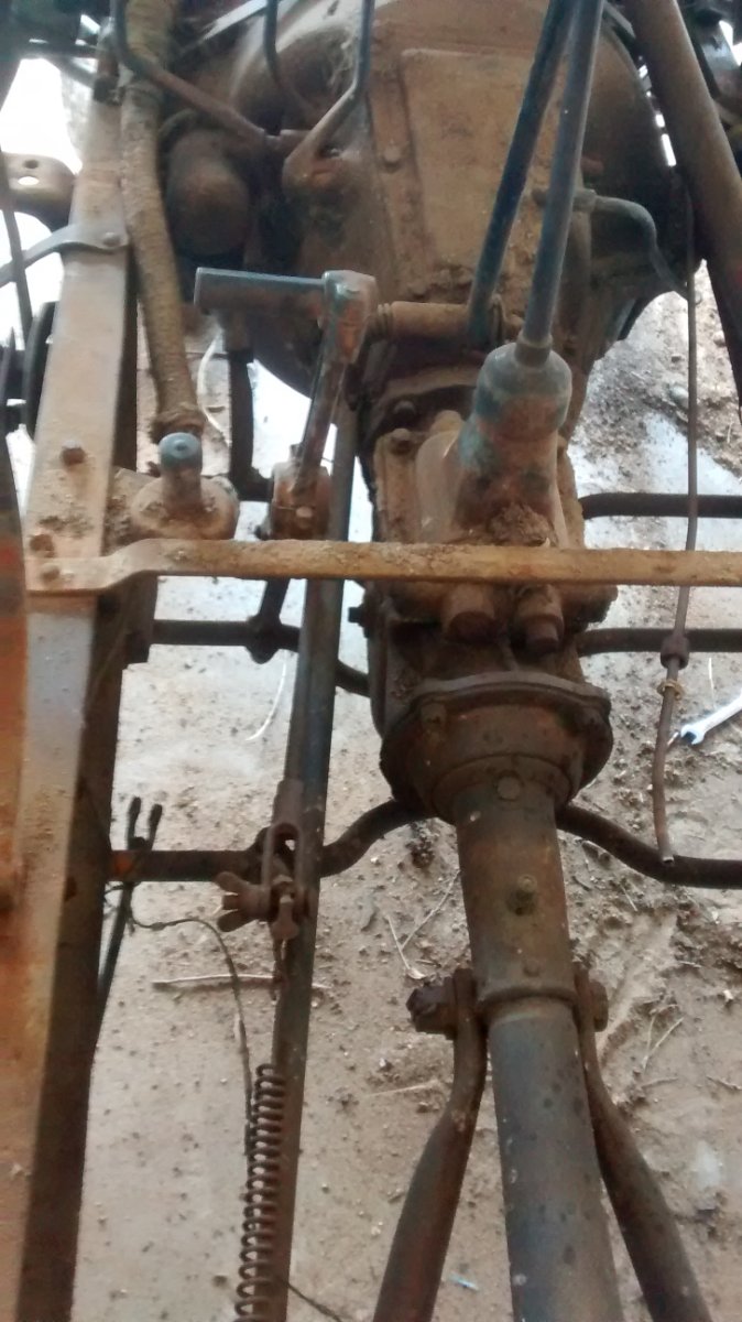

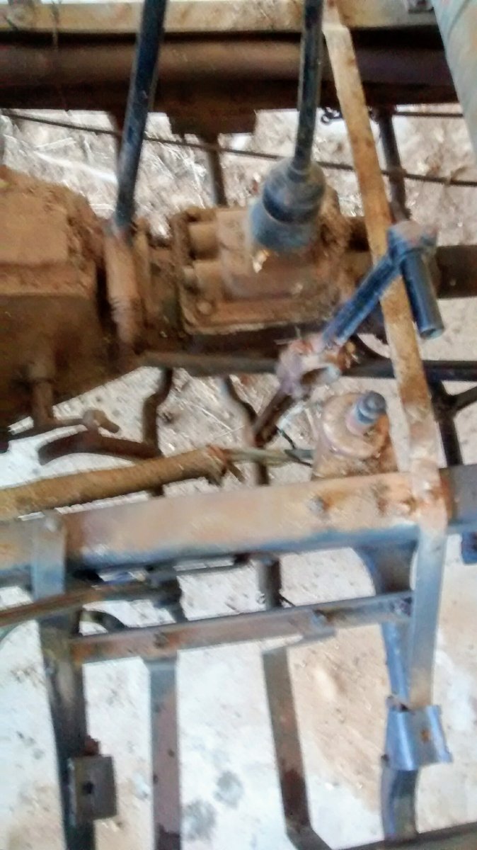

I got the cab off so I could get some deceit pictures of my brake set-up. The hand brake is hooked the front U-shaped thing-a-ma-jig. The middle and rear are hooked together and run by the small black lever (looks homemade). The brake rods and cable weren't connected to any of these. They were just connected to the rear brake levers so I don't know where they go which makes no difference because you guys told me what set-up I really need. The right pedal (which I thought was the brake) isn't hooked to anything. It just goes into the transmission. Does anyone have a picture of standard TT brakes? I will need brake shoes if anyone has some for sale. I think the vendors probably have everything else.

The pedal that goes into the transmission is the transmission brake. Have you pulled the wheels off, do you know it need rear shoes? The rods with the clivices go to the TT rear parking brakes, they would have been hooked to the parking brake cross shaft (the front one). If you have outside brakes, I am guessing they would have been hooked up to the two T connecting rod thingy. Seems it would have been hard to use!! Under the Ruckstell shifting rod I see a link, what does it connect to at the front if anything?
If it were mine, I would pull everything that was not part of the stock Ford brake system off except the outside brakes(?) and cable and start fresh. It is going to take some thinking, but it can be done. I would want to operate the outside brakes off the brake pedal.

It's not easy to tell for sure, but I THINK what you have is:
1. A stock transmission brake.
2. A stock parking/emergency brake (front part - I know the shoes aren't there).
3. An auxiliary brake system that's been "customized" to be activated with the home made lever.
IMHO you should probably:
1. Remove the transmission brake band and pedal (we can help with how to do this).
2. Remove the home made lever assembly.
3. Obtain and install a proper equalizer and linkage and pedal for the auxiliary brakes.
4. Obtain and install rear shoes and associated activation parts.
I know this sounds like a lot, but with a little patience and some Forum help you can get it done!
P.S. The "U-shaped thing-a-ma-jig" is a brake equalizer.

I enlarged the last photo. I see the link I was asking about now. The cables might have connected to the end of the cross shaft, it would be an activator not an equalizer. If you are going to use the cross shaft I would A; use rods and B; connect it to the brake pedal (your would ether need to weld a tab on the bottom or buy one made up), not the T handle. I would not remove the transmission brake band, it holds the shaft in place. Loosen yes maybe, remove no. Looks like the only thing the center cross shaft does is hold the T handle so it would not be needed. Because of the transmission between the engine and rear end, don't think the normal equalizer setup sold will work, but there are ways. Going back to the pedal, depending on what way you want to go dictates where the tab is mounted for the link. For the cross shaft as it is now, bottom to push. Many torque tube mounted equalizers would have the tab mounted above the center line of the pedal to pull. Google "mtfca; outside brakes" or ""(for examples). There are many ideas out there. While most are for cars, TT's are about the same.
I see now that shoes are missing, added a link;
