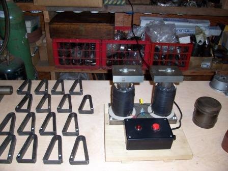

- Posts: 5591
Re: charging magnets off flywheel
Or, make one of these.

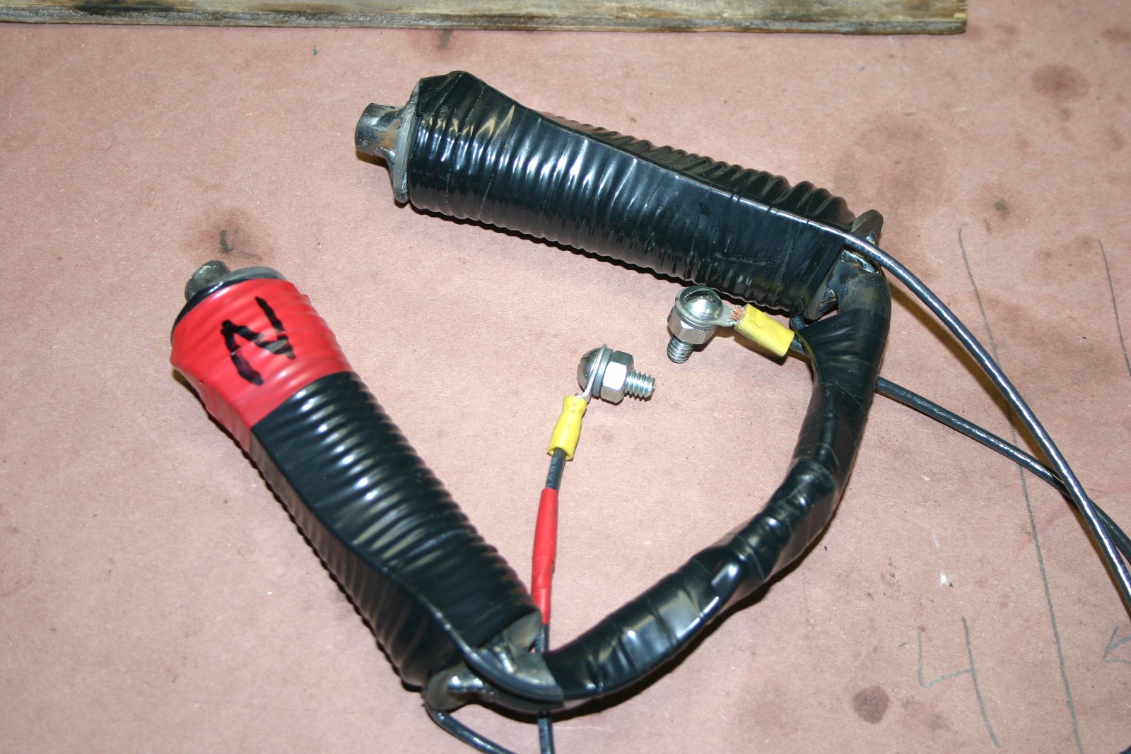

To efectively magnetize a piece of iron, you need to force as much magnetic flux thru it as possible and make an abrupt change in that flux. Magnetic flux is produced by ampere turns. This means high current thru a lot of turns in a coil. The other important item is to reduce the magnetic resistance of your magnetic circuit. Your magnetizer has to fit snugly to the ends of the Model T magnet, very little air gap between the two. But the process is relatively forgiving. If you do a search of the forum you will find many different approaches and they all seem to work. Testing the magnets will give you an idea of how good your magnetizer is. A charged magnet should easily pick up 3-4 pounds of iron. One additional point, closely inspect each one of your magnets for cracks. A cracked magnet will magnetize, maybe not fully, but could look good enough, yet may break once inside your engine causing a lot of damage. Anyway, here is what I use. Good Luck Mike

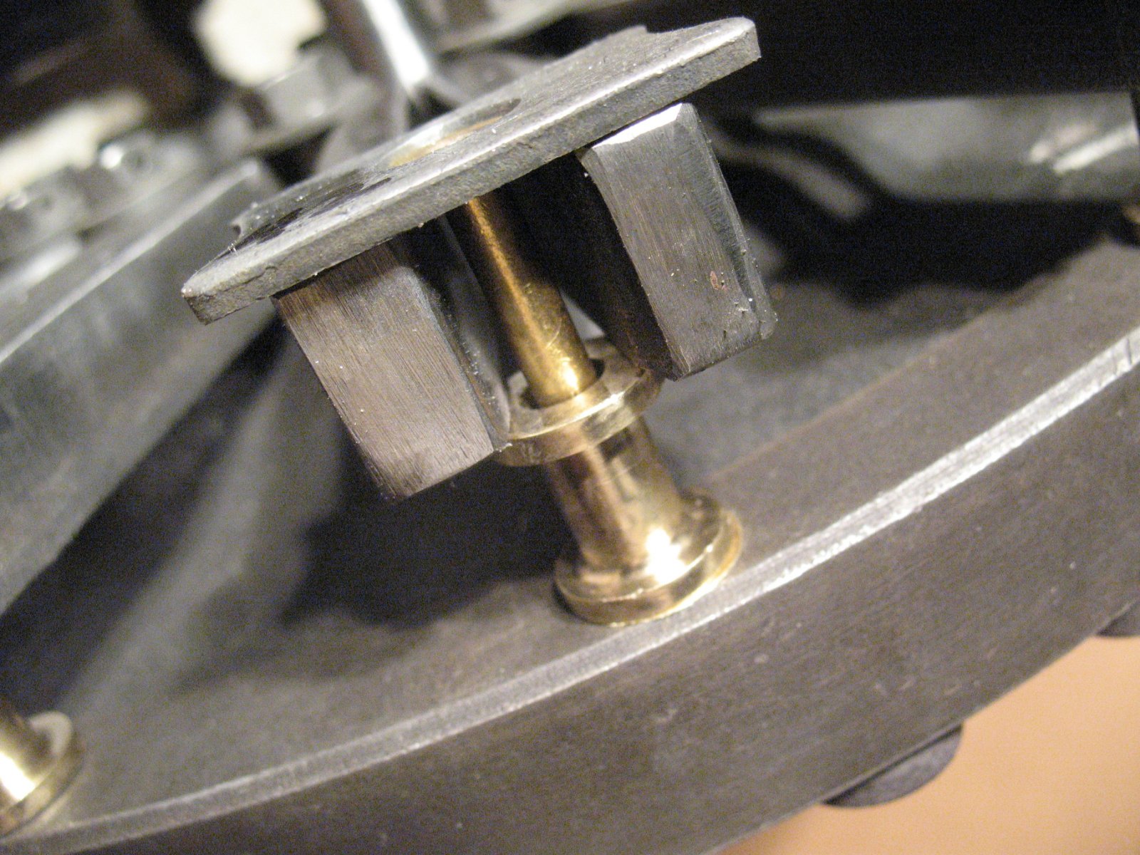

Magnets should be charged after mounting them. Pounding on the magnets with a hammer to set magnet height tends to reduce the charge..
- Posts: 7411
