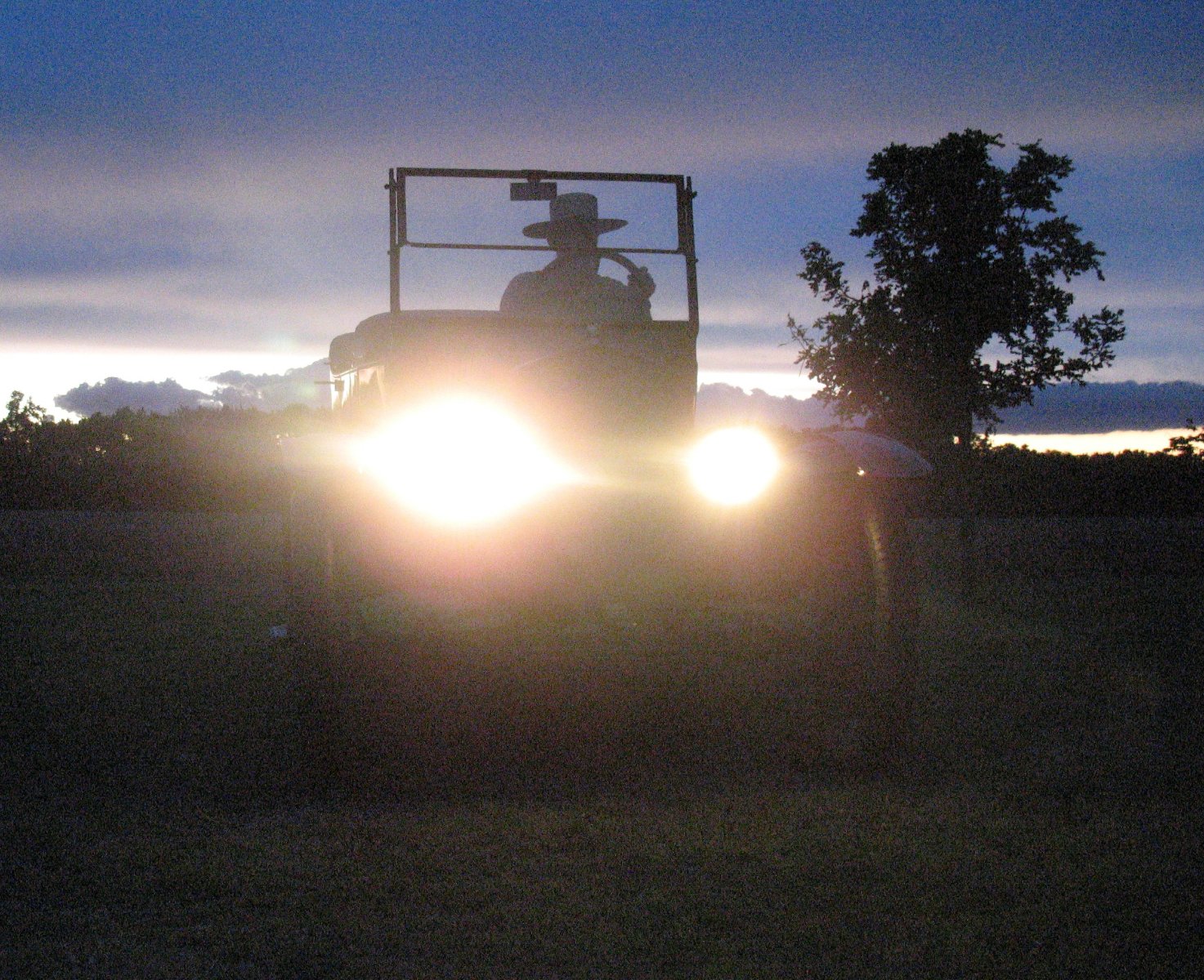

The new Led headlight bulbs being marketed for the model T. Make it possible to have daytime running lights without straining the Ts electrical system since the 55 watt equivalent Led bulb only draws 1 amp for the pair of headlights. and on low the draw is practically nothing but plenty bright for being seen. On Magneto cars a small deer feeder battery will power it for up to 7 hrs and You will probably need gas before they go dead. on My generator car You can just barley see the amp meter move on bright/high. I tried both and prefer the round led 55 watt. The wedge shaped 75 watt bulb produces a funny looking U or C pattern depending on which sockets are in Your car OEM or reproductions.

I just leave my headlights on. They're mag lights, so they're on whenever the car is running. No battery involved.
Magneto lights are fine for running lights and for driving at night in town where there are plenty of street lights, but not good enough for dark country roads.
