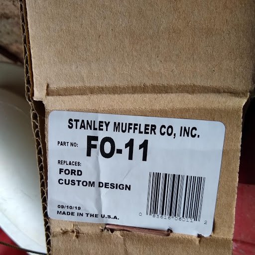

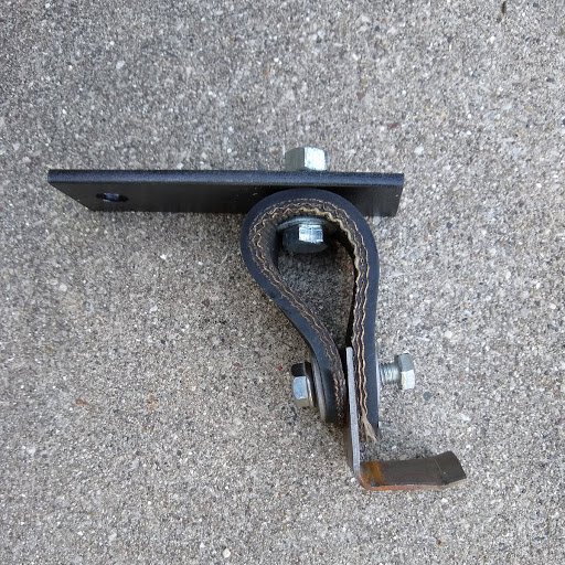

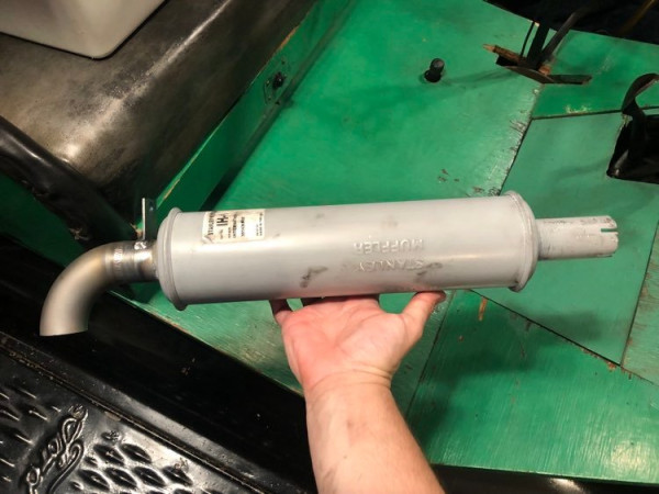

As some of you know I had Muffler troubles on my way to OCF. Dallas helped with a temporary repair, but I decided to go with a different tractor muffler. I purchased the Stanley muffler FO-11 and a tail pipe and a new hanger.

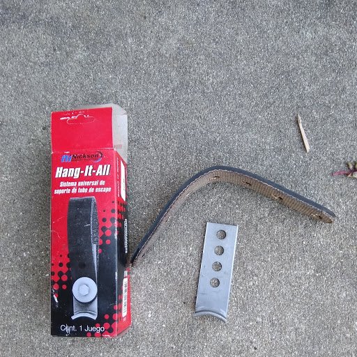

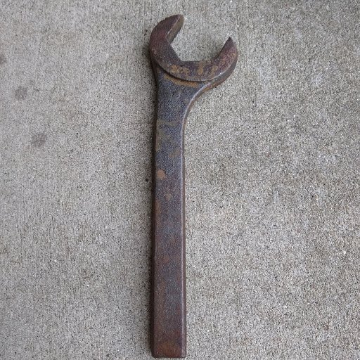

Dallas and I modified the hanger but cutting off part of the rubber material, since it was too long, and cutting off some of the metal from the piece that attaches to the muffler. Hopefully that is clear in picture #4.
Next step is to find out where to hand the muffler from. Remember that the muffler is not clamped on to the exhaust pipe, so the hanger is the only place of attachment.

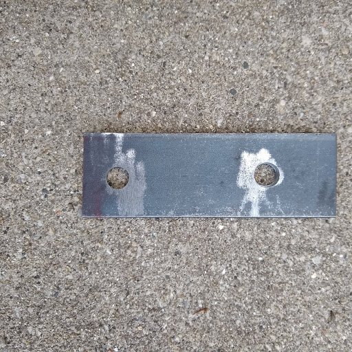

This hole is too far to the left so I needed a piece of metal to hold the hanger. I cut off a piece of steel 4.5 inches long and 1.5 inches wide. This I had to drill two holes in.

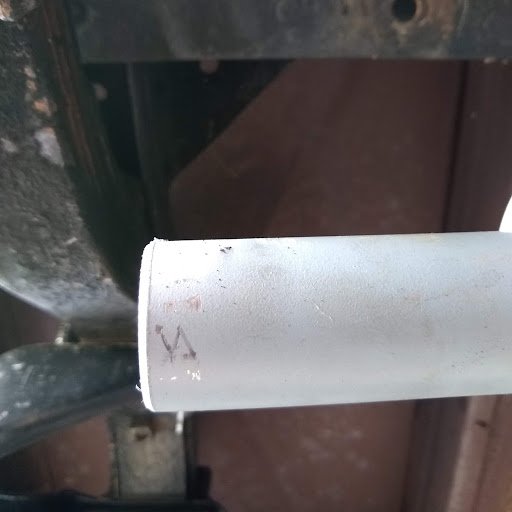

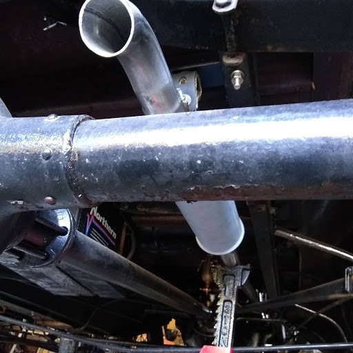

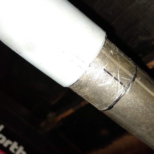

I placed the muffler on the exhaust pipe so I could note how far the muffler goes on. I marked it with a sharpie. This is where the muffler and exhaust pipe flex.
Next I attached the hanger to the metal piece, and then attached that to the frame. I put the exhast pipe in place and attached that to the exhaust manifold with the nut. This was put on loosely. I also used a floor jack to hold the exhaust pipe in place, because it will bounce off the floor if you do not. Now I could line everything up and put the muffler on the exhaust pipe. It fit perfectly and the hanger was in the right place.

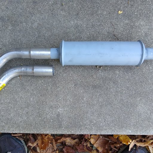

You do not need a tail pipe, but I have a spare tire in back so I added a tail pipe. It was $9 at NAPA for item #41733. It was longer than I needed so I cut it off where the item number tag started, so about 4 inches. Looks better that way too.

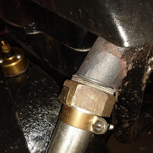

Now everything was lined up and I could tighten the clamps. First I tightened the nut on the manifold. It is worth spending the money to purchase this tool. I have needed it more than once. And even though I get it nice and tight I have had the nut loosen. I strongly recommend the clamp with the tag to hold your exhaust nut in place.

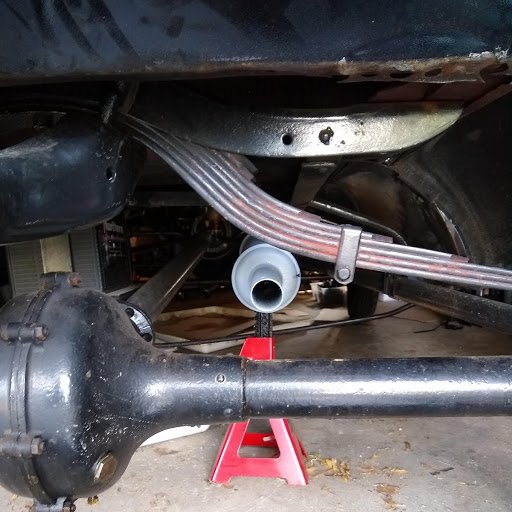

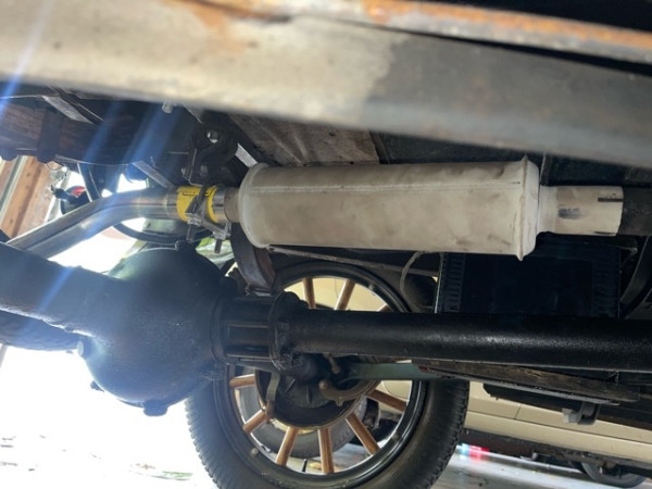

This next picture shows the entire assembly put together and held up with the jack stand.

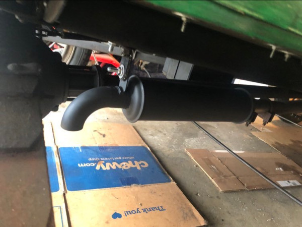

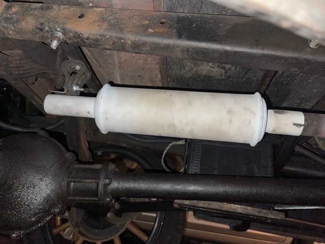

Ok, so I’m putting the FO11 muffler on. No clamp going on between the exhaust pipe and muffler inlet (for flex). The exhaust pipe slides all the way into the muffler with ease.
Tailpipe is on order, should have it tomorrow. Then I’ll clamp that part up.

Bob
If you could turn that bracket around so it attaches closer to the engine it will support the muffler better.
Supporting on the very end allows the muffler and exhaust pipe to flex too much where they come together. A bit floppy if you understand what I am trying to explain.

Yes I see what you mean - Sounds like a good idea. I wasn’t sure which way it should face. Since I don’t have the tailpipe yet, I wasn’t sure how far it slides onto the muffler outlet.
I should invest in one of those pack nut things too….

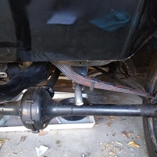

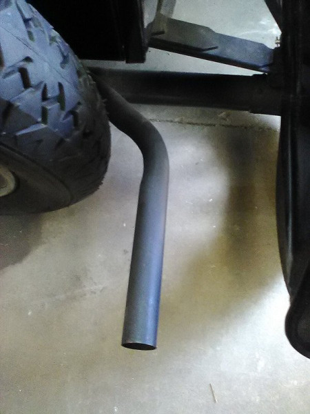

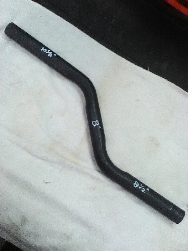

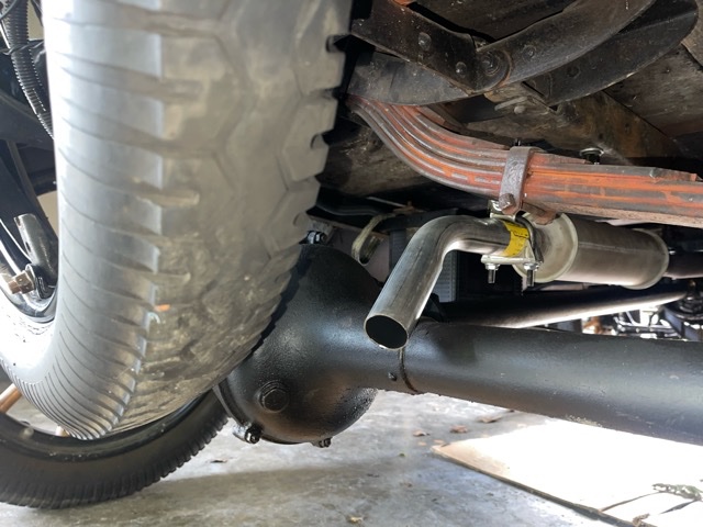

I came up with an exhaust pipe that keeps the exhaust fumes totally away from the spare. Reader’s Digest version here: I bought a ten foot long piece of inch and a half exhaust pipe for about $15. I cut off a piece about three feet long and had a muffler shop put two 45º bends in it. By trial and error I arrived at a tail pipe as pictured. Respective measurements are: from one end to middle of bend is ~ 8.5”; from the other end to the middle of bend is ~ 10.5”; center section is ~ 8” long. Once the dimensions were worked out I got the muffler shop to make up several more, keeping one in reserve for a future pattern. Our ’22 touring, ’24 roadster, and ’27 coupé all now sport one. Prior to installing I wiped them down with some brake clean and applied a couple of coats of high temp paint which has held up surprisingly well. You might consider mocking the exhaust pipe up out of inch and a half PVC and I’ll leave the mounting engineering up to the individual. Should there be any questions I’ll do my best to answer.
Have a day. Tom in Taylor Mill, KY 41015

Got it all hooked up this morning. Not visible but I turned the bracket around as advised
Quite a bit louder than the other muffler I had but it is quite a bit smaller. Not an unpleasant sound at all.
Thank you for taking the time to make such a detailed description. It helped a lot!

Better view

Is there any support of the tailpipe/muffler assembly between the manifold packnut and the bracket attached to the rear spring?
Your vehicle, but I sure am apprehensive about the longevity of your installation....attaching a bracket to a spring.
Dave

I do not see it attached to the spring, but it does look that way. Just the way the photo is. Looks like it is attached to a cross bracket.

Yes, sorry for the poor photo. The hanger is bolted to the cross bracket. I followed DHort’s suggestions to the letter :-)
I didn’t take the sticker off the tailpipe though :-( Too impatient. I figured it would burn off with time….
