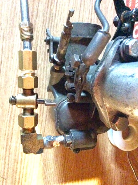

Post by revaz » Fri Jan 25, 2019 9:49 am
I am changing the copper/brass fuel delivery line from tank to carb with a flared steel brake line using brass adapters, couplings, and fittings. Need a consensus/opinion as to whether to use plumbers Teflon tape on the threads. Thanks in advance. Reason for doing so: I’ve had the original lines leak and break from vibration and don’t need this problem when driving across the country in June.

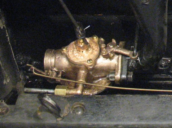

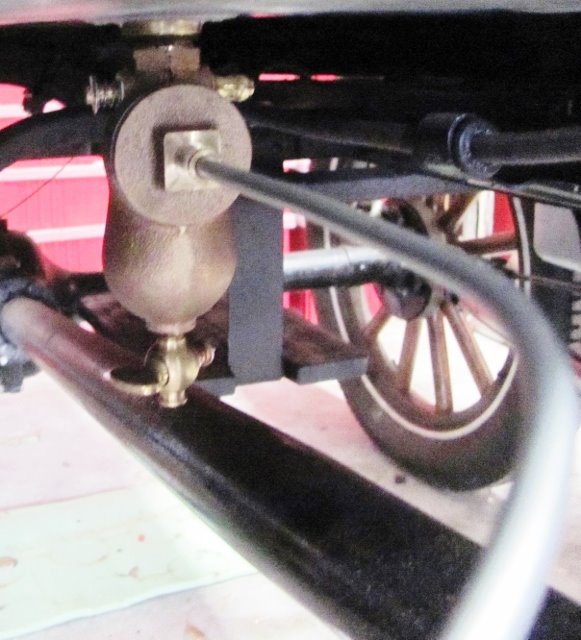

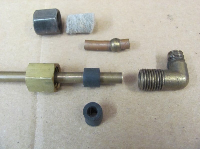

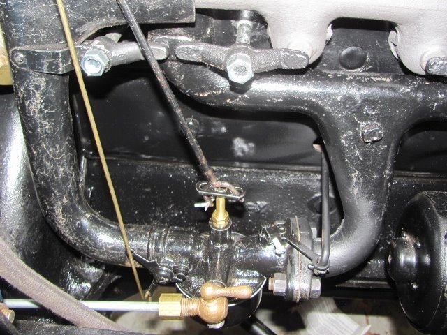

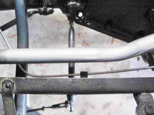

Post by Steve Jelf » Fri Jan 25, 2019 10:11 am
How I do it: Cut off the flares and bend the line to fit. Use the stock Ford 2910 nut and 6154 elbow. Cut off a little piece of fuel hose for a washer. It goes inside the nut. I've used Teflon tape on the elbow where it screws into the carb, but some say that's a no-no.

I've done Steve's recommendation about using a slug of fuel line in place of the felt and it's always worked quite well. As to Teflon as stated it has to be correctly installed or it will lead to trouble. The Permatex sounds good too. The monster problem really is over tightening which can easily happen when using Teflon. Slippery Devil.

I agree with Steve except I couldn't get a rubber fuel line seal to work over time and went back to the original felt seal and have been leak free for 10 years and counting. I have tried many different lines and fittings over the years including modern flare fittings and compression fittings and they all developed a leak over time. A steel brake line with the flare cut off and the original ford nut and felt seal did the trick. I think the problem lies with nothing in the fuel line design to absorb the movement of a engine vibrating and the frame twisting. A modern car has a flexible hose between the engine and fuel line to allow for movement, the model T does not. I think using a modern compression fitting or flare fitting becomes problematic. The felt seal may allow some twisting and protect the fuel line. I do not know why I couldn't get the rubber seal to work for me but had I used fuel valve lube on it it may have worked better.
As to teflon tape, I use it for pipe threads on smaller fittings, for larger fittings like 1/2 or 3/4 pipe threads I use pipe dope. Regardless of tape or dope, keep it on the threads only, if you get it on the edge of the fitting it could work its way through the system and reduce or block something... that was a lesson learned.

Does the felt seal need to be seasoned or coated with anything before assembly?

There are several different outside diameters of 1/4" neoprene fuel line.

Mark, use the felt seal dry.

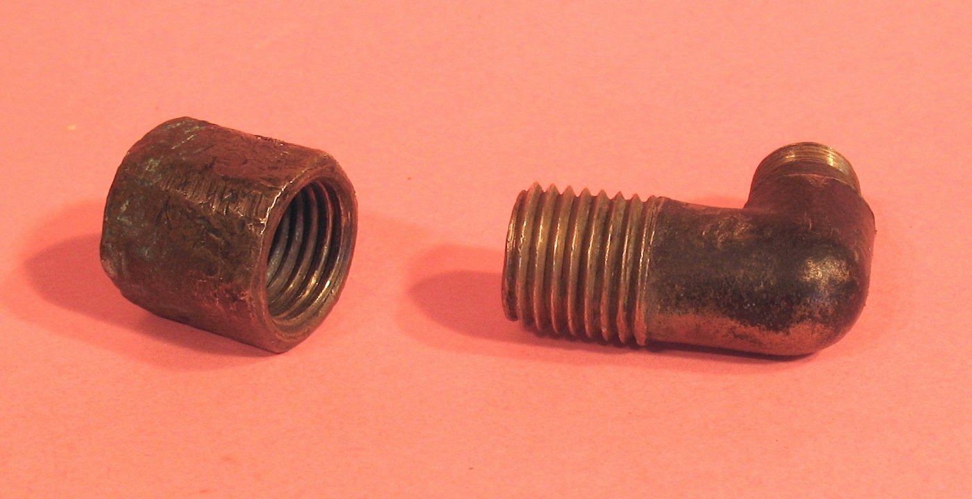

The problem with the fitting isn’t so much will it seal if you tighten it as it is will it be positioned for the fuel line to fit. Cast iron will break if you over tighten a fitting into it but you can cut the threads a little deeper with an 1/8” pipe thread tap carefully so that it will screw in the right amount and face the correct way then use whatever sealer (if any) you want. I did this where I have twist oilers so that the holes for the oil are on top for shackles and forwards on the spindle bolts to make them easier to oil.
As most of use know, pipe fittings are a tapered thread so really "crankin 'er down" will literally cause a wedging action....and split things you don't want to split.
About using an 1/8" pipe tap.... I had to grind the end of the tap, reducing its length, in order to get it in far enough. Otherwise it simply bottoms out in the carb.
Although I've used pipe tape and several kinds of "dope" over the years, I found that that those pipe dope "sticks" in a small cardboard tube work very well. Seals very well without a lot of fuss. It does tend to turn hard after time where it's exposed to the air though.

Revaz, this might be a good candidate for the L shaped shut-off valve that the vendors sell. Would eliminate over half on your connections. Sort of pricey, but when playing with gasoline, would be worth it IMHO.
Posts: 4089
Re: Teflon Tape for Carb Fittings
Post by DanTreace » Sat Jan 26, 2019 5:50 pm
Will
Re-consider the plumbing on your carb....oh my :o :? That's a bunch!
Can't really do wrong with Ford method. Steel lines, large pack nut easy to tighten or remove when needed with the T-1917 tool kit open end wrench.
Add the hi-quality repro shut off too, at the carb. Keeps one from getting under and makes it a snap to drain the carb bowl when the T sits for a couple of weeks, that gas sitting in the bowl compromises the float, hinges, and needle valve.
Stock modified method in center, pack nut, but with modern gasoline tubing neoprene instead of felt, seals the best and reuses time and again. Steel line cut for it to fit fully into the connector, that way you have full support. Plus removal of the line only requires pulling back some, with a slight bend, and the gas line is free. Anchor the gas line to the frame with the Ford clip.
