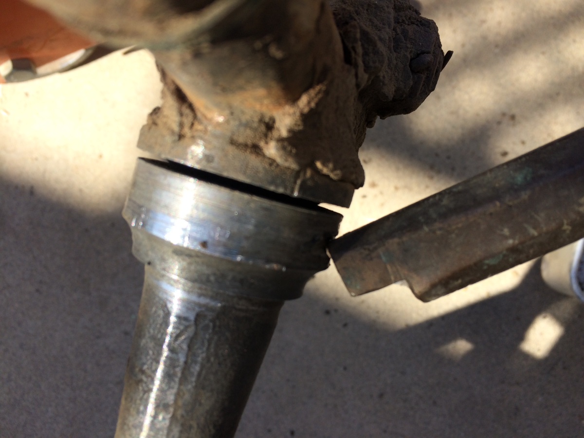

Inner bearing race pressed on spindle?
Is this normal?
Matt
Thanks!Matt

Re: Inner bearing race pressed on spindle?
No...
Maybe you will need a little heat to get it off, but it should slide off.
You might be looking for another spindle

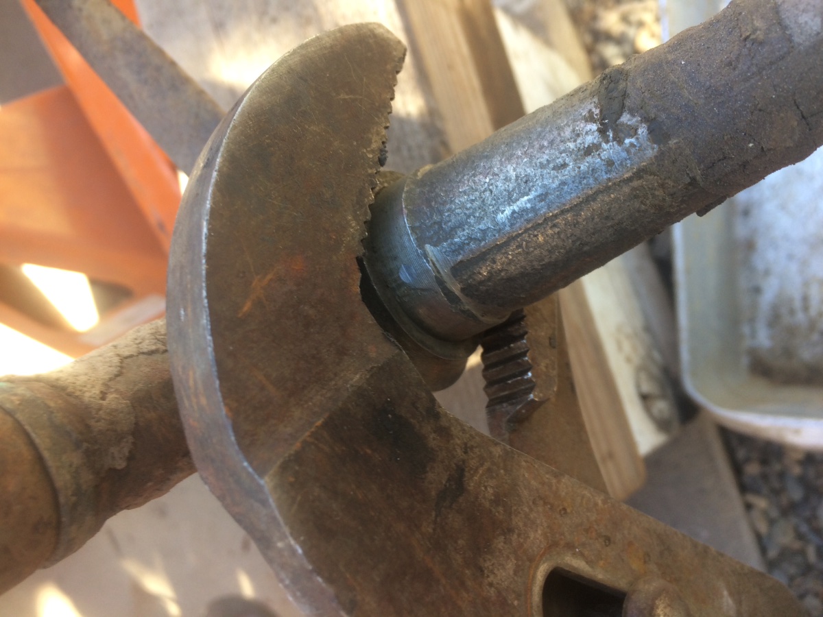

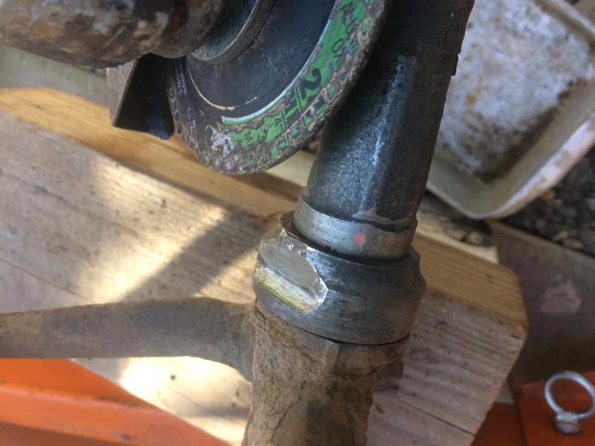

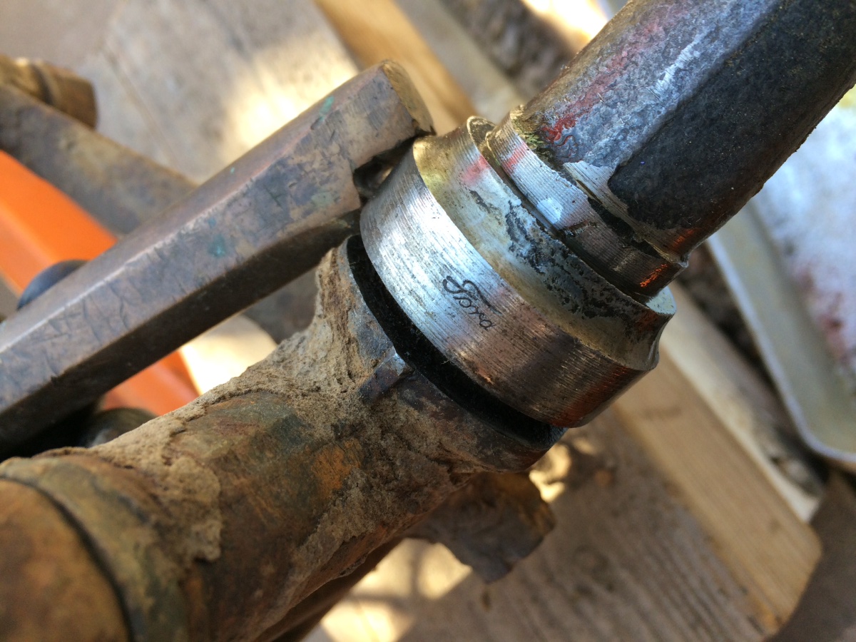

This is what I did:
Heat source- angle grinder. Large monkey wrench was then able to move it... But that didn’t help in getting it off. But I found the flat spots that Steve mentioned. The other spindle did not have flat sides, so it must be an earlier one. I made a notch with the angle grinder. I am using this axle for rollers wheels, not a running car. The funny part was I found that my second old wheel had ball bearings. So I put one bearing race back on. I put light oil on it dirt cleaned off and it slid right on. So dirt must have caused it to bind up.
Thanks for everyone’s help.
Matt
This is what I did:
Matt

Rodger, not sure that would help, nothing really to grab on to and usually heat will do the trick.
Matt, don’t feel so bad, the second set of pics shows the bearing surface of the race was pretty badly pitted...I wouldn’t use it.
