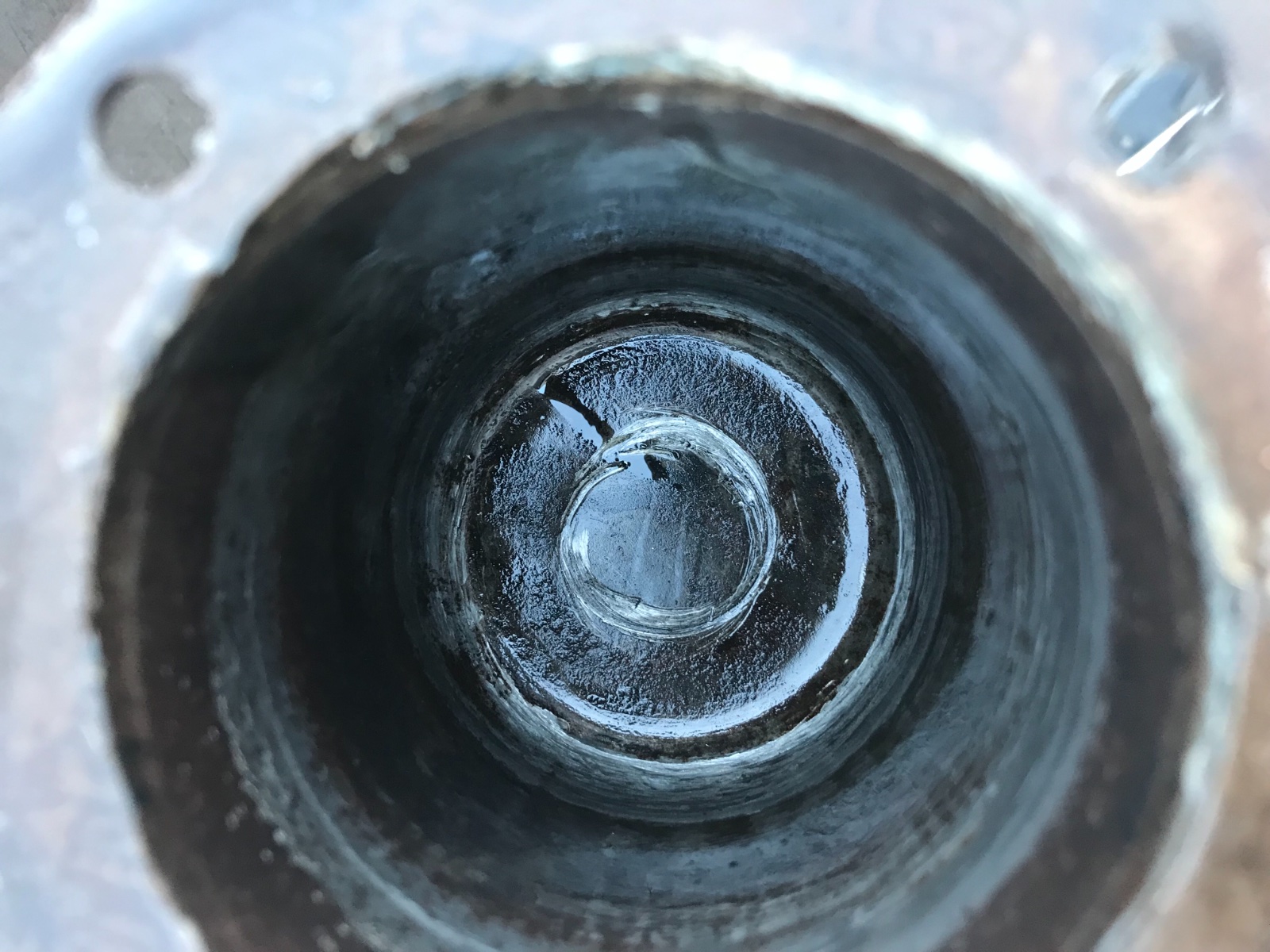

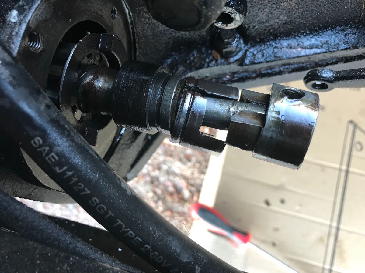

Re: Dodged a bullet yesterday.
A couple of photos of findings. The bolts were were sorta still in place along with the spring. The cover was keeping it sorta together. [/size]
Pull the starter and rotate the flywheel to see what kind of parts are stuck to the magnets.
Looks like you hit Lucky 7’s. 7 beers, 7 hours sleep, and about $7.00 in repairs (used parts of course)!
