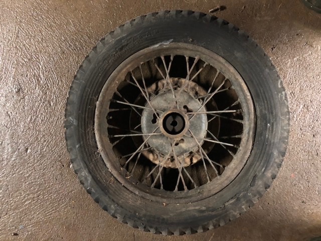

I have looked at various ways to fit 5 stud wire wheels to my 6 bolt wood wheel hubs but getting the wheel centre to rest on the hub nose is the bit that I haven't worked out successfully. I always come to the conclusion that it would be better to make new 6 lug wheel centres and lace them up to suitable rims, which seems like re-inventing the wheel like McLaren Wheels have done .. beyond my purse, but I would love a set. 8-)
I have also looked at just using a simple adapter plate and running Austin Seven (late model) 3 lug wheels which come in useful sizes for available vintage tyres here in the UK. Fine for a lightweight speedster but maybe not so good for a full bodied car.
