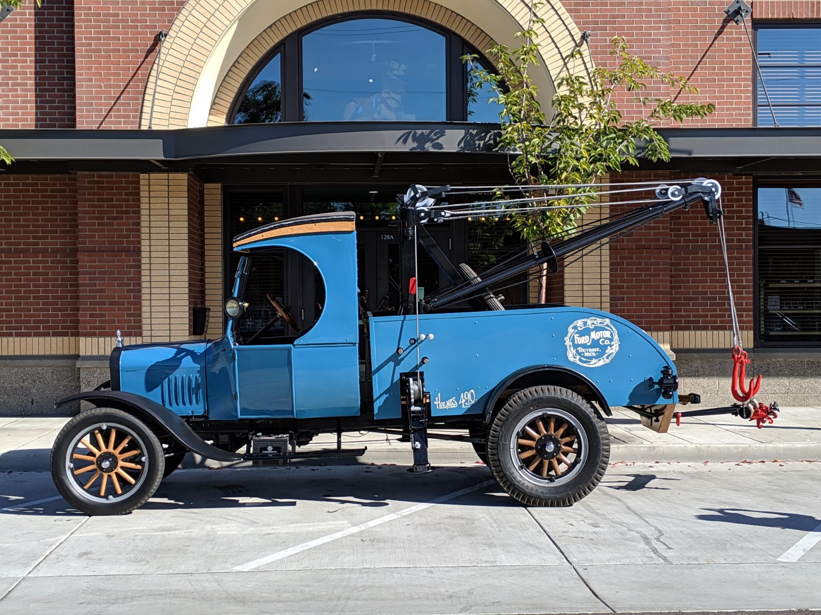

The trucks are fun. Find a theme and build it out. We built a tow truck.

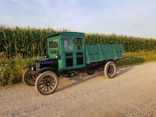

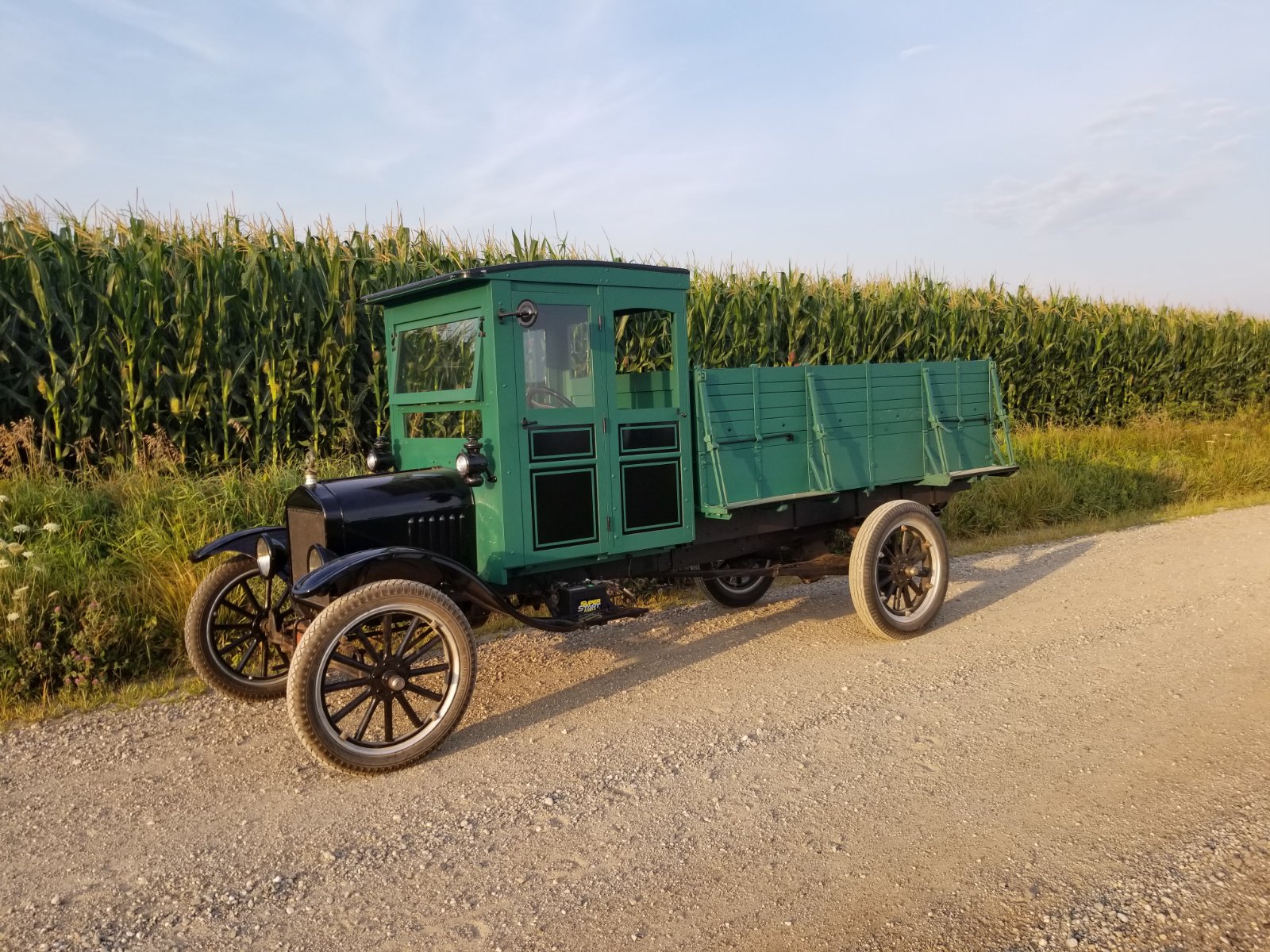

My wood cab TT with 32x4 1/2 tires out back, 9 ft wood bed and wood cab tops out about 40mph. Very stock rebuilt engine 5:1 gears in the rear and Chicago 3 speed. 20-25 is where I run it cause it
" feels right". Pretty heavy rig with all new wood and large bed. Dont use overdrive much as she whines and I dont need the speed unless running with those fast DB cars my buddy has. Done a few car games at OCF and decided it was too fast for the slow race and to slow for the fast race!

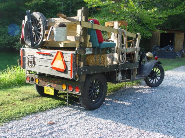

Same here - high speed Ruckstell w/3speed Warford - cruise pretty easy at 35mph but I do have large external brakes also.
- Attachments
- grandpa's truck0001.jpg (28.24 KiB) Viewed 6961 times

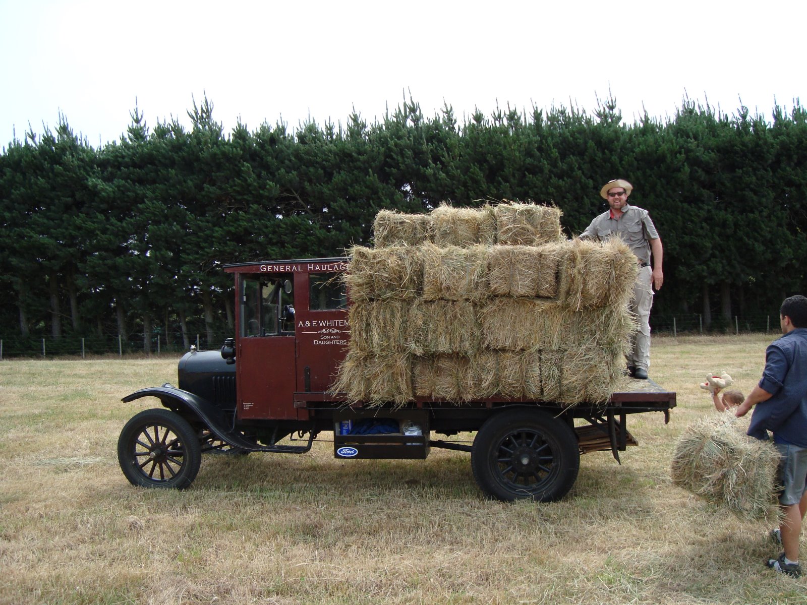

Noooo.Bone stock we have been told some topped out at 25 mph.
This is more like it, maybe a mile or two faster if your engine/trans/drive train are 'balanced'.My first TT was stock with 7:1 rear and had a top speed of 17 mph, just like it was designed to have. Driveshaft whip and vibration were bad over 17 mph.
That is a good point, each truck will have a 'sweet spot' where both it and you 'feel right'. You will find that by driving. Its not just gearing and brakes that matter, but state of your steering (loose? slop?), tyres, springs (stiff? rusted?), shackles (worn? tight?) etc. These all add up to 'feel' and safety.20-25 is where I run it cause it " feels right".
My truck has a Model AA (A truck) underdrive unit (which is made by Ruckstell by the way) installed 180 degrees around so it works as an over drive. I can get 45 plus down hill with a tail wind BUT after that experience my hair went white......
Probably 30 to 35 is the optimal cruising speed for an auxiliary gearbox equipped TT with a high ratio diff set and 17 to 20 (ish) for a standard low ratio rear set and no aux-box.
Plan ahead when it comes to stopping!
If you have an aux-box installed BEWARE - you probably have a neutral with it which means NO BRAKES if you get stuck in neutral UNLESS you fit auxiliary external brakes like Rocky Mountains or a disc brake set. Not a bad idea in today's traffic anyway, but it does highlight the 'knock on' effect of one change requiring further upgrades for safety.
