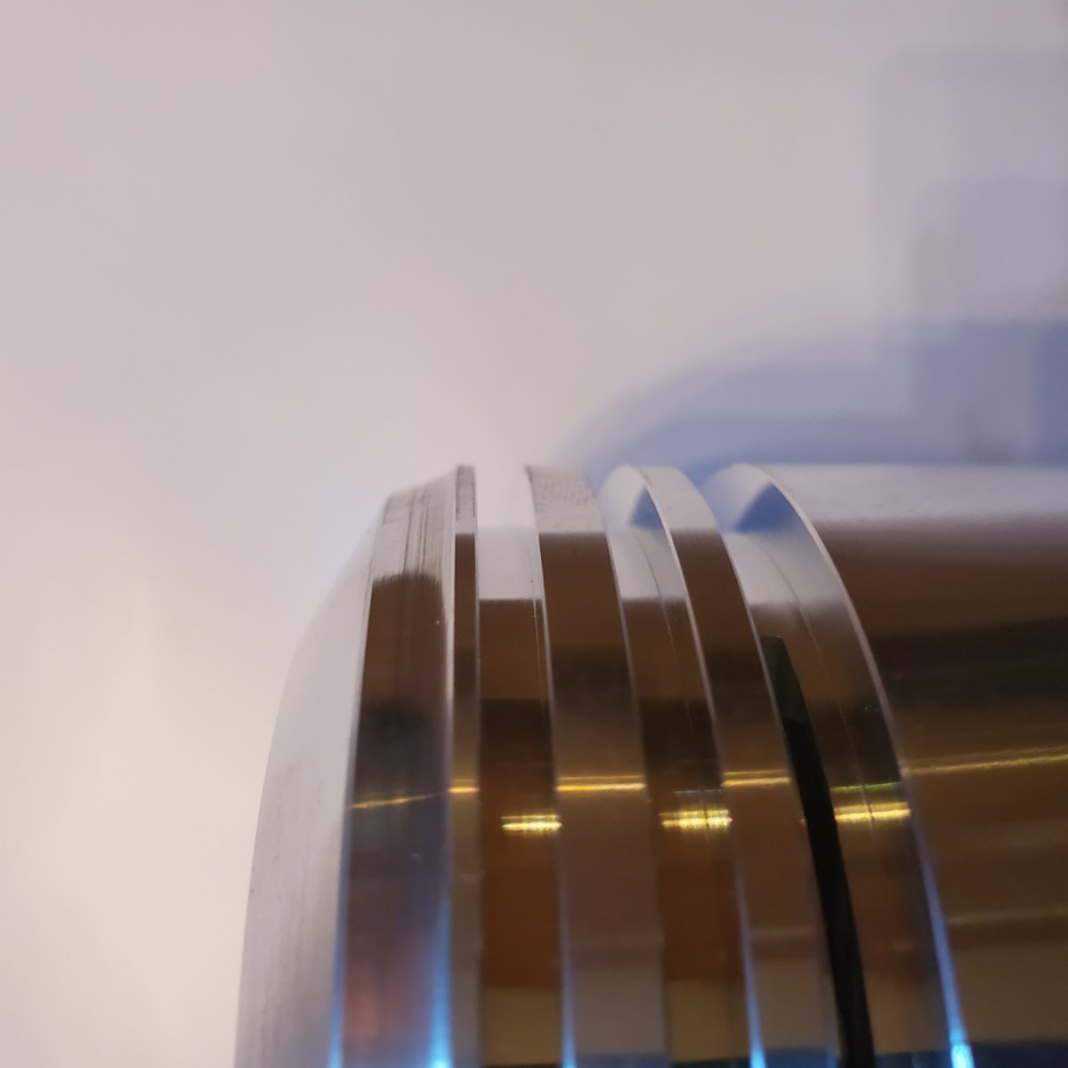

Thanks for the feedback Walt. I think I'll cut a relief in the pistons. I have a set of 20 oversize that has a relief cut just above the top ring to avoid the situation I have, ie the top edge hitting the head. Can't understand why the 80 OS
I am using isn't the same. Here's a photo of the 20 OS.

Snyder's year ago fixed the relief in the pistons hitting head or head gasket from the relief in the pistons, I would look for marks that are shiny will tell you what is happening. I really hate going over .060 on bores! Just my thoughts!

Thanks for the thoughts fellas. Joe, come to think of it, the 20 thou OS pistons with the relief were purchased from Synders. The 80 OS were not. Agree with you Scott and Walt about re necessity of turning the engine over w/o the head gasket before final installation. Lesson learned. Actually this is the first time I've used 80 OS pistons. Never had a clearance issue before. But then this car has given me a host of new problems and challenges.

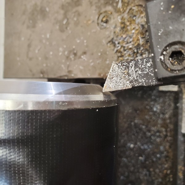

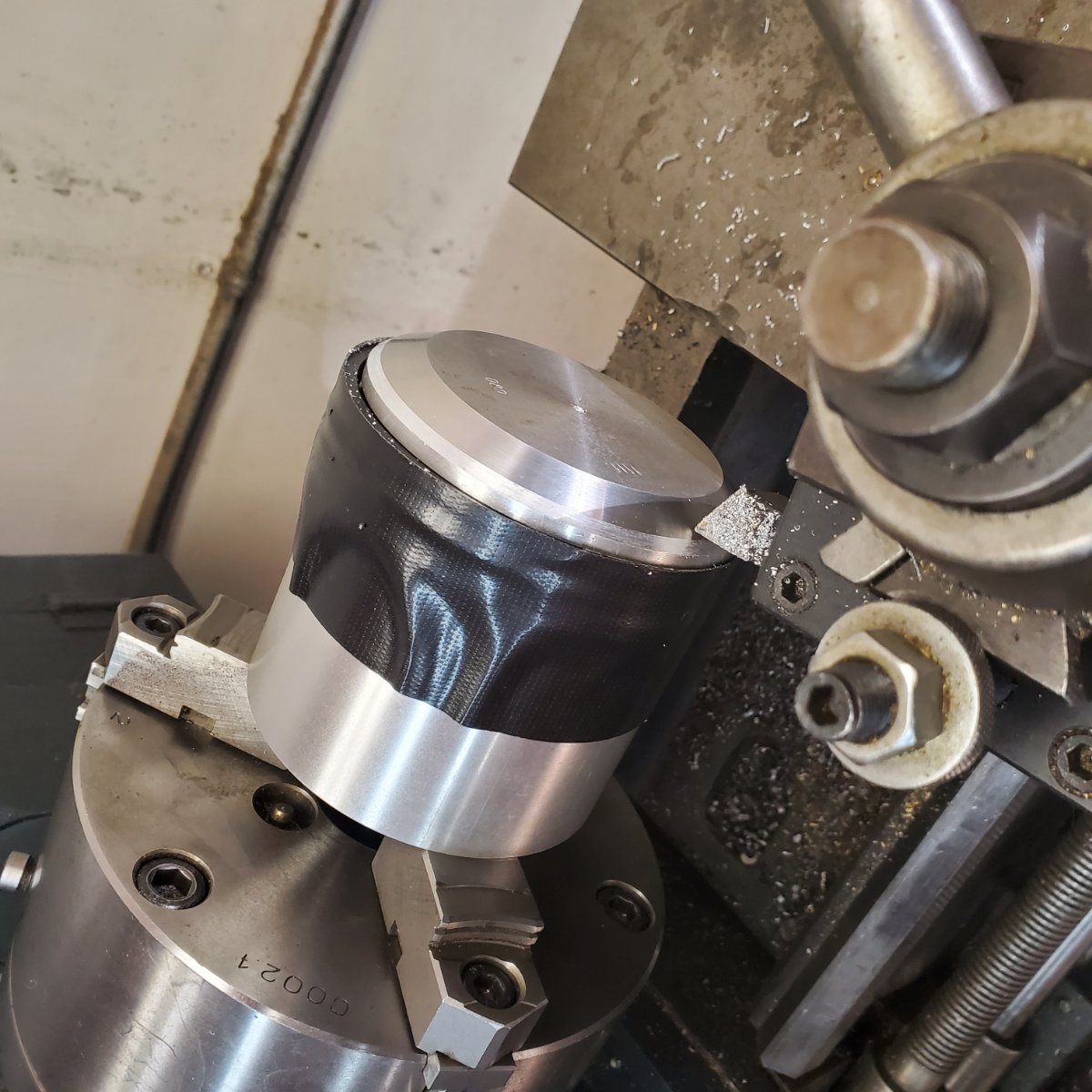

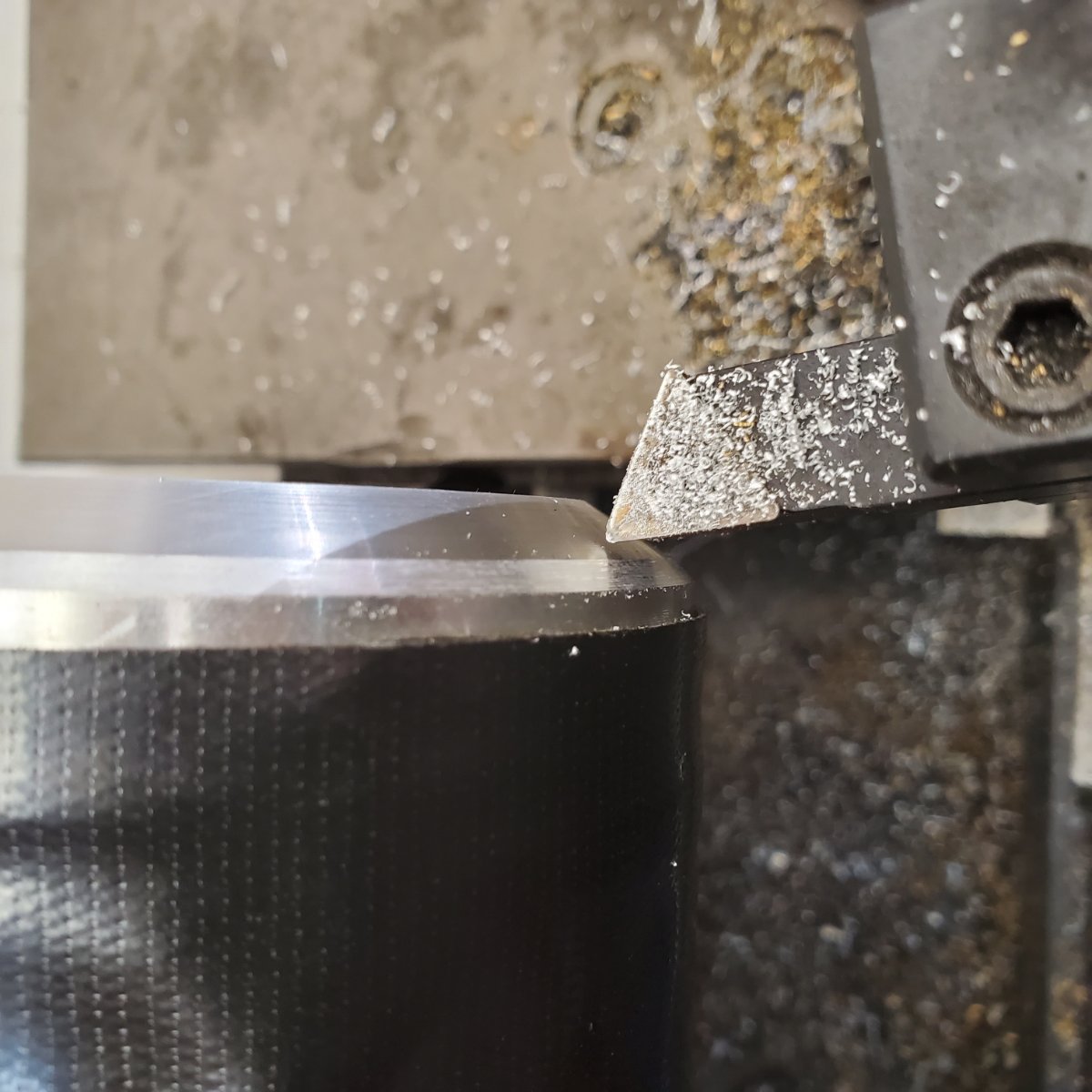

Gasket is Ok. Taking .100" off the top corners of the pistons. Having an adjustable chuck allows centering even with the cam ground pistons.

Thanks Joe for the encouraging words. I aimed for making the same relief I saw on the Snyder pistons I have.
