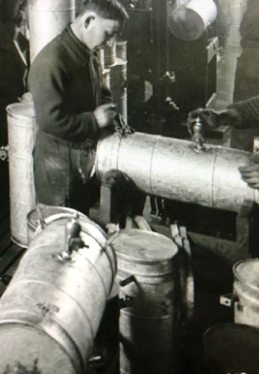

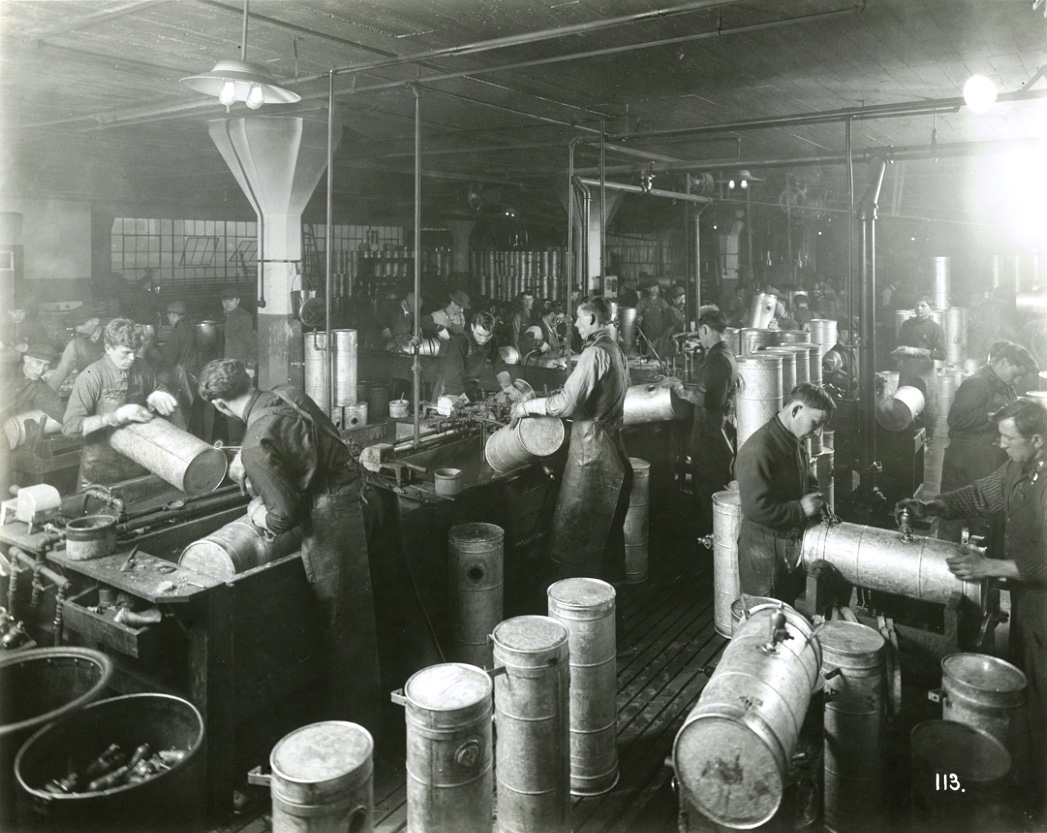

Adam
Posts: 1556
First Name: Adam
Last Name: Doleshal
Location: Wisconsin
Re: Gas tank sediment bowl
Post by Adam » Thu Nov 21, 2019 11:42 am
How do you know the ones in the picture are steel and not bronze? Appearance of both oval and round tanks? It doesn’t make sense that round and oval tanks would be in the same photo. The change-over was in ‘20. Is it possible that the photo is much earlier, maybe around ‘14, and the tanks that appear to be oval are in fact round tanks moving by on a conveyor?
Posts: 3889
* REQUIRED* Type and Year of Model Ts owned: ‘12 open express,'23 cutoff, '27 touring
Post by DanTreace » Thu Nov 21, 2019 9:00 pm
Adam
Those are all round tanks, early photo, posted a cropped version, and camera angle made the upright tanks seem oval :P
