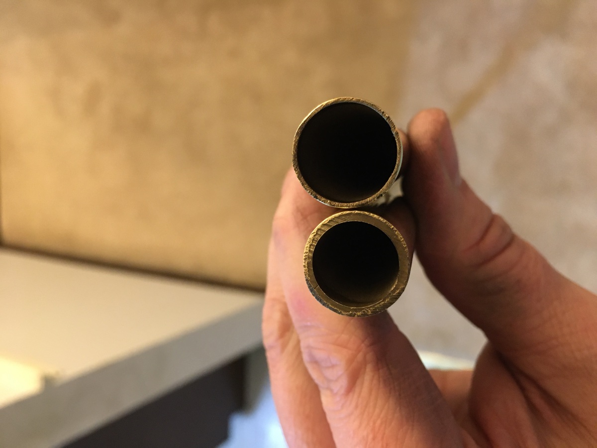

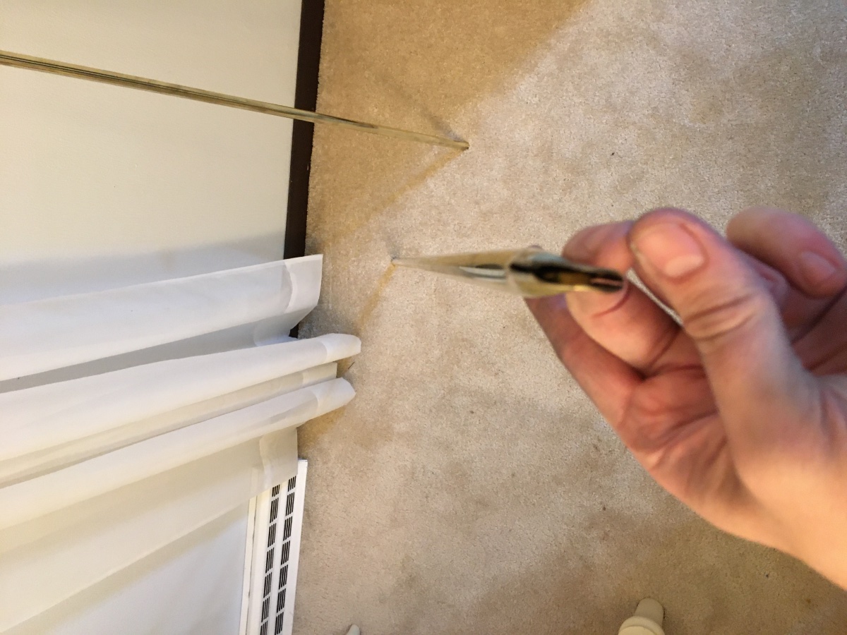

I purchased an original Rands windshield a while back and with it came the windshield support rods. I’ve seen other support rods with a bend near the top. These are completely straight all the way down. Can someone who has a 12 verify? One of the rods is heavier gauge brass tube as you can see in the picture.
Mike

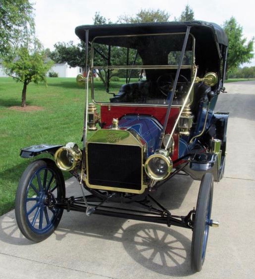

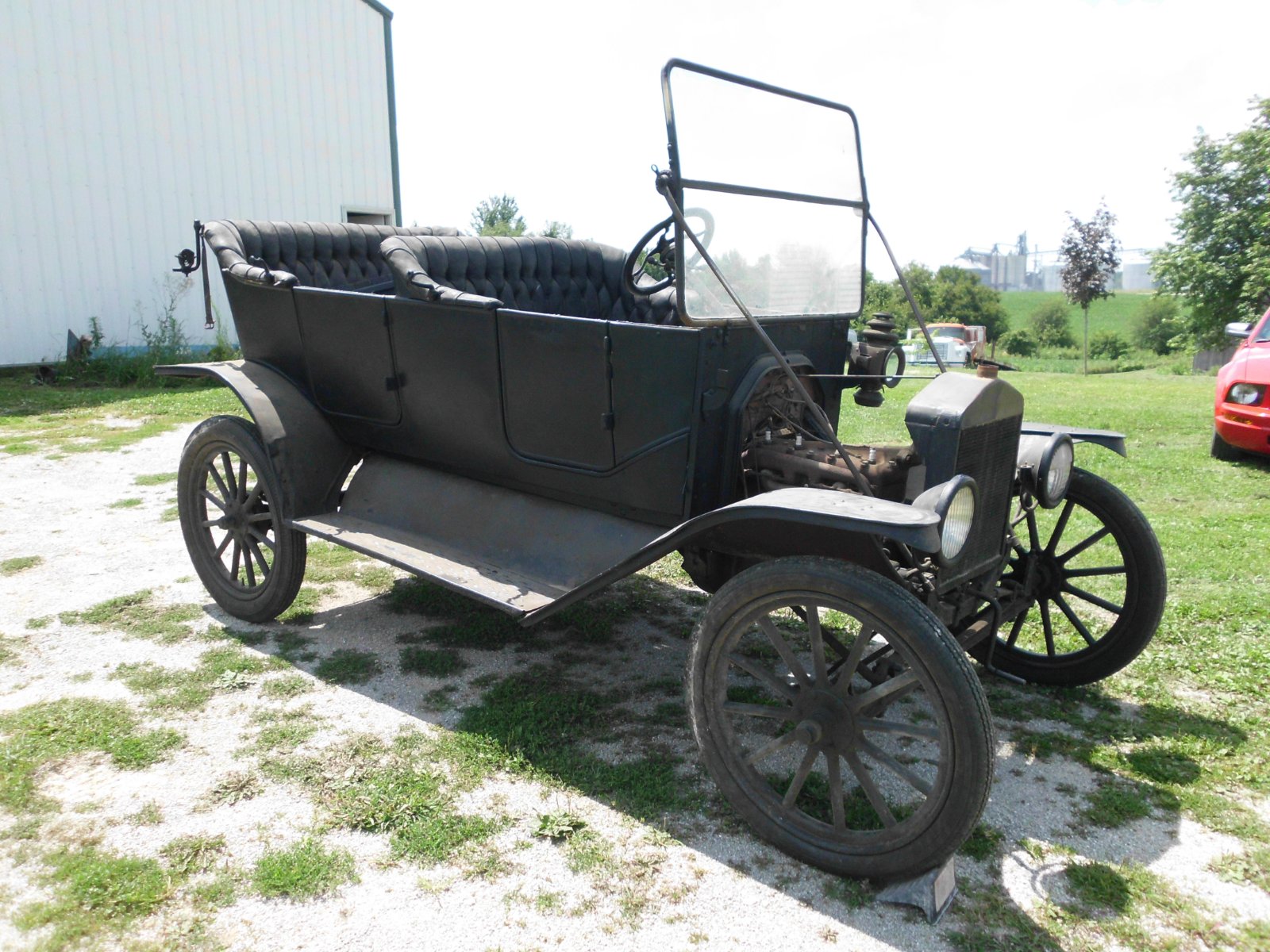

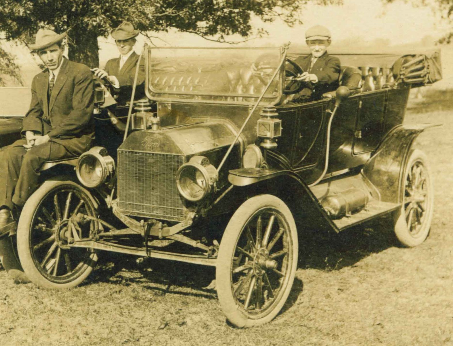

Here are some pictures posted over the years I have saved of 12's. You may have seen or saved these before but just in case maybe this will help.

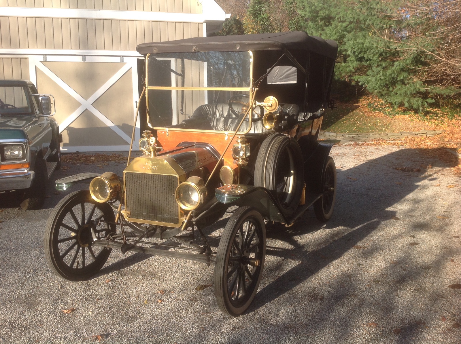

Next I will show my 12 but keep in mind this car is over 107 years old and anything could have been changed for any reason but it may show some detail to help. As you can see mine are bent but I don't know the make of the windshield or rods or if original or not. This just happens to be what was on the car when I found it.

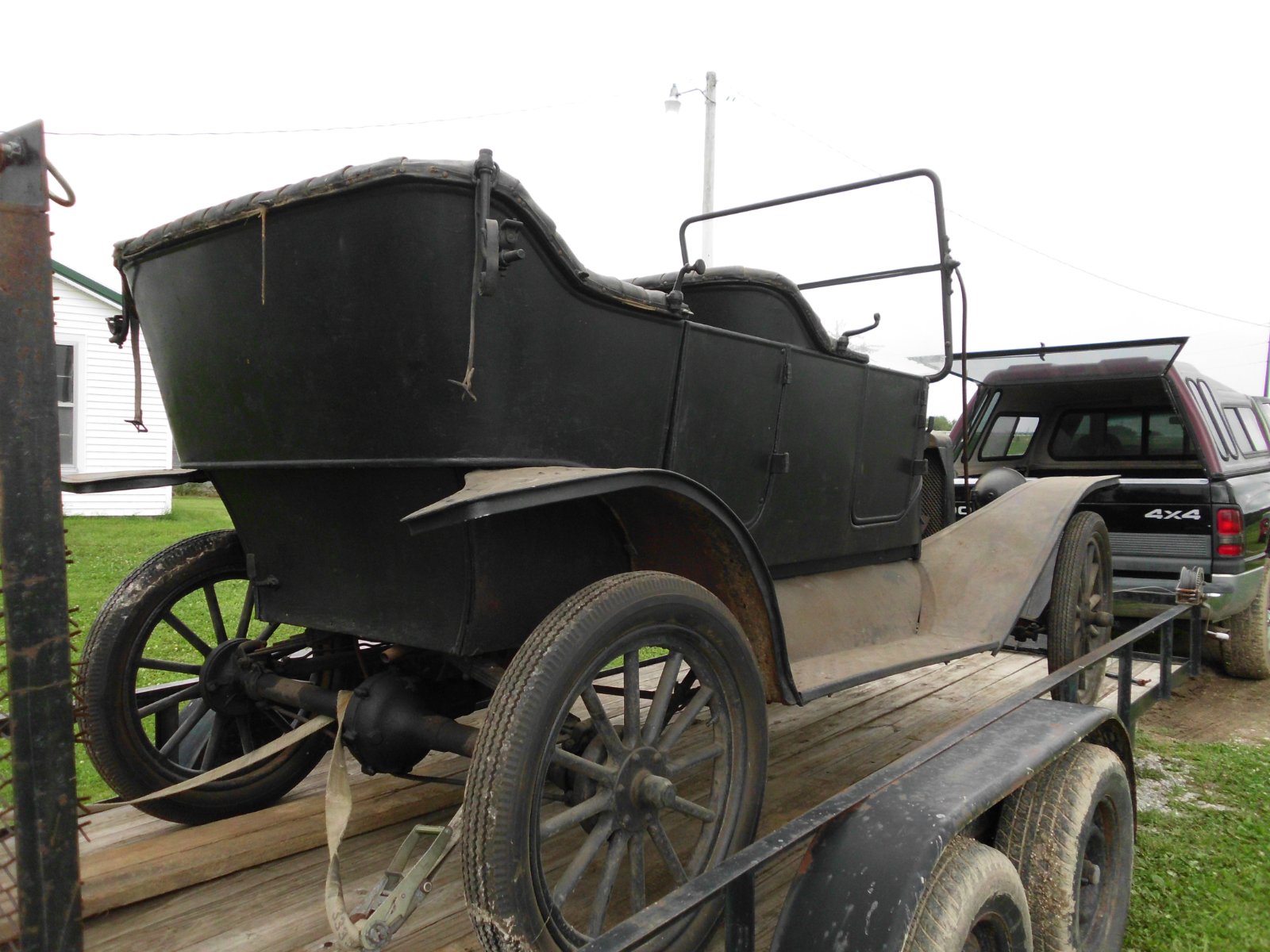

Re: Are these the correct windshield support rods?

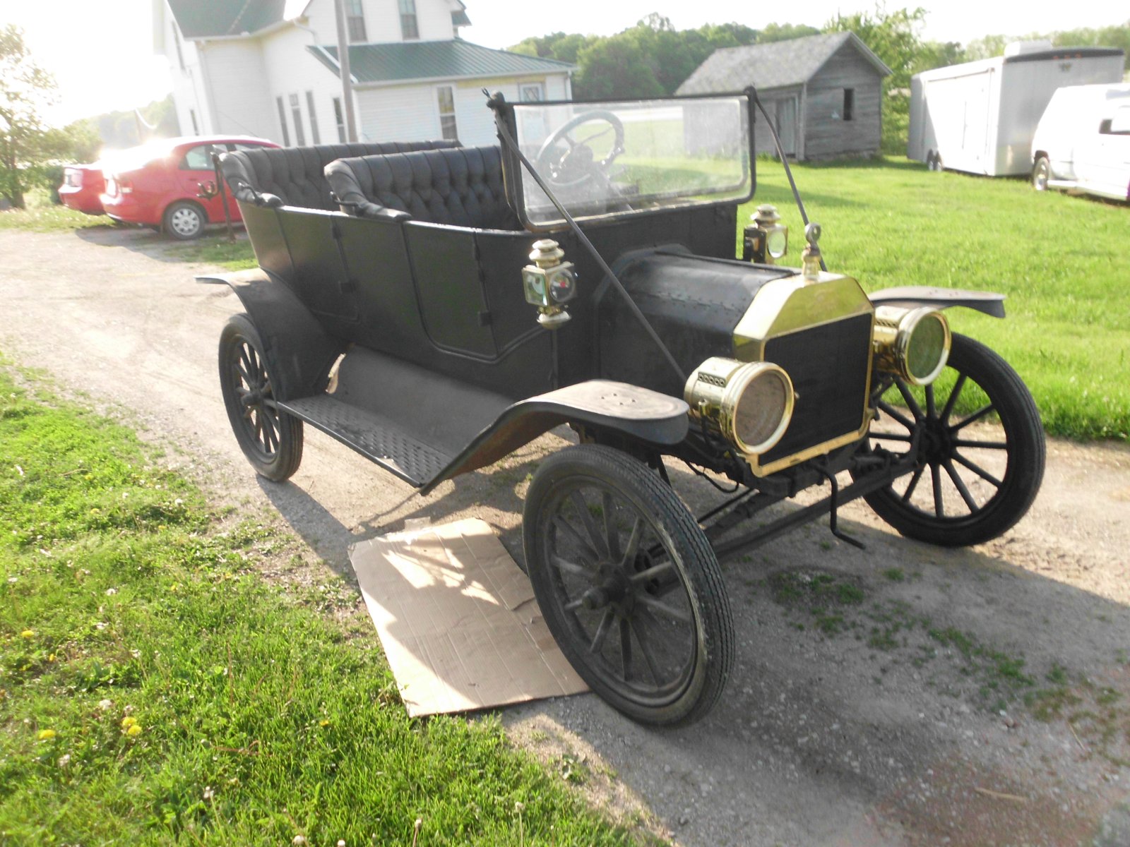

As you can see the last owner tried to put on a later radiator and the headlights were updated to electric at some point and almost all the brass had been removed other than the windshield so even that may not be original.
Last picture is after I put on some brass I had on the shelf for another project so we could take the car for its first test drive around town.

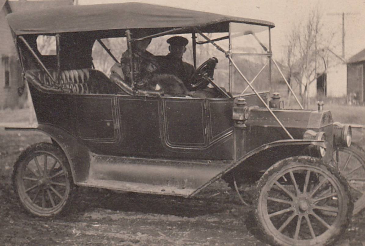

Mike-
I have seen both straight and some with a slight bend at the top. From what I understand, original windshield rods were steel tubes with a thin brass sleeve over the top. Generally over the years, moisture would get between the steel and brass and the resulting rust would split the thin brass outer layer. I believe all reproduction windshield rods are just brass. I don't know how thick the wall of the tubing is on my 1911.
I would opt for straight, unless someone can come up with a 1912 blueprint with specifications.
Here are some 1912 images that I have harvested over the years that you may use for a reference.
(Notice that that there is no pinstripe on the lower section below the back of the back seat.)
Keith
Keith

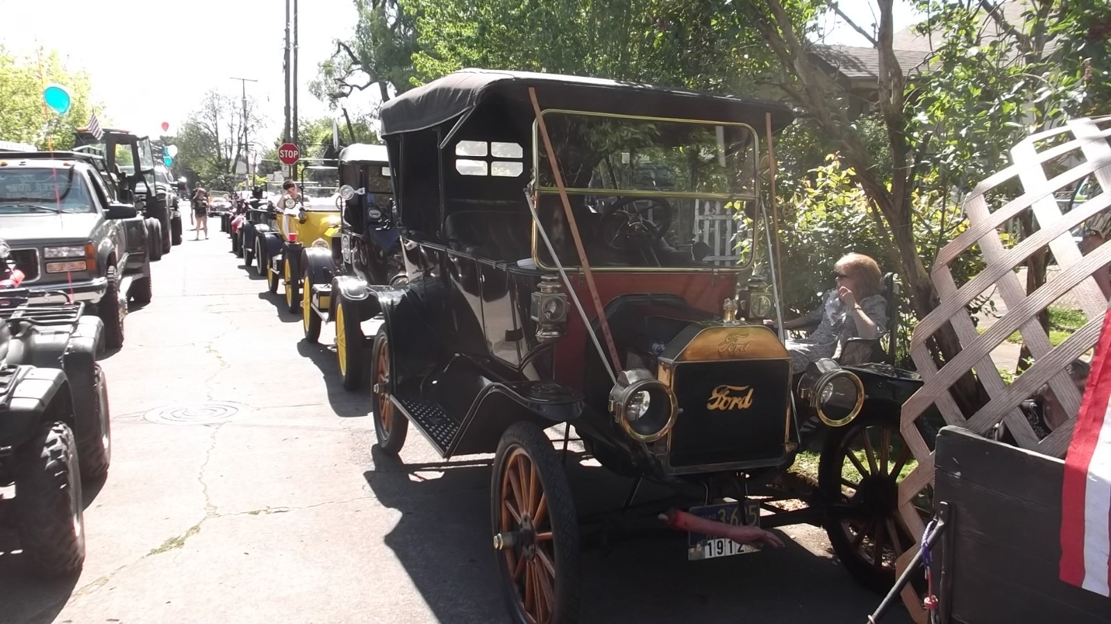

- Posts: 5544
Clay's 12. I think it is June 1912. Sorry can't help on tubing thickness. Were the tubes left open or was there a plug to keep dirt out?
