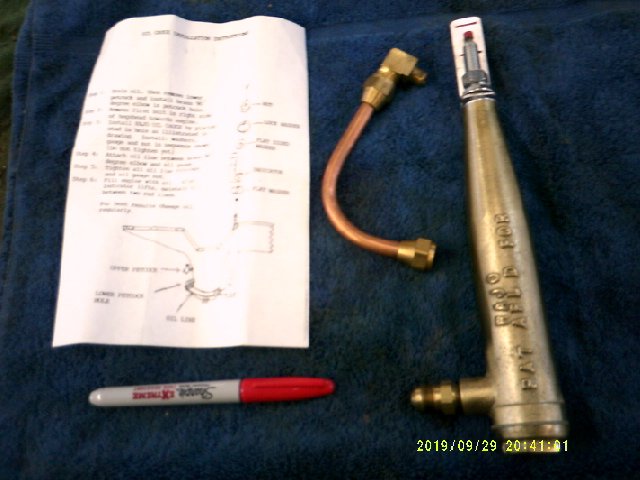

Heres another oil gauge---says RAJO on the brass gauge]
