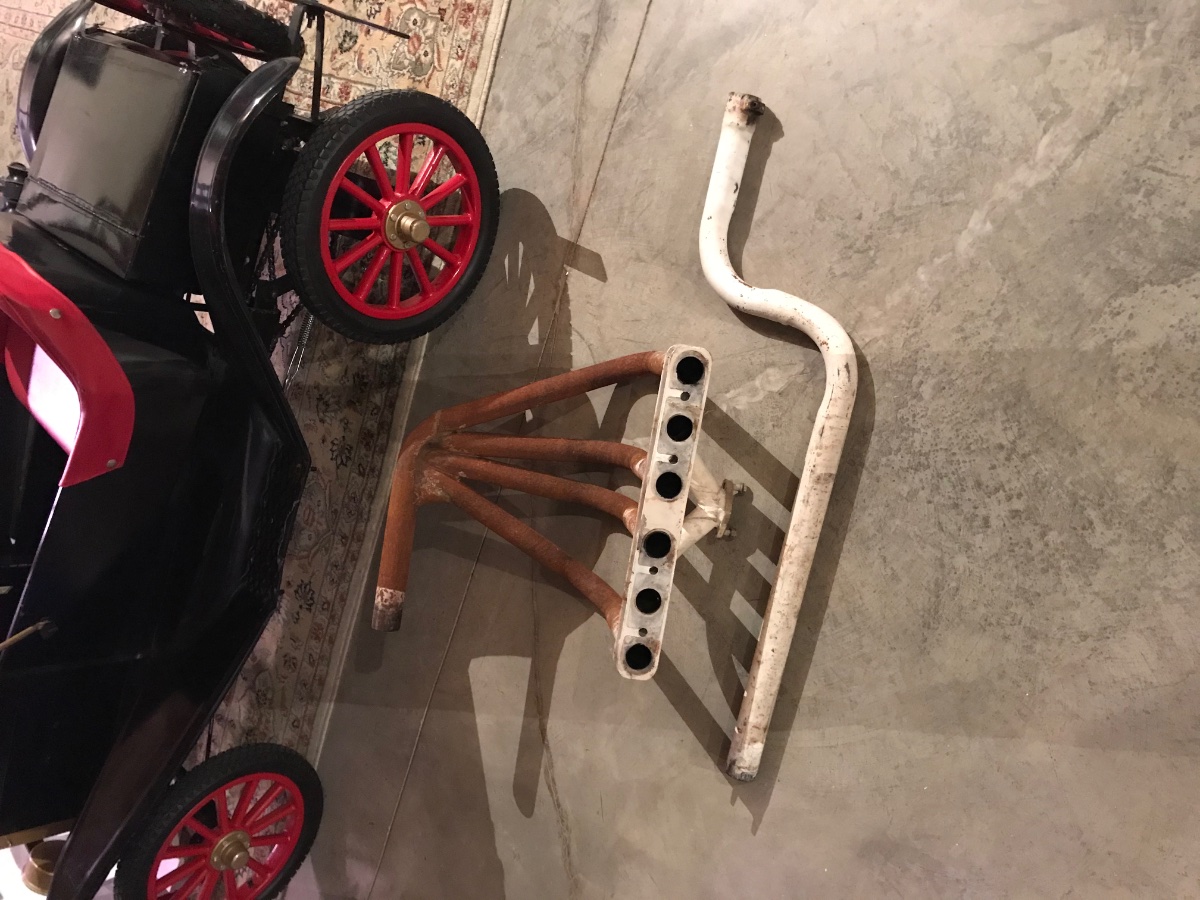

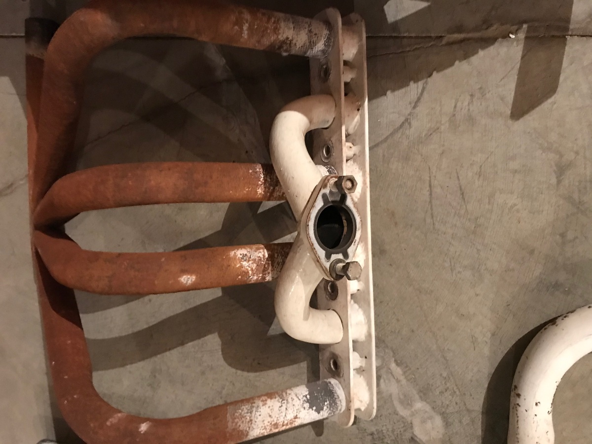

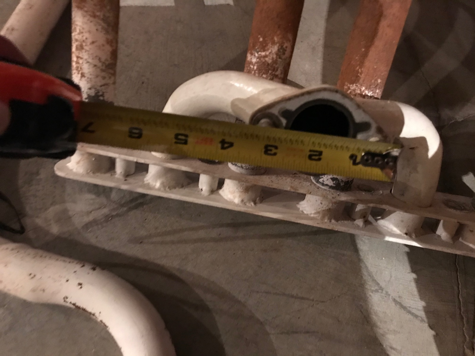

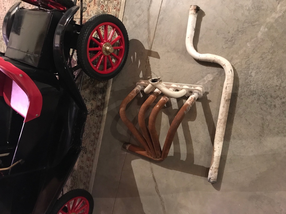

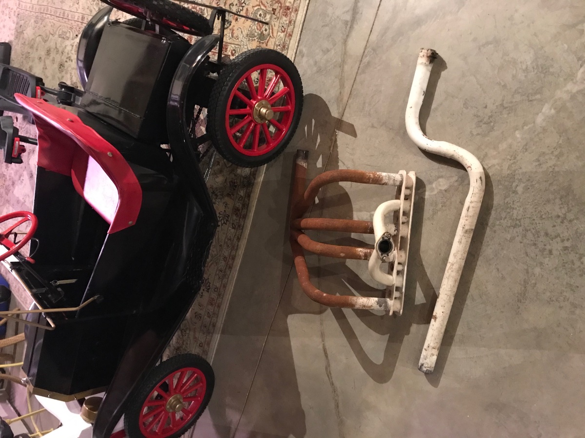

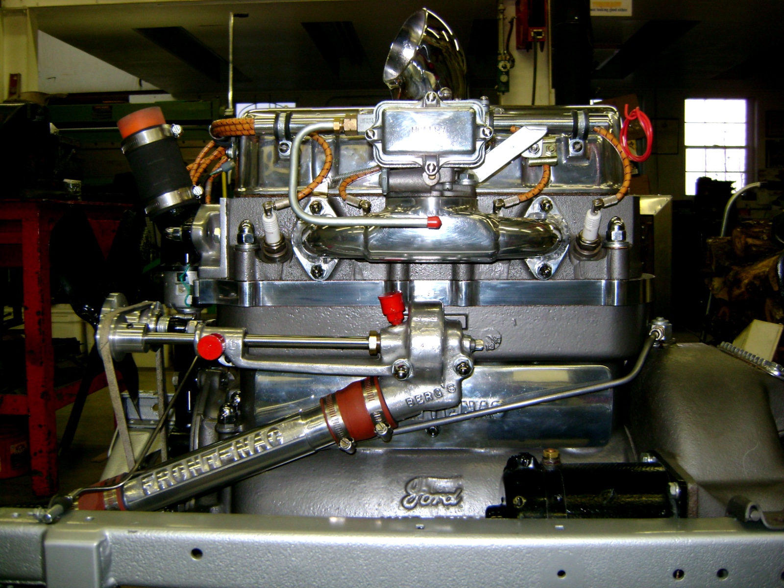

I purchased a Model T truck some time back, along with various parts. I have a header and exhaust pipe, the mounting holes match the Model T manifold.
My question is this, if I decide to use it, what type of carburetor would I run?
Photos attached.

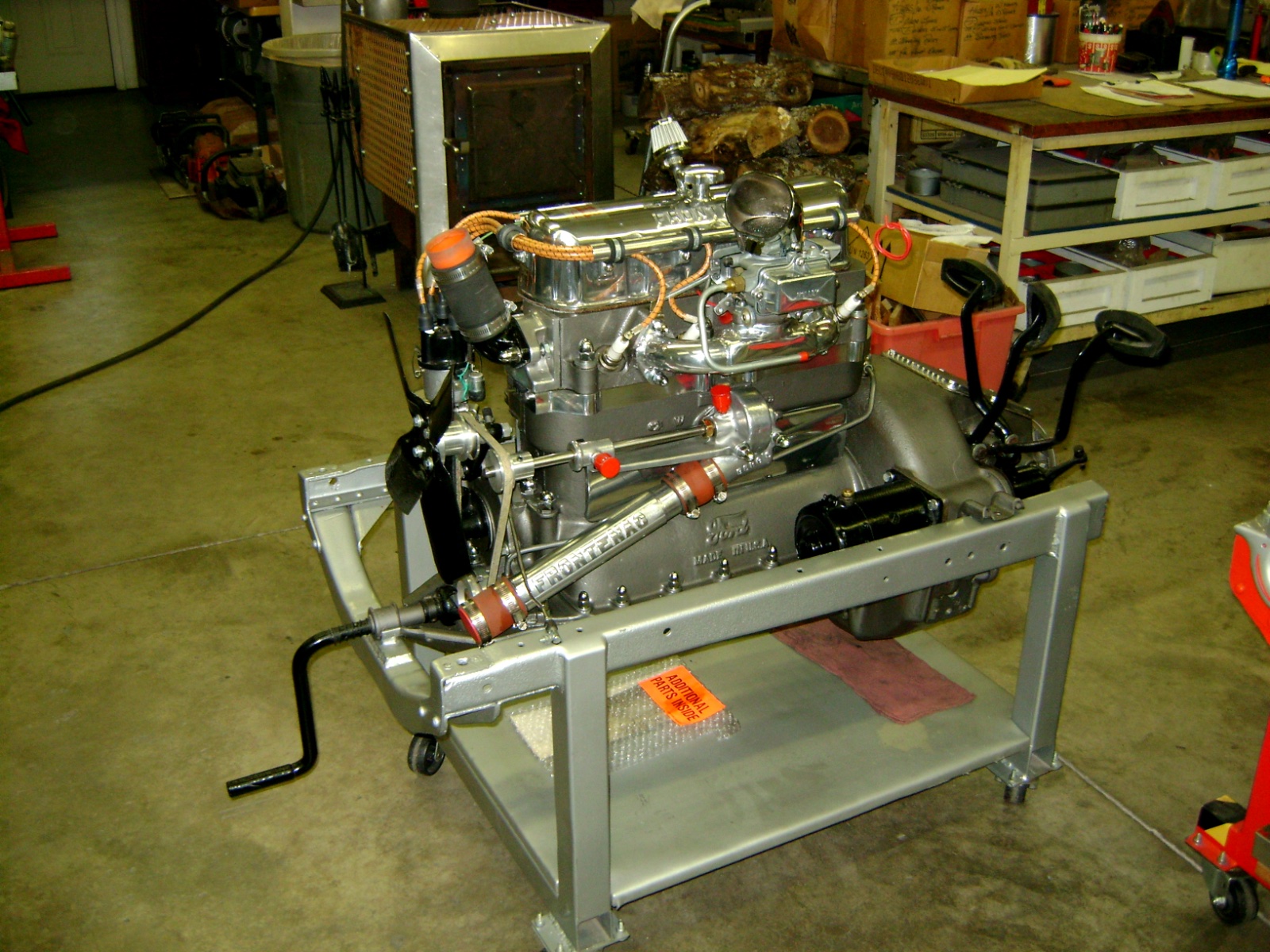

If you use a big enough cam such as a 280 or 290 a Holley 1904/1908 series works well from a Ford 170/200 CI 6 cylinder.
Hope this Helps,
Hank

Re: What type of carburetor would I use
Post by Henry K. Lee » Mon Dec 16, 2019 8:37 am
Posts: 6596
Post by Scott_Conger » Mon Dec 16, 2019 11:16 am
Hank
you sure can come up with the Bling!
ACORN nuts no less!! :shock:
