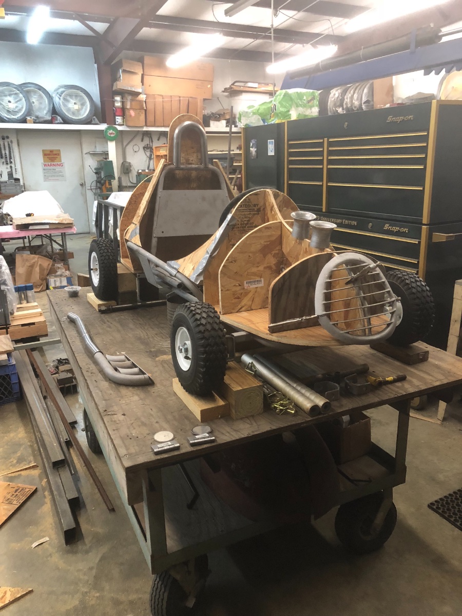

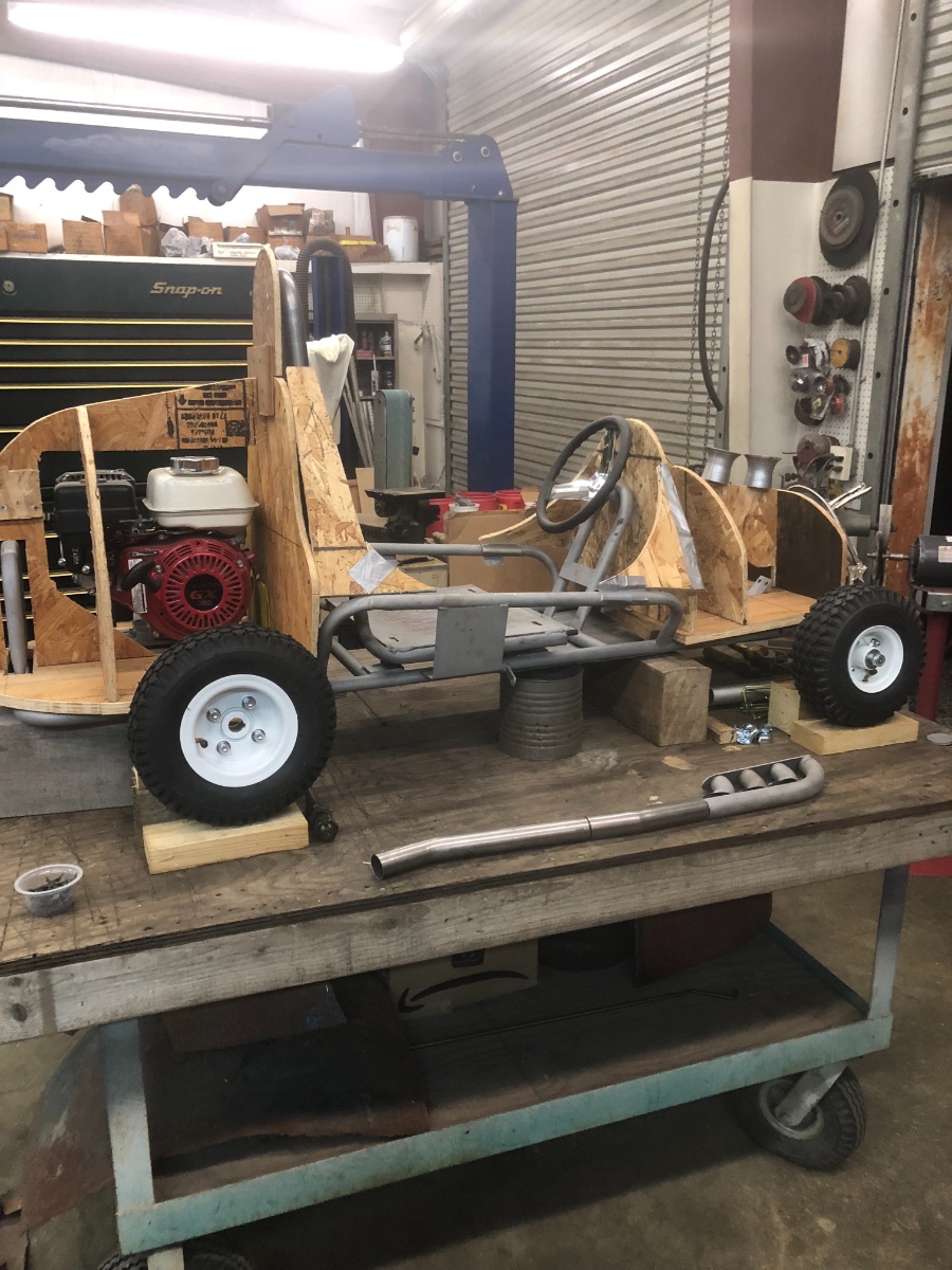

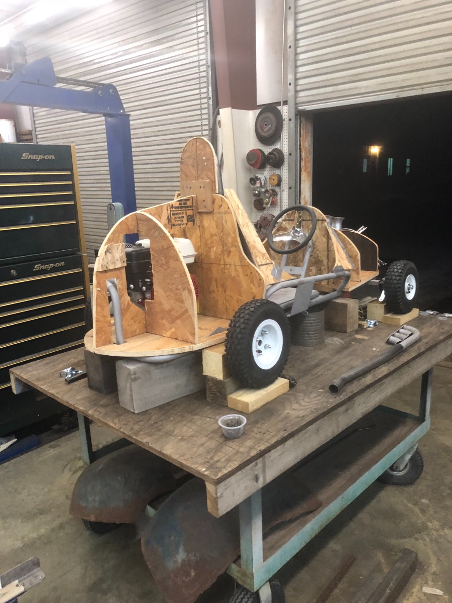

Here is something for you bored out of your gourd folks! Long winters etc. The key to any custom body is having your components in place, ergonomic in design, and nice lines. Building from a buck with a spine (that's the center board) and branching out with ribs to follow is enjoyable to me and really does not take as much as you would think. This go kart is for our Grand God Children whom live in England but come over every summer for spoiling. So far this is a "Pre" buck and I will refine it a little more to get the right balance. Using 7/16" OSB works just great for one but if you were making multiple, 3/4" plywood is best.
Just trying to enlighten others so please Enjoy!
Will post progress with how to tips.
All the Best,
Hank in Tin-A-See
All the Best,
Hank in Tin-A-See

Very cool! I can see the finished product!

Thanks Mike! The cool thing about this body, I will be making the the main sections from old body panels, meaning hoods, roof, and old fender sections cut out from other wise junk. Rotted edges are removed then matching profiles with minor adjustments. This is the way they did a lot of them after WW II. No tools were available or folks made do with what was available to get on the track.
Hank
Hank
