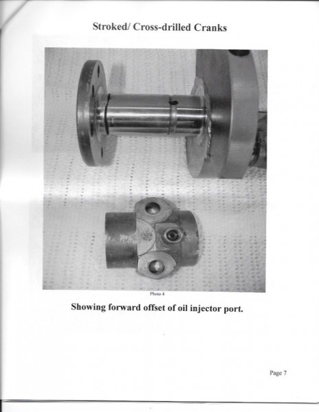

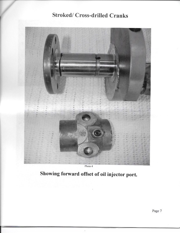

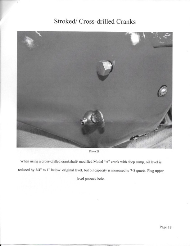

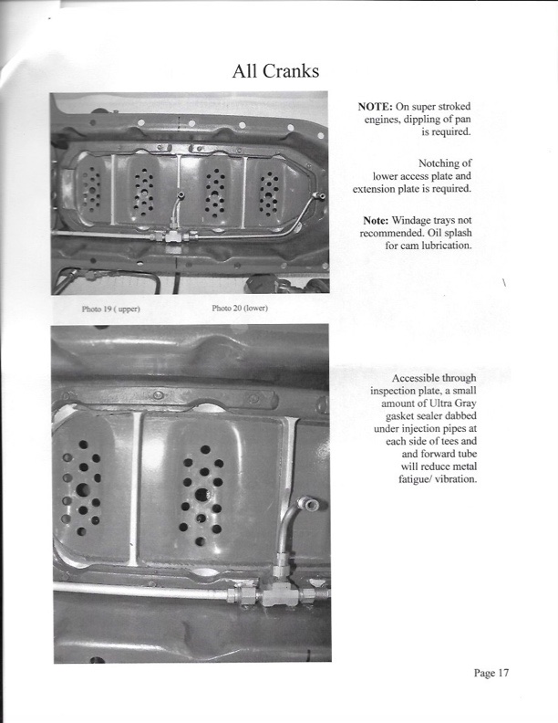

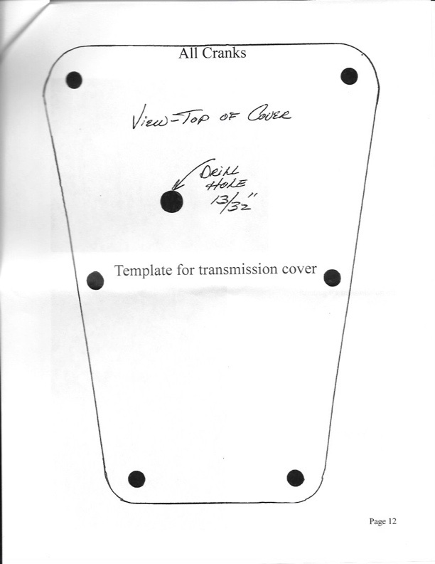

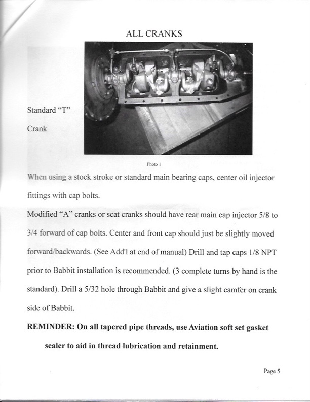

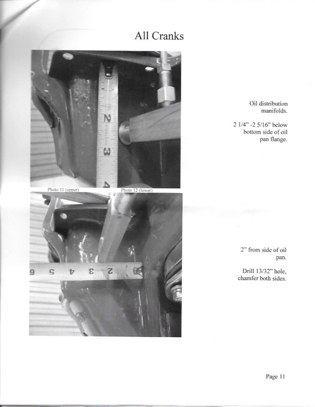

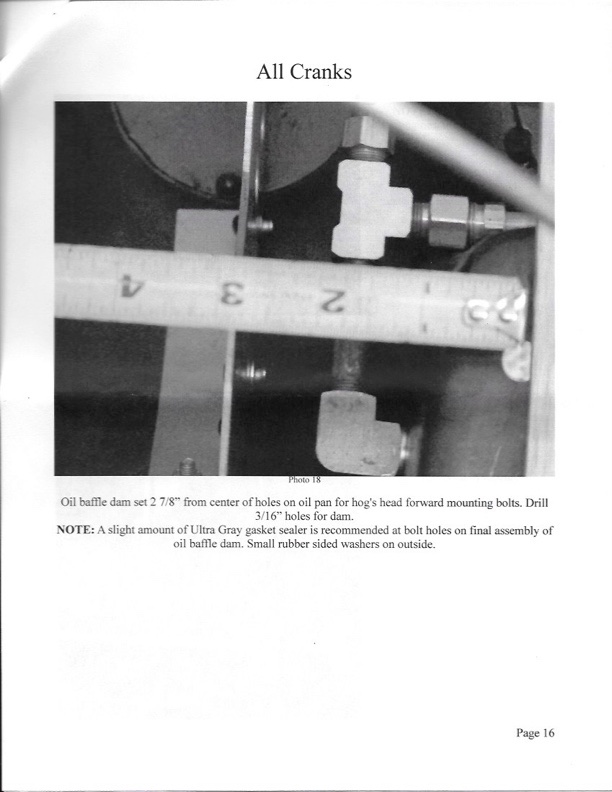

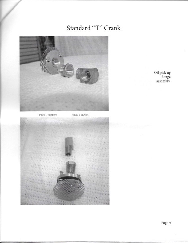

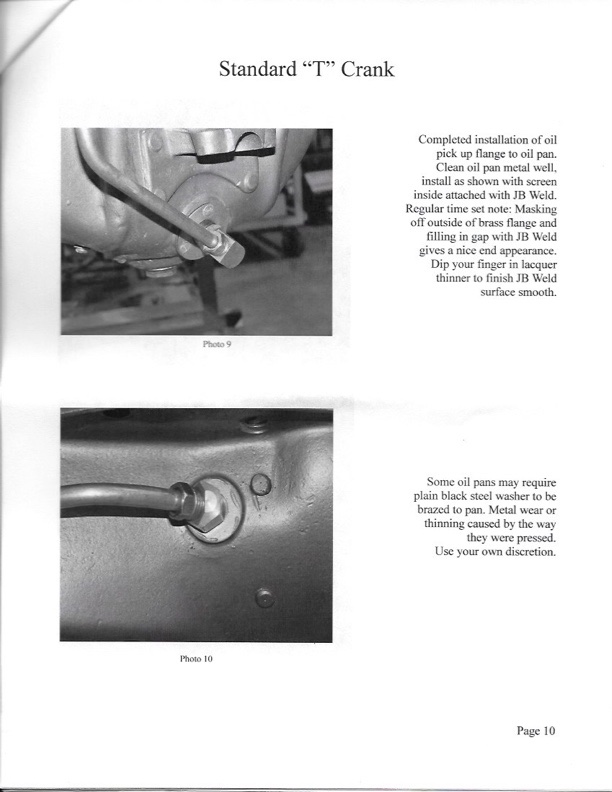

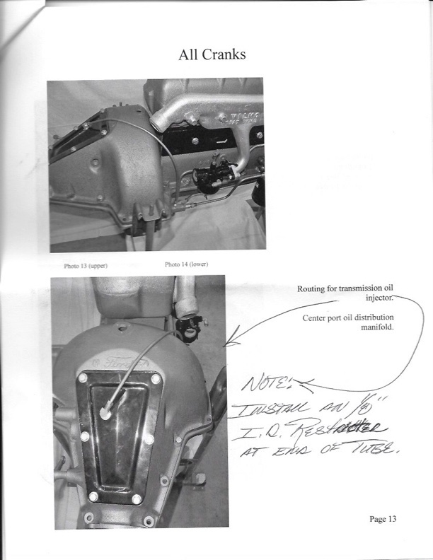

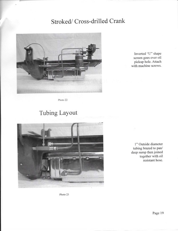

I am sharing this info with all of you, so please print and save for your records. We did not invent the use of the Datsun B 210 oil pump, just added a lot of improvements as we progressed. My Dad and I some years back had to purchase all the North American stock of the pumps to secure it's future production. They were getting low request at that time and was going to discontinue reproduction.
Please let me continue loading these up before weighing in, Thanks.
I know some of you have your own experiences, and I respect yours, so please respect mine and Dads. We have never had a failure time and tested for going on 20 years.
