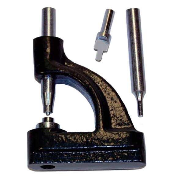

I also found this tool in my "barn find" pile of parts. Looks like it's used for setting brake rivets.
Jeff
