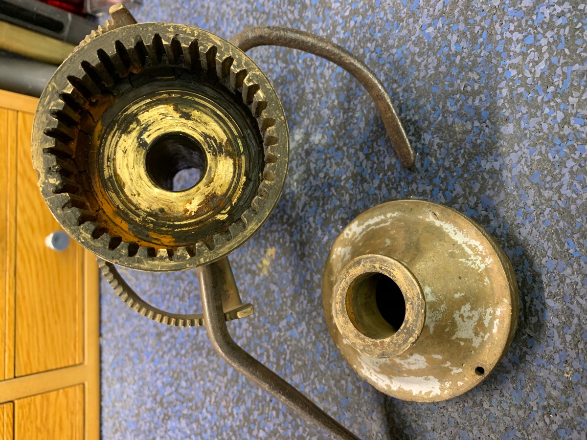

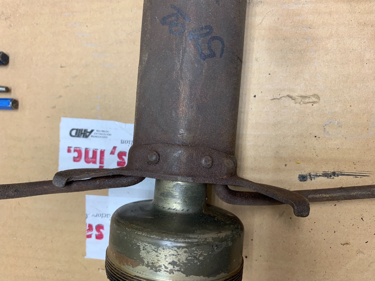

I stripped out a later model column today mainly for the sheet metal column. I have a saw cut brass quadrant and gear case I am thinking of dissecting and using for my speedster column. Will the new 5/1 shaft and gears work with this combo? I have read that the new stuff is tight in the older brass gearbox?

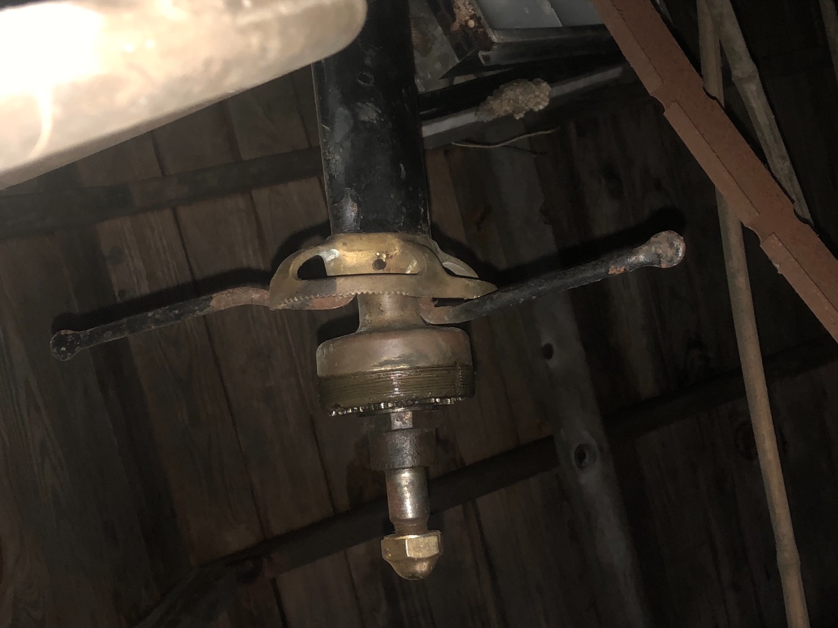

The brass case I have does not have the routed out overtravel groove. I have no clue what year it is. I will take some picks

When fitting new gears and shaft in an original case I prefer to use valve grinding compound to remove any high spots on tight fitting gears. I assemble the components of the steering column dry on the bench and then put a generous amount of grinding compound to the gears themselves. Then rotate the shaft until it turns freely. Once grinding is complete, remove the parts and wash out all grinding compound and reassemble with grease. IMO timesaver will not cut as needed and is not worth the effort to get a good fitting gear case.
Posts: 6817
Re: Steering column
Post by Scott_Conger » Thu Dec 26, 2019 9:55 pm
Well, it looks like someone cut up a very early pre-'15 column
I can almost guarantee that someone would trade you a working, complete steering column for that quadrant and steering case.

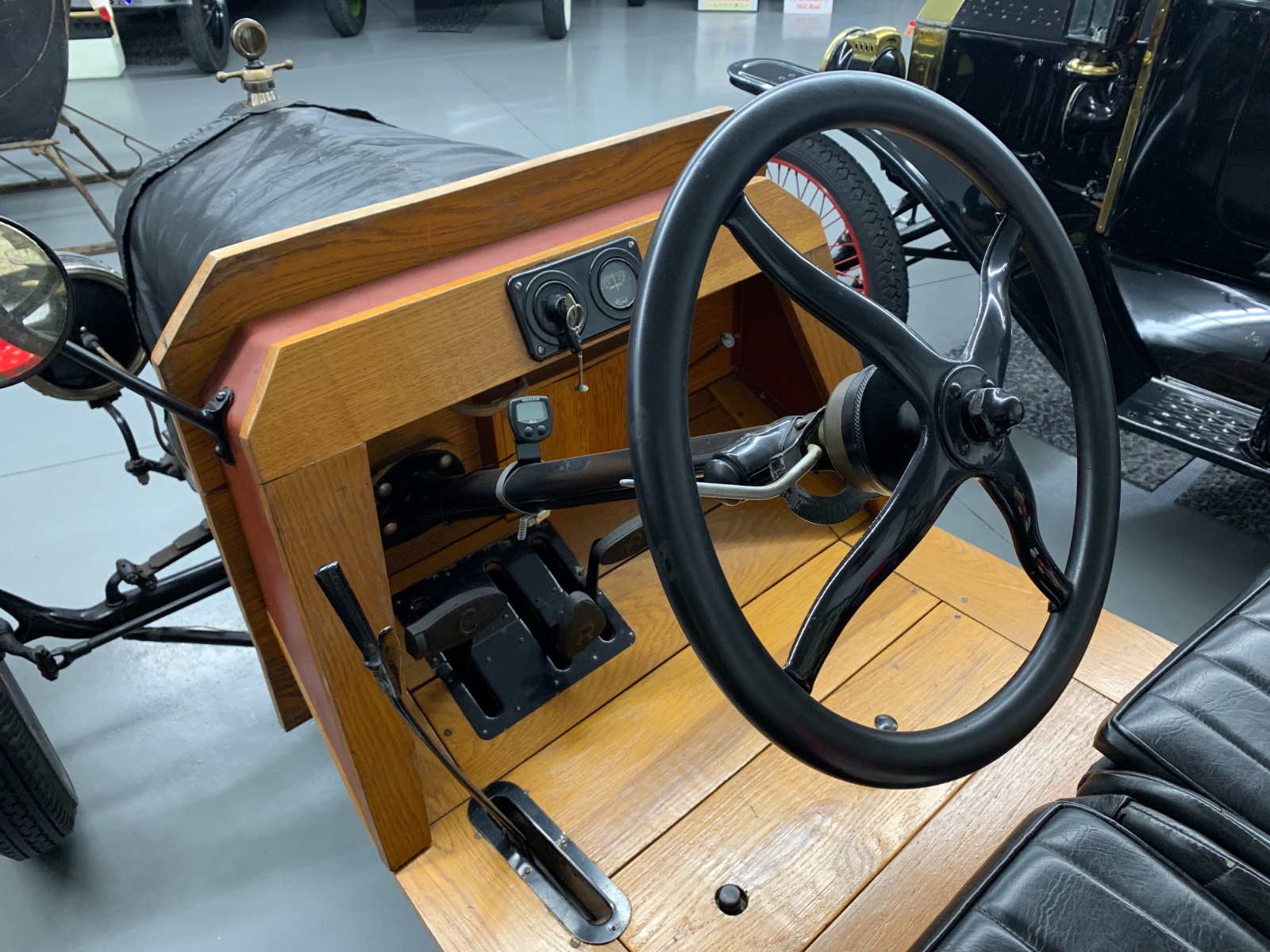

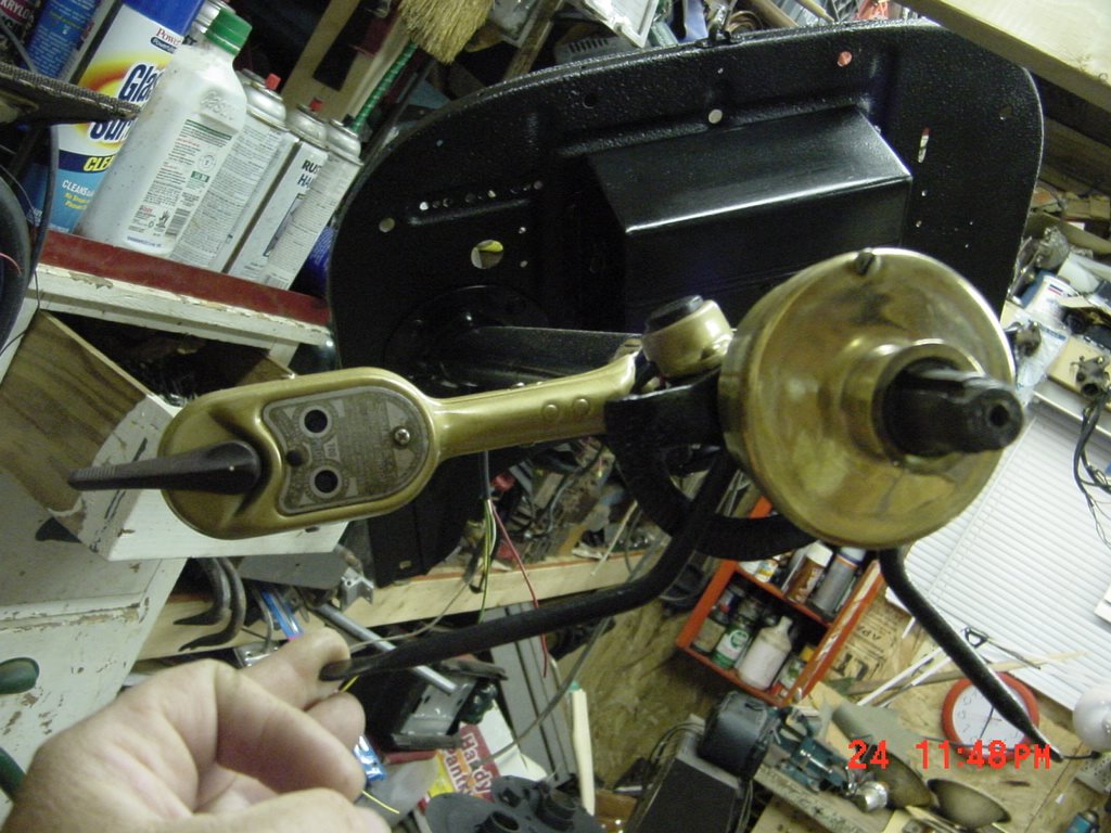

Along the lines of what Wayne said, I’ve got this column with a later one piece gear box and reproduction brass quadrant that I’m going to use on a speedster. You can tell it doesn’t belong together but it’s similar and nobody but T people will know. I had it in my 1914 until I found an original column for it.

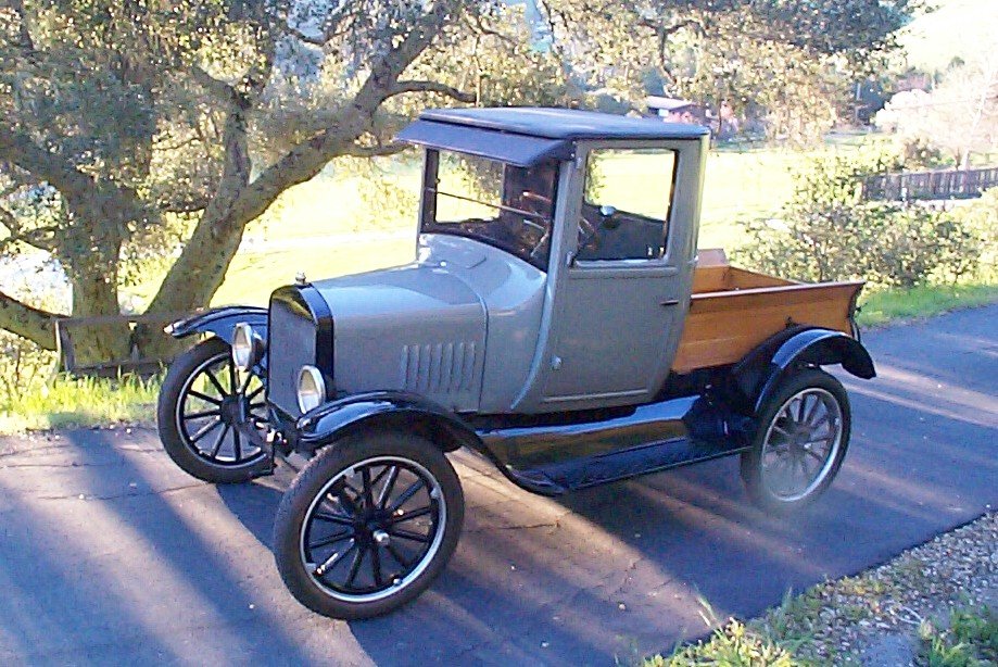

I have used later gear sets in earlier columns, to gain better steering, as I drive my cars. The earlier brass riveted gearboxes have deeper cut internal gears, and the later gears will not drop in. Get a later case that they will, measure the ID across opposing gear teeth, and turn out the few thousandths of the earlier gear case in a lathe to match, then do the fine valve lapping trick mentioned earlier in this post to finish up. It will make a much better & safer steering car, and no one will be any the wiser, being as none of it is externally visible.
Speaking of Franken-T's, I bought this little pickup inexpensively from the widow of an old friend, somewhat disassembled and missing a lot of stuff. It was overlooked at the estate sale, being up on blocks and missing its wheels, among a bunch of other stuff. It was originally a Fordor sedan that was very nicely made into a closed cab PU certainly sometime before I was born, probably because Ford never sold a closed cab PU in the model T era. It once belonged to Dennis Day of the Jack Benny show. Chassis is 1921, body 1926, that's the original Fawn Gray color matched from inside a door. I am working on a stock looking steel PU box for it now, which will further confuse the experts, but its the only PU I own, so it makes regular runs to the dump, among other errands. It has the later steering gears too. Good luck with your project, Danny. Jeff Beaumont, Gardnerville, NV

Danny, your brass steering box and quadrant look to be really nice. The riveted case looks to be tight, the quadrant is tidy and the riveting in the steel tube looks tight.
With all this looking so good, I would not disturb any of it. Rather, I would cut your later metal tube and weld it to the reminder of the tube still in the brass parts. There is enough variation in the cross section of the tubes that a good fit of the brass bits in a later tube may well be quite difficult to achieve. Welding two steel tubes offers a much easier solution, and one which will be easier to manipulte to achieve a good looking result.

I think I will use the later gearbox I have and just restore it. Not because the rarity of the brass one I have. Because I have it cleaned up and stripped it down. New rods for it. Quadrant is pretty rough. Might source one and then I will be good. Didn’t mean to start this mess.

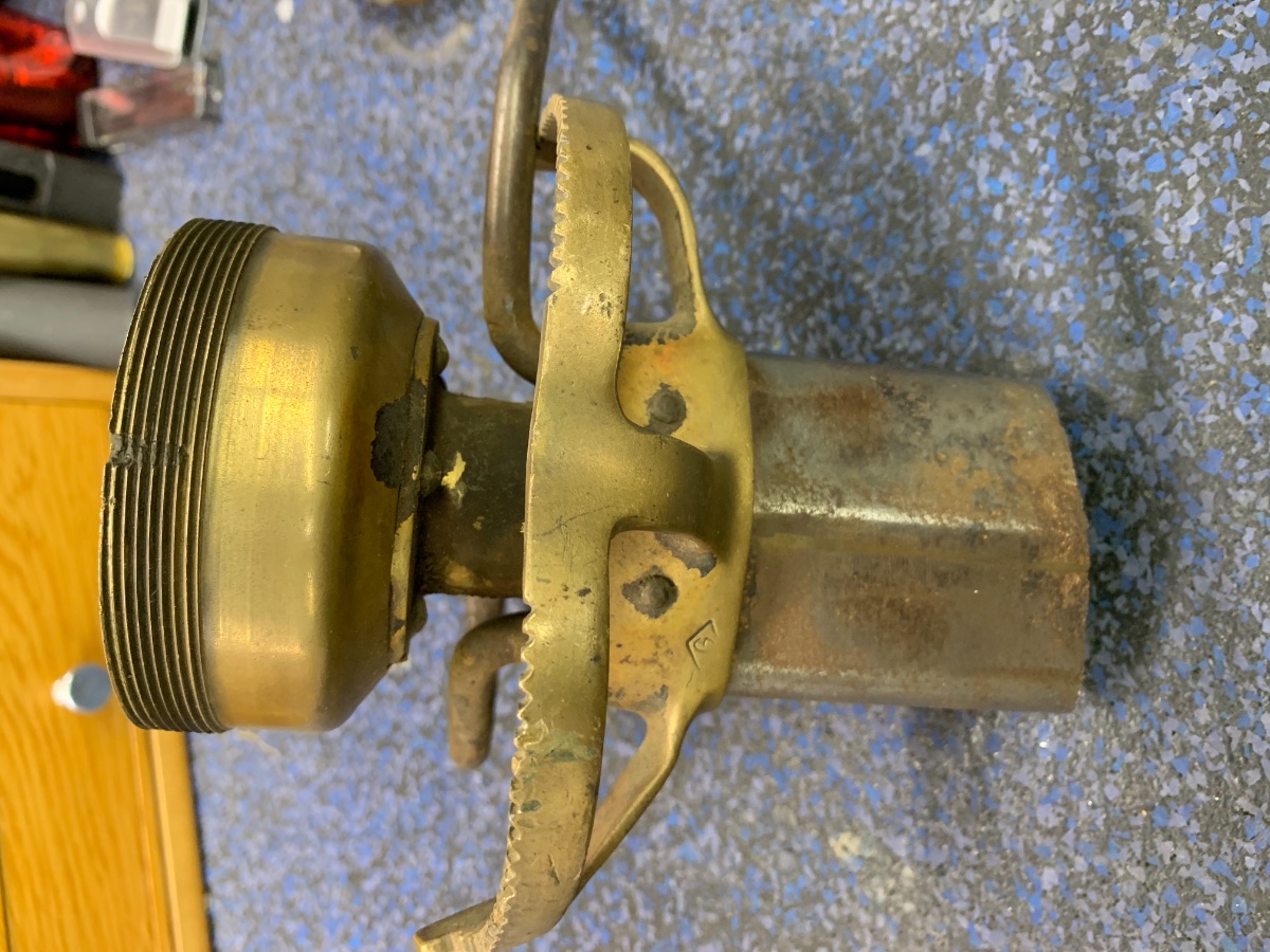

Here are a couple I took pics of this morning.

No worries Danny D ! Those of us paying attention here already know that you didn't cut that early column. The fact is, probably hundreds of such columns were cut that way over the many decades before these parts became a bit more expensive and rare. Most by people that wanted to save the most valuable bit (whether for scrap brass or the smaller end worth five bucks without having to handle the longer bulk that only added a few more dollars back then). I have probably seen nearly a dozen such cut early gear-cases with a couple inches of steel tube.
