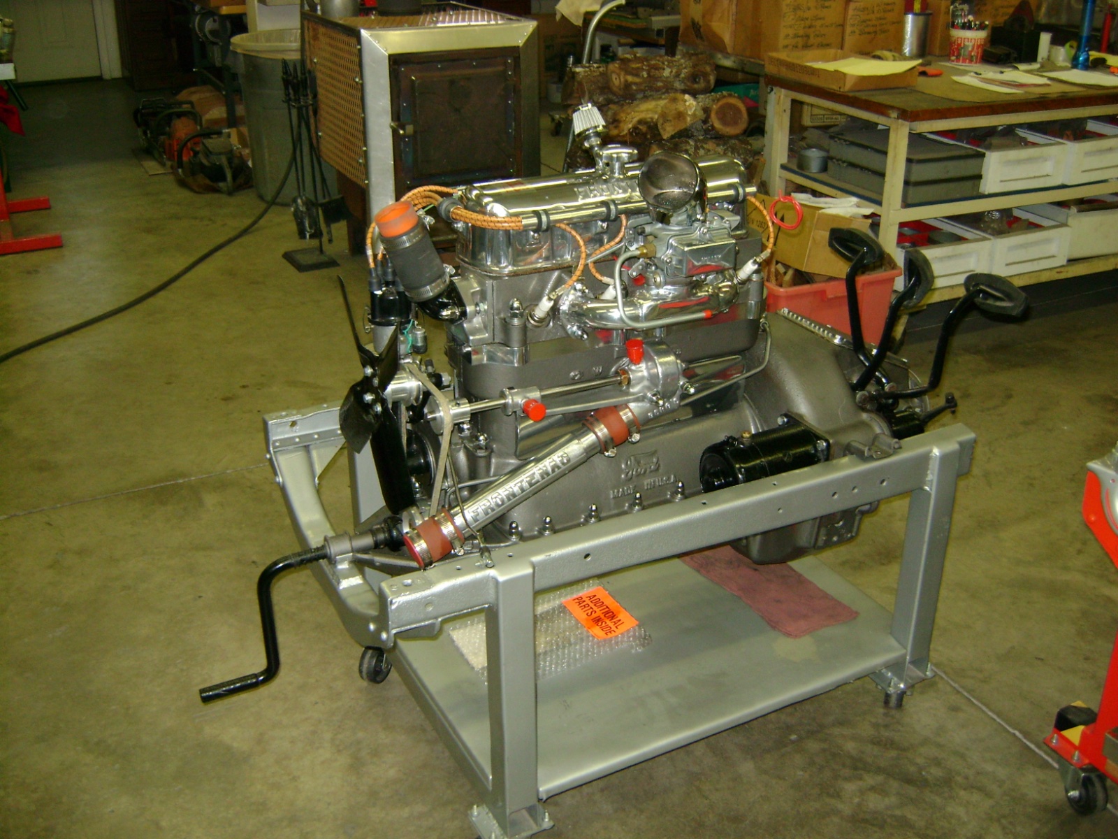

Just an example.
All the Best,
Hank

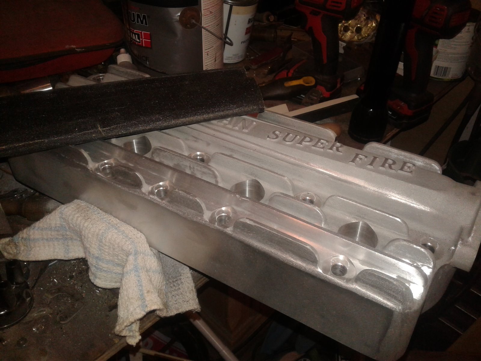

And another.
Hank

Yeah, that’s shiny enough. 8-)

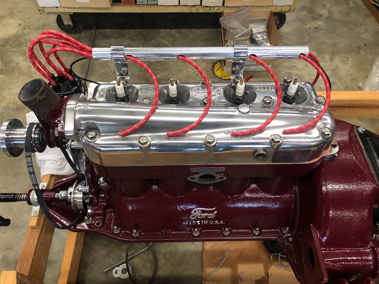

Working on my head now, I did the intake a while back. Using a random orbit I start with 60 and work up to 400. From there I go to the bench grinder and compound.

Really nice. It’s gotta be tough to get a consistent finish on all those fins. What I found was even with hand sanding on unobstructed areas I made decent progress in a reasonable time. It’s the letters and the recessed areas for clearance to head bolts that aren’t going to shine up with a power tool without risking damage to the sharpness of those features. I’ll post a photo when I get further along.
