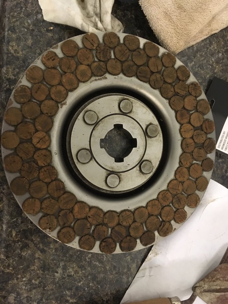

Does it look something like this?

Certainly it resembles your picture!!
I got your message as well.
I will work on this project some more myself as on one of these I will end up remaking most of the clutch as they tried to continue running it with worn out corks and pretty well destroyed it. Certainly destroyed all the wear surfaces!! I am remaking the pressure and receiving plates from Durabar so retain comparable properties!
The disc I will get CNC laser cut

How thick is the steel plate?
How much do the corks project each side?
Thank you
Thank you

I don't remember if I measured them or not.
And this disc is not available now. I'll see what I can find out tomorrow.

Yes I have studied the Hudson sites and it is quite interesting. The thing is the tolerances never seem to be disclosed. My weakness is that I LOVE to learn!!
So I have expanded my research to British motorcycle sites and am learning about cork properties.
The dimensions appear to be what I expected. Looks like about 12-14 gauge steel and the cork projects a good 1/16” or a little more. So a total thickness of 1/4-5/16” for the finished disc.

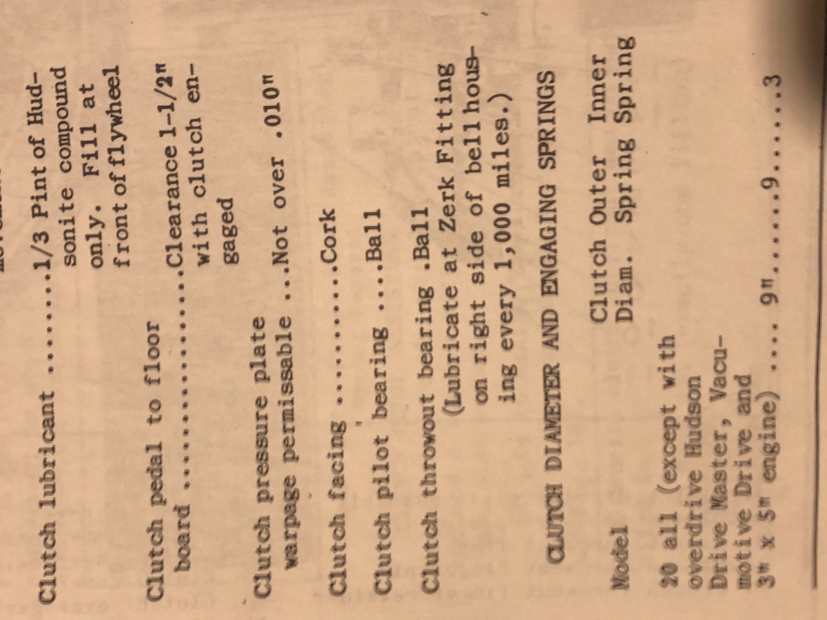

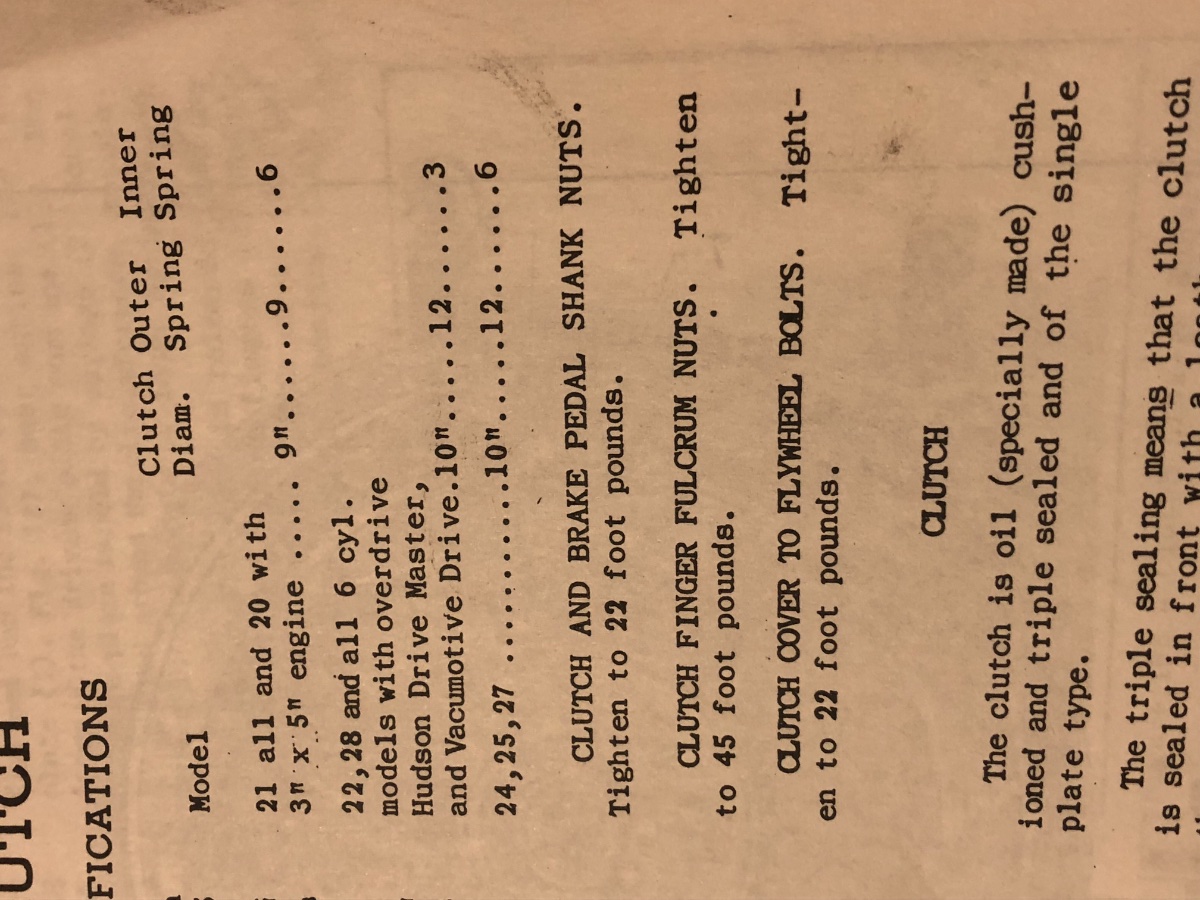

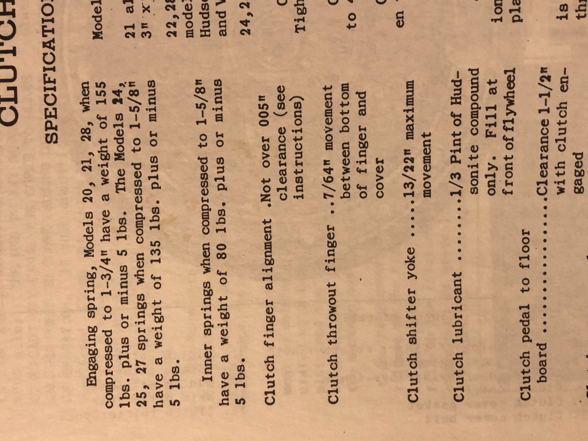

I believe Doug Wildrick is the main person doing Hudson clutches now. There was a man in El Paso, Texas that dt I spoke to around 2008 when I put a clutch in my 47. He said he was moving and I think also going to stop doing them.
I soaked the disc all night in “Hudsonite” oil before I installed it. It’s about like ATF.
It had worn out and wouldn’t move under its own power and upon disassembly I found only the steel disc with holes.
Here are the only specs it the shop manual. It seems like i found more online somewhere back then.

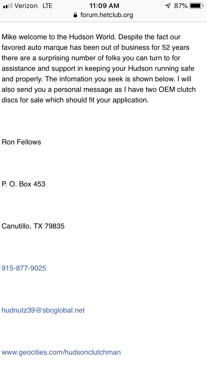

This is who I talked to, Ron Fellows, just outside of El Paso. This is from the 2008 forum so I’m not sure if the phone number is the same and I believe he told me he was moving. It seems like he told me about the process. I remember something about inserting the corks and facing them down on a lathe. I’ve never spoken to Doug Wildrick, only have seen his name on the Hudson sites.
