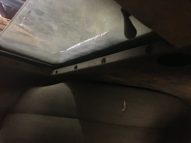

Re: Pictures needed of 24 coupe inside bottom trim pieces
Post by Robert Lawson » Fri Jan 10, 2020 12:23 pm
The metal pieces that go on both sides that cover this area.

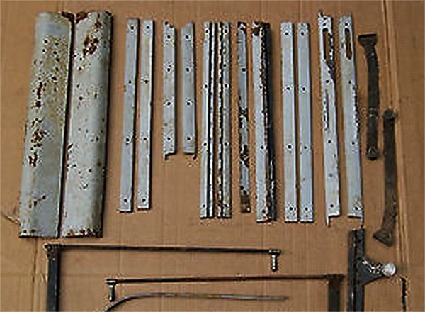

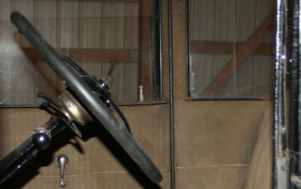

Post by Rich Eagle » Fri Jan 10, 2020 12:40 pm
I will look for better photos but here are these for now.
Apologies to those I stole them from.

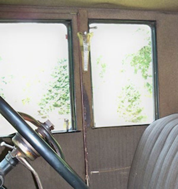

Post by Rich Eagle » Fri Jan 10, 2020 12:52 pm
This shows them a bit better.
From:
http://www.vintagecartruckpartsshop.com ... -1923.html
I don't see that add there but that is where the picture came from.

Do you have any clearer pictures?

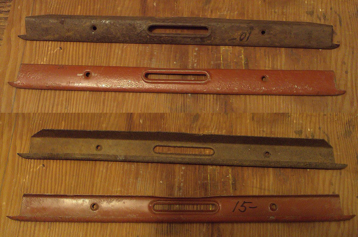

Post by Rich Eagle » Fri Jan 10, 2020 1:29 pm
I don't have better photos. I went out to the garage but apparently don't have any of those.
These are earlier ones '20 or so. There may be similarities.

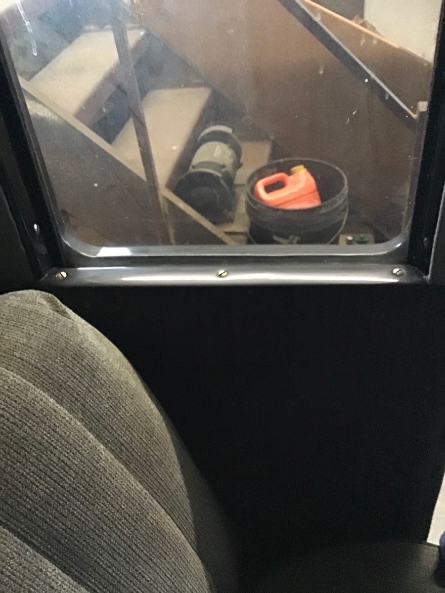

Post by John kuehn » Fri Jan 10, 2020 3:33 pm
Here is a pic of the inside lower trim piece in my 24 Coupe. It has to be installed first and then the side and top pieces. You might could squeeze it in but it would scratch the paint.
You can see that it has 3 screws for attachment.
There is a post in the classifieds selling Coupe body parts. Maybe he has some interior trim pieces. These don’t show up to often. There is no reproduction interior closed car trim being made. Good luck.

Post by Robert Lawson » Fri Jan 10, 2020 4:21 pm
Thanks for the picture. I figured the piece had four holes because the piece it mounted to had 4 holes.

Post by Rich Eagle » Fri Jan 10, 2020 4:45 pm
The bodies did some evolving through '24 and '25. It may be that the number of screws to hold that piece was a mid year change or a difference with suppliers. The 3rd photo I posted shows 4 holes as does your car.
FWIW Ford called that piece a Strip (Quarter Garnish Finish) and listed a R. H. and a L. H. 17390X and 17391X 1924-25. I can't tell you what the difference would be.
