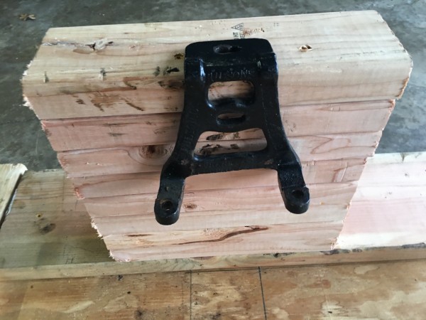

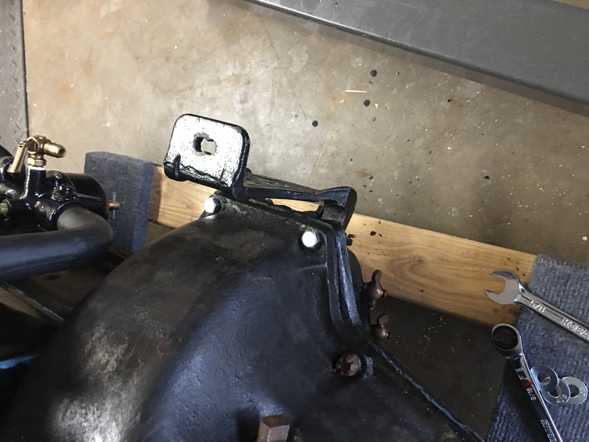

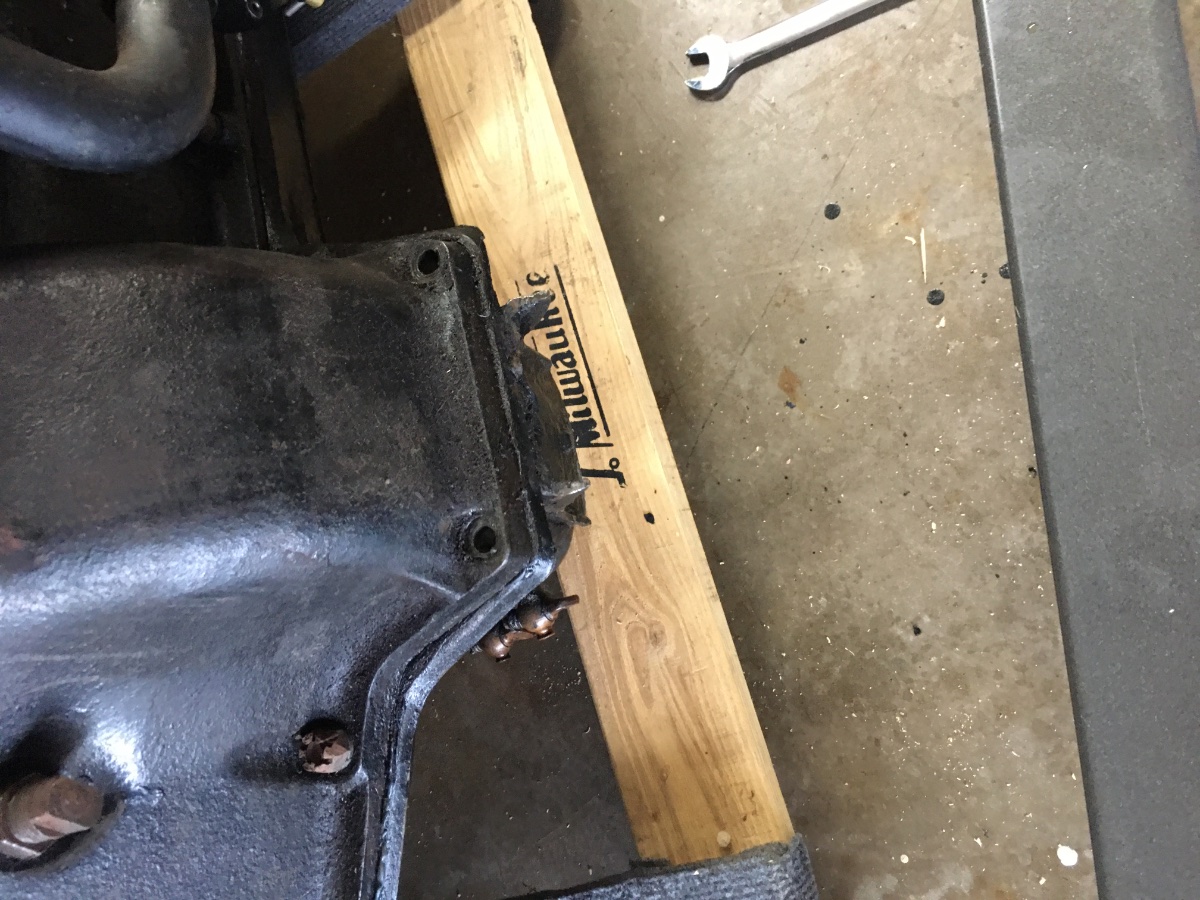

Also when I removed the motor I noticed that one of the ears that bolt the motor to the car is broken
Oddly enough there is a repair bracket that was bolted to the frame but not to the motor.

If that engine is using a 3 dip pan,I would locate a later 4 dip pan and replace the pan while you are this far along.It will make bearing adjustment easier down the road.
I may have a pan ear on a rusted pan I could remove and send to you to rivot to that pan and braze it but,if it is a 3 dipper,now is a great time to upgrade.
