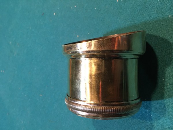

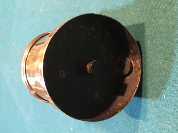

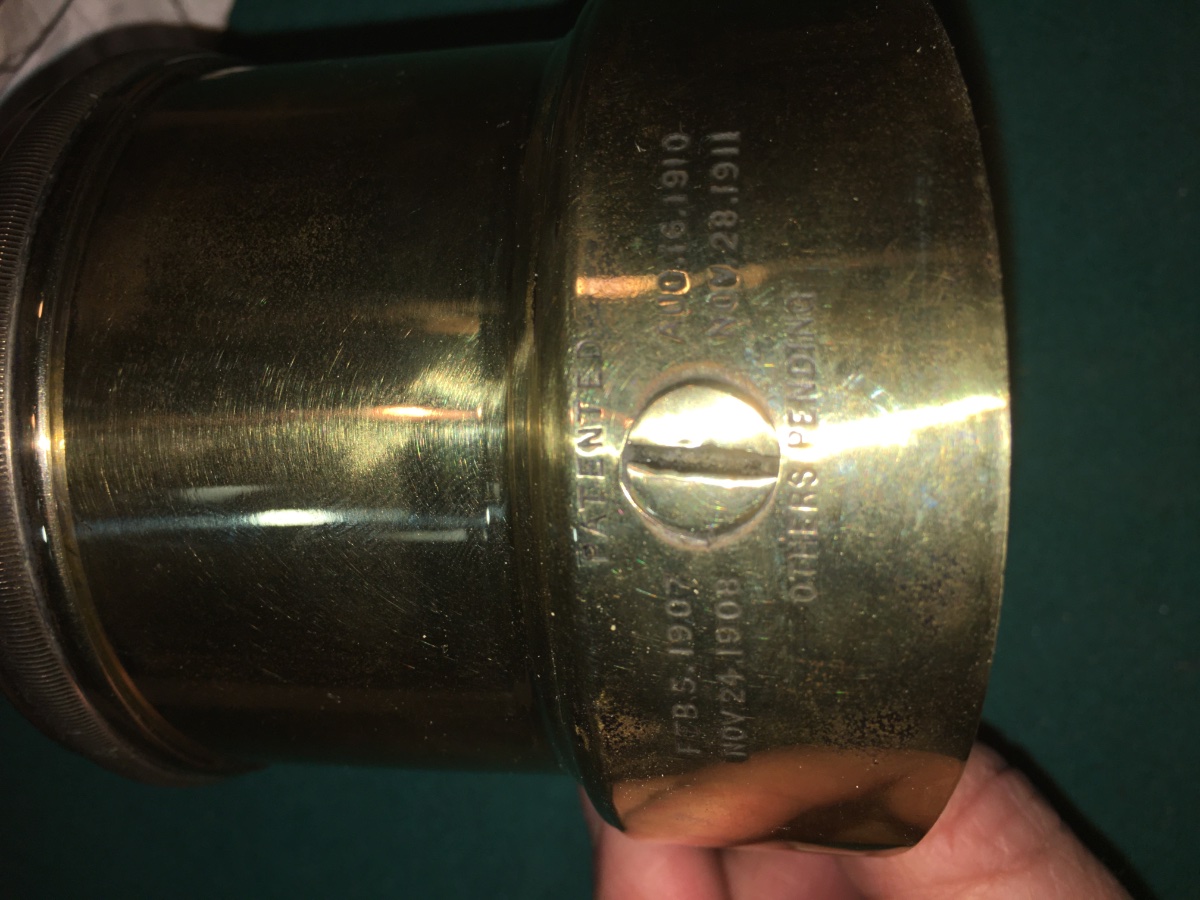

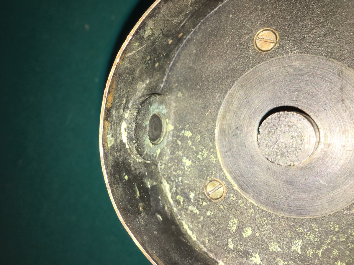

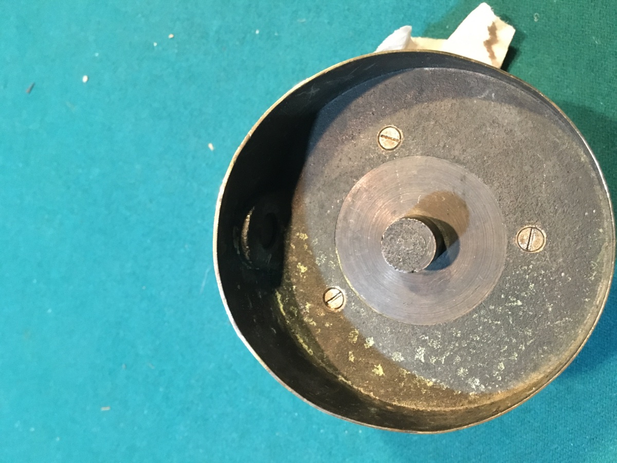

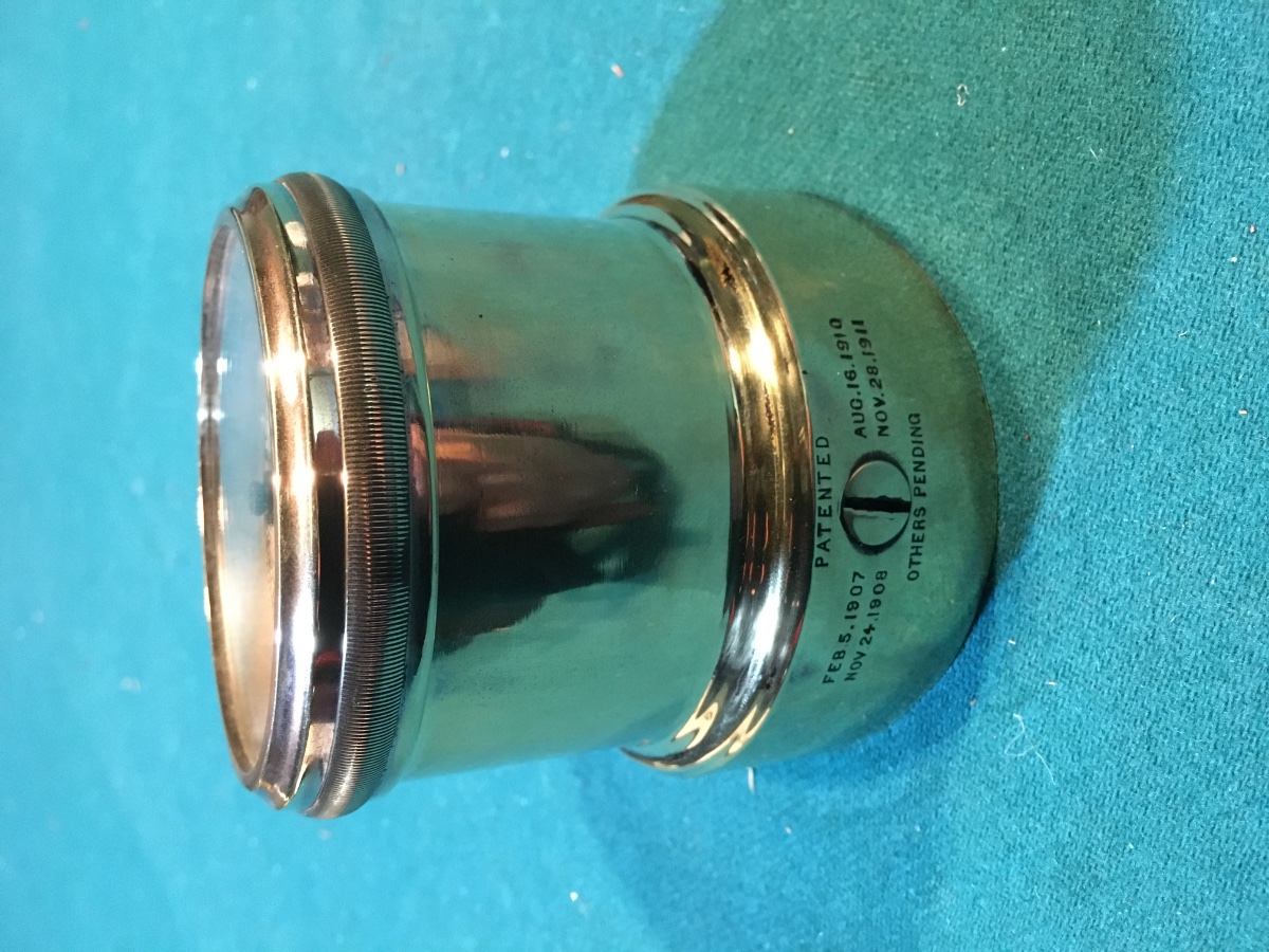

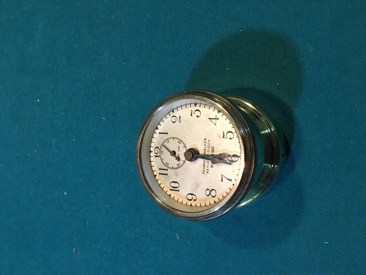

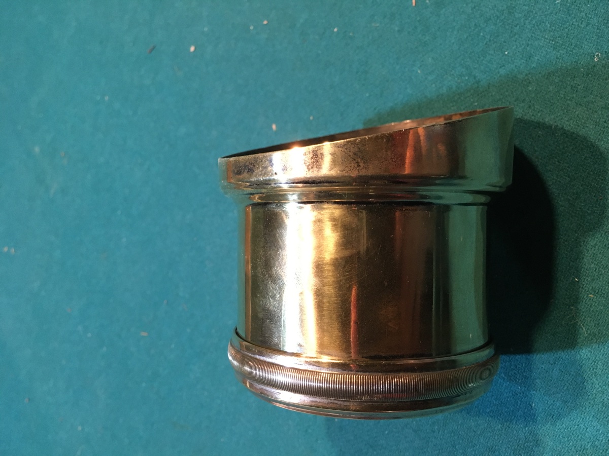

Here is a Phinney Walker rim wind with a angled case. How does something like this mount on the dash? It has a set screw on the bottom. I’m thinking that perhaps there was some sort of bracket that it mounted to in the firewall. Any help much appreciated

Mike, yes , you are missing the mounting bracket. I think I have one that would show what’s missing. Easily made. Nice clock! The small hole cover is often missing, so you are good to go there.

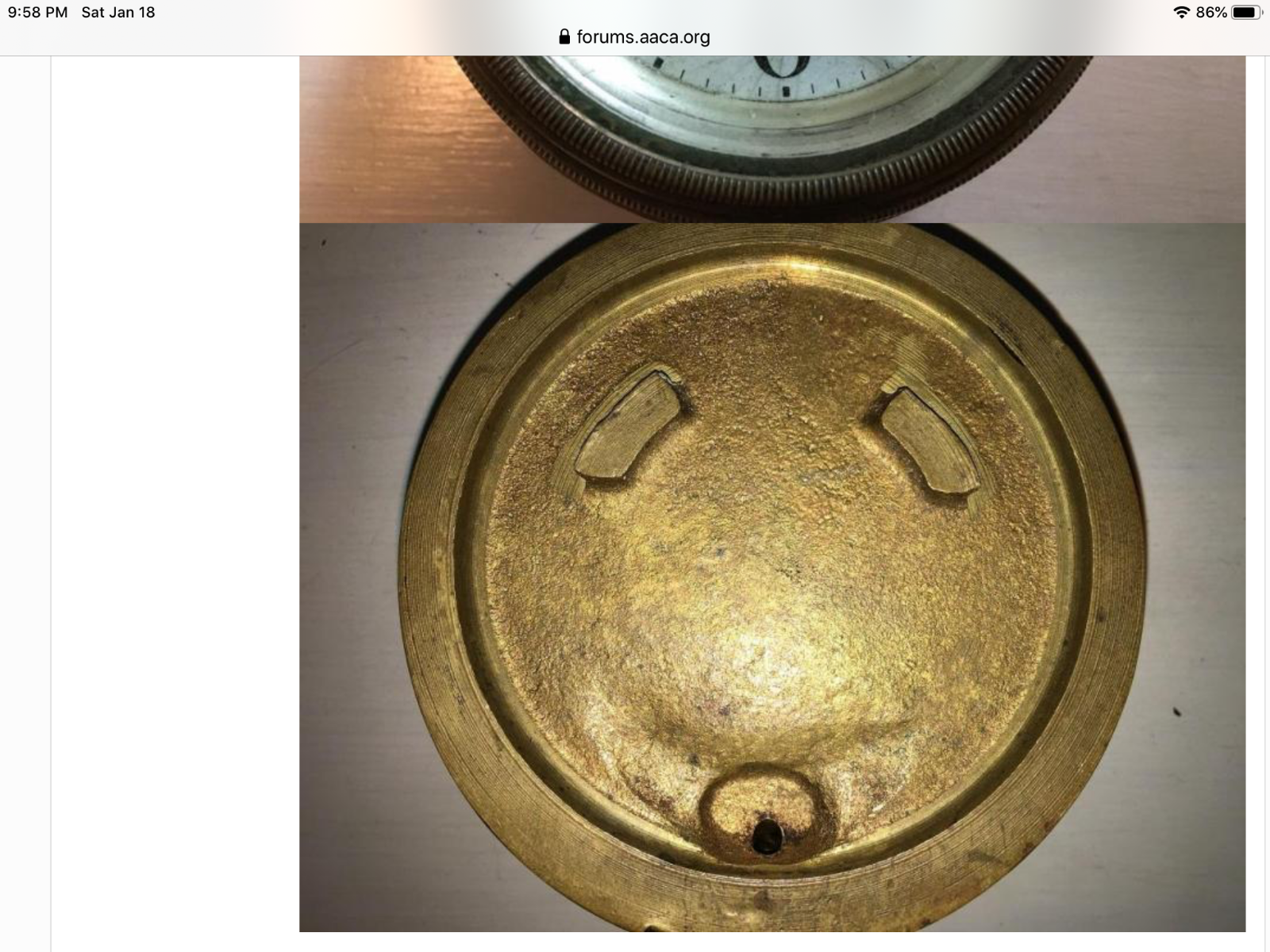

Mike, I have two here that are different. I’ve got another that’s off for repair. There will be a plain looking bracket of some sort that will get screwed to the dash. your clock will hang on this bracket, and opening the cap at th bottom, and reaching a screwdriver up inside will attach it securely to the bracket, making it rather difficult to steal. Putting a $10 clock on an original vehicle was quite the expense back then. I’ll post a picture of another type, this one hangs on two angled tabs, and then the screw will secure. Yours uses that big center pin, I think. Good luck, I’m sure you can make something that will work.
