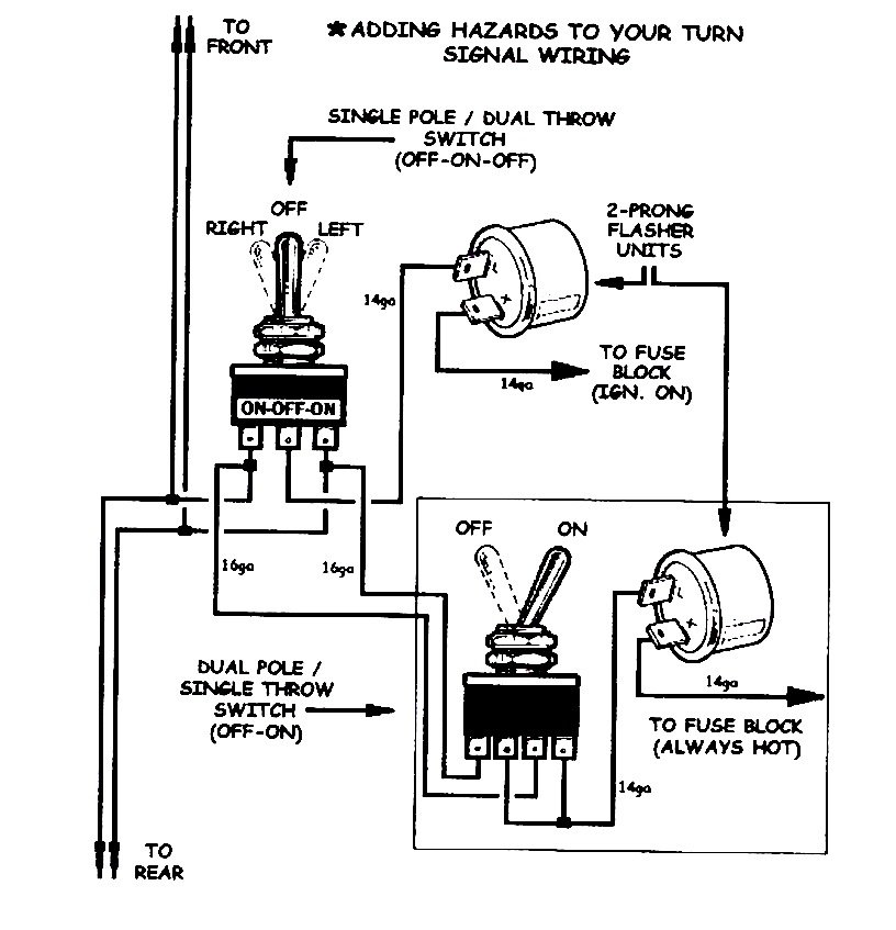

Here are some previous posts on the subject.
Screen Shot 2020-01-24 at 10.22.40 PM.png (19.79 KiB) Viewed 6196 times
NOTE: In this diagram the right/left switch should be labeled ON OFF ON.

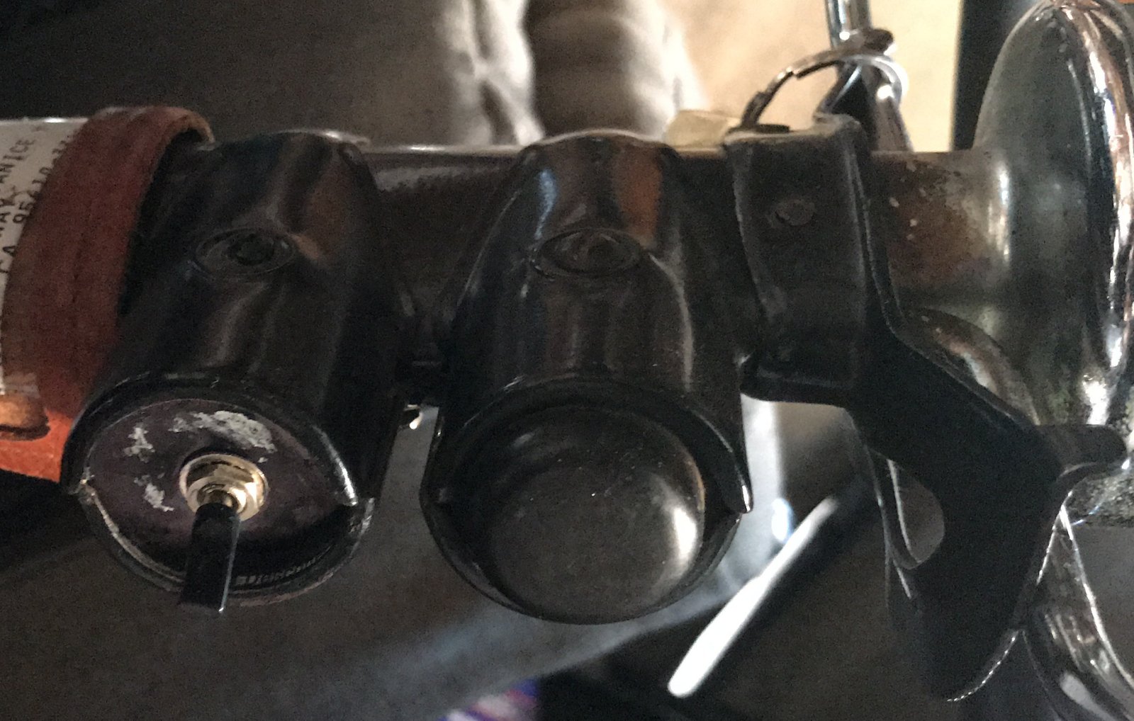

There was a photo, I think on the old forum, where someone put a toggle switch for turn signals in a standard horn button housing. Mounted on the steering column, it didn't look out of place.

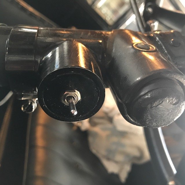

One using a horn button housing and one using a modified PVC pipe "T". If you are going to combine the turn signals with the brake light using the schematic above you will have to add some diodes to isolate the front from the back.
