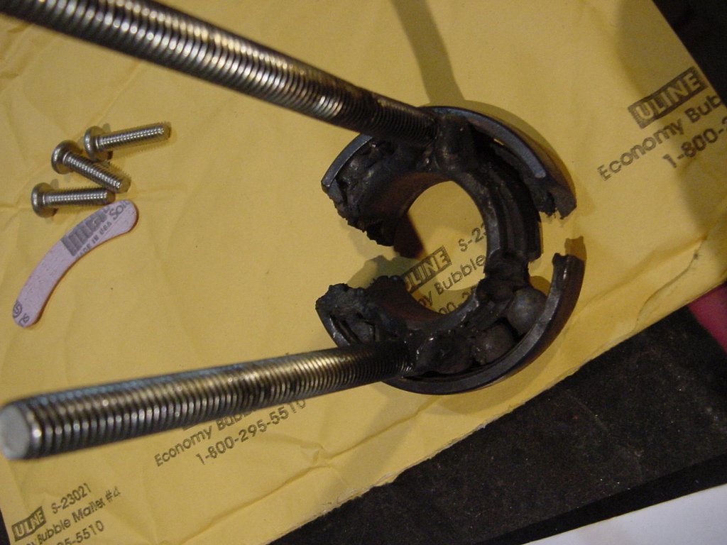

1 of my neighbors I have always been able to depend on to help me if I really needed it called me 1 day last week and ask if I could help him fix his old mortar mixer. "sure". Turns out he was in the middle of a major job and needed it bad.
WOW, 1 day i will learn!
anyhow, the bearing was up in a pipe and there was no simple pulling to be done. THis is what I wound up with.
I welded 2 peices of threaded rod into the bearing and then had to cut it off the shaft and out of the pipe.Didn't scar either 1! I was LUCKY.

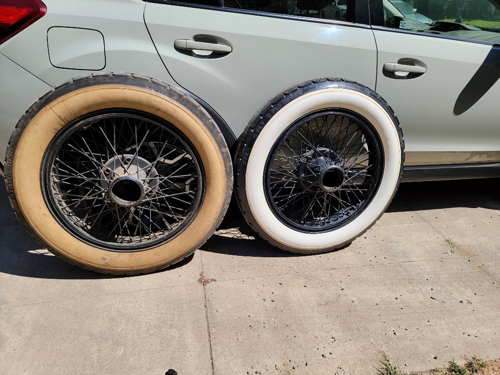

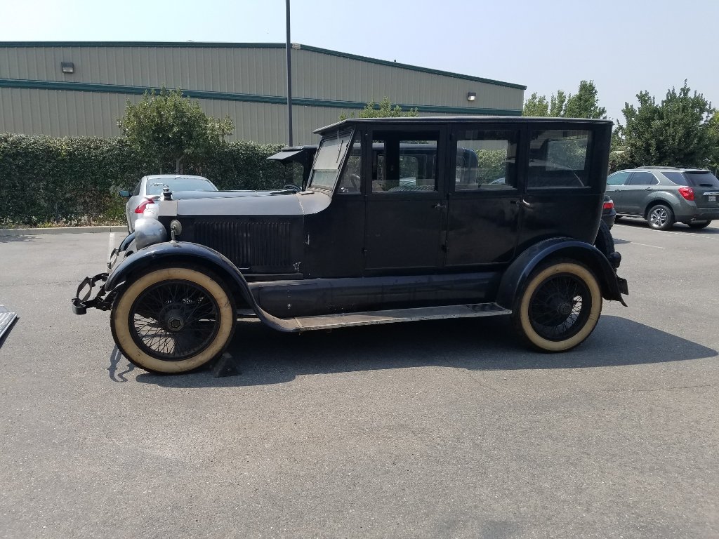

After a horrified look at what new tires would cost for the Stanley sedan, it was times to stock up on jumbo-sized jugs of Blechewhite and a new box of SOS pads
5 WoodenWheels

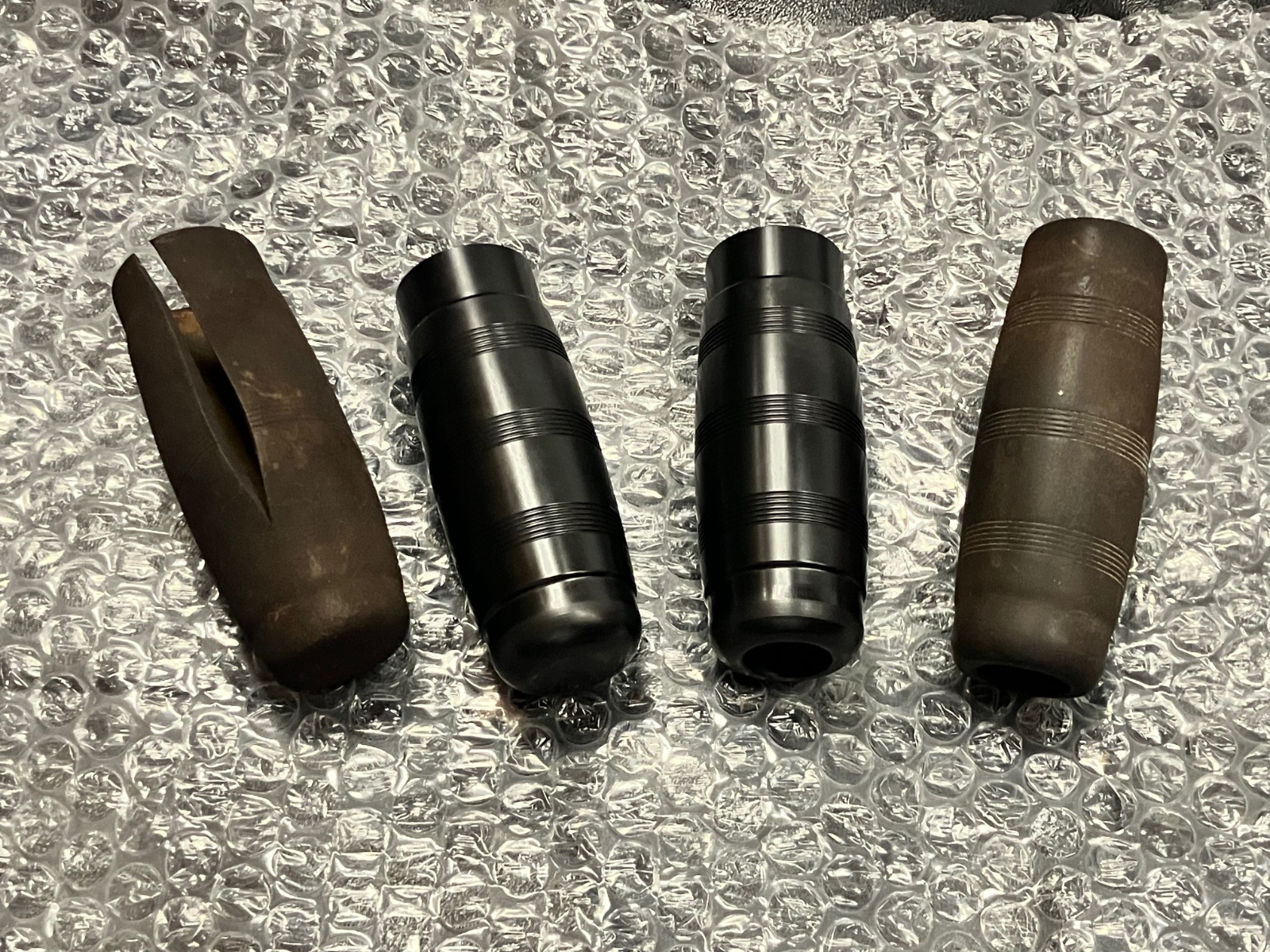

I took my 1973 Vélosolex French motorized bike out of the garage and thought about putting the fuel system together. Then I went and did something else. Need to put the headlight assembly back on as well. Lots of work and a few parts to get it to this point, won’t bore you with details. Very popular in France for many years, cheap and reliable transportation. This one was intended for the American market, imported through Detroit which was a hub of distribution. Gerrit

Dan, from my standpoint the discolored whitewalls are beautiful. Thanks for taking pictures before scouring them.

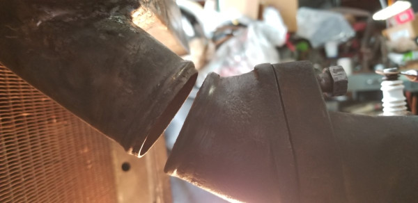

Over the last six weeks or so, I have made a few opportunities (read that as neglecting Responsible Adult chores and obligations
) to work on my '14 Metz Model 22.
I removed the radiator, Again, in hopes of making a permanent repair to a persistent leak. As I was beginning to mount the radiator back into the car, I stopped and gave more consideration to a possible underlying cause to the persistent leak, something beyond my previous failed soldering jobs.
Those of you familiar with brass Ts know that, unlike the later cars with their spring cushioned radiator, the only cushion is a piece of leather under each ear of the radiator.
My Metz has none. The Metz automobile is no where near as well documented as our beloved Model T. I don't know if there was supposed to be a leather cushion used or not.
I added a piece to each side and installed the radiator. The radiator inlet and the cylinder head outlet are now better aligned than they ever have been and I am hoping that this will reduce the stress on the top tank.
There is more to reassemble and then there are few bits to fabricate for the transmission, replacing those which fell off during the last outing.
Bill Harper
Keene, New Hampshire
- Posts: 8665
Re: What have you done on an old non-Model T vehicle.
Does the Metz radiator have a lower mount similar to a Model T? If so, a pad both under and over the mount would probably be advantageous. If possible, a spring under the bolt head or nut would be of further advantage. More distance between the radiator neck and the water outlet would also help isolate the radiator from vibration and strain, but I don't see how that could be accomplished, other than using a "live" hose and keeping the clamps away from the ends of the metal parts. I'd want as much flexibility in the upper and lower hose connections as can be had, short of modifying original parts.

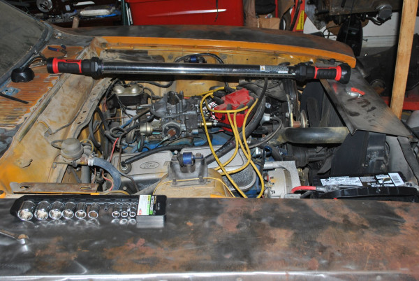

After almost 3 years I am finally getting back to work on my late wife's 1972 Mercury Comet. Here's where I'm at now.
Bryant
- Posts: 1232
- First Name: Bryant
- Last Name: Shafer
Looks like your not to far off from driving it out of the garage and to a paint booth!
How many cubes are under the hood?
Got a color in mind?
Bryant
Bryant Main color Blue The Back panel and lower body line Satin Black And Bright work will be powder coated Satin Black
Interior Powder Blue (She Choose The Colors)
302 (5.0l for the young guys)

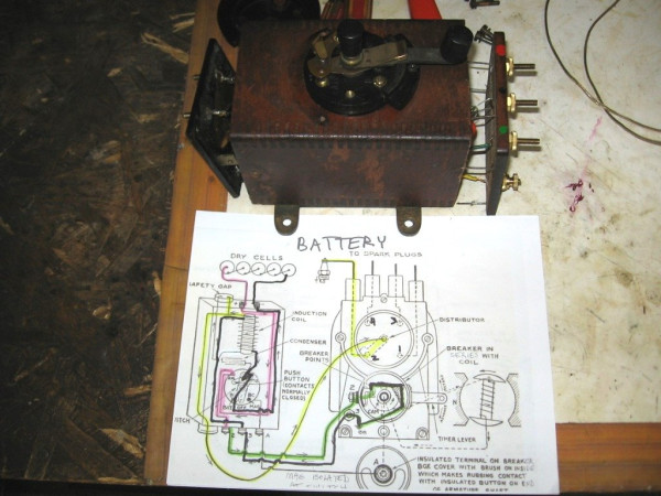

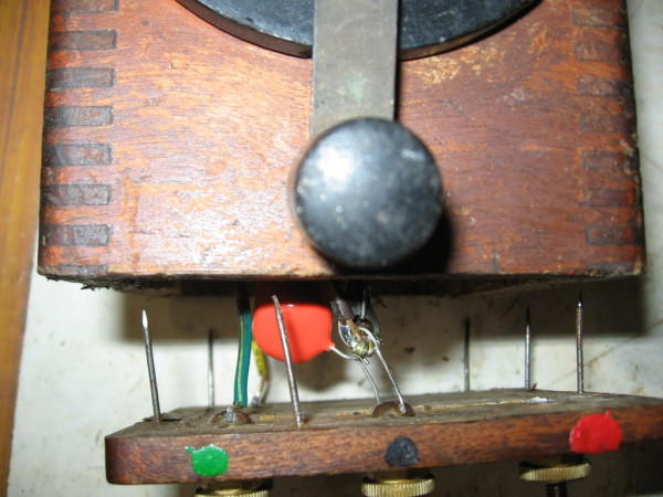

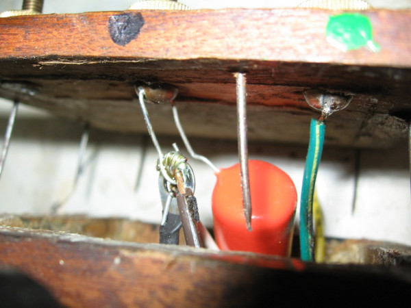

I am finishing getting my 1910 Stoddard Dayton out from a deep sleep. It is an original unrestored car. Lots of little thing to check out.
Today was what I thought to be a simple fix. There is no dip stick or pet cocks to check the oil. Instead they use a sight feed glass with a rod and cork floating in the sump. The cork was heavy with soaked up oil.

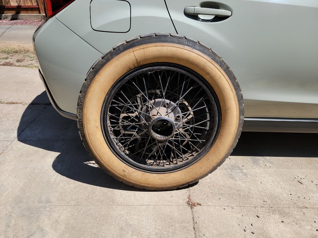

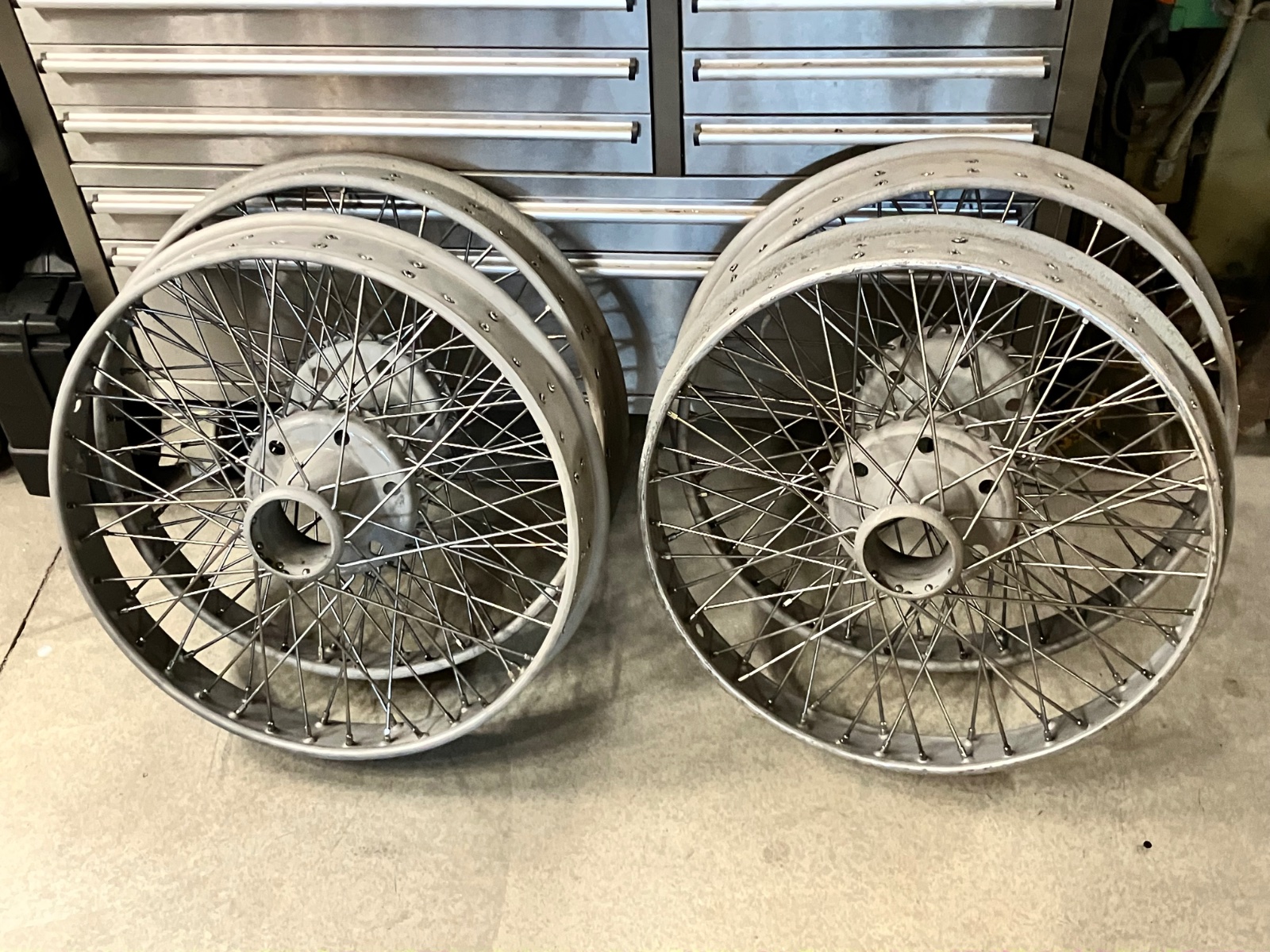

Rebuilt a set of #4 Houk, 60 spoke, 24” lock ring rim wire wheels for a 1919 Detroit Electric. Just need true and paint. Also made a new hub cap to accept an original factory accessory Veeder hub odometer and replacement steering column control grips.
Last step is to make new lock rings to fit the rims. The only fella in the world that makes these rings ran out of material, and won’t be making any more. Sooooo, I had some rings cut from 1” plate and gonna load em in the mill today. We’ll see how it goes…

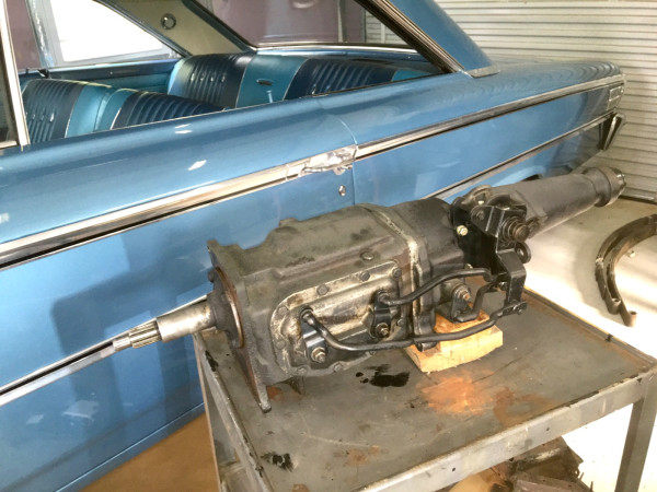

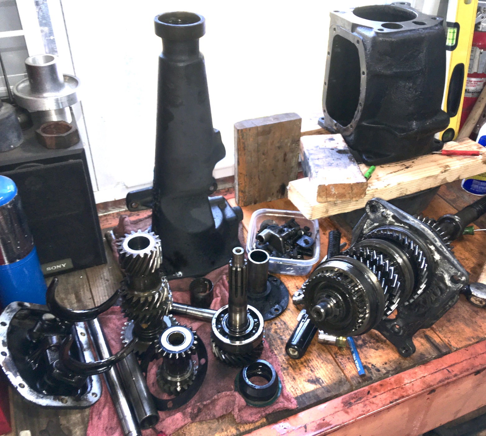

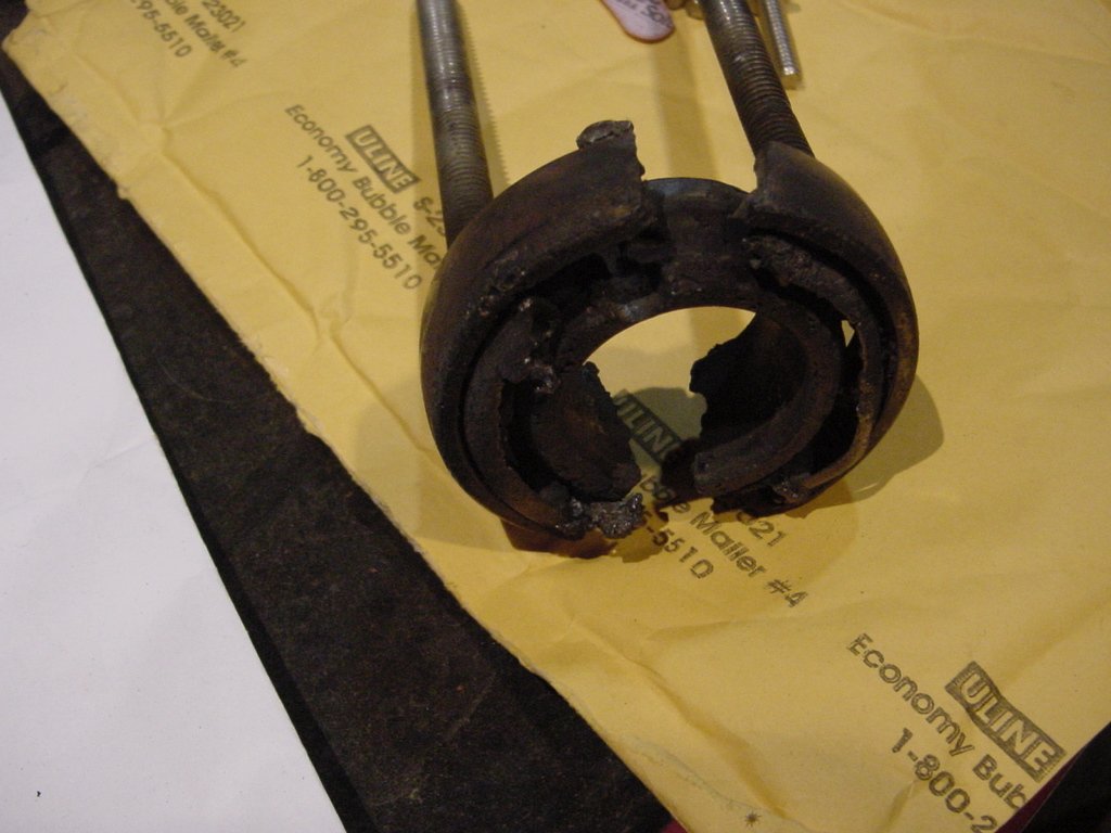

Broke a tooth off 1911 Hupp pinion. Decided to replace rear end internals & driveshaft with Model T ‘guts’. Went from 4:1 ring/pinion to 3.63:1. A new Hupp friend in OR made the adapter plate enabling the T ring gear.

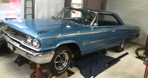

I've seen Hupps with a whole Model T differential case and Ruckstell installed on the Hupp axle tubes.George House wrote: ↑Mon Nov 10, 2025 12:28 pmBroke a tooth off 1911 Hupp pinion. Decided to replace rear end internals & driveshaft with Model T ‘guts’. Went from 4:1 ring/pinion to 3.63:1. A new Hupp friend in OR made the adapter plate enabling the T ring gear.

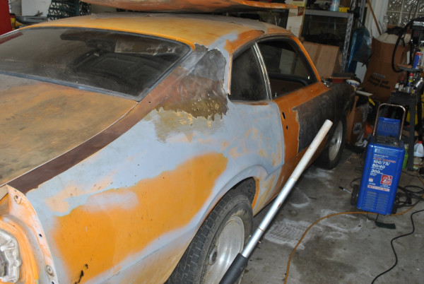

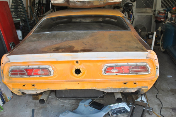

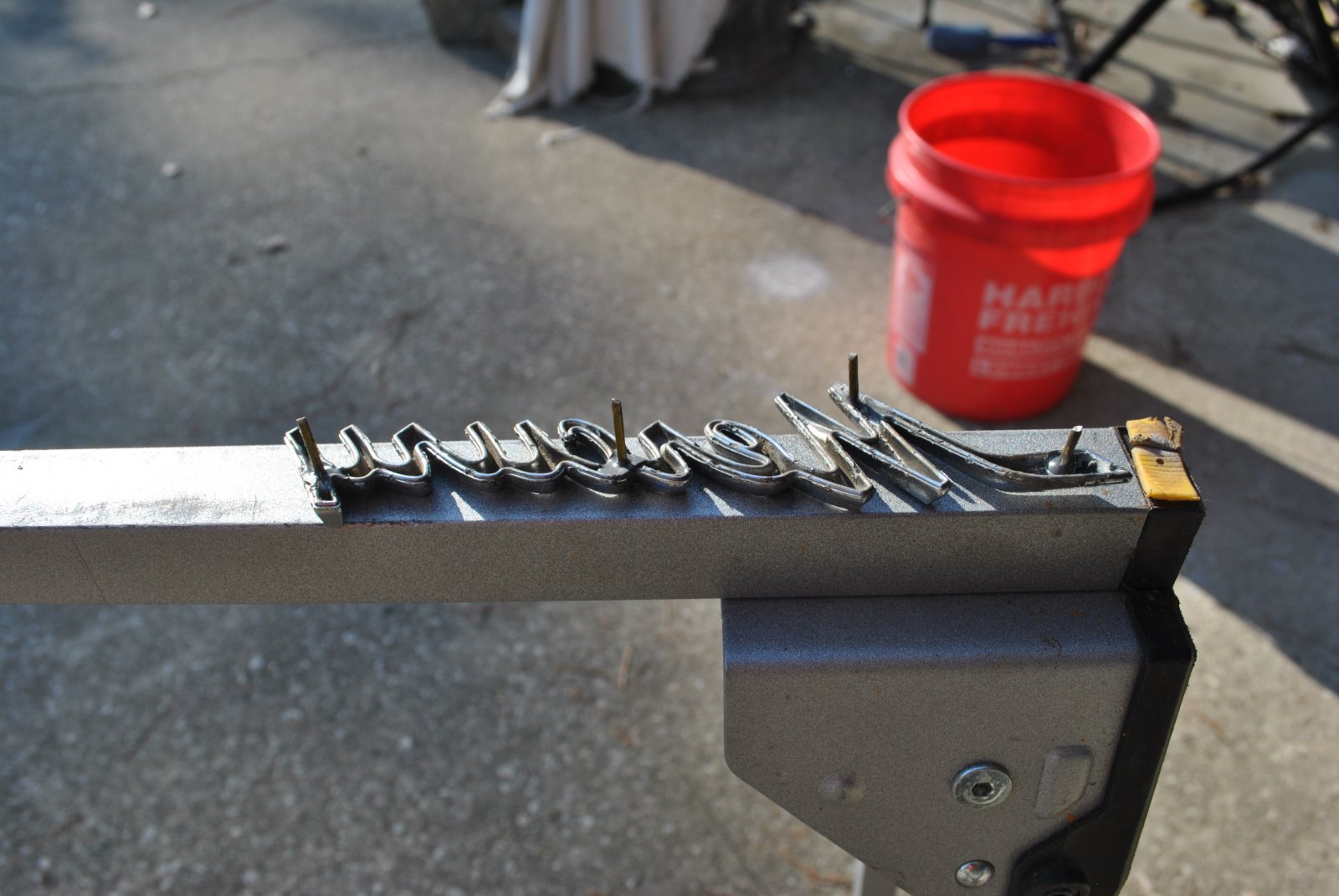

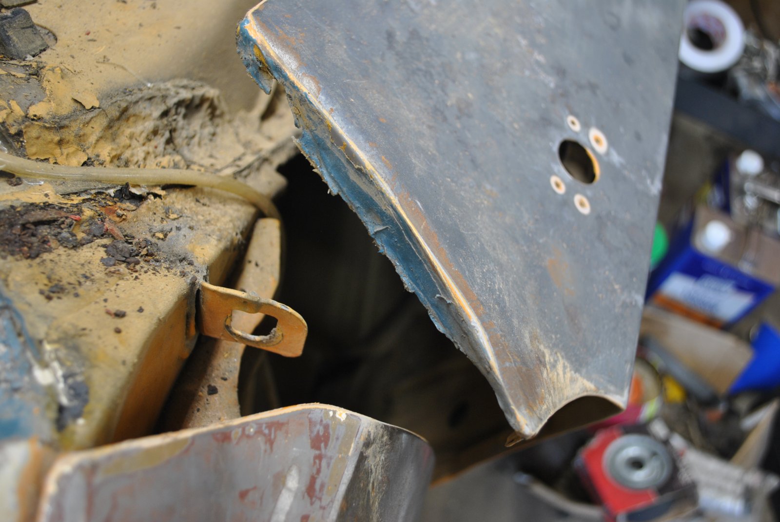

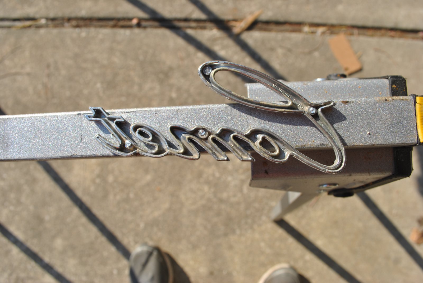

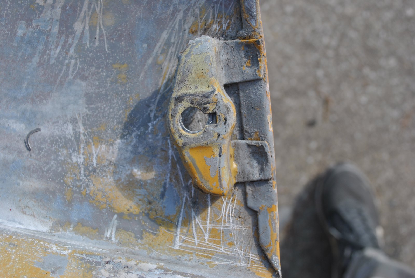

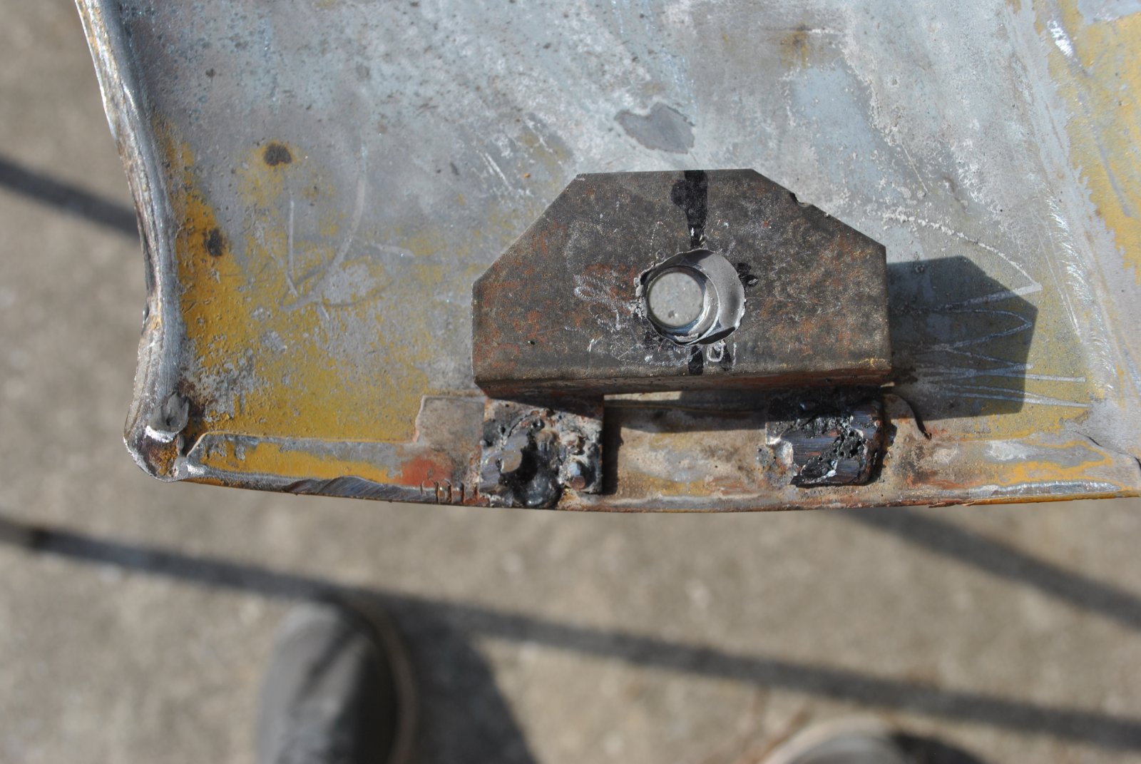

While working on the 1972 Comet I found some broken parts.
The rear valance had a broken attachment which someone just drilled a hole and inserted screw
the badging had all of the "pegs" broken off and was reinstalled with double sided tape this is how I am trying to fix them takes patience of which I have very little!

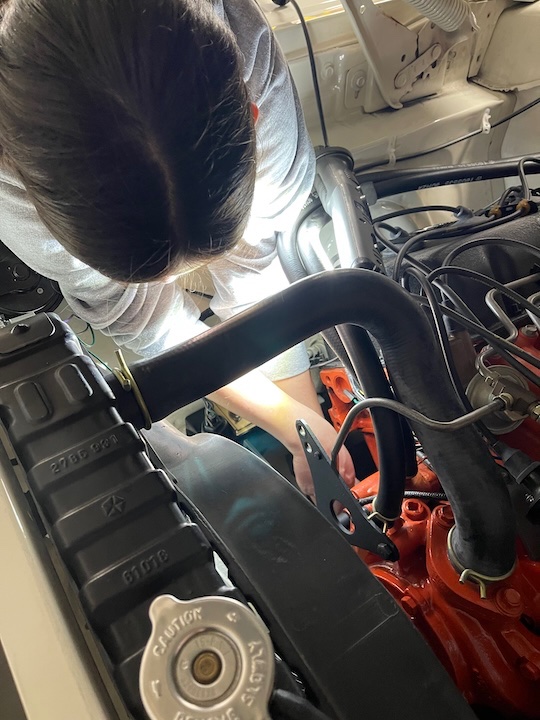

My Fuel pump left me on the side of the road. So my mechanic was home for winter break and she replaced it. The 69 Super Bee started right up.

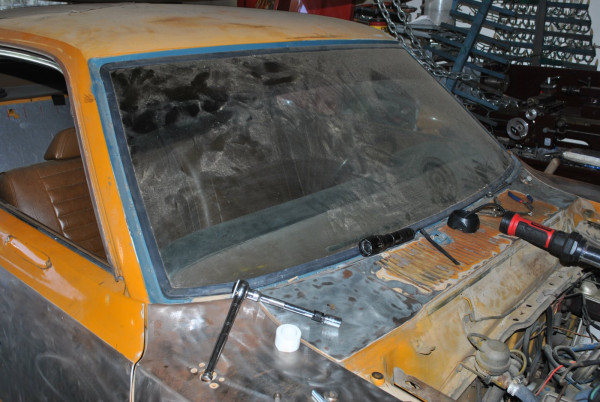

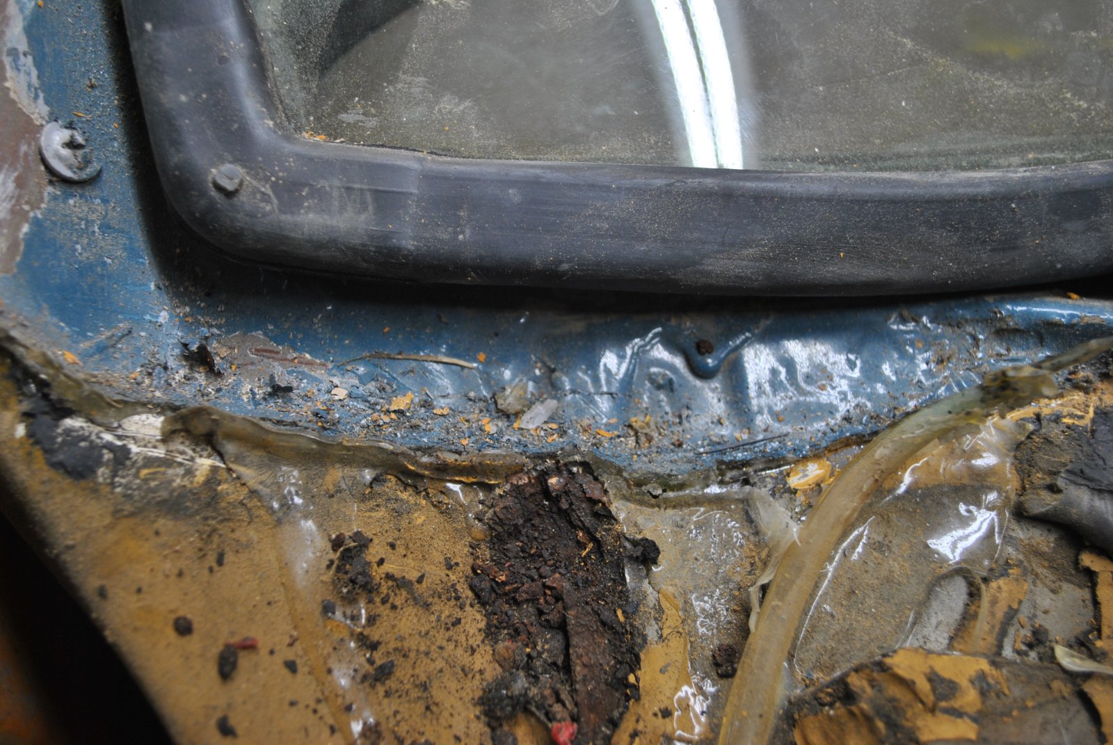

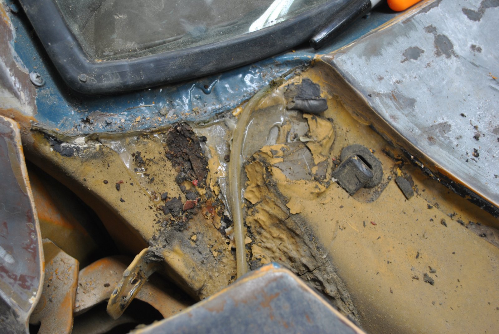

While disassembling the 72 comet to fix a couple of rust-outs I saw this I guess that is a redneck moisture removal system
