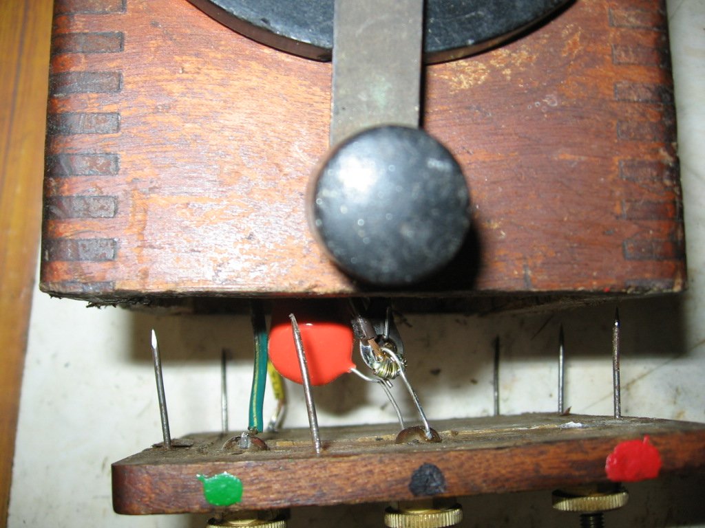

NOT a vehicle but it gets towed by 1.
1 of my neighbors I have always been able to depend on to help me if I really needed it called me 1 day last week and ask if I could help him fix his old mortar mixer. "sure". Turns out he was in the middle of a major job and needed it bad.
WOW, 1 day i will learn!
anyhow, the bearing was up in a pipe and there was no simple pulling to be done. THis is what I wound up with.
I welded 2 peices of threaded rod into the bearing and then had to cut it off the shaft and out of the pipe.Didn't scar either 1! I was LUCKY.

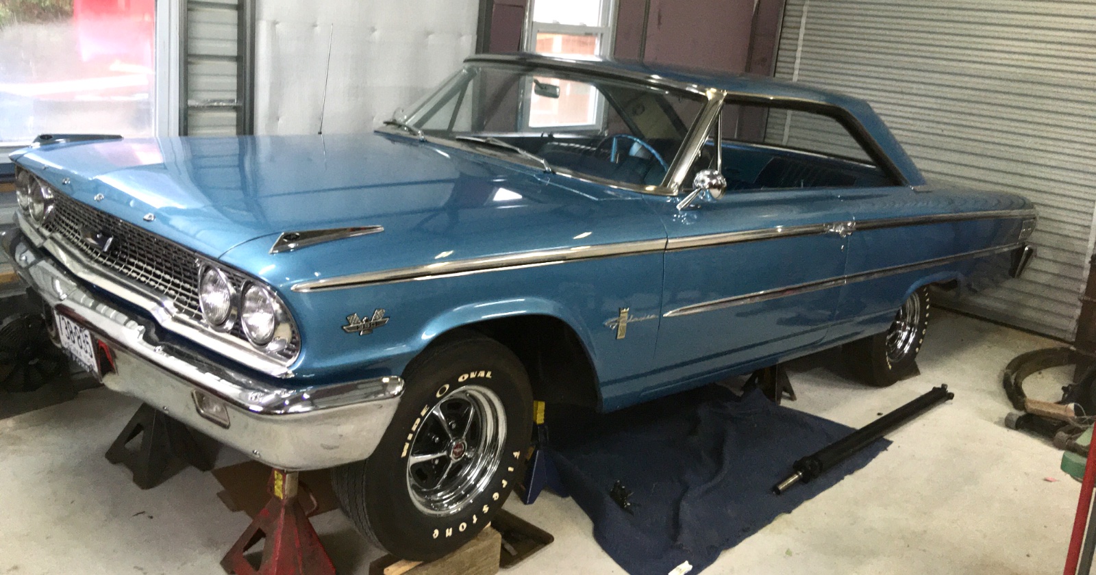

It’s been awhile since the last post. how time flys.
After the passing of my Father in-law, my family has been honored in taking care of his classic. 1963 1/2 Ford Galaxie 500. FE 390 4V 4 speed.
I went down to Virginia with our farm tow rig to pick her up. What a beauty! I will be going through all the maintenance and getting it set up in Maryland and back out on the road. First family outing will be somewhere that has ice cream.

Post by Bryant » Sun Aug 10, 2025 11:32 am
after a short drive I decided there was something off with the transmission. Popping out of 2nd gear sometimes and the speedometer cable was whipping between 0-120 mph like crazy!
found the tail shaft bushing out. Really wrecked up the driveshaft slip yoke. Time for a rebuild.
probably caught it in time. Things look a little wore out but definitely re-buildable. Between this and the Model T auxiliary transmission build I’ve been dreaming about gears….
