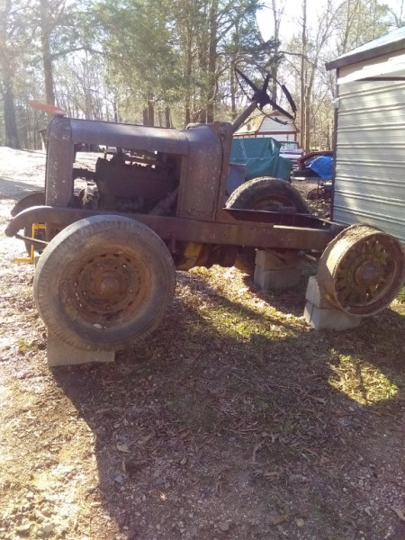

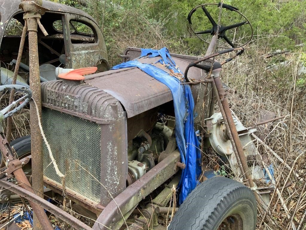

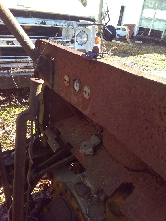

Well boy have I went and done it, Republic "shortdog" truck
Well the good friend of mine that helped me get started into Model T's back in the early 90's had this short dog truck for years.I have always wanted it but he would never price it to me. Even right before he died, I tried to get it and he didn't really want to get rid of it.
Well he was taken to the hospital and couldn't come home and later died in a nursing home back in may or june can't remember which, the hospital took his home,land and etc and alot of his stuff including a Pullford Model T just closed out on auction about a hour ago.
I figured it was time to #### or get off the pot so to speak and I bid on this thing wound up with it.
Best I can tell it is about a 1916 or so Republic truck,probably a 1 ton.
May be missing it's magneto.The chassis is cut short and the rear axle is bolted to the frame.
wheels are shot,fronts all but gone,has 39 ford wheels somehow attached to move it around.
I don't think the engine was stuck when he first brought it home but I would assume it is now.Online auction only, and had no idea who I was bidding against.
I may post more photos and such when I get it home this week.
Auction company only giving 2 short time windows for people to come get stuff and there is ALOT of stuff to be moved before I can even get to this. I also am supposed to be getting the peice of a cowl and model T axle and such that is leaning against it.

Almost looks showroom new !
Re: Well boy have I went and done it, Republic "shortdog" truck
I would like to see more of it. I had a friend who had 3 Republics. They were all different and he had one complete that ran for a while. I wish I had taken pictures.
It looks like fun.

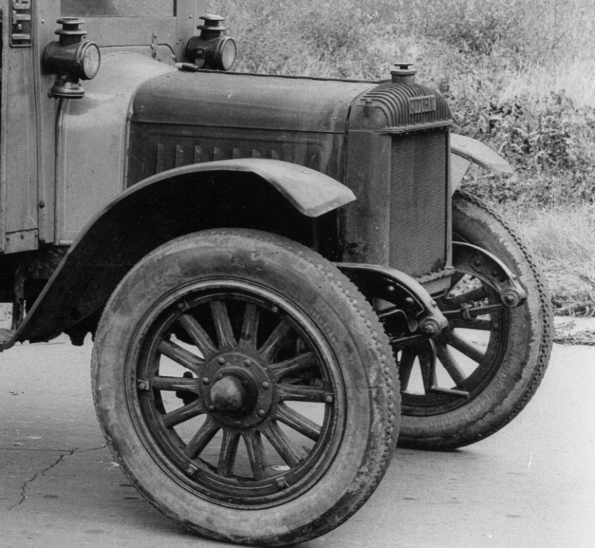

This was taken in 1923 but I don't know the year of the truck. It is a Republic. I will keep searching for more.

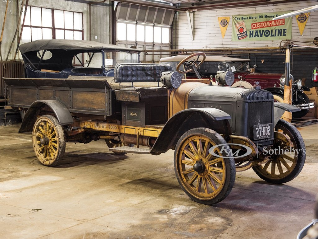

Here is an '18 that looks similar too.
https://www.bing.com/ck/a?!&&p=68b14302 ... jay8&ntb=1
It looks like a good truck site.

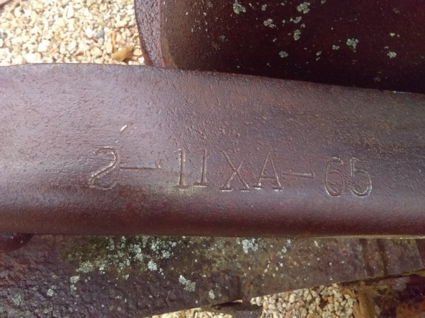

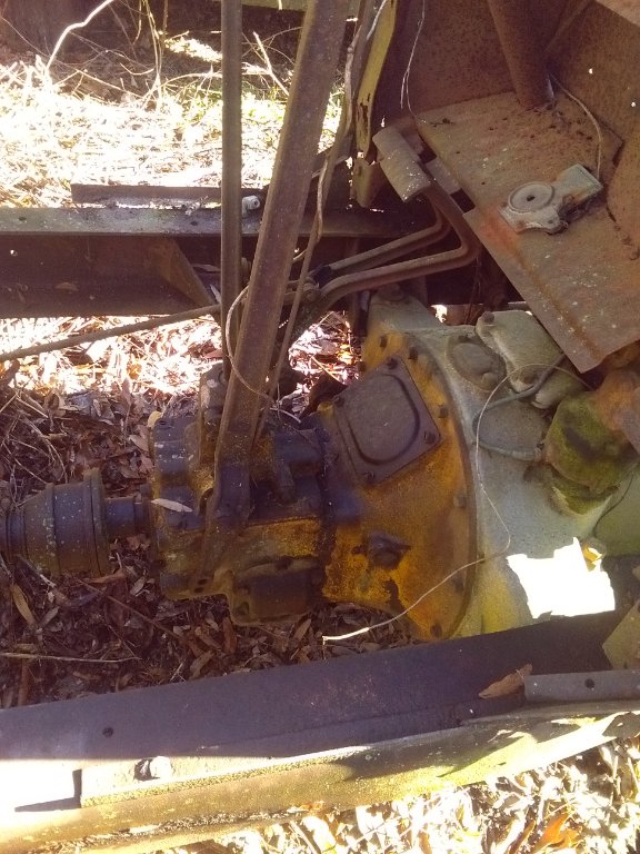

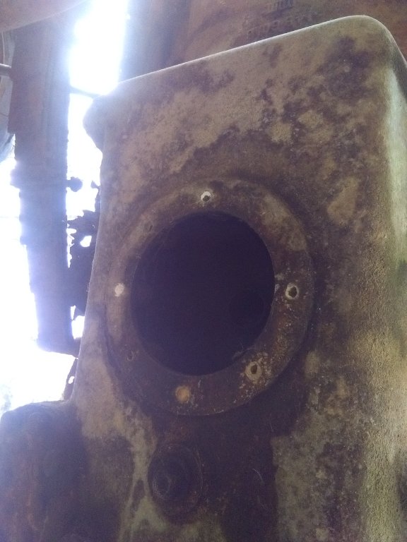

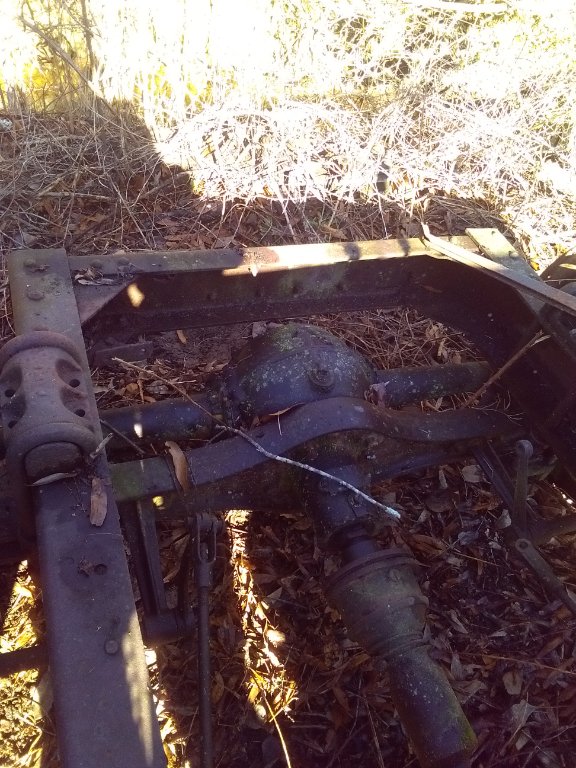

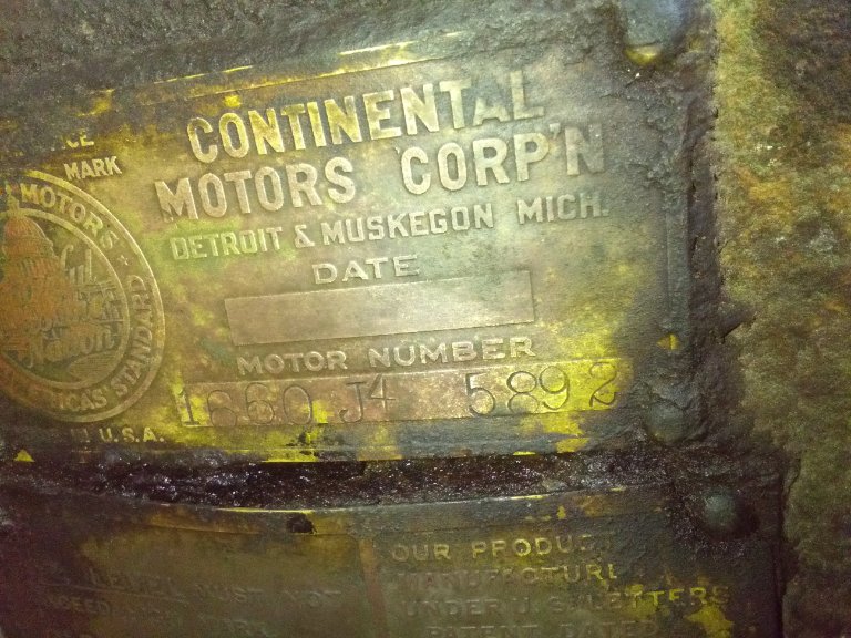

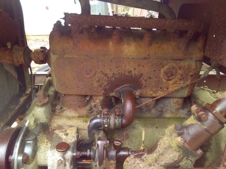

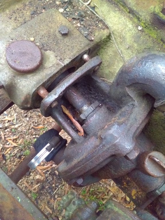

Well I finally got it home today, it has alot of issues. Left front spring is broke.
I did open the trans fill cap,it did not appear to be full of water ,still oily and "clean" same with rear end.
I can NOT find a dipstick or anything on the engine.
Thanks for the photos and ideas.

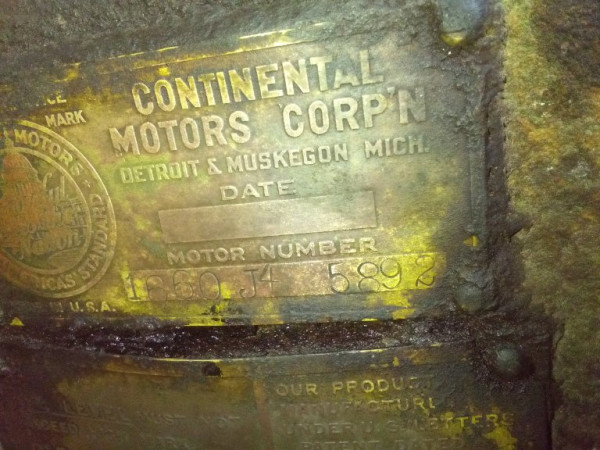

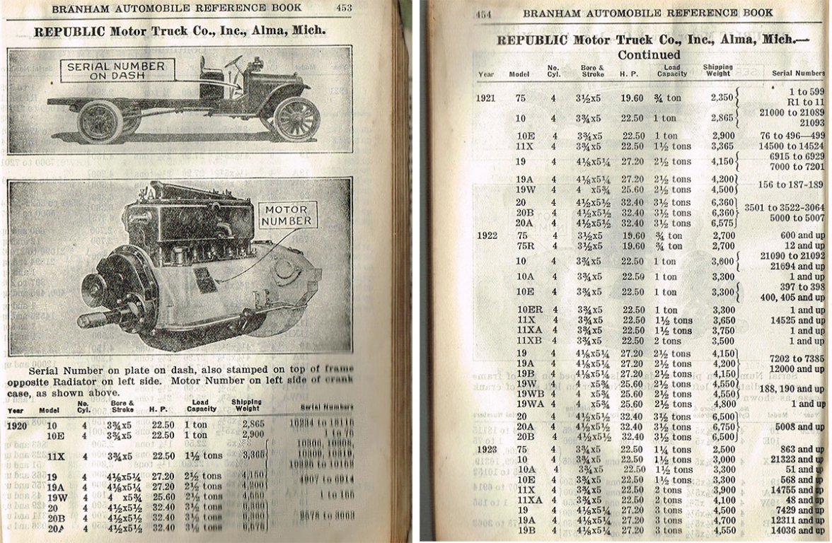

according to the numbers it is a 1 1/2 ton truck.
Has a Continental J4 I think, I need the American bosch magneto for it.IF it can be made to run.

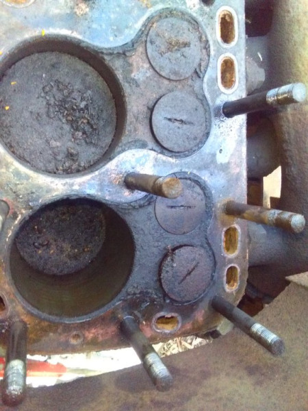

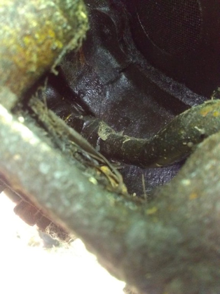

Pulled the spark plugs and no water in the cylinders, looked dry,some old carbon and not pretty but not rusted up down in there what little I could see.
I have been reading on the web and there was a site that tells about vegetable oil and acetone for penetrating oil.
Since the engine seems stiff or stuck,I am thinking of trying this idea. Can't hurt,
https://www.engineeringforchange.org/ne ... ating-oil/
I think I will go 50-50 mix like the acetone and trans fluid trick.

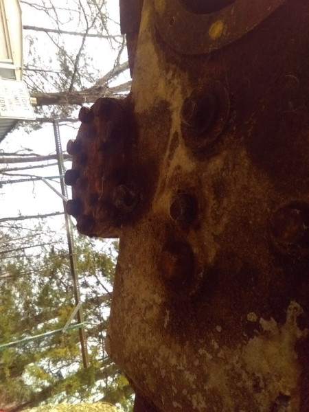

I can say for 100% sure,there is no water in the oil pan,and no oil. I jacked it up to fix a bad tire on the front and saw this, a plate missing on the bottom of the oil pan. Appears it was just a service plate. But I can not find didly squat on the net about these engines to find out what it was.
And still no dip stick or check plugs for oil level that I can find

This engine sold for $100. So, they are out there.
https://gjwilliamson.com/product/contin ... lic-truck/
My piston ring catalog shows the Continental J4 being made in 1920 and 1921.
This is from a handy little book I have. It may not be as helpful if you don't have a dash with a plaque on it but here it is for what it's worth.
It doesn't look like the Continental engine either but....
Sorry for the fuzzy numbers.
P.S. It does mention the 11XA like in your frame number for '22 and '23. '24 only has 11X, and 11XB.
Lots of question, few answers.
The piston ring info may be bogus. Arrow piston lists J4A as '17 to '25 and Perfect circle lists 11X J4 as '25-'26. ???

Thank you for that info,BIG edit
Ok so for 1922, the 11XA is listed as a 1 1/2 ton truck. serial 1 up
1923, 11XA is listed as a 2 ton truck serial 48 and up.
So according to my numbers, 2 11XA - 65 mine must have been number 65 off the line.
BUT does the 2 mean, perhaps 1922 sold in 23? or/
I can be specific now when searching and asking questions.

1922 4 221 11XA (1 1/2 ton) Stromberg M-1 1529
1923 4 221 11XA (1 1/2 ton) Stromberg M-1 1529
Now that is handy to know,so now if I contact https://www.thecarburetorshop.com/TruckkitsR.html
I can order the correct carb kit.When I get to that point that is.

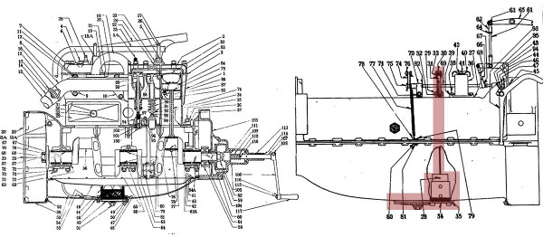

Mack,...a plate missing on the bottom of the oil pan. Appears it was just a service plate. But I cannot find didly squat on the net about these engines to find out what it was.
My guess is that the missing part is not an inspection plate. I believe what's missing is the oil pump. It would not be uncommon for the pump to be fitted in the bottom of the pan and accessible by simply unbolting it and dropping it out. Look way up inside the hole for evidence of a pump drive coupling, such as a male or female spline.
- Posts: 4516
- Location: Michigan

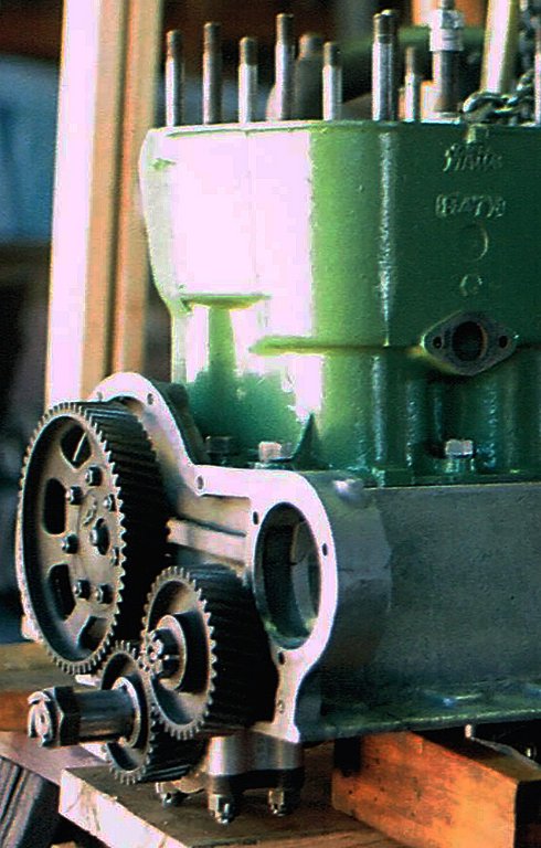

Just for reference, I show my 1923 White engine details. The shaded area is a similar cover and my oil float and sight glass. Some of the Republic design may have similarities.

Ok,well, there are 2 other cover type things further back,I didn't see anything on the first look in there but now that I know what to look for I will look again.If the oil pump is missing,that shoots this thing in the foot!

You have probably seen this '16 on the RM site but I can't help but notice how similar it is to what you have. They must have used much of that later.
"220.8 cu. in. Continental Red Seal L-head four-cylinder engine."
"Just Sayin"'
Just some more details of it.
https://www.conceptcarz.com/profile/234 ... Truck.aspx
"Just Sayin"'
Yes that is a nice original truck, wish mine was closer to that condition.
Well I just got out from under the truck and the oil pump is off to the side,and is there and all pipes are in tact.
What a relief,now just back to figuring out what is missing.
EDIT, I got in the house where I can add photos.
Here is the underside showing what I think is the oil pump and there is pipes inside all connected up to stuff,nothing loose or hanging. Maybe nothing missing?
Another edit, some of the PB blaster is going all the way thru and is about to start dripping out the bottom! So perhaps all pistons are not in terriable stuck condition.

Awesome! Happy for you that it's not missing its oil pump!!

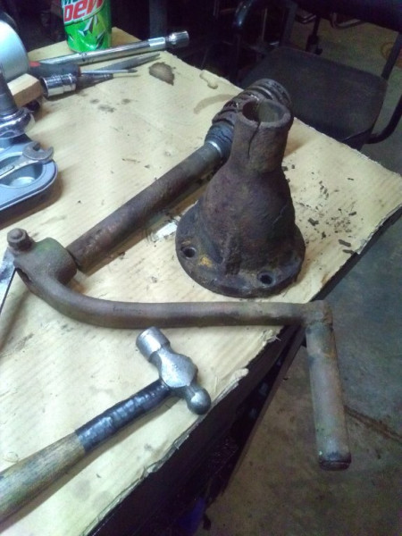

This is not a project I can rush on if I wanted to,but I have done a little.
First and foremost I had to move to a better spot as the hauler was in a rush and I was not at home.
But the handcrank is not straight , gear shifter is in the electrolysis tank so I can free it up.
Clutch releases by the pedal as I looked inside with the cover off, gears look good in the trans,as in no stripped gears and not much debris,should wash out with some kerosene.
I am still soaking the engine and such.
looking forward to more info on this particular engine if anyone stumbles over anything they think may help.
Apparently there are no very active vintage truck forums,the 1 i joined ,well, not much action.
Here is a couple photos,you can see how short the truck was cut down to for a tractor.

Take your time and savor the fun. Too many projects get rushed.
I had an 18-year project and have some that may take that long.
I'm enjoying yours now.
well we had a spring like sunny day today and cuirosity got the better of me,I have wanted to know what was under that cylinder head.
So off it came.
And I am pleasantly surprised.
Some carbon, a slight ring groove,I have saw alot worse.
nothing in bad shape.
the other 2 look the same. I put a 1/4 inch of red kerosene in each cylinder .I will see what is gone later.

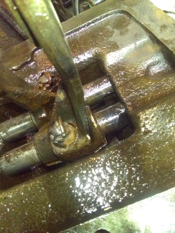

I am having difficulty getting the shifter freed up. I can peck each shaft back and forth with a hammer and brass punch. I took 1 ball and spring out but to remove the other I would need to take forks and such out.
Just won't free up. I soaked it in the electrolosis bucket and after pecking on it a while and making things more moreso,i just put it back in the vat and will leave it a few days.Any hints and tips on freeing that up would be appreciated.
So with the cylinders being clean,as in no gaulding, makes me wonder what is stuck. I will check the water pump next. But I am trying to figure out,will taking the 3 nuts off that are on the engine remove the pump?
So off it came.
- Posts: 8725
I'd want to gently work the valves loose before trying to turn the engine, and keep soaking everything. If you can get the crankshaft to move, rotating it a short distance forward and backward is often helpful, while adding lubricant and slowly increasing the range of movement as the engine frees up. Almost anything can be stuck, so caution is needed. Pistons, valve stems, and valve lifters often stick, but I'd rule nothing out, including the oil pump and water pump, if any. It's encouraging that the cylinders show no sign of having had water standing in them.

Any pointers on how to free up the shifter a bit better?
I can bump the rods back and forth with brass punch and hammer but they won't budge with just the shifter lever.
Soaked in the electrolysis bucket for a week,rust GONE, heated with torch and penetrating oil applied,with alot of tapping and so forth.
I am wanting to make sure the trans is in neutral.
IT may very well be that I have to take this engine plumb apart as I can't even figure out how to get the water pump loose .
It may have a fiber timing gear and I don't want to break it.
I had this one posted on the This was Trucking thread on the OT forum.
Rich Eagle said it was a Republic. There are other photos of Republics on there too.

Disassembly of rusty machinery is always challenging ! I don't know anything about electrolysis, perhaps it is not penetrating ? I have had the best luck with penetrating oils, "Liquid Wrench", "Knock 'er Loose" and "S-OaK". Heat can sure help, tapping and "nursing" slight movement, more penetrating oil, and lots of patience ! You're doing great ! Thanks for showing us.

I think you're going to have to loosen up the clutch forks and tap the shift rods out completely in order to clean/polish them up. Might be a good idea to remove the timing gear cover to see what's on the other end of your water pump. Probably some nasty stuff in there anyway that would be good to wash out. Keep us informed! This is fun!

If it has a timing cover, I would remove it as Jerry mentioned. Here is how some of the gears are held on on my White.

I am afraid you all may be right about taking apart more than I really hoped to. I have the rest of my life though to get to it!
