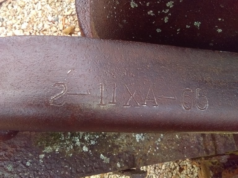

according to the numbers it is a 1 1/2 ton truck.
Has a Continental J4 I think, I need the American bosch magneto for it.IF it can be made to run.

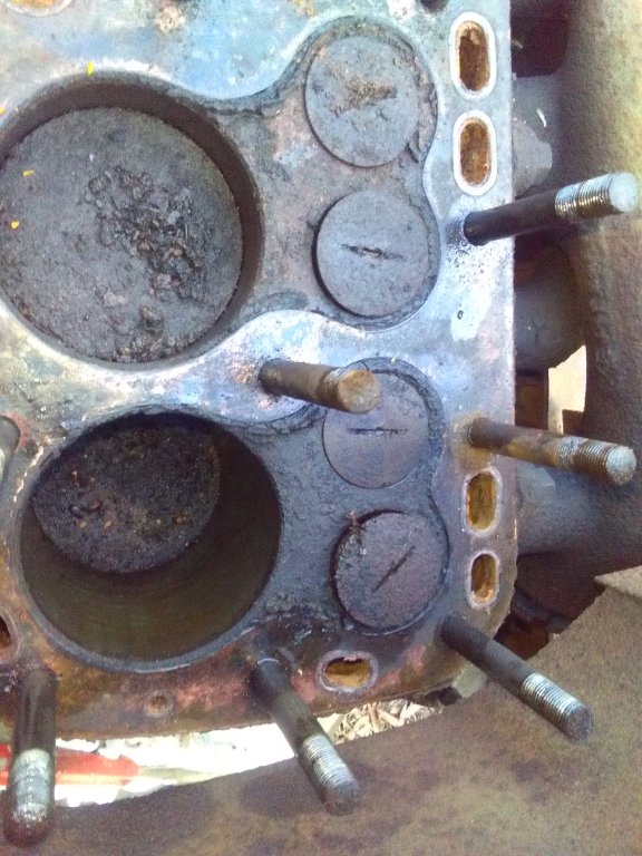

Pulled the spark plugs and no water in the cylinders, looked dry,some old carbon and not pretty but not rusted up down in there what little I could see.
I have been reading on the web and there was a site that tells about vegetable oil and acetone for penetrating oil.
Since the engine seems stiff or stuck,I am thinking of trying this idea. Can't hurt,

Re: Well boy have I went and done it, Republic "shortdog" truck
This is from a handy little book I have. It may not be as helpful if you don't have a dash with a plaque on it but here it is for what it's worth.
Sorry for the fuzzy numbers.
P.S. It does mention the 11XA like in your frame number for '22 and '23. '24 only has 11X, and 11XB.

Thank you for that info,BIG edit
Ok so for 1922, the 11XA is listed as a 1 1/2 ton truck. serial 1 up
1923, 11XA is listed as a 2 ton truck serial 48 and up.
So according to my numbers, 2 11XA - 65 mine must have been number 65 off the line.
BUT does the 2 mean, perhaps 1922 sold in 23? or/
I can be specific now when searching and asking questions.

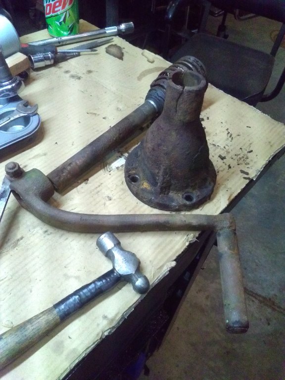

This is not a project I can rush on if I wanted to,but I have done a little.
First and foremost I had to move to a better spot as the hauler was in a rush and I was not at home.
But the handcrank is not straight , gear shifter is in the electrolysis tank so I can free it up.
Clutch releases by the pedal as I looked inside with the cover off, gears look good in the trans,as in no stripped gears and not much debris,should wash out with some kerosene.
I am still soaking the engine and such.
looking forward to more info on this particular engine if anyone stumbles over anything they think may help.
Apparently there are no very active vintage truck forums,the 1 i joined ,well, not much action.
Here is a couple photos,you can see how short the truck was cut down to for a tractor.

well we had a spring like sunny day today and cuirosity got the better of me,I have wanted to know what was under that cylinder head.
So off it came.
And I am pleasantly surprised.
Some carbon, a slight ring groove,I have saw alot worse.
nothing in bad shape.
the other 2 look the same. I put a 1/4 inch of red kerosene in each cylinder .I will see what is gone later.
I am having difficulty getting the shifter freed up. I can peck each shaft back and forth with a hammer and brass punch. I took 1 ball and spring out but to remove the other I would need to take forks and such out.
Just won't free up. I soaked it in the electrolosis bucket and after pecking on it a while and making things more moreso,i just put it back in the vat and will leave it a few days.Any hints and tips on freeing that up would be appreciated.
So with the cylinders being clean,as in no gaulding, makes me wonder what is stuck. I will check the water pump next. But I am trying to figure out,will taking the 3 nuts off that are on the engine remove the pump?
So off it came.
- Posts: 7922
I'd want to gently work the valves loose before trying to turn the engine, and keep soaking everything. If you can get the crankshaft to move, rotating it a short distance forward and backward is often helpful, while adding lubricant and slowly increasing the range of movement as the engine frees up. Almost anything can be stuck, so caution is needed. Pistons, valve stems, and valve lifters often stick, but I'd rule nothing out, including the oil pump and water pump, if any. It's encouraging that the cylinders show no sign of having had water standing in them.

Any pointers on how to free up the shifter a bit better?
I can bump the rods back and forth with brass punch and hammer but they won't budge with just the shifter lever.
Soaked in the electrolysis bucket for a week,rust GONE, heated with torch and penetrating oil applied,with alot of tapping and so forth.
I am wanting to make sure the trans is in neutral.
IT may very well be that I have to take this engine plumb apart as I can't even figure out how to get the water pump loose .
It may have a fiber timing gear and I don't want to break it.

Rich Eagle said it was a Republic. There are other photos of Republics on there too.

Disassembly of rusty machinery is always challenging ! I don't know anything about electrolysis, perhaps it is not penetrating ? I have had the best luck with penetrating oils, "Liquid Wrench", "Knock 'er Loose" and "S-OaK". Heat can sure help, tapping and "nursing" slight movement, more penetrating oil, and lots of patience ! You're doing great ! Thanks for showing us.

I think you're going to have to loosen up the clutch forks and tap the shift rods out completely in order to clean/polish them up. Might be a good idea to remove the timing gear cover to see what's on the other end of your water pump. Probably some nasty stuff in there anyway that would be good to wash out. Keep us informed! This is fun!
If it has a timing cover, I would remove it as Jerry mentioned. Here is how some of the gears are held on on my White.

I am afraid you all may be right about taking apart more than I really hoped to. I have the rest of my life though to get to it!
