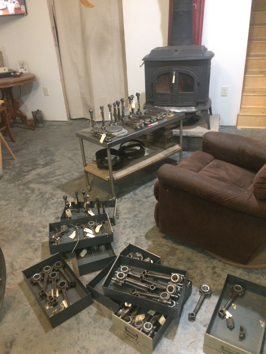

Picking out a set of rods to bore for My 25 roadster pu

Dean,that round thing on the bench in front of the stove tells me you are on the right track!

Allan, When I babbitt rods I start with cores that weigh +- 10 grams with the babbitt wiped out. After poring the sprue is removed and bore to 1.2 inch then weigh again. This makes it easier to get a balanced set.

Way to go Dean. I don't do my own babbit work, but I do select a set of rods of es near as possible the same weight to send off for work. Makes sense to get things as close as possible to give a good start.
