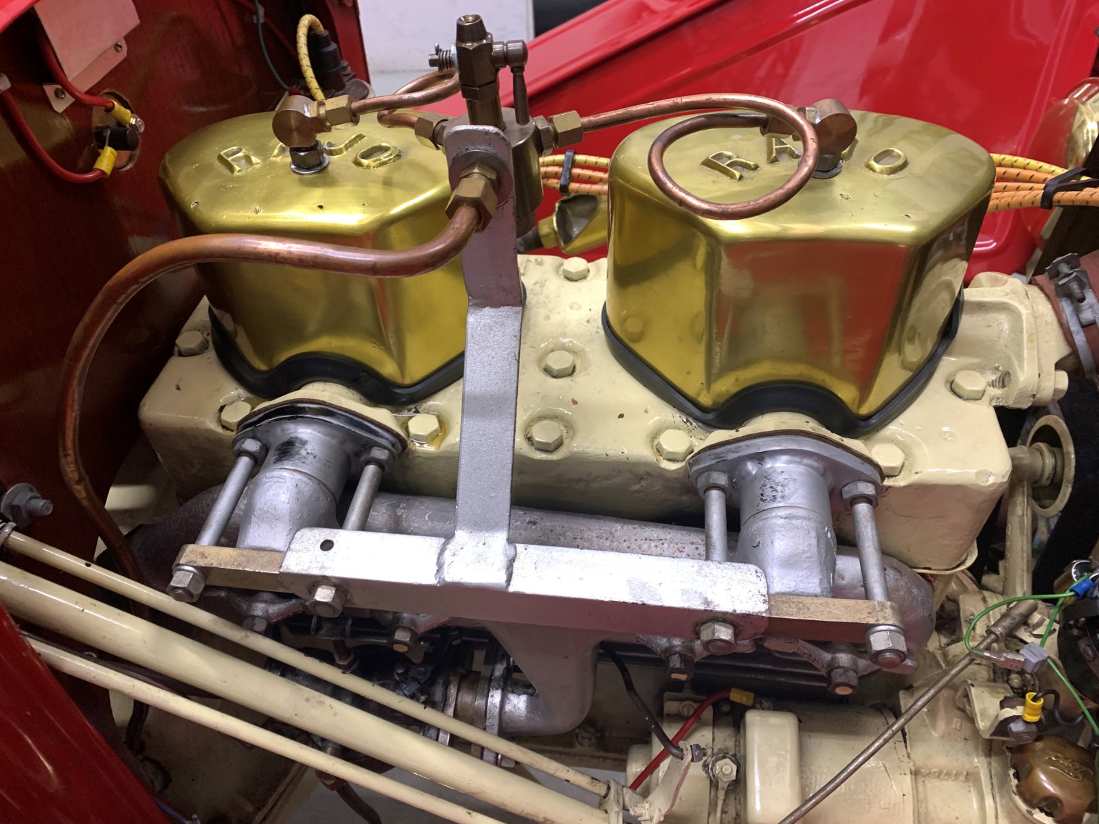

Thanks for the comments about sealing my RAJO head.
Thought you might like to see the unusual oil delivery mechanism and the seal I created from a rubber extrusion.

Took me a while to see where the T intake was connected!
At first I was seeing the T exhaust and intake was was trying to figure what the was connected to the head.

Nice work Jeff, seals and simple!

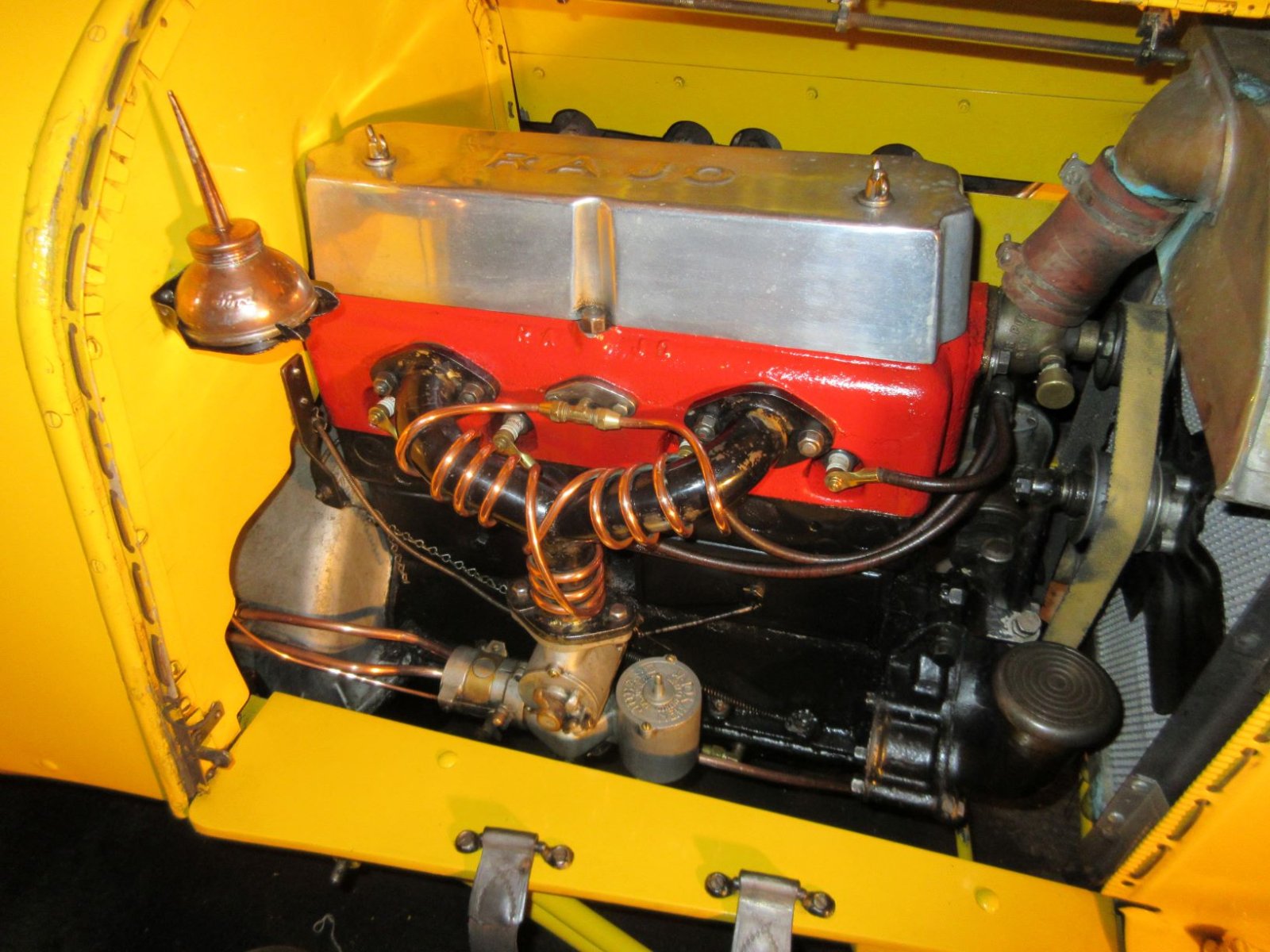

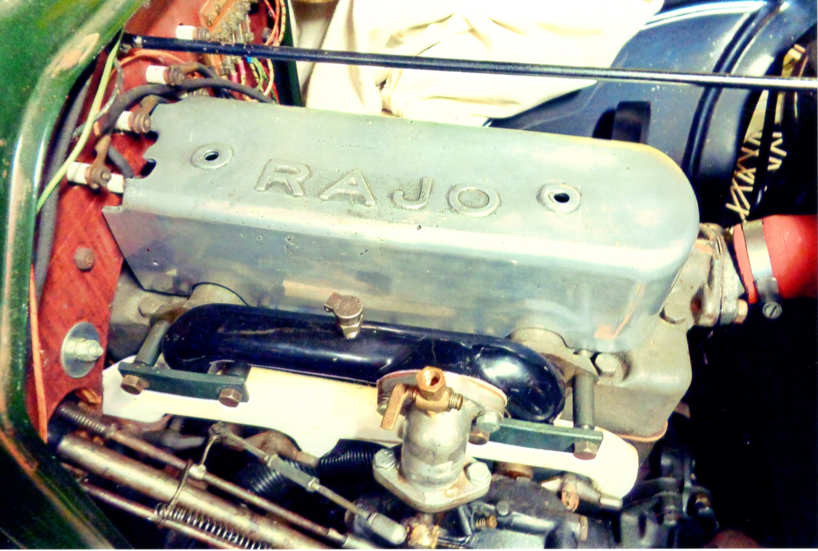

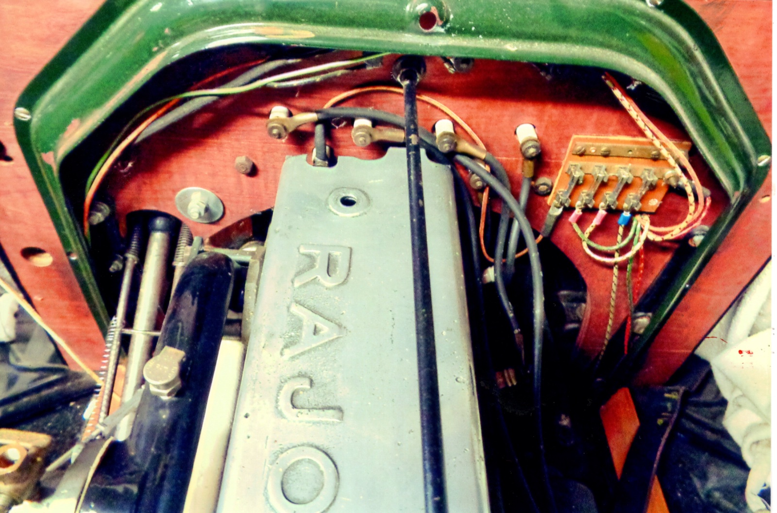

Great solution, Jeff. Friend Jarvis saw this thread and sent me these. With his permission, I am posting. It shows very nicely the original open back valve cover. Back then they didn’t care a ding dong about a little oil spray.
