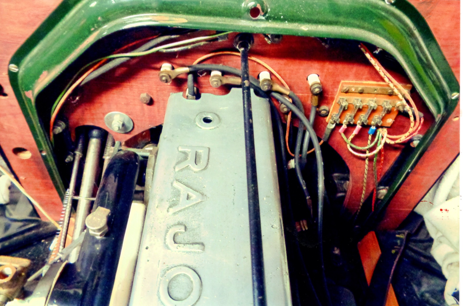

Great solution, Jeff. Friend Jarvis saw this thread and sent me these. With his permission, I am posting. It shows very nicely the original open back valve cover. Back then they didn’t care a ding dong about a little oil spray.
