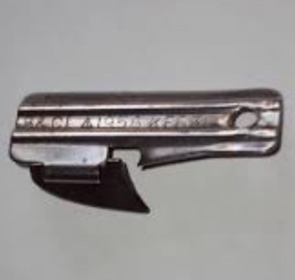

If you’re trying to be authentic...

Kevin, how can a can opener dated 1956 be authentic for any T model? :D

Sorry Allan... was the oldest one I could find a picture of...😔

I stand corrected... turns out the P-38 can opener wasn’t invented till 1942. So NOT a period correct holemaking method. Guess you’re goin to have to look for an ‘ol bit and brace... or get out the ‘ol trusty cold chisel!! :twisted: :lol:

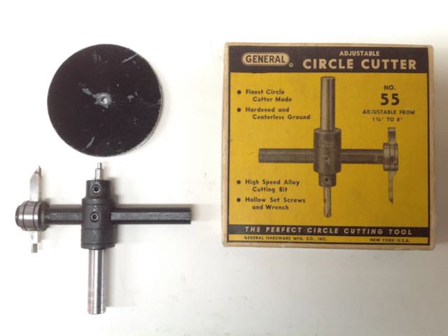

Lacking the proper sized hole saw, I used this Adjustable Circle Cutter I had on hand.

The P38 key is a great invention. I retired from the commercial nuclear industry and carried one on my work key ring. A very useful tool. Wish that I still had mine. I "willed" it to a newbie when I left. I haven't replaced it yet.
