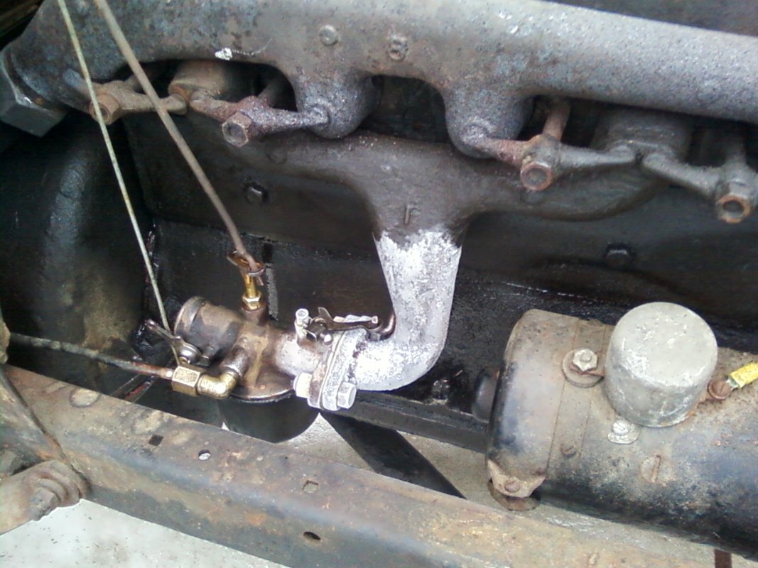

I kept taking my heat pipe off and then put it back on after my carburetor ices up. Now I just leave it on. It does not detract from the performance that much.

They also keep small birds and bugs out of the carburetor !!

Thanks Dave, I may end up taking you up on that. I have one for my 25, I'll see if it will come close to working. Then I'll let you know.

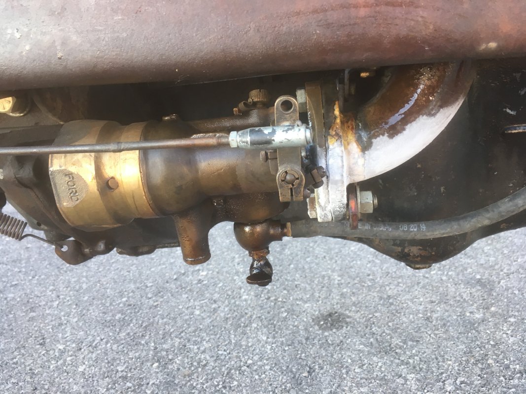

I keep them on both of ours. I've had the carb freeze up on my TT before.......WITH the heat pipe on it. It may rob a bit of HP, but if I'm in a HP mood, I'm not gonna pick the T to drive anyway.

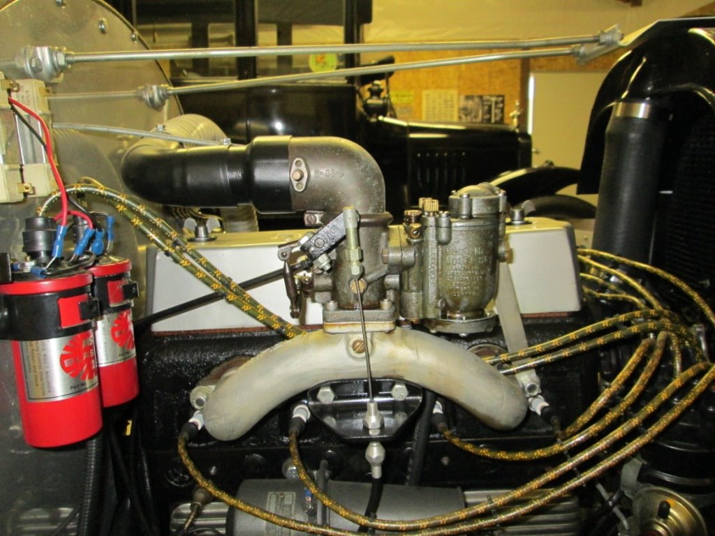

Here's what I ended up installing on my Winfield SRB - wet air up here in the PNW - I believe I should add an adjustable flapper for summer driving !

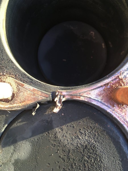

Well I waited for better conditions and it still didn't run well. It would miss at idle and would detonate under power. I took the temps of the exhaust just after starting and found no 1 cylinder much cooler and when idling, grounding the plug made no difference. I took the plug out , brought it to TDC compression stroke and did a leak down test with air. Air coming out the carburetor. Next pulled the valve cover off and checked to see if the valve was adjusted to tight, nope. So what do you think?

This is what I found when I took the head off. So guess what is happening on #2 cylinder when #1 is at TDC compression stroke, you guessed it, BDC on Intake stroke. When I did a leak down check with air on #1, the air went through the blown head gasket and out #2 intake valve and out the carburetor. It still narrowed it down to taking off the head. I'm not sure if it had anything to do with carb heat after all. I just thought some of you may find this interesting. Thanks.

Good of you to post the result...so often posters solve the problem and leave the guessers in limbo...

It appears that the head gasket may have been cracked and it also appears that the compressed air may have assisted in the additional tearing of the gasket. I had one that blew a small section out at the same spot. The gaskets are very narrow at that point and may not have full contact with the block and the head due to warping or debris.

Thanks Guys, I did notice that when I took the (in this case) nuts loose, there was hardly any resistance. I did re-torque the head once but after this I will re-torque it a few more times. It was a new high compression head (5.5) when installed. The gasket wasn't recommended for this. I like the copper gaskets but I am also using the recommended (steel inserted )one this time.
