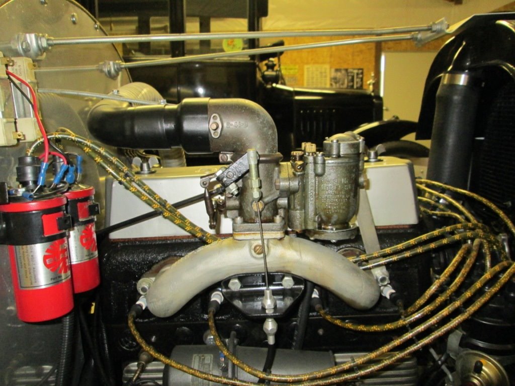

Post by RajoRacer » Tue Jan 15, 2019 10:17 pm
Here's what I ended up installing on my Winfield SRB - wet air up here in the PNW - I believe I should add an adjustable flapper for summer driving !

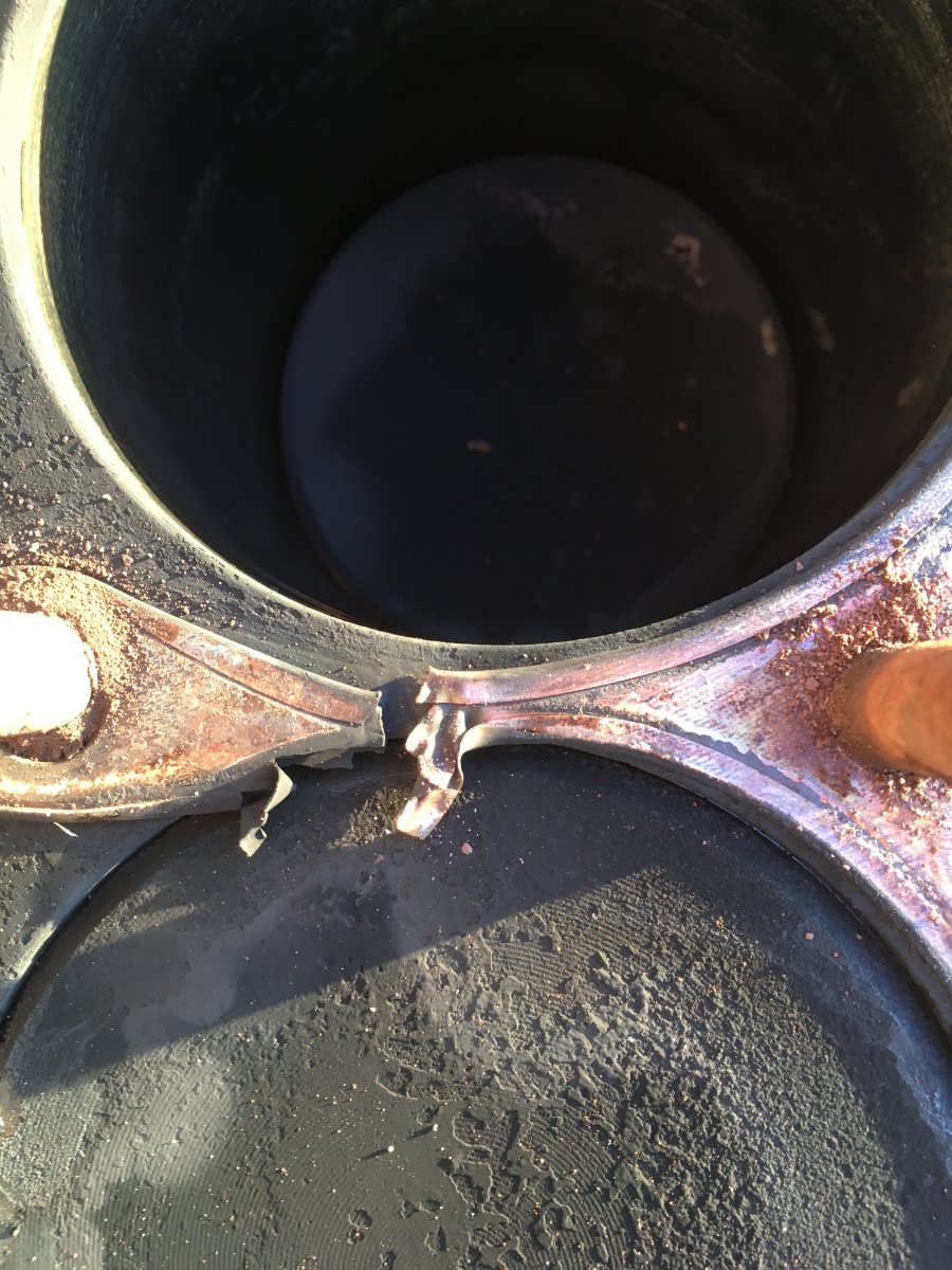

Post by John Warren » Wed Feb 13, 2019 8:24 pm
This is what I found when I took the head off. So guess what is happening on #2 cylinder when #1 is at TDC compression stroke, you guessed it, BDC on Intake stroke. When I did a leak down check with air on #1, the air went through the blown head gasket and out #2 intake valve and out the carburetor. It still narrowed it down to taking off the head. I'm not sure if it had anything to do with carb heat after all. I just thought some of you may find this interesting. Thanks.

Posts: 6804
Re: Carb Heat
Post by Scott_Conger » Wed Feb 13, 2019 9:46 pm
Good of you to post the result...so often posters solve the problem and leave the guessers in limbo...

Post by Altair » Thu Feb 14, 2019 1:08 pm
It appears that the head gasket may have been cracked and it also appears that the compressed air may have assisted in the additional tearing of the gasket. I had one that blew a small section out at the same spot. The gaskets are very narrow at that point and may not have full contact with the block and the head due to warping or debris.

Post by John Warren » Thu Feb 14, 2019 8:00 pm
Thanks Guys, I did notice that when I took the (in this case) nuts loose, there was hardly any resistance. I did re-torque the head once but after this I will re-torque it a few more times. It was a new high compression head (5.5) when installed. The gasket wasn't recommended for this. I like the copper gaskets but I am also using the recommended (steel inserted )one this time.
