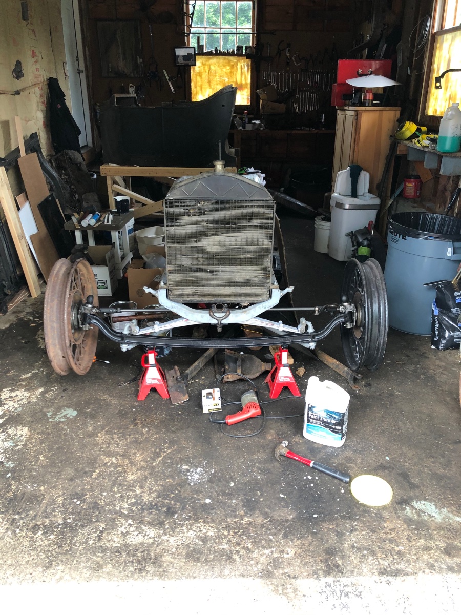

I’m doing it now. I love both the t and the a, so I’m going for it. I’m using the a trans as well. Custom motor mounts will need to be made. An aluminum spacer on either side of the a flywheel housing 5/8 will space the new motor mounts and allow the engine to be mounted like the t. I haven’t gotten to the front motor mount design yet. Another thing is that the a engine is longer and also taller. The hand brake cross shaft will need to be moved rearward and down lower. 5 inches back one inch down to clear the model a trans. The driveshaft and torque tube will need to be cut and adapted depending what you will do for the rear axle. I’m using a large drum t axle with Rockies, you will loose the t trans brake so good brakes are imperative! I will cut the t tube and use the front section on a model a tube welded to it and do the same for the driveshaft. Obviously the entire car is being built around all these changes, not simple, not easy, completely custom. But the end result will be a fun and interesting car. If you like early style hotrods( gow job) then this is a good project for you and may open your mind to a whole new, yet ancient forgotten segment of old fords.

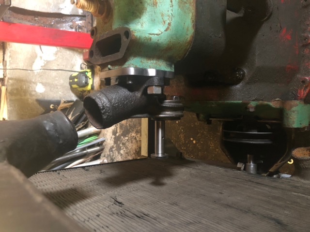

Also I will use a model t water pump mounted to the side of the a engine and block off the water outlet on the top of the head. I will make a 1/2 plate to adapt the 26/27 t water outlet to that. Just lots of stuff to engineer as you go.

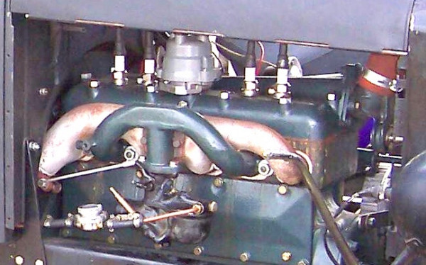

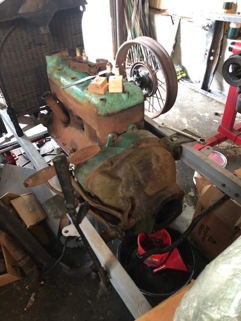

Someone on here did it long ago, wish I knew more about this one! They used a model b exhaust manifold
Bud Delong
- Posts: 469
- First Name: Kenneth
- Last Name: DeLong
- Location: Wheeler, MI
Re: Model A motor into a T?
Yes and no,That"s a model B engine! Bud.
Your right. No outside oil pipe!
It looks nice, except there's this strange protrusion between the 2 and 3 spark plug...

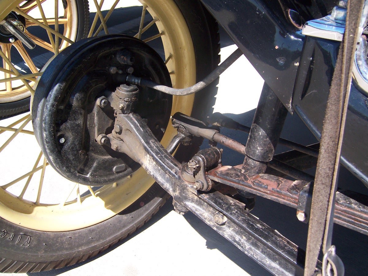

Something else to remember - the front wishbone (which anchors on the T pan) determines your caster... you don't get that right, you're in a world of squirrley hurt. As you're building motor mounts et al, don't forget this... otherwise your first ride may be your last...

Yes, your right the wishbone up front and the radius rods will also need modifications. I need to get the engine in exactly where it needs to be and everything built around that before the front wishbone can be properly determined to be sure the geometry is correct. So it’s a ton of work, needing to be done one step at a time. I actually made of detailed list of things needing to be done and what effects another system or part, to not mess up and have to go back to correct something. The protrusion is either the model a brake cross shaft straps or a digital caliper. I’m sure something else will come up that I haven’t thought of. Probably exhaust system and fuel system.

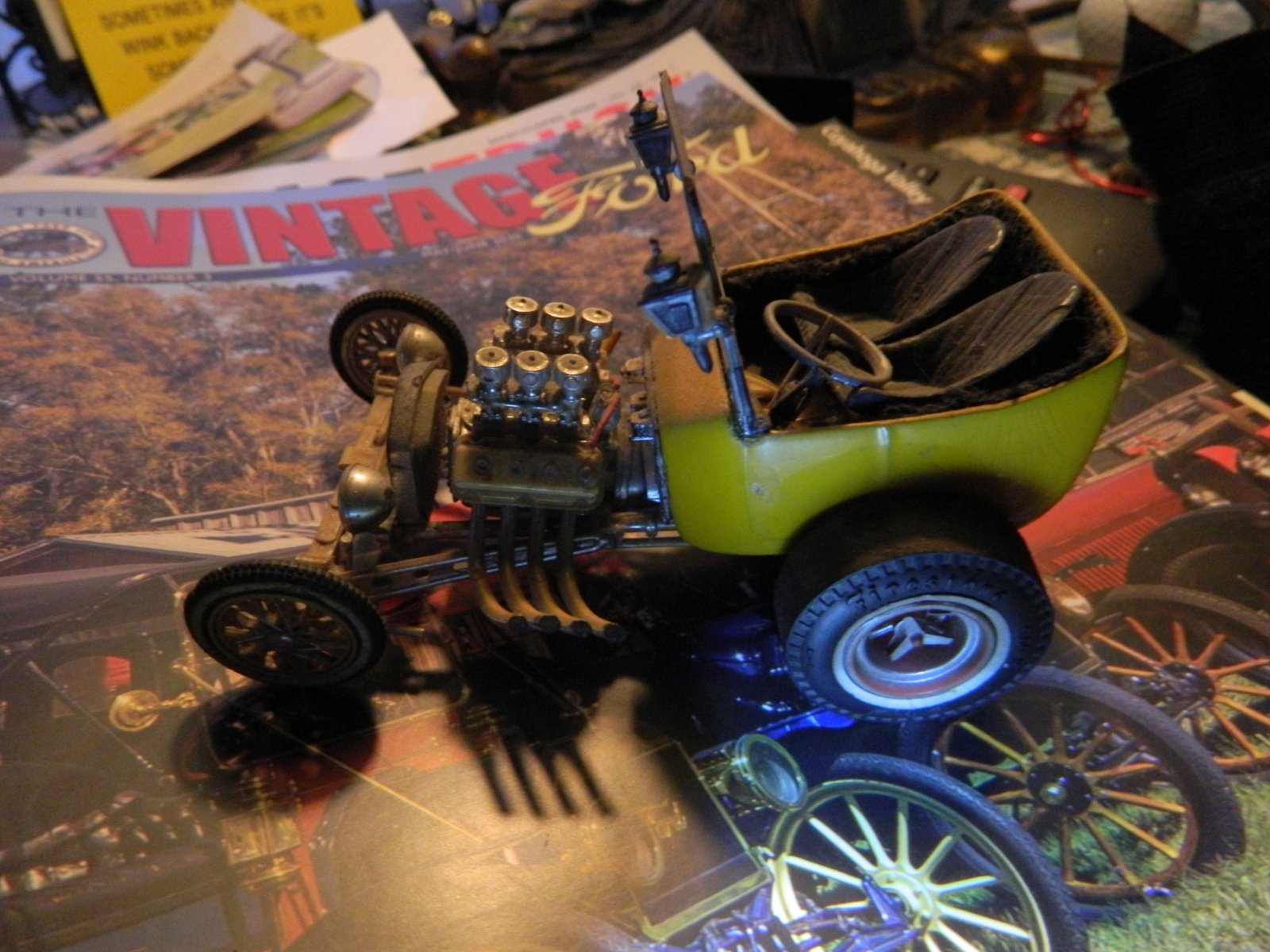

My race car is a hybred, I call it a TA race car

John, seeing your car burning the tires launching at the speedster reunion is what gave me the confidence that the model t rear axle is strong enough! My driving style is definitely more relaxed so I will be fine.

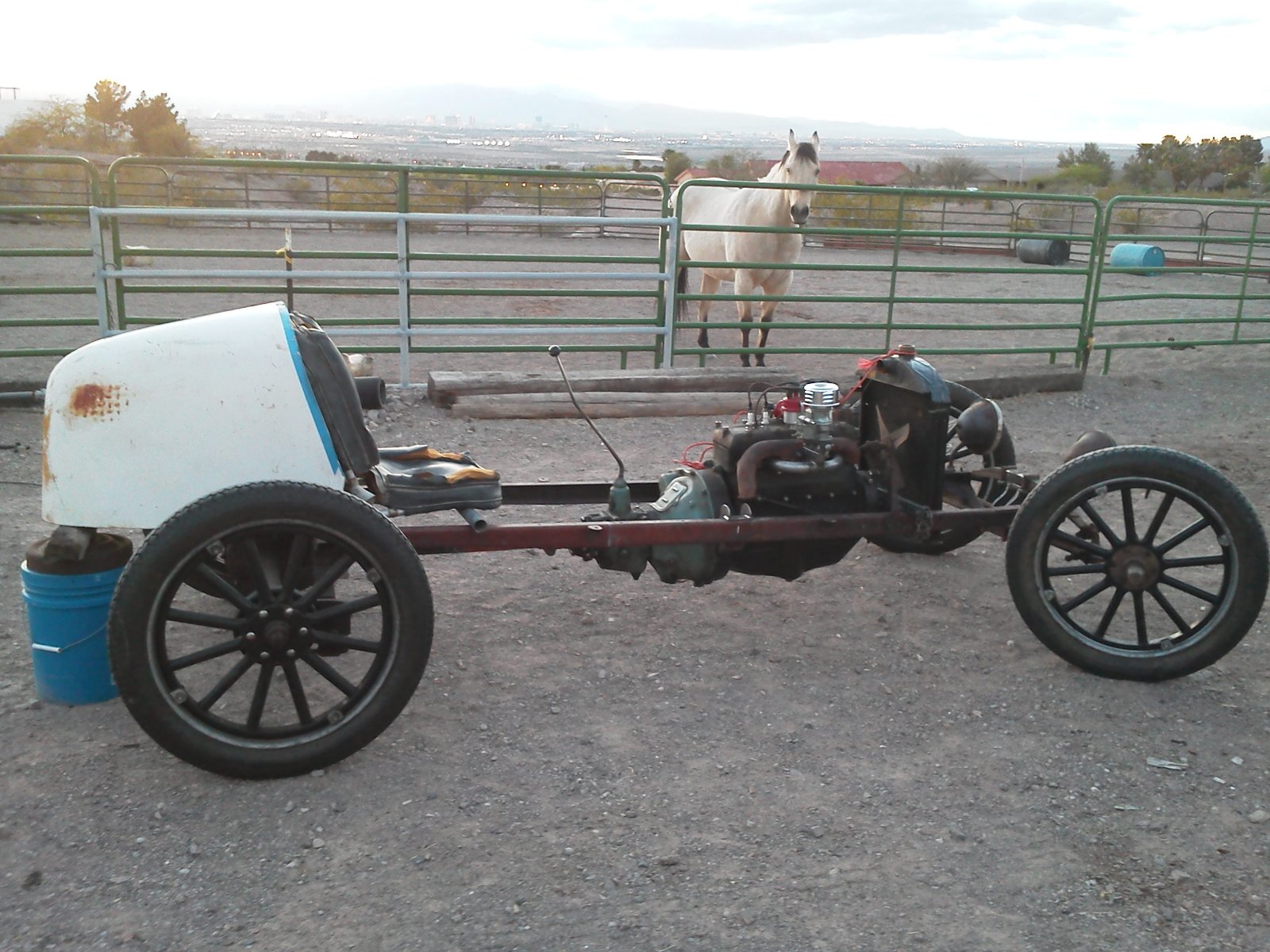

Dave, you do remember that I broke down. I twisted off an axle. It was mostly because it was a bad axle. Please take lots of photos of your build and share. The big drum brakes work well, adding rocky mountains is a great move.

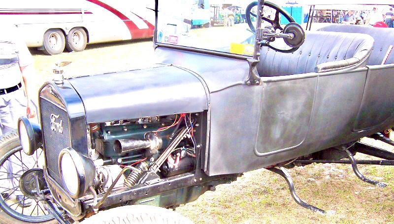

There was a very well known T here n Australia which had a Model B motor in it at one stage.
This 1912 Australian bodied T was restored and then sold to one of our members after the restorer passed.
He used it for a number of years and it was featured on the cover of the Vintage Ford.
It was then sold to a person who owned a Brothel in Sydney who intended to use it to help promote his business. The girls found it difficult to start and drive so it was sent to a Antique car resorter who removed it's original "B" numbered motor (an thankfully kept it aside) The girls then drove it around the red light district for a few years.
The previous owner then brought it back and reinstated the original motor. A friend who was doing a speedster purchased the brass radiator which had been modified as the water pump shaft fouled the core and a section had been removed.
Very little else needed alteration or was damaged in the transplant., only the motor was altered, not sure about the brakes but as a vehicle it drove and accelerated really well. It was still deemed a alteration "too Far" and potentially unsafe to be left as it was.

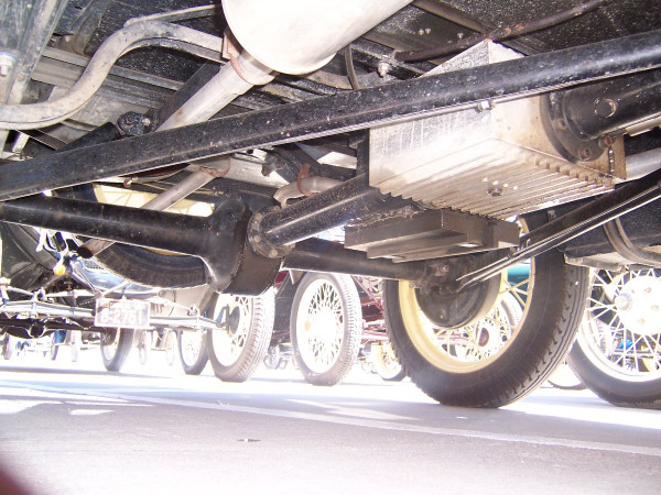

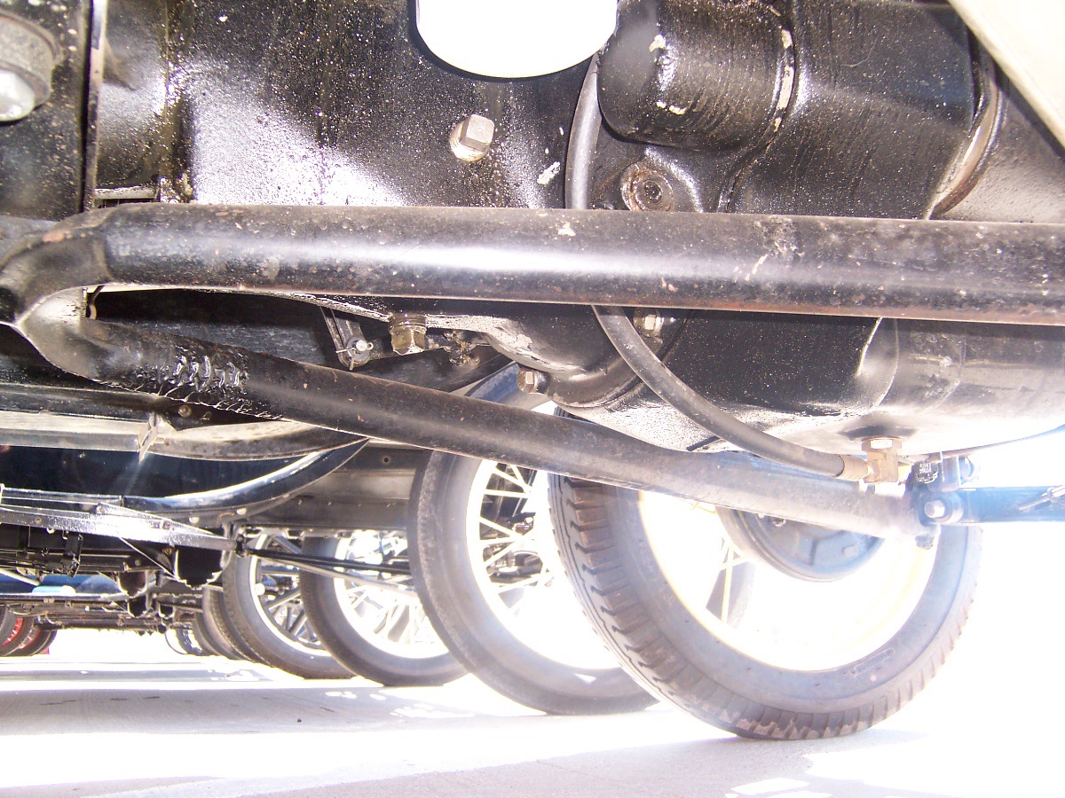

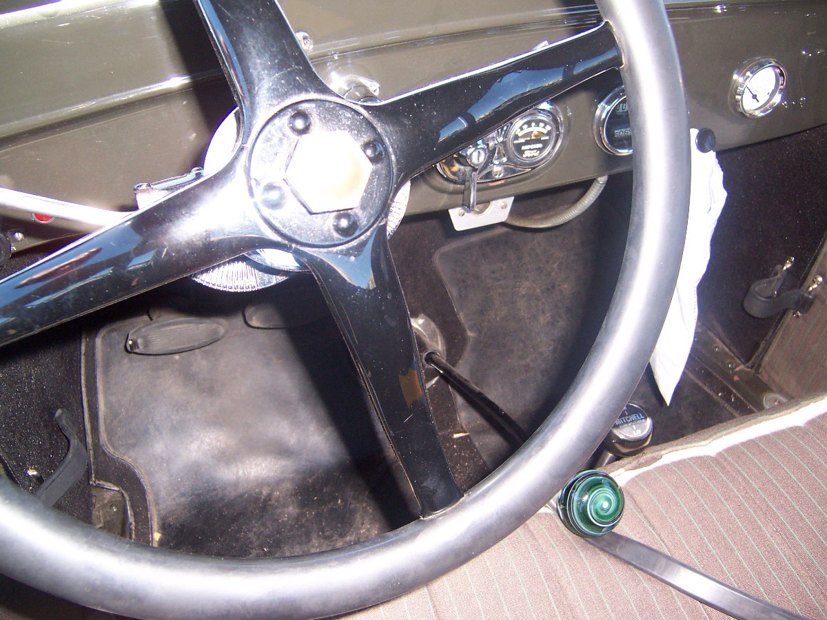

Saw this '27 sedan on tour years ago.
Asked the owner how it ran and he said good, but lots of work to many details, like A water pump hits the T radiator, so side pump added. Model A engine, and of course all Model A running gear. Model A front end with juice brakes, Model A rear with added Mitchell Overdrive, other wise pretty much T frame and stuff.
Model A clutch and brake, 3 speed shift, and overdrive lever too. Model A front axle Wishbone stock Model A to axle
Model A rear with overdrive unit

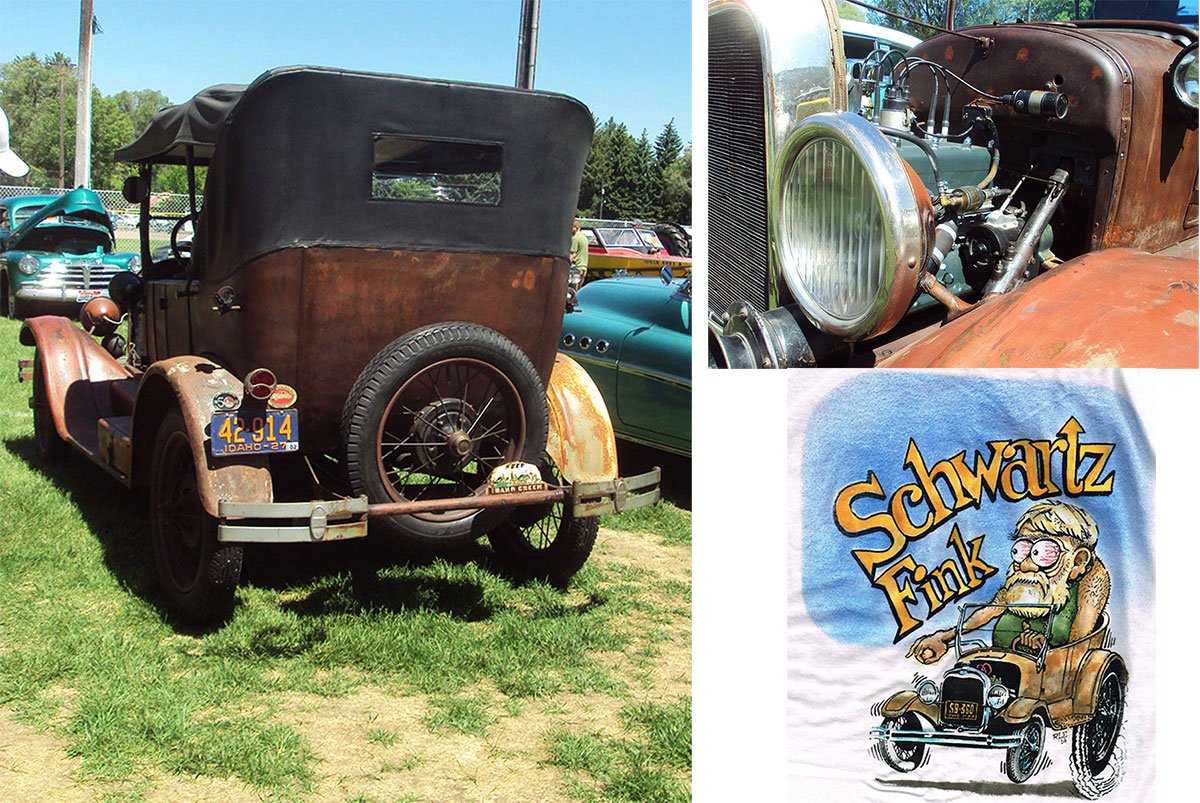

Our buddy Gary put this '27 body on an A chassis. He complained a lot about things that didn't fit. Duh!
I screened some shirts for the local guys and made him a celebrity.

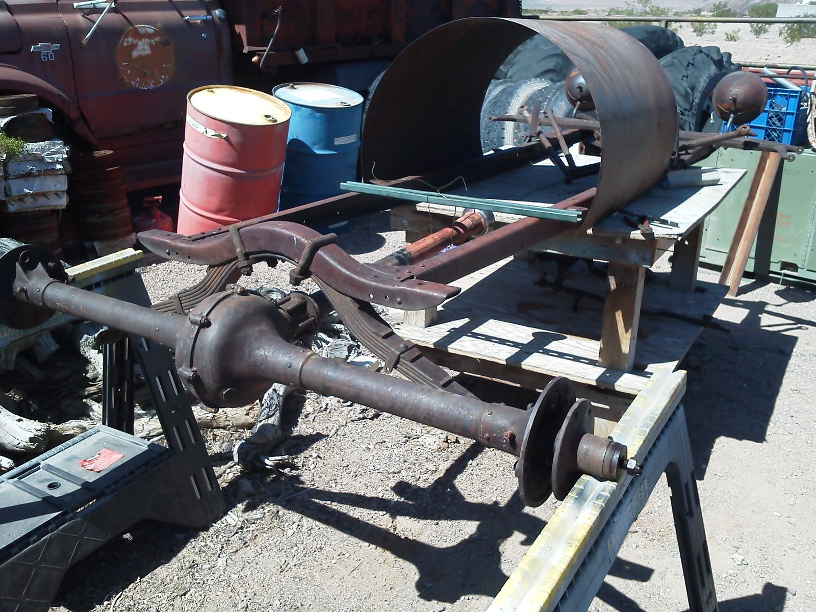

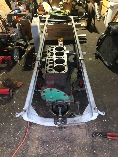

Here’s a little more of how I’ve begun putting a model a engine in a t. Yes I know it’s ridiculous, but it has been a fun project.

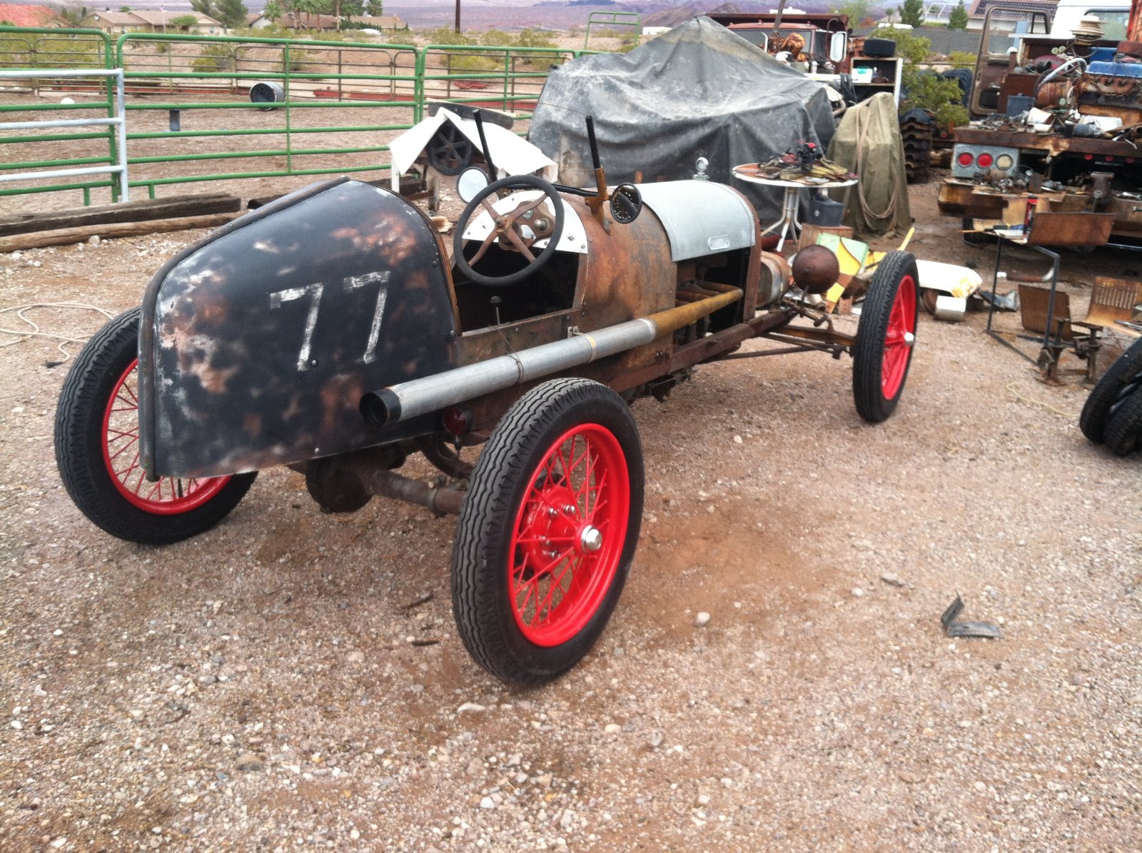

There is a guy here in Arizona that shows up at antique tractor shows with a 26 or 27 model T coupe with a V8 60 & model A drive train. His documention shows it was done by a relitive in the 1960s. At first glance you can hardly tell. There was a guy in Californa that was doing this model A swap 7 or 8 years ago for people, do not know anything more about him. I was trying to buy the T chassis from him for a speedster but he sold them as fast as he took the bodys off.

More things to do to put a model a in a t chassis. This time the water neck needed to be adapted. A side mount model t water pump will be used with this set up. A v belt pulley will be used on the model t fan shaft and the pump will also have v belt.
