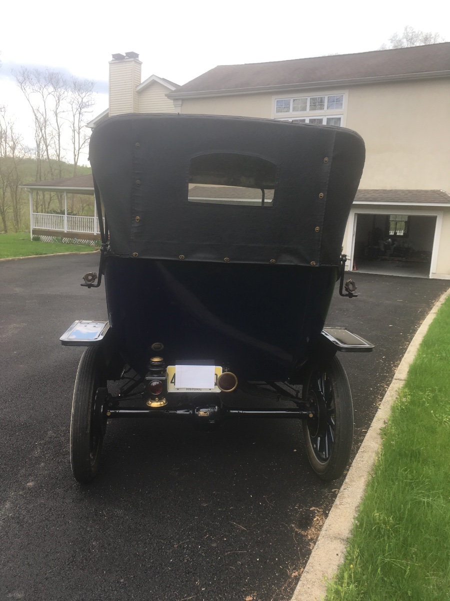

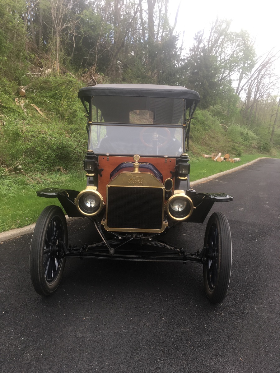

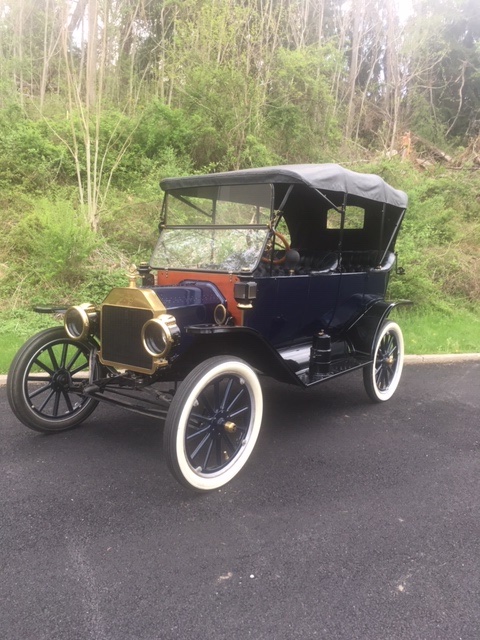

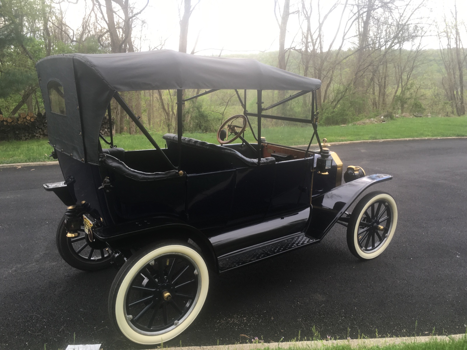

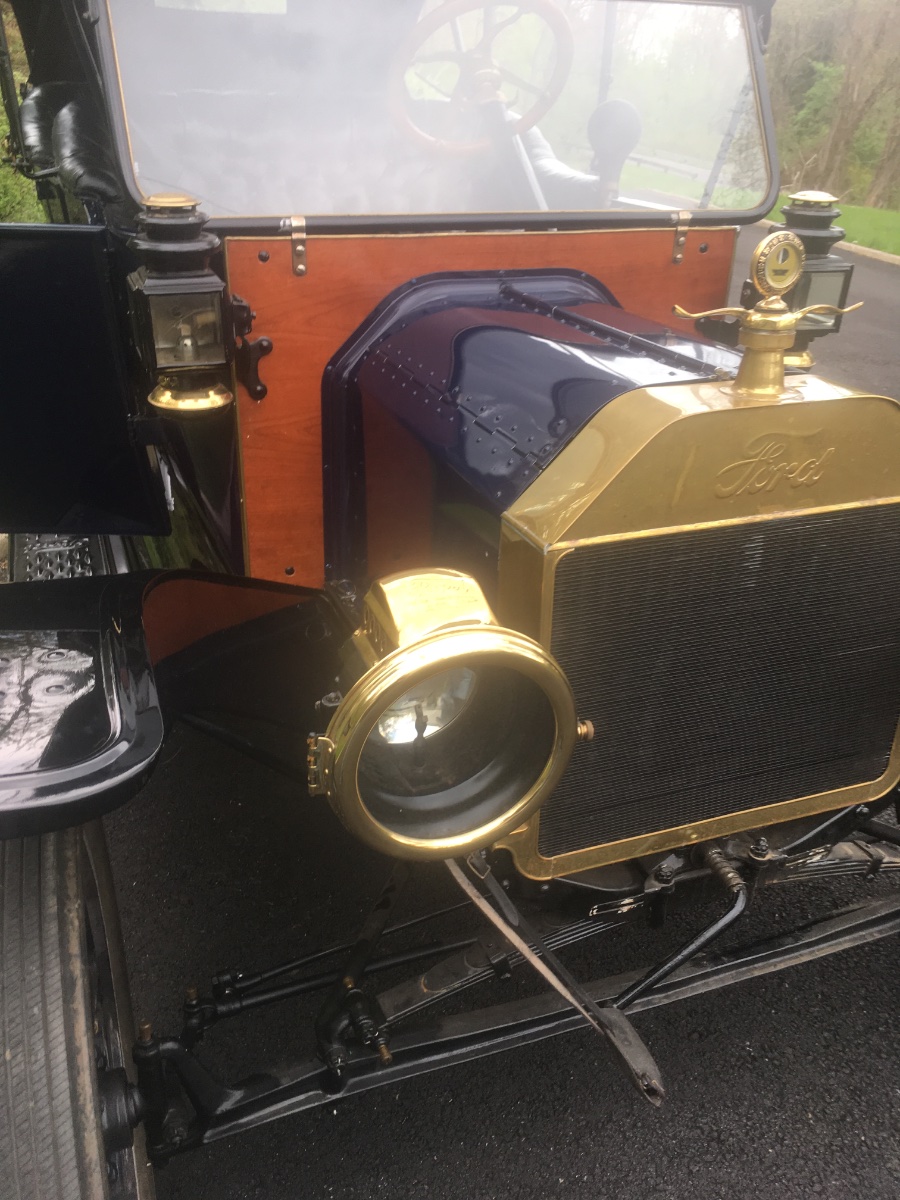

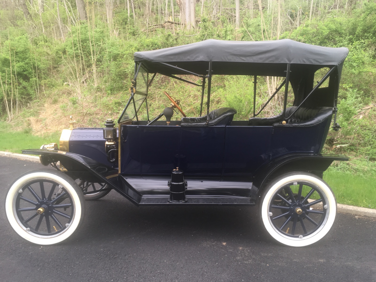

Here is my 1913 touring. Modifications are demountable rims, 12 V system, electric start and a ruckstell. I bought the car the way it sits, I would appreciate any comments as far as originality goes

I haven't studied 1913 details, so I can't comment on most of the car itself, except to say that it's a beauty. I do see two things, if original means as it came from the factory. In 1913 the car would have come from the factory with tires that were all white, and a radiator cap like this.
Of course, that's nit-picking. While the cap is factory correct, the motometer is a period accessory.

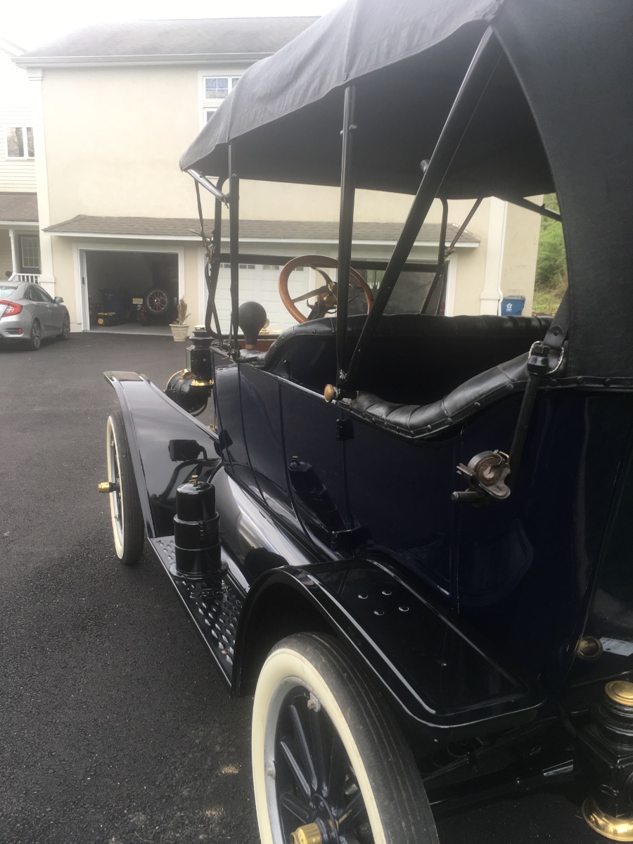

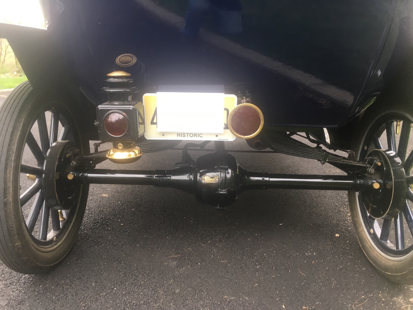

The most obvious thing is the horn is upside down, as so many '13-14's are. The radiator cap that Steve posted above is incorrect, so forget that. It doesn't appear to have any of the gas light system in the car. There are a lot of other details too, like the natural steering wheel, wrong wheels, and no speedometer.

Vincent, you catalogued the "non-original" modifications to your car, as Steve said, not much else to say except that it's a beauty and likely ready to be driven long and often ! I suppose there's yet debate on whether the '13s were painted blue, and when, exactly "all black" became the rule. Mine is blue and I love the look of it.

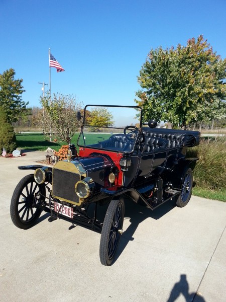

Joe, thanks for posting the pictures of your Ts, what can you tell us about its unique wheels ? I've never seen the like except on farm implements.

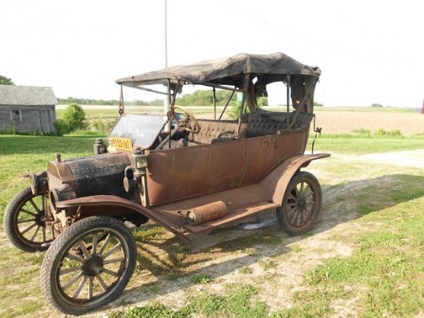

For what its worth my 13 Touring still has some of its original blue paint on the body and black on the fenders. As far as I can tell the only thing on mine that is not correct are the wheels and the rear end and an aftermarket clock mount on the dash, and a switch for a later mag light conversion and a master vibrator. Someone said my spark plugs are not original either. Here is a picture that I have posted before and a link to a lot of pictures from a couple of years ago posted on this forum.
http://www.mtfca.com/discus/messages/599638/641256.html

that is a VERY nice looking car! Nice purchase, and welcome to the affliction! It appears to be ready for some serious touring. Enjoy and be safe.

As others have said, it's a beautiful car, and certainly nicer than it would have come from Ford. The only thing I would add is, while I love that shade of blue, it's not quite correct for '13; the original would have been just about black, with the blue tint only apparent in sunlight. But unless your goal is some show hardware or a Stynoski, just enjoy it as it is.

I do not plan on showing it, I just like driving it. It is my third model T. I sold the other two to buy this one. I was just curious as to how Correct it is. I realize original was the wrong term. So is it true that all 1913's came with a speedometer? The gas headlights will be operational soon. I had to repair a leak in the water tank on the generator and I just have to run new tubing, and then I have to make a new gasket for the separation between the water tank and the chamber. Can't wait to fire that up, I already bought calcium carbide

So your car has the later demountable wheels on it. You are in good company. A LOT of brass era Ts are driven on tours with wheels that were not available until the 1920s! (And that includes nearly all the brass era Ts with wire wheels on them!) A Ruckstell? So what? Nearly half the brass era Ts driven most often on tours has a Ruckstell. So the Ruckstell is a '26/'27 version. What difference does that make? The first Ruckstells were offered for sale seven years after your car was built, whats another five years difference over a century ago? Besides, the late version has the better parking/emergency brake that is a safety issue. I mean, that is why so many people put after-market outside brakes on their brass era Ts, and they weren't widely available until the '20s either.
The point of this, is that you are aware that your car is not fully correct in its restoration and current presentation. You are asking questions, and showing an interest in what is correct.
Whether I or anyone else does or does not like it the way it is? Should not be the most important thing. Drive the car! Enjoy it! And, in conversations with the curious, you maybe should consider pointing out some of the inconsistencies for educational reasons. And also point out how the car was manufactured for seventeen years with significant parts and systems being interchangeable, which is part of why the model T Ford more than any other car in history put the people of the world on wheels!

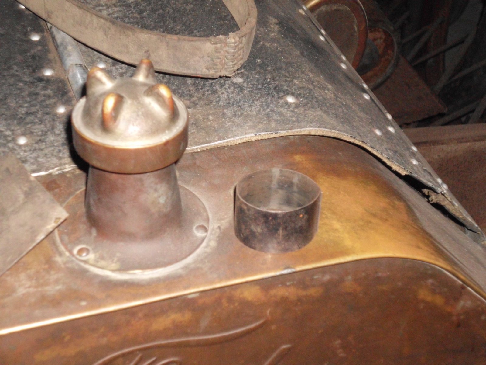

I've been looking for a picture of a correct 1913 radiator cap to post and not having any luck. Anybody have a photo? The guidelines say it's stamped (unlike my cast repo) with low fins.

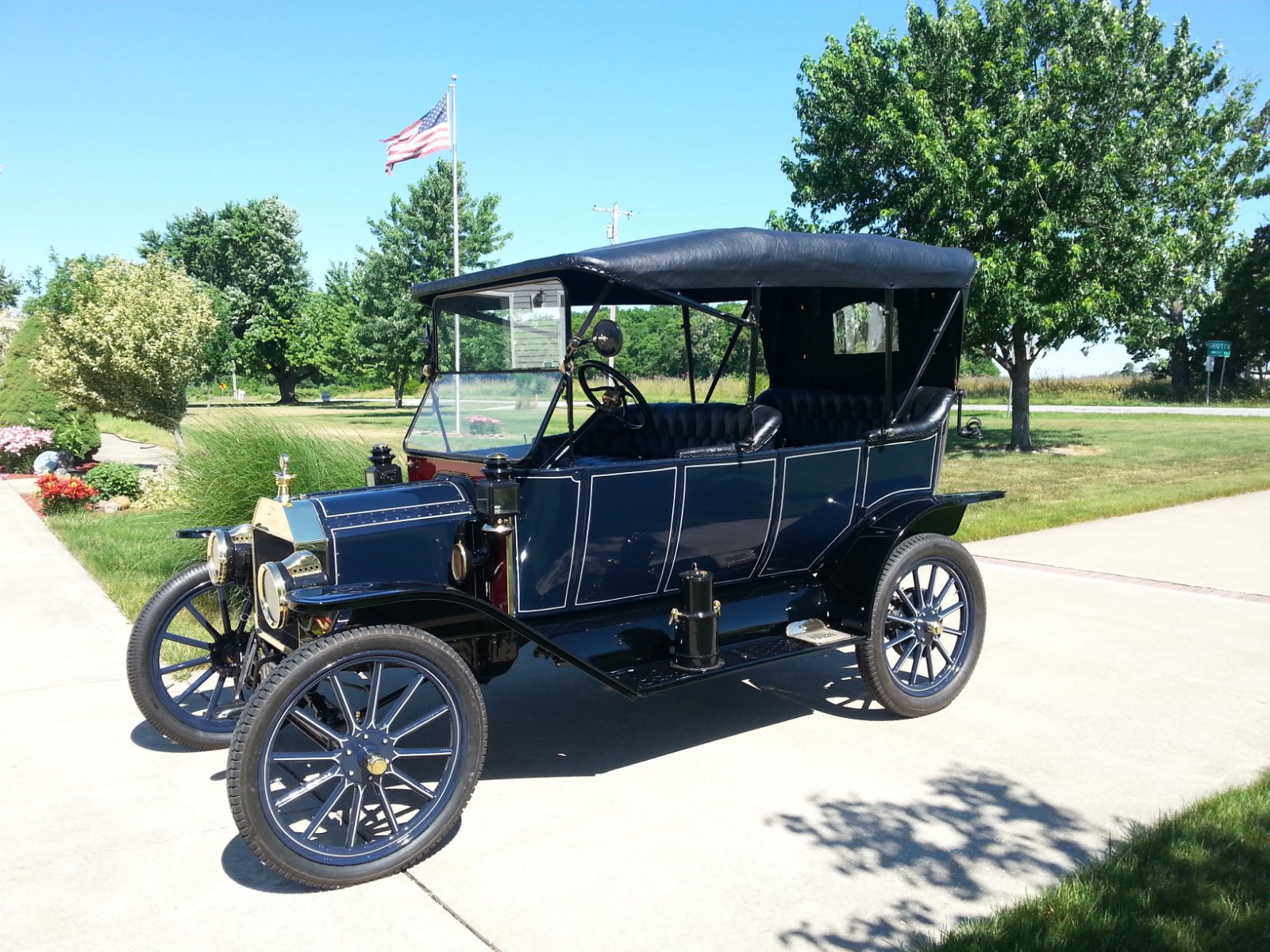

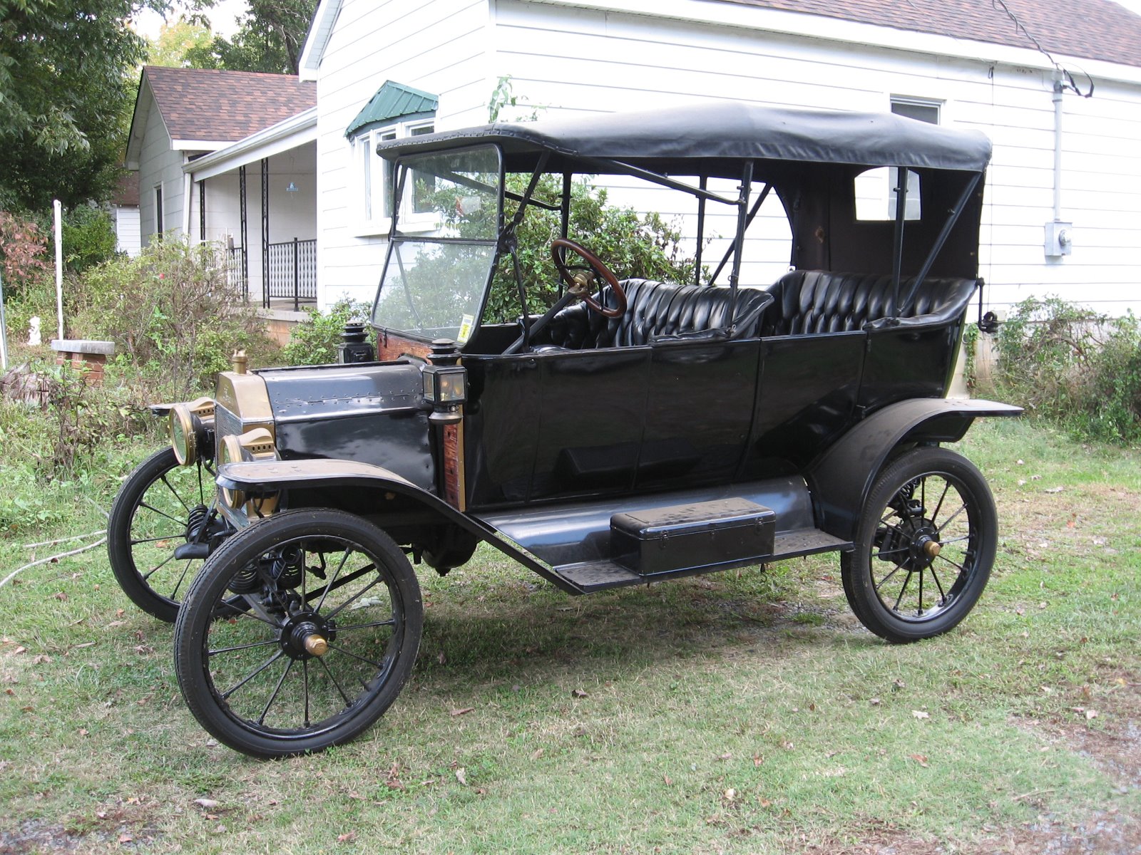

Well, here's a pic of my pretty "correct/original" '13, as determined by judging a couple of years ago at the MTFCI annual tour in New York. Took a "Gold", so pretty darned correct. I drive the hell out of her and work just as hard keeping her pristine. You CAN have it both ways! Just takes work!Johnnybuick wrote: ↑Fri Feb 15, 2019 8:13 amSo many T lovers out there assuming they have a 1913

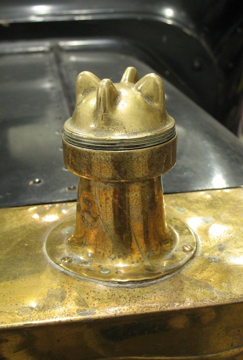

So..... would this be a 1913 cap?

Hard to see the fin height from that angle, but if it's stamped, not cast, probably so.

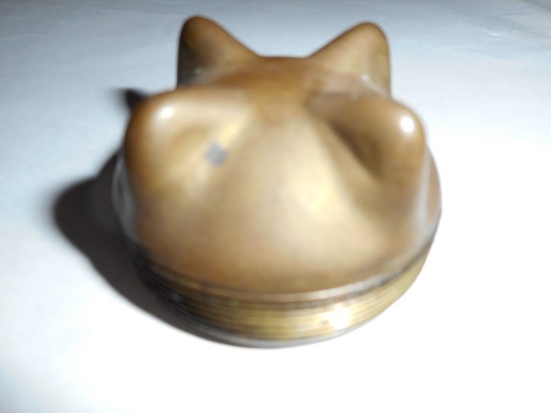

Does this look like a 13 cap?
