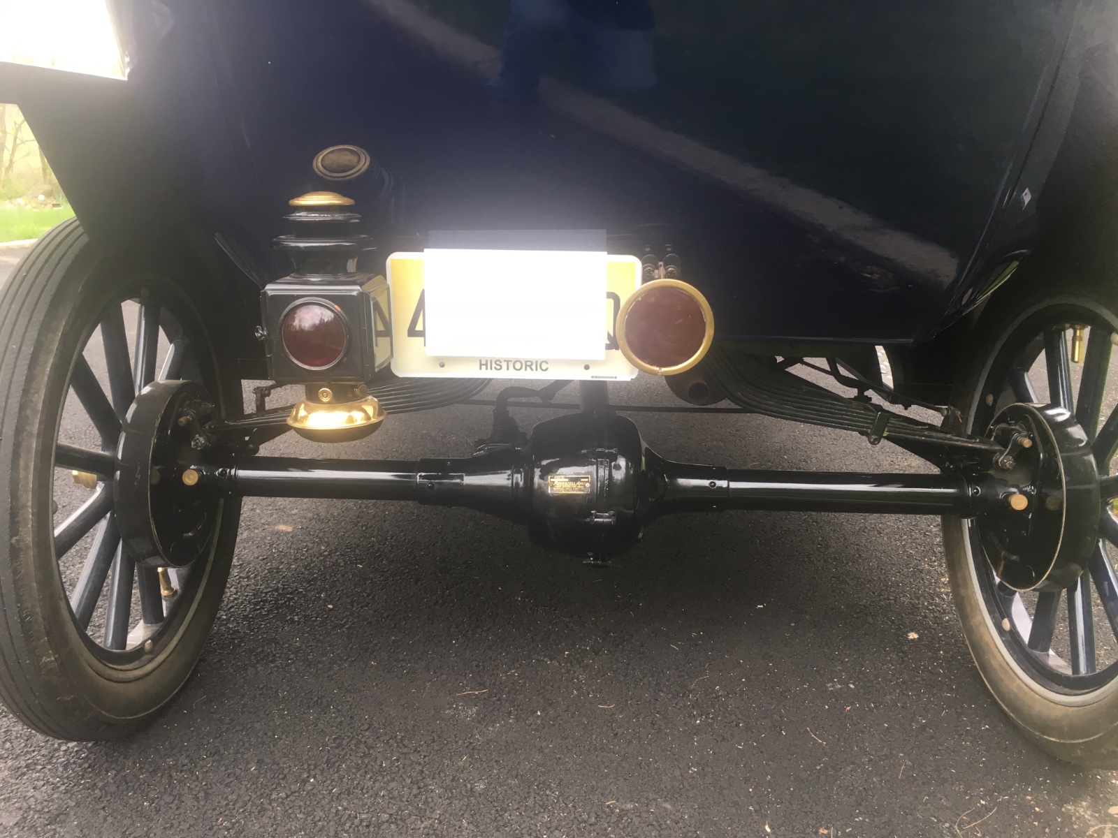

Here is my 1913 touring. Modifications are demountable rims, 12 V system, electric start and a ruckstell. I bought the car the way it sits, I would appreciate any comments as far as originality goes

More photos

And a few more

I haven't studied 1913 details, so I can't comment on most of the car itself, except to say that it's a beauty. I do see two things, if original means as it came from the factory. In 1913 the car would have come from the factory with tires that were all white, and a radiator cap like this.
Of course, that's nit-picking. While the cap is factory correct, the motometer is a period accessory.

The most obvious thing is the horn is upside down, as so many '13-14's are. The radiator cap that Steve posted above is incorrect, so forget that. It doesn't appear to have any of the gas light system in the car. There are a lot of other details too, like the natural steering wheel, wrong wheels, and no speedometer.

Vincent, you catalogued the "non-original" modifications to your car, as Steve said, not much else to say except that it's a beauty and likely ready to be driven long and often ! I suppose there's yet debate on whether the '13s were painted blue, and when, exactly "all black" became the rule. Mine is blue and I love the look of it.

As others have said, it's a beautiful car, and certainly nicer than it would have come from Ford. The only thing I would add is, while I love that shade of blue, it's not quite correct for '13; the original would have been just about black, with the blue tint only apparent in sunlight. But unless your goal is some show hardware or a Stynoski, just enjoy it as it is.

There is, and certainly should be, room in this hobby for all stripes and colors of correctness, so long as the car is still essentially a Ford model T. There are purists, and also self stylists all the way down to those that paint their car purple, with hydraulic disc brakes, brass or chrome in lots of places it never belonged, and "improvements" to everything that usually serve to make the car less reliable than it ever was.
So your car has the later demountable wheels on it. You are in good company. A LOT of brass era Ts are driven on tours with wheels that were not available until the 1920s! (And that includes nearly all the brass era Ts with wire wheels on them!) A Ruckstell? So what? Nearly half the brass era Ts driven most often on tours has a Ruckstell. So the Ruckstell is a '26/'27 version. What difference does that make? The first Ruckstells were offered for sale seven years after your car was built, whats another five years difference over a century ago? Besides, the late version has the better parking/emergency brake that is a safety issue. I mean, that is why so many people put after-market outside brakes on their brass era Ts, and they weren't widely available until the '20s either.
The point of this, is that you are aware that your car is not fully correct in its restoration and current presentation. You are asking questions, and showing an interest in what is correct.
Whether I or anyone else does or does not like it the way it is? Should not be the most important thing. Drive the car! Enjoy it! And, in conversations with the curious, you maybe should consider pointing out some of the inconsistencies for educational reasons. And also point out how the car was manufactured for seventeen years with significant parts and systems being interchangeable, which is part of why the model T Ford more than any other car in history put the people of the world on wheels!
Its a beautiful car! Enjoy it.

The question was, what is incorrect for this car? So I told him! That has nothing to do with driving the car or painting it purple or anything else!
