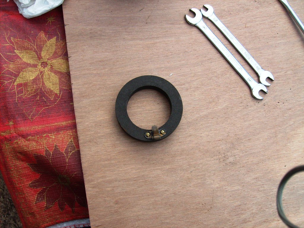

Snyder's list a float for the Holly G, I bought one several years ago for my bronze/brass G, their listing list for 1918-20 (steel body) but it worked fine in my carb. The only thing is the nuts on the screws can loosen up so I would add a drop of solder to each once you hinge is
to the new float assembled. price $14.95 T-6102G

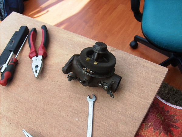

I think it is this one you are talking about.
I not only use it in the holley G carburetor. I take it as base to build other floats as I can't find the right one. It is an easy material that gives good results but while grinding and sculpting it to fit you need to wear a mask.
Last time I used it was for the rebuild of the float for a four balls kingston
Andre
Belgium
