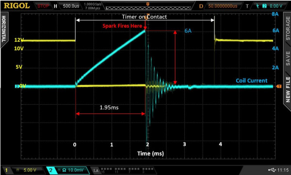

Hi Ron, Good to see you active on the Forum again! I re-read my post and believe it to be accurate but acknowledge we all make mistakes. I certainly would not have intentionally posted false or misleading information. Please let us know what I stated that you feel was incorrect. Thanks!
MKossor
- Posts: 546
- Joined: Sun Jan 06, 2019 7:30 pm
- First Name: Mike
- Last Name: Kossor
- Location: Kenilworth, NJ 07033
Re: Mag Voltage vs RPM - 1911 t
Neil,
Apologies if I missed your inquiries about the Time To Fire (TTF) method of coil point adjustment. The TTF method of coil point adjustment is done by applying a fast pulse of electricity to a coil at rest and measuring the Time it takes to produce a spark. For example, the coil current rises nearly linearly from 0A to about 6A at which point the coil fires spark. The entire process typically takes only 0.002 seconds to occur. TTF Coil current of 6A is an eye opener for folks familiar with the HCCT where the magic number of coil current is 1.3A indicating proper adjustment. You have to realize the 1.3A is NOT the current flowing in the coil at the moment the spark fires. The 1.3A is the AVERAGE coil current measured over tens or hundreds of sparks over time (including time when little or no coil current is flowing). The PEAK coil current at the moment the coils fires spark is MUCH higher; easily 6A during normal magneto operation in the car and again happens for a very short time.
Here is a link that explains more about the differences between the HCCT and TTF methods of coil point adjustment that you may find useful:
https://modeltecct.com/ecct-vs-hcct-difference
By the way, ALL well known professional coil re-builders use the ECCT as their default test instrument here in the US after experiencing the consistent results it achieves for their customers with one (1) exception that I am aware of. That decision not to use it is not based on lack of technical merit or consensus on performance (plenty of support for both) but rather bruised ego and personal animus from my understanding which is really unfortunate in my view for a professional.

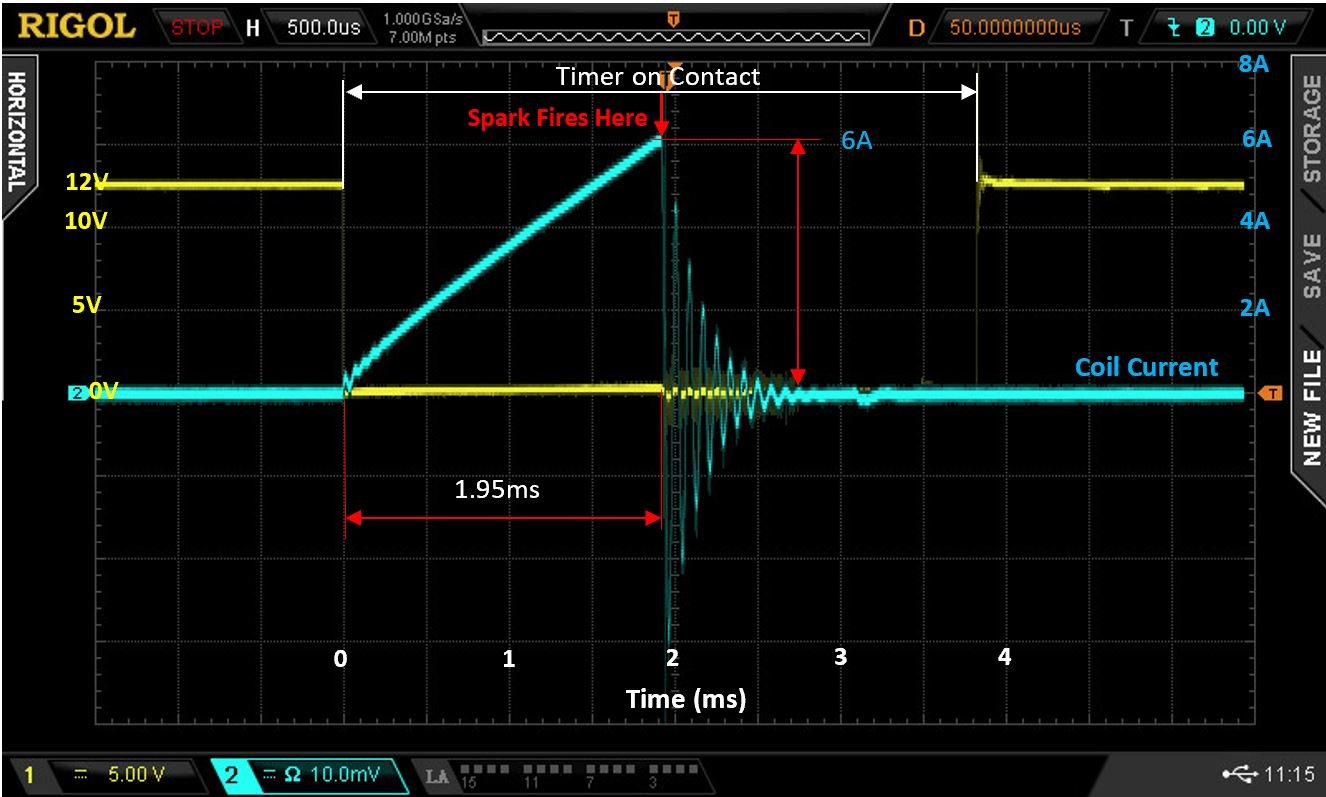

Regarding the TTF method; A graphic may assist with understanding where the 0.002 seconds of dwell time to fire spark came from. Here is a oscilloscope capture of a TTF test: The yellow trace is the coil timer terminal; a fast rising 12V pulse is applied to the coil under test when the timer terminal is grounded (yellow trace goes to 0A at time 0 as indicated on the white scale on the bottom). The coil current (blue trace) begins flowing nearly linearly (straight line steady rising current). Note that the coil current rises to 6A after 0.00195 seconds. At that point, the magnetic field produced by the coil current is sufficiently strong to pull open the vibrator spring contact; breaking the primary coil circuit and interrupting the flow of coil current. The coil current abruptly ceases flowing (goes to 0A) which causes the magnetic field to abruptly collapse and in turn induces a voltage in the coil's secondary (high voltage) winding wound around the primary coil winding. The voltage induced in the secondary coil winding is much higher than the primary winding because the secondary winding has approximately 80 times more turns of wire than the primary winding thus stepping up the voltage by the same factor through transformer action. The next logical question is; 12V primary voltage stepped up by 80 times is only 960V which is not high enough to produce a spark at the spark plug at ambient pressure (14.7psi) let alone cylinder pressure so how does spark get generated? The answer is not obvious because the coil voltage is not shown. The coil is an inductor which opposes abrupt changes in coil current (when the points open). A mechanical analog from fluid flow is water flowing rapidly (coil current) and the faucet is closed abruptly (coil points open). The water flow stops abruptly and the pressure within the pipe builds rapidly (possibly causing pipe banging) many times higher than the normal water pressure. In the case of the Model T coil, the coil voltage builds rapidly when the current flow stops flowing abruptly and can reach 200V to 300V for a very brief time (microseconds) even though the initial voltage applied to the coil was 12V. It is this brief voltage peak of say 250V that gets multiplied by the coil turns ratio (80) to produce the secondary voltage applied to the spark plug: 250V x 80 = 20,000V which is more than sufficient to jump a 0.025" spark plug gap when the ambient pressure within the cylinder is 50psi or greater.
The ringing you see after the coil current ceases flowing at time 0.00195 seconds is energy being transferred back and forth between the secondary winding and primary winding as the spark plug is arcing (current flowing to ground across the spark plug electrodes). At this point, the coil points are still open and the capacitor across the coil points is still in circuit and functioning to produce this back and forth energy exchange between capacitor and secondary winding. The capacitor value (0.47uF) was strategically chosen to suppress point arc when the points initially open but also to optimize the spark plug arc "burn time" to ensure complete combustion.The spark plug spark (arc) lasts for approximately 0.0011 seconds. You can see the arc extinguishes shortly after time 3ms (0.003s) by the last perturbation in primary coil current. The coil returns to rest, ready for this next firing. Hope this helps to understand the TTF method better.
