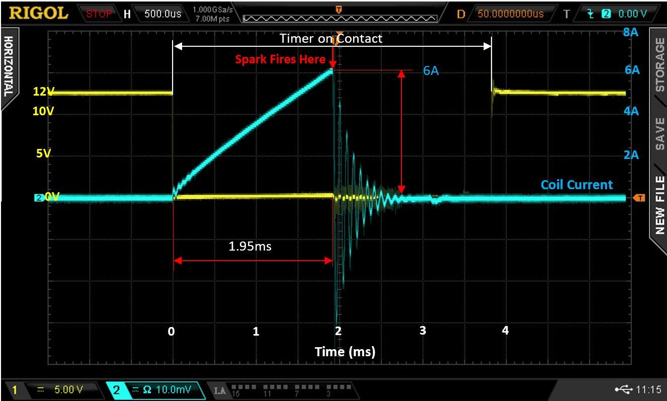

Regarding the TTF method; A graphic may assist with understanding where the 0.002 seconds of dwell time to fire spark came from. Here is a oscilloscope capture of a TTF test:
The yellow trace is the coil timer terminal; a fast rising 12V pulse is applied to the coil under test when the timer terminal is grounded (yellow trace goes to 0A at time 0 as indicated on the white scale on the bottom). The coil current (blue trace) begins flowing nearly linearly (straight line steady rising current). Note that the coil current rises to 6A after 0.00195 seconds. At that point, the magnetic field produced by the coil current is sufficiently strong to pull open the vibrator spring contact; breaking the primary coil circuit and interrupting the flow of coil current. The coil current abruptly ceases flowing (goes to 0A) which causes the magnetic field to abruptly collapse and in turn induces a voltage in the coil's secondary (high voltage) winding wound around the primary coil winding. The voltage induced in the secondary coil winding is much higher than the primary winding because the secondary winding has approximately 80 times more turns of wire than the primary winding thus stepping up the voltage by the same factor through transformer action. The next logical question is; 12V primary voltage stepped up by 80 times is only 960V which is not high enough to produce a spark at the spark plug at ambient pressure (14.7psi) let alone cylinder pressure so how does spark get generated? The answer is not obvious because the coil voltage is not shown. The coil is an inductor which opposes abrupt changes in coil current (when the points open). A mechanical analog from fluid flow is water flowing rapidly (coil current) and the faucet is closed abruptly (coil points open). The water flow stops abruptly and the pressure within the pipe builds rapidly (possibly causing pipe banging) many times higher than the normal water pressure. In the case of the Model T coil, the coil voltage builds rapidly when the current flow stops flowing abruptly and can reach 200V to 300V for a very brief time (microseconds) even though the initial voltage applied to the coil was 12V. It is this brief voltage peak of say 250V that gets multiplied by the coil turns ratio (80) to produce the secondary voltage applied to the spark plug: 250V x 80 = 20,000V which is more than sufficient to jump a 0.025" spark plug gap when the ambient pressure within the cylinder is 50psi or greater.
The ringing you see after the coil current ceases flowing at time 0.00195 seconds is energy being transferred back and forth between the secondary winding and primary winding as the spark plug is arcing (current flowing to ground across the spark plug electrodes). At this point, the coil points are still open and the capacitor across the coil points is still in circuit and functioning to produce this back and forth energy exchange between capacitor and secondary winding. The capacitor value (0.47uF) was strategically chosen to suppress point arc when the points initially open but also to optimize the spark plug arc "burn time" to ensure complete combustion.The spark plug spark (arc) lasts for approximately 0.0011 seconds. You can see the arc extinguishes shortly after time 3ms (0.003s) by the last perturbation in primary coil current. The coil returns to rest, ready for this next firing. Hope this helps to understand the TTF method better.
There are many ECCT users in Australia, check with your nearest club to see if they have one you can borrow or member who would be willing to assist you.

fbergksi, I'm kind of surprised no one else has mentioned it, but those voltages don't look that bad imho if they are that good once you apply a load (like an 1156 bulb). I don't think I saw any loaded voltage results above, but I could have missed it. If you get similar voltages once you test with a load, the car should run better on mag than bat at higher rpms. As stated above, the timing can change when switching from bat to mag. Also, if the timer has inter-cylinder inconsistencies, they can be exacerbated when switching from bat to mag if you're just missing the rise on one pulse for one cylinder and just getting it on another. I would play around with the timing while driving on mag and see if it picks up, possibly swap to a different timer and see if there's a difference, and check that the timing cover is centered to the cam.

Philip reported his no-load magneto voltage measurements dropped about 5V when he operated his car on magneto. That is a lot to drop, however, the magneto output is extremely noisy when operating on magneto so the voltage measurements may be skewed significantly. I agree a repeat of his original measurements with 1156 bulb as load would be more insightful in the absence of ECCT mag test or St. Louis Magneto tester which would be most definitive. The presence of loose/intermittent wire/terminal/connection is always a possibility too that might not be easily detected via voltage measurements.
Apologies for the thread drift, good questions asked and thought relevant to the discussion. Still waiting for Ron enlighten us on the errors in my post that warrant his directive for everyone to ignore the information I posted.
For sure. It's not going to run well on mag if there's a problem in the mag-to-coil box wiring or switch. Sometimes it's the simple thing that will cause a problem.

Good point! Where were the voltage measurements taken from - the mag post, terminal block, ignition switch or the at the coil box connection. Lots of connections that could cause a problem. Yes, best to investigate the simple things and rule them out before diving into technical issues.

Phillip.... Check the AC voltage at different engine speeds, a good magneto will generate 30 plus ac volts at engine speeds above 30 mph. Magneto may have to be recharged .
