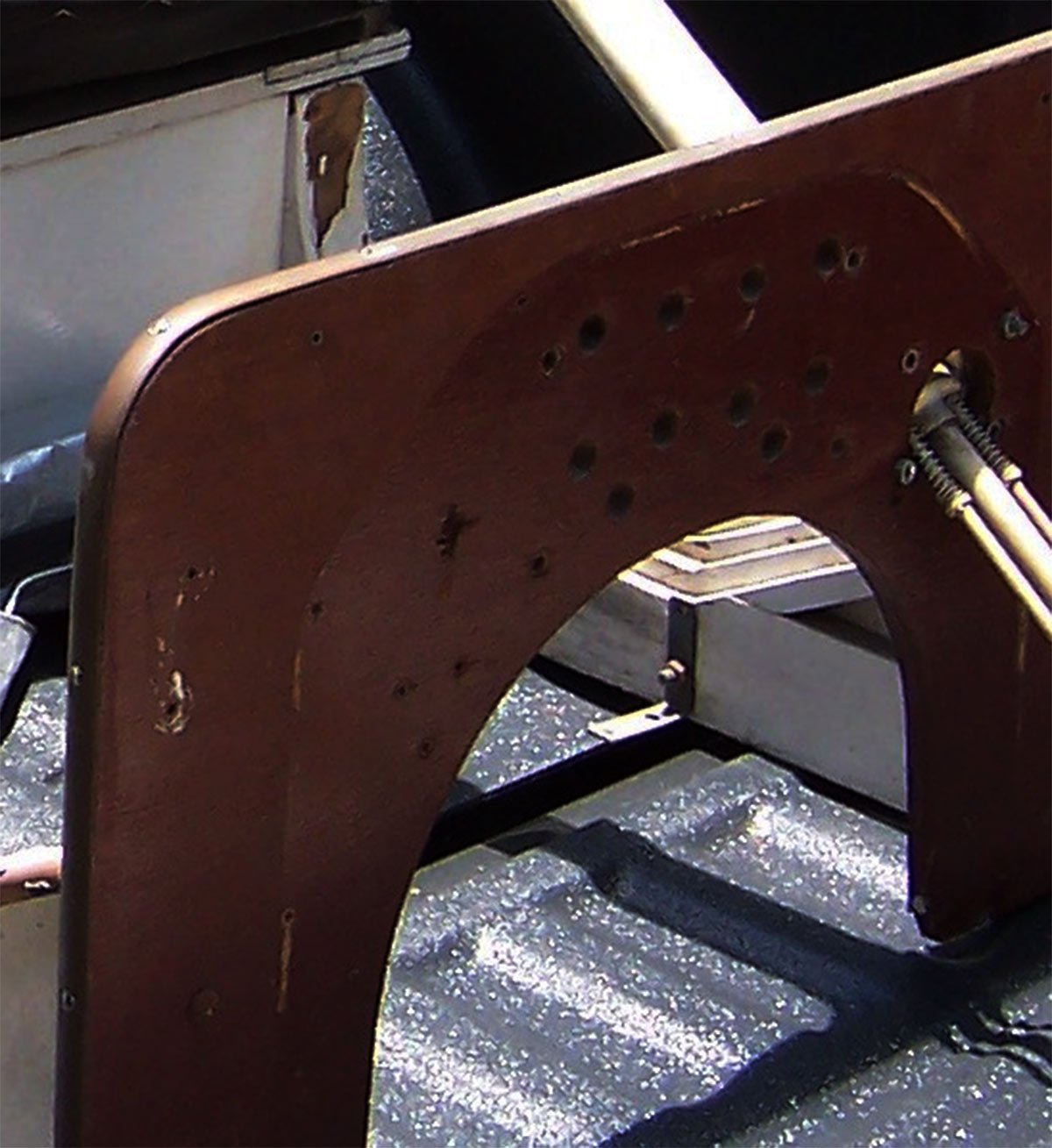

Post by Rich Eagle » Mon Oct 05, 2020 12:09 pm
This photo Dan showed in the discussion does show some spacing. I think it may be original.
More insight on it is welcomed.

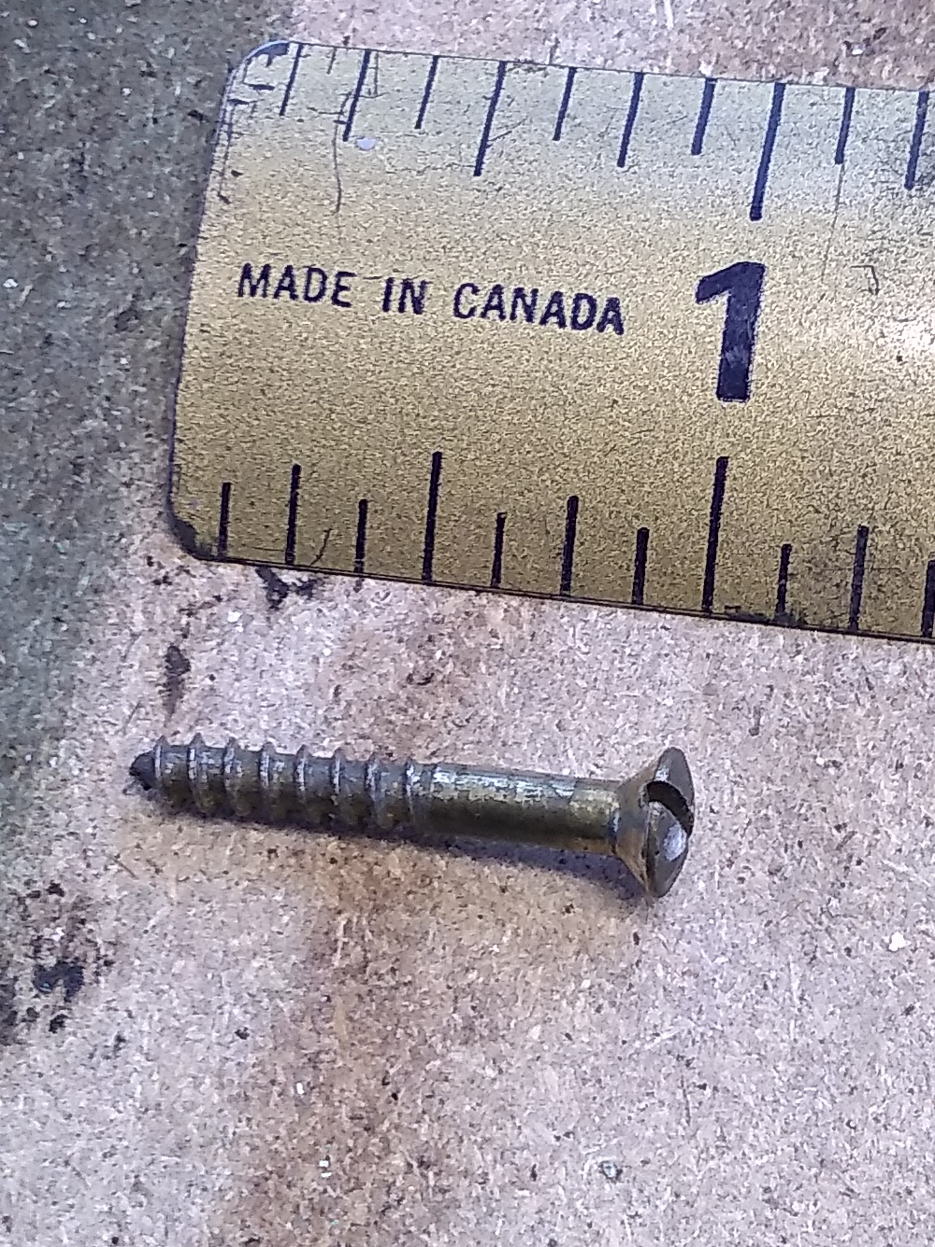

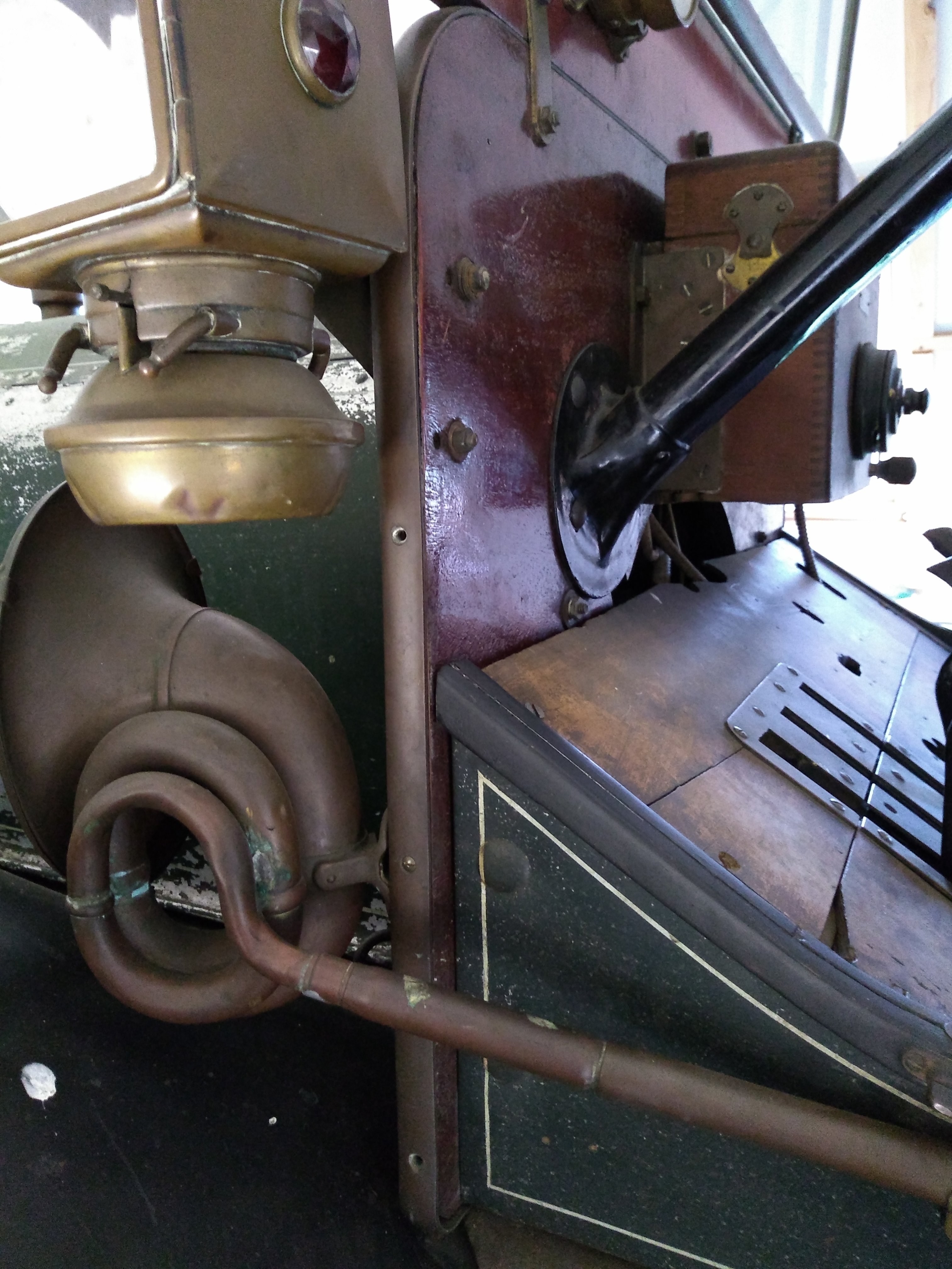

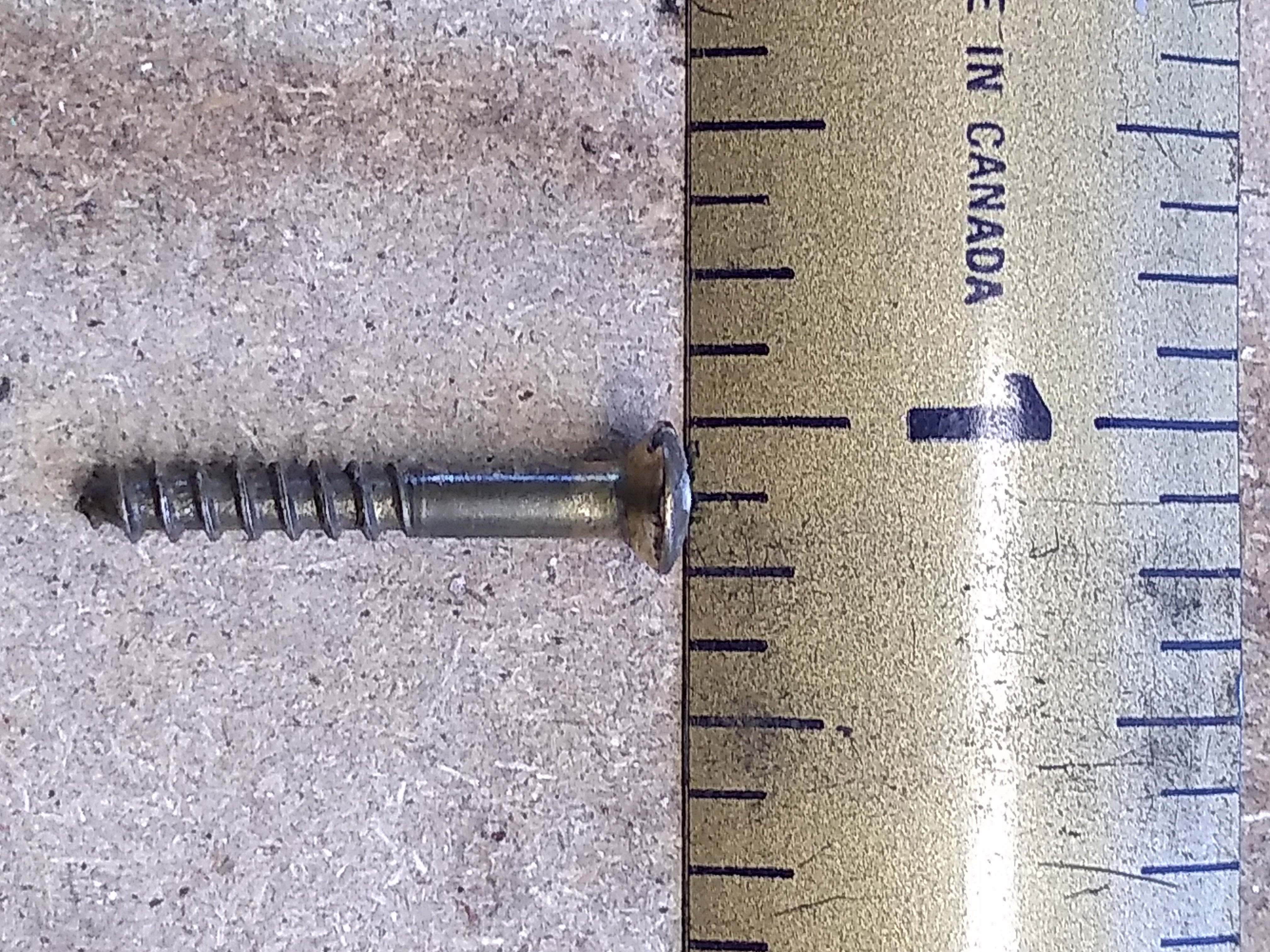

Here's my unrestored Aug 09 (not totally unmolested, it had an incorrect repaint circa 1950)
The bottom screw is 1.5" from the bottom edge, subsequent screws are 5.25" apart. The screw is a raised countersunk 1" long with 0.25" wide head.

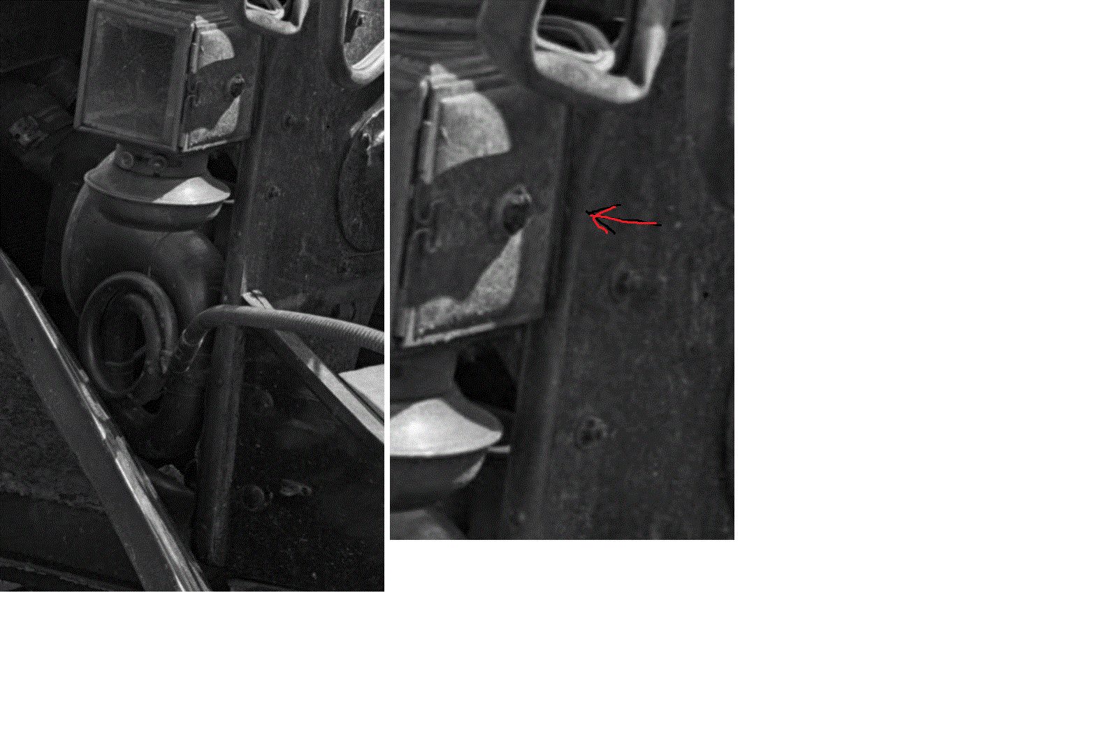

This photo of a wrecked '09-'10 was taken in 1913. Timing suggests that nothing was changed from original. This correlates with Jem's photo. It also shows a screw behind the lamp. See the arrow.

Yes there is a screw behind my lamp

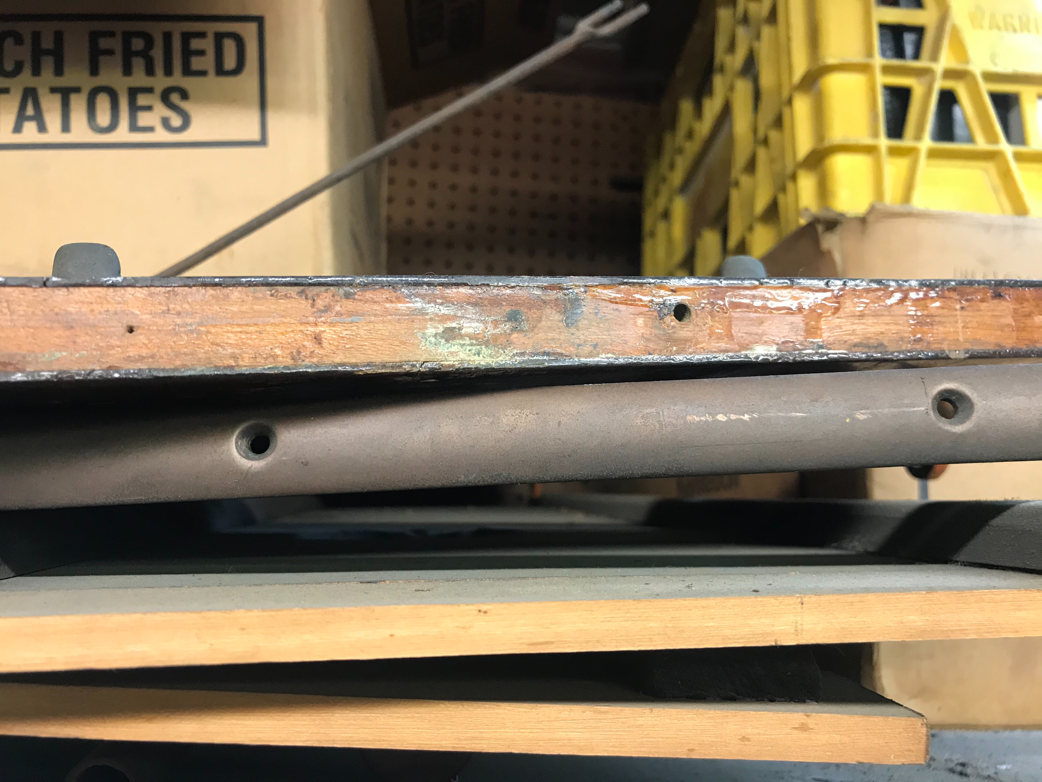

Phil, my 1909 dash is also 5.25 spacing.
