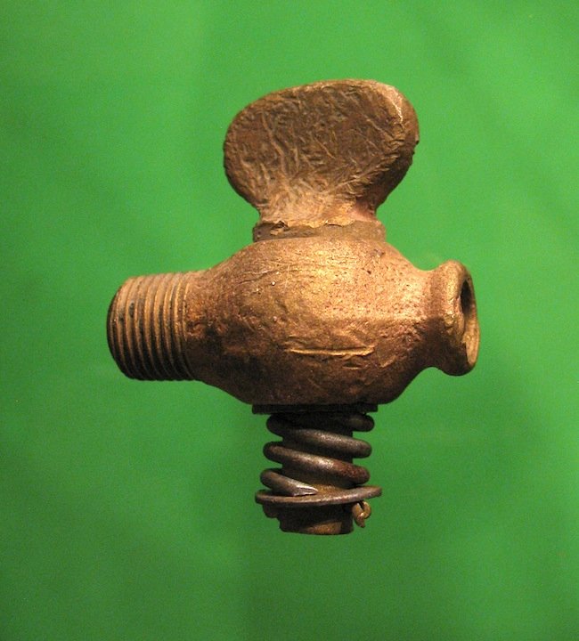

Okay, so I'm "fed up to here" with the typical green drops under both my Ts from that cussed, period-correct looking radiator petcock dripping incessantly. The vendors CLAIM the original style (as well as the modern version) don't leak. I say "ha! Prove it!
That said, has anyone bought one or the other in the last year, and indeed do they NOT leak?

Thanks guys, the petcocks I have on both cars are same as the one Steve posted the pic of.
Maybe I'll give it that "quick tap" first, and see what happens. If not, I'll take it apart and try what Richard G suggested.
